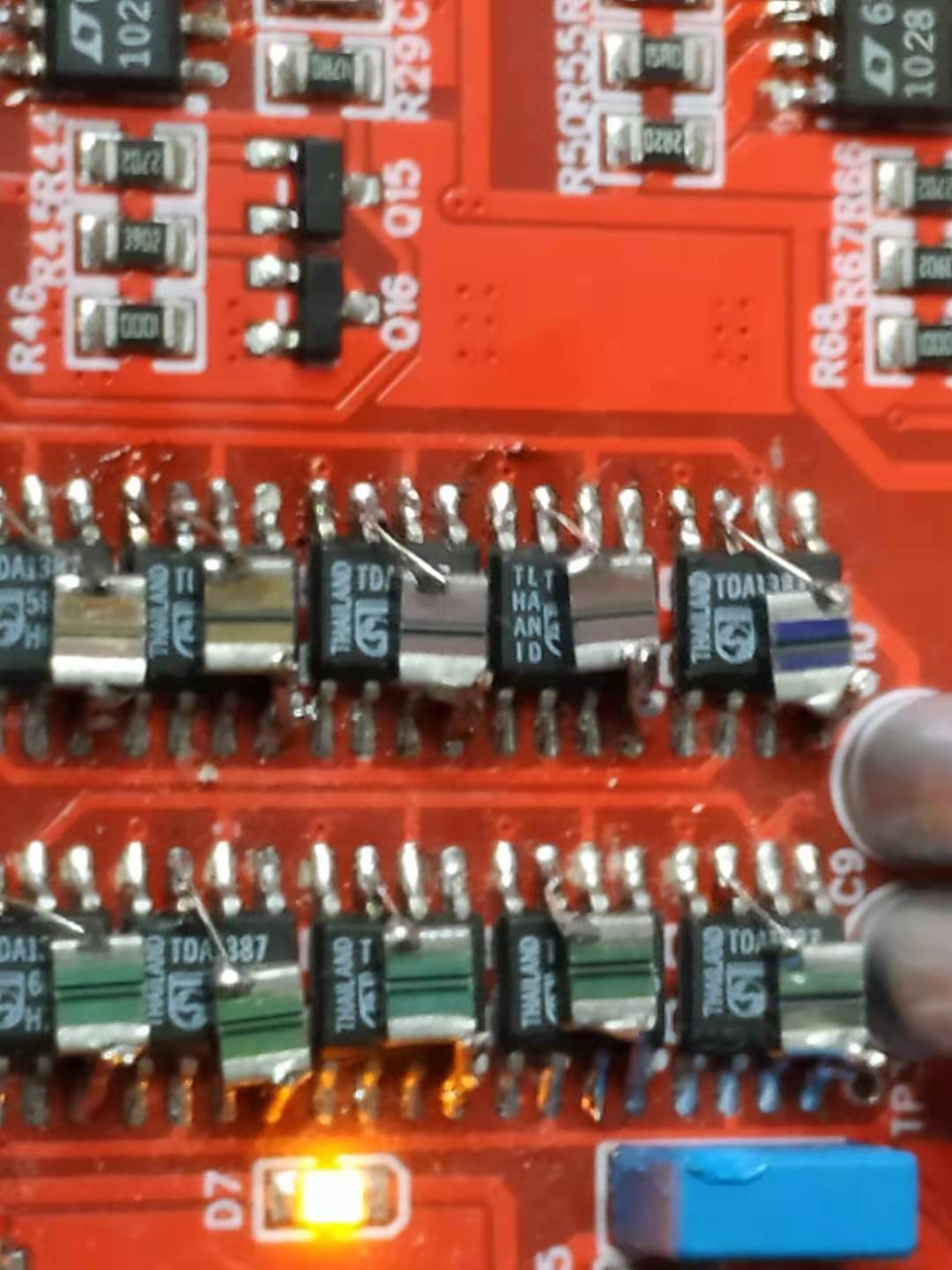

I finally had the time and built the Hex Phidac wich I received some months ago.
Test points are within the specification. Altouhg in one chanel DC voltage between out and ground is 12mv. on the other chanel is 0mv. I replaced C51 capacitor by a normal electrolitic just to test and DC voltage is now very close to 0mv on the afected chanel.

It's worth to replace C39 and C51 by high quality capacitors?
Yes, that's a worthwhile upgrade to this DAC.
Can they be smaller than 15 uF?
They can - that capacitor is an X5R whose capacitance decreases with increasing voltage across it. So in-circuit its definitely less than 15uF. How low you can go depends on the input impedance of the following circuit. 4.7uF (as used in the Deca DAC) is fairly safe.
In case they are to big and have to be soldered by wires to the PCB will the sound be afected in any way by the lenght os the wires?
I'd keep the wires as short as possible, under 15cm I would doubt there would be any degradation as the output impedance is fairly low (47ohm).
