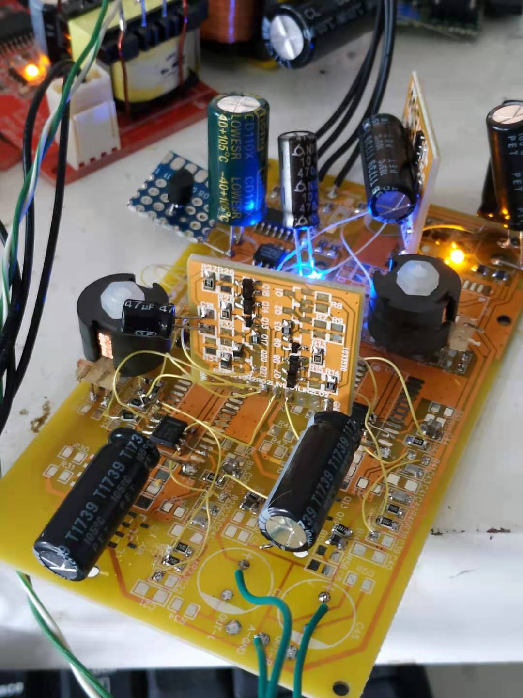

Latest prototype with OPA1678
This is the latest incarnation of the 'reloaded' PhiDAC - I've been listening to it for a couple of hours so far and its strength is definitely in the region of HF transparency. The obvious weakness though is in bass solidity in comparison to a tweaked Deca DAC (which uses LT1028). This combination of strengths/weakness give the overall impression that its a bit on the bright side in tonal balance.
My hypothesis is that its the LF noise in the opamp that's responsible for this tonal balance so I plan to try other opamps with lower LF noise corners. The OPA1678 being CMOS input is considerably worse for LF noise than a typical low-noise JFET opamp. OPA1642 is the next candidate to try - however its at least 3X the cost.
Anyone got any other ideas for low noise opamps to try out, preferably duals?

Funny you should mention that one Vunce, it was the first DS I pulled up when looking around. Turns out the LF noise issue is the same as for OPA1678 - HF-wise its slightly better but LF noise density @20Hz is the same 25nV. So if my hypothesis is correct it might sound a teensy bit brighter than OPA1678.
I still have a bag of AD829 so I'm going to try again with that for the next proto. Its bipolar though so might need some R values tweaked.
Ha that one is a very old favourite of mine for I/V duty. Great dynamics but lousy noise, largely because its a CFB opamp in VFB clothes. Its about 11nV mid-band which makes it more than twice as noisy as OPA1678 but at least the LF noise doesn't rise as fast.
My affair with CFBs is pretty much over now because in practice they are a bit noisy - I'm interested in VFBs once again and OPA1678 seems to deliver a very good package of features at a very nice price.

Seems I have been a little bit too hasty to lay the noise floor imbalance at the feet of the opamps. The design had been working on a single TDA1387 - I wondered if adding more chips might add more bass? And indeed, going from one to two chips does flesh out the sound so it sounds a good deal more in balance. So here is an audible justification for running more than one chip in parallel - LF noise is decreased which gives more perceived depth and a more 3D presentation. Perhaps OPA1678 can stay after all, more listening needed.

I understand OPA1656 might not give a huge improvement on the paper over your current OPA choice, but sometimes spec sheet aren't the entire thing.
I would say give it a try amazing OPA on many applications. Having said that, it is quite neutral, not bass heavy, so depending on how you want to trim the balance you may not prefer it. It is quite musical / natural, but then perhaps you rely on the output transistors for sonic performance.
As said, if you have them lying around, would be pity not to try the OPA1656, they are non expensive...
Just thinking out loud of course, and following all your developments with delight, thanks for sharing all this

@ClaudeG - thanks for your suggestion. I agree spec sheets aren't everything when it comes to how things sound. Yes I do rely on the output transistors for getting the SQ I like, I did try without them and didn't find the sound engaging on more complex music. Seeing as the main difference I noticed between 1656 and 1678 was in output drive I felt like I wasn't paying for what I didn't use in selecting the 1678.
So... perhaps you could try OPA1656 and even try that one without the output transistors.
If you get the sonic signature you want with the drive capability, you would this way even get a circuit with less parts and cost... and who knows, might even sound better.
