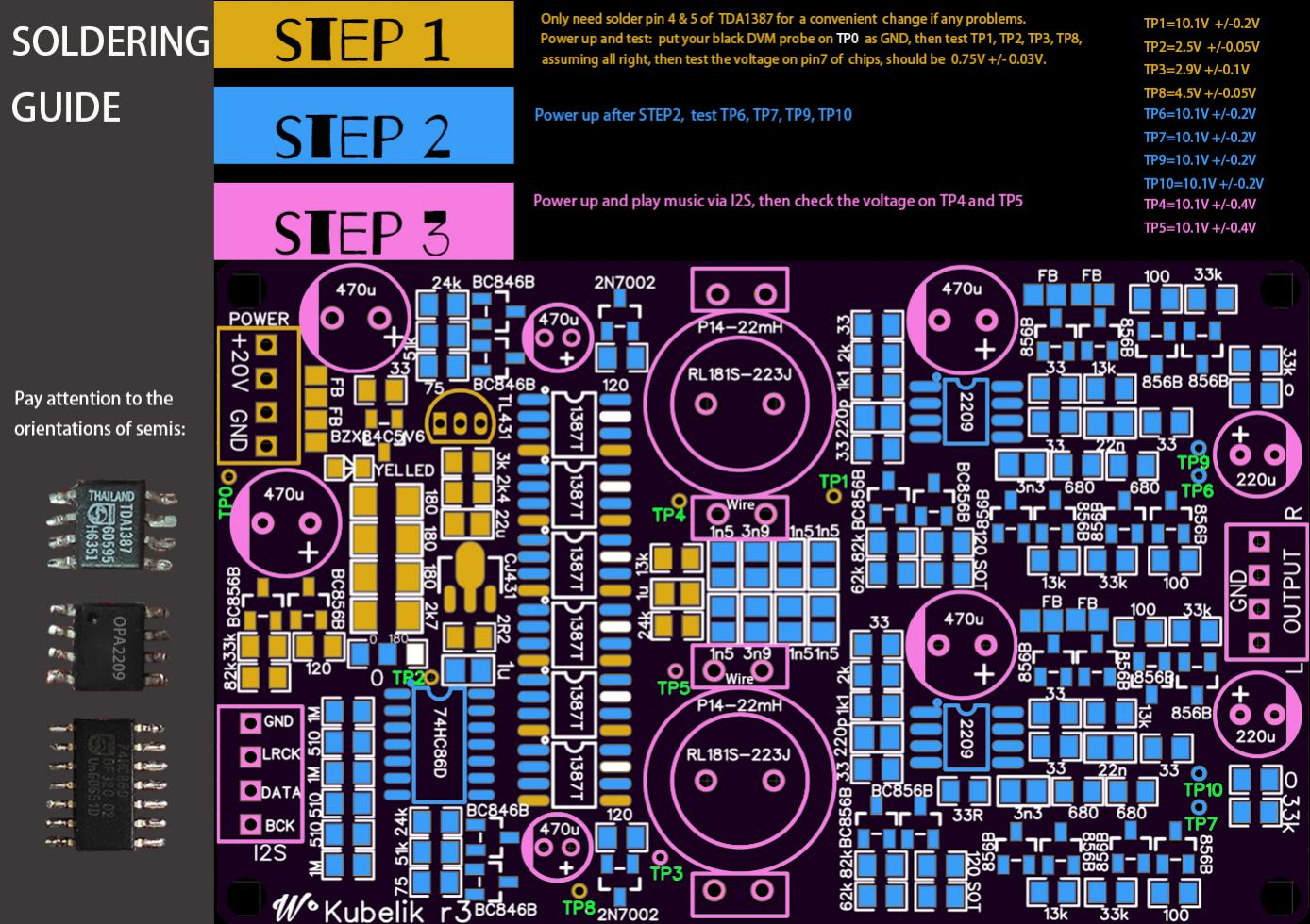

Having completed step3, power up with an I2S signal playing and verify the offset voltages at TP4, TP5. If you want to gild the lily the offset can be trimmed closer to mid-rail with the SOT resistors.
Basically I have cleared Step 2 ( Blue stage) and hope to complete with Step 3 soon. I know the SOT resistors may not be necessary, but would it really make some minute level of difference if I were to try trim offset voltages to closer to mid-rail?
I see that the SOT resistors are in parallel with R2 and R6. Can you advice on the adjustment approach?
Having done the adjustments on a couple of DACs, I haven't noticed any difference in how they sound.
The assumption I made (based on the build of several prototypes) was that the offset would be a negative one initially. Putting in R69 and R70 can only move the offset higher - if its initally too high then R2 and R66 need to be raised in value first (try 130ohm).
The procedure is as follows - measure TP4 (-ve probe) with respect to TP1 (+ve probe). The voltage is then divided by 2000 (the I/V resistor) to calculate the offset current. Measure the voltage across R2 and divide that voltage by the offset current. This gives the resistance needed for R69 - choose the next highest value. Repeat for TP5, R66 and R70.

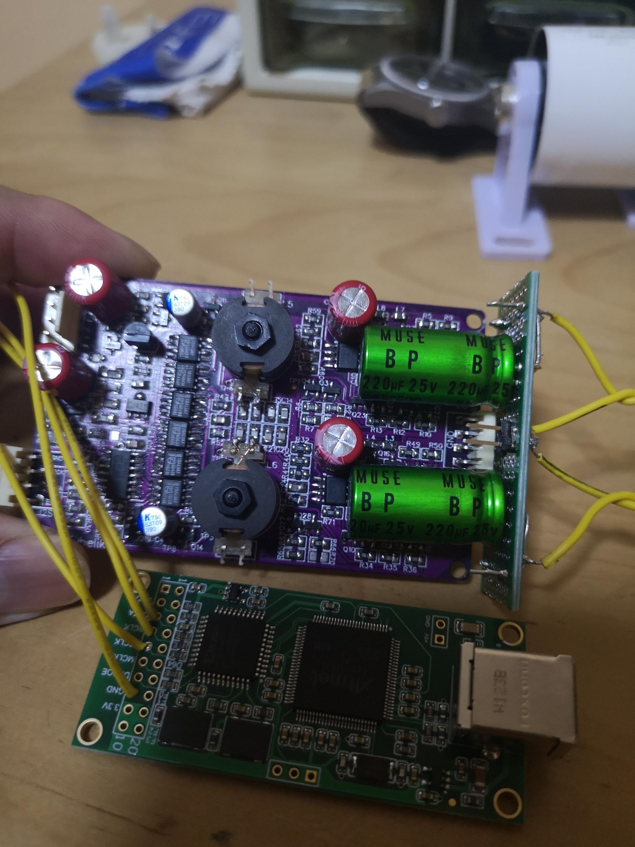

Kubelik
First of all, thank you to Richard for sending me an already built-up Kubelik. I have been listening to it for the last couple weeks, and it is incredible what he can offer at this price point. If you are on the fence about it, I would recommend just to go for it.
For the sake of comparison, I had been listening to an SMSL DAC (Sanskrit 10th MKII). Kubelik blows it out of the water. While the SMSL sounds clean, I feel that Kubelik reveals much more in the way of quality of the music. For example, I never realized there could be detail in the decay of a crash symbol (each hit sounding different).
One thing I really appreciate is the sound stage, it is realistic and has a well defined center (something the SMSL was severly lacking in). Also it handles music with a lot going on (a lot of instruments or a lot of distortion) very well, it never feels like it gets bogged down or you need to turn it up louder to get more detail.
I also have a DecaDAC (both 3rd and 7th order filters). DecaDAC with 7th order filter has an even bigger soundstage and improved bass (probably my favorite so far). But having listened to all 3 for a couple weeks each, I have never felt anything lacking after the intial getting used to stage (unlike SMSL).
I hope this doesn't sound too sales pitchy, but I am extremely impressed with Richard's work and what he can offer at a very reasonable cost. I wish I had tried one of his DACs before I had purchased the SMSL (a little intimitaded by the SMD soldering and didn't know where to get a power supply). Soldering the DAC chips went much smoother than I anticipated, and I'm using one half of a VRDN for PS.
Side notes: I was initially concerned that these DACs are designed with NOS droop compensation. My only music source is Amazon music, which I run in exclusive mode because I don't trust Windows to keep it's nose out of the music. So the DAC is likely fed 192Hz 32bit most of the time. I have not found this to be any issue, it handles it perfectly (I haven't run into the tape hiss problem). If you are putting the DAC in a chassis, look for "panel mount USB" (I initally used Neutrik style, but recently found more convenient and cheaper style on AliExpress).

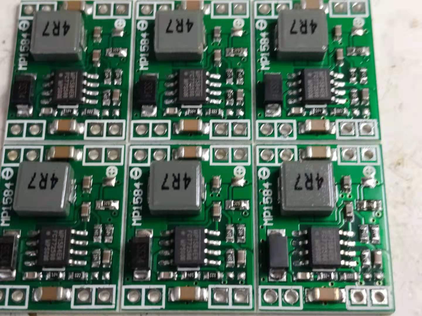

Progress towards the next generation DAC...
Kubelik's array of six DACs was limited as much by heat as board space. Linear regulation down from a 20V supply to the DAC's supply (3-5V) is very wasteful. Increasing the number of chips beyond the 10 of Deca DAC really needs an alternative solution for supply regulation.
I did come up with a heat-saving solution of running the DACs in series with the analog stages rather than in parallel as now. It worked fine in prototype but it means the currents for DACs and analog circuits have to be about the same. Going to 20 DACs means the DAC supply requirement goes well beyond the analog one - in this case a switcher looks to be the best solution.
After a bit of basic math I figured the switcher should be a buck one generating the DAC supply rather than a boost for the analog as the analog stages are more power-hungry. I have a few modules from Taobao based on MP1584 and have my first prototype using one of these playing music now. MP1584 has the advantage that its fixed frequency and you get to select that with a resistor, I've gone for the minimum of 500kHz. The module's inductor is 4.7uH which is probably great for currents above 1A but here I need in the region of 100mA so I have increased its value to 47uH with the aim of decreasing EMI.
