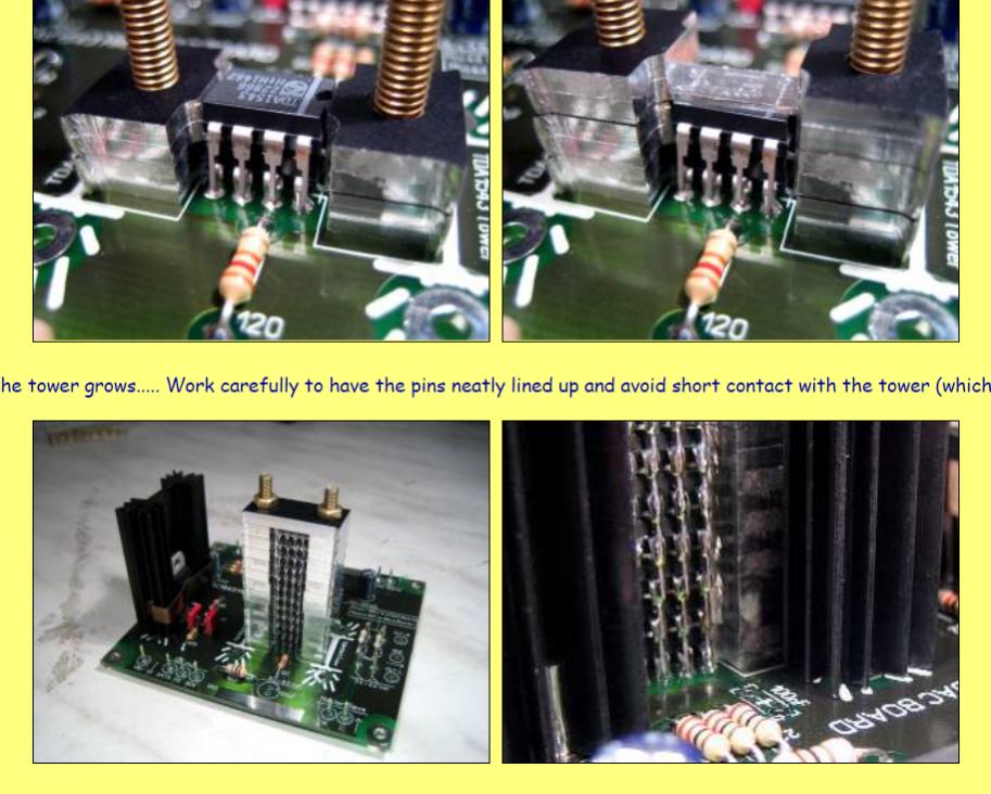

piggiebacking
Hi Richard!
Years ago I had built a DDDac 1543 (Doede Douma).
This dac existed of numerous TDA1543 chips, packed together forming a tower with the use of cooling profiles to get rid of the heat.
As I understand: heat is no problem in your design, so piggiebacking five or ten chips should be no problem.
Though this way of building ,in an easy doable way, asks for a chip with legs.
I am not aware of availability of your dac chips in a legged form though!
But I am sure you know!

Hi Ed - thanks for the inspiration. I'm not aware of any TDA1387 in DIL packages either. The closest is TDA1545 which I've played with before and not had the best results. But might be worth another look with a bigger form-factor PCB than I'm currently using - I might still have some of those chips in my closet.

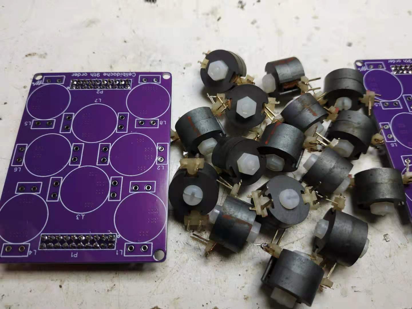

Celibidache 9th order filter PCBs

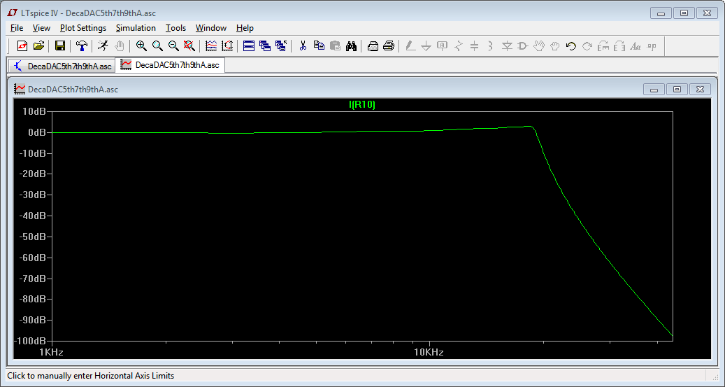

The dedicated Celibidache filter PCBs have arrived - frequency response plot attached. Since the NOS droop is compensated for in the passive filter now there's no need for an active filter stage giving the HF lift. Which saves power and board space. Stop-band rejection is close to -100dB by 44kHz.

I hope you are making kits available.
Paul - I've given some consideration to ways of mounting chips on daughter boards. With the current layout though stacking is very limited due to the filter board over the top of the chips. Also with the design I have there are other parts of the circuit that need changing (biasing current sources) when the number of chips is changed. So its not quite a simple plug-and-play.
@commstech - filters won't be available in kit form due to the impracticality of providing selected value caps in multiple small bags. Shipping individual inductors is also labour-intensive on packaging.
