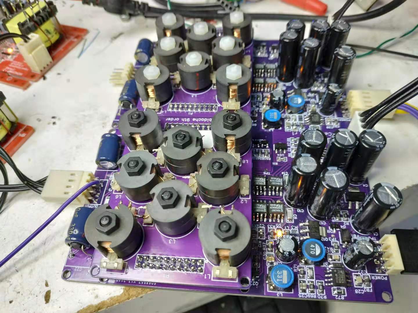

r1 PCBs came in a few days ago, but its taken me longer than usual to get an r1 prototype into a condition where prolonged listening is possible. I've been plagued with randomly occurring rumbling/rushing noise on the L channel. I was really hoping that it wasn't one of the DAC chips as individually examining (potentially isolating) one chip at a time is a long process. In the end the noise became less intermittent so became easier to track down. Eventually I uncovered a failed transistor in one of the biassing current sources.
So now comparative listening with the last version is possible. There's a lower impedance filter on the r1 to suit the additional current out of the DACs. Plus the tweaks to the discrete OPS on the I/V. Then after that, I am curious to try if its possible to push this to 60 chips......😱
The second prototype I built with 60 chips and set up a listen for wifey to see if she heard any difference. She seemed to have no trouble picking the 60 chip version against the 40 chip one, saying it was 'more powerful, more scary'.
So this result suggests the bottleneck is still in the DAC chips themselves. But this design isn't really a practical avenue for adding more chips beyond 40, I think I'm going to have to revisit my 'massively parallel multibit misadventures' design and see where that leads.
Oh and something very weird - the same transistor blew up as on the last prototype. Which suggests its a layout or circuit issue rather than just a random transistor failure. So more investigation is called for.

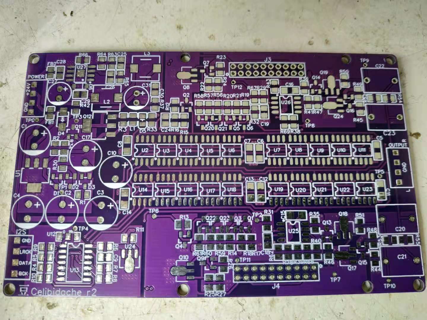

You can order by sending me a PM with your requirements, your location and your payment and shipping preferences. You can buy a Deca DAC PCB fully built and tested if SMD soldering isn't your strong point.
The 60 chip DAC won't be a commercially available project, its just for experimenting. Shortly there will be the 'Celibidache' available with 20 chips (with option for 40). It'll be more expensive than Deca DAC.

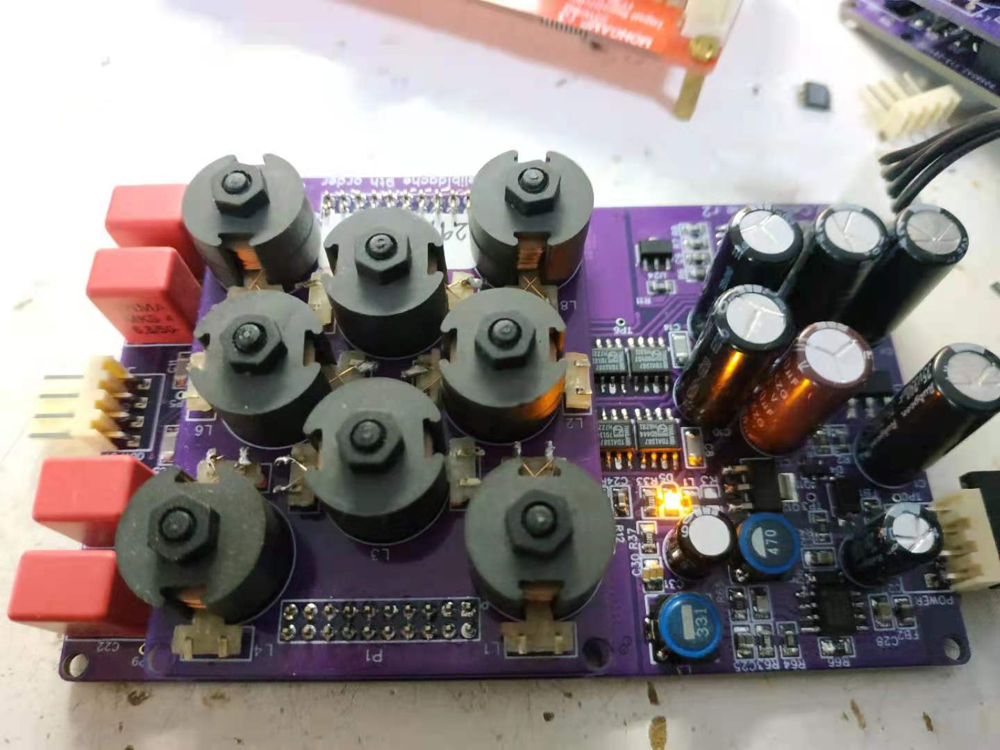

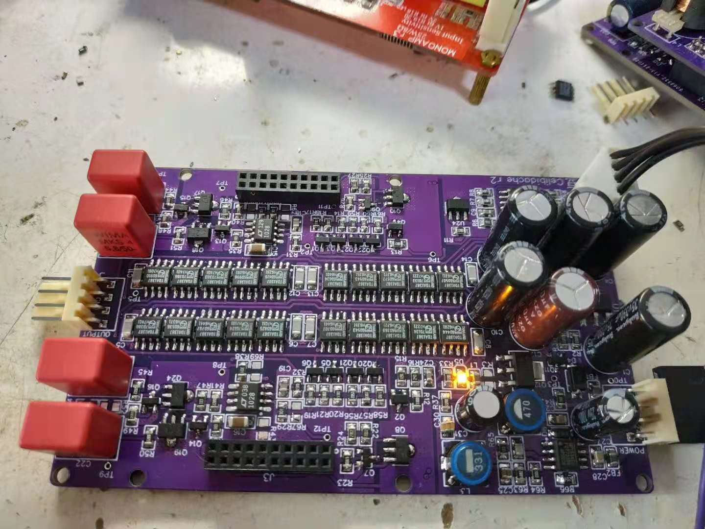

Here are a couple of pics of the built-up DAC. I'm building several so I can understand what are the natural variations in the parameters (offset voltage is a significant one as its DC-coupled).
