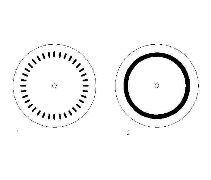

I have been wondering about the problem of drag between platter and oil and it seems to me that it really should not be that much of a problem.
drag is a big issue if you try to move a padle through a fluid in a direction perpendicular to its biggest area (like the padle of a canoe), but if you try to move it in a direction tangential to this it will be easy. (like on a boat where te keel or the rudder will cause very little drag, because they are oriented in the direction the boat is going)
And the way I understand it what we have is more like a rudder than a padle.
version 1 is the unwanted padle variety and version 2 is the rudder model
Peter
Agreed but still not qualified - experiment/fluid dyn degree required again🙁 If there are only smooth (note smooth) surfaces slipping tangentially/linearly thru damping fluid - like the hull of a boat, then drag will be minimal though I think not zero, due to good ol' surface tension effects. And that's as deep as I'm prepared to go in public!!🙁 (Though native cunning also says it can't be a big problem). Now if drag were to =vary= as the platter rotated due to a) turbulance in the damping fluid (could this happen if those clearences were too small?), or b) differences in gap as platter rotated, it would be a different matter. Turbulance in oil will have a much greater effect than in air. So, I think what this means is we need no turbulance (doesn't this then dictate minimum gap for a given speed differential?), and quite carefully dimensioned gaps around the periphery of the platter surfaces to avoid ecentricity - in that limiting (ridiculous!) case one can imagine a cam arrangement where the fluid is squashed out of the system by ecentricity, gradually loading the motor... more and more we need that fluid dynamicist or a set of experiments to prove or kill this concept...

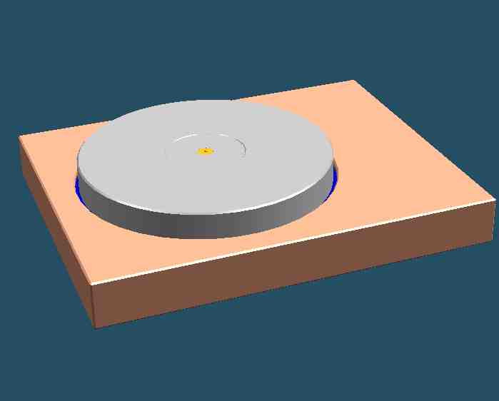

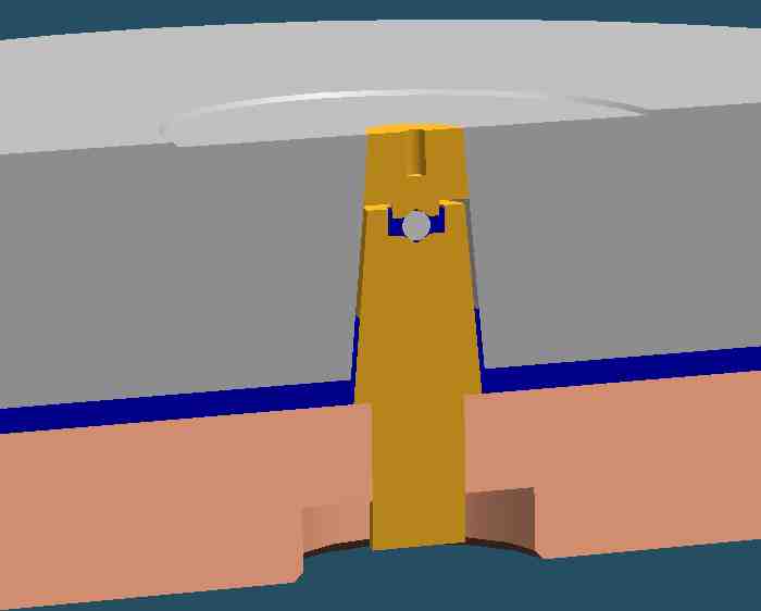

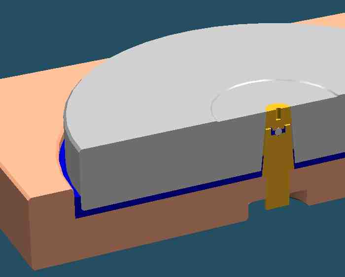

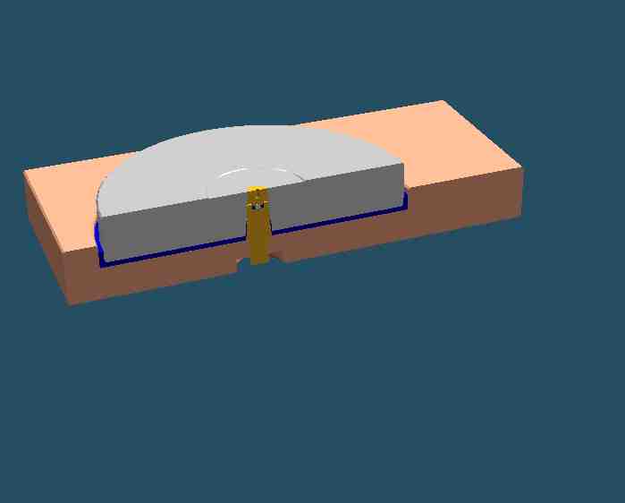

I have made a quick design for a simple oilbath tt.
basically its a translation of my previous pictures. The only real change is the separation of the damping oil and the bearing oil. This way you can keep the platter much simpler. Also can use different fluids optimised for damping vs lubrication.
Peter

Hey - cool pics Peter 😀 That looks about the size of it without going real-world. However chances are (backed up by history 🙁 ) that I too cannot find time to play with this - I'm in throws of trying roll my own IT business and generally stay afloat. This stuff will have a somewhat rock-bottom WAF just now!! Needs someone to take up the challenge (Peter - just hook your CAD up to the molecular replicator in the kitchen - preload with worn-out vinyl first??).
So, I am also interested in unipivot designs , only mine was the air bearing with metal plater, yours oil bearing , maybe a lot smaller ball, with oil damping, and the floating platter.
Mark - attraction of the oil for me is for damping as well as flotation. I think it more effectively couples the platter down into the plinth which can be as massive as is practical etc.
That seems a reasonable idea - at least while playing with the concept. and if it makes it easier to produce too. May actually be necesary due to uniball being physically above than the oil bath, so it needs its own little bath to sit in. There may be dry alternatives too - ptfe/teflon/nylon etc.
