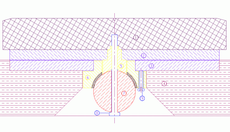

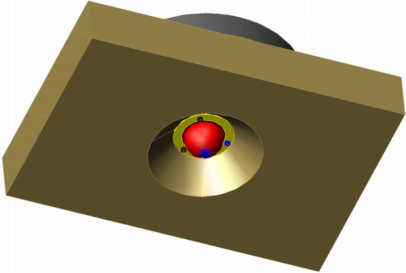

All,
it's about full moon (and my corner teeth are growing 🙂 ) and i could not sleep last night. So, there was some idea pestering me. ... based on the posts of Havoc and Mark.
cheapocheapo air bearing. Look at the attached pix. The drawing is in fact a Xsection taken from the 3D model. The components have ballons with numbers in it, the colour of the balloon circle is the same as the numbered component. And, dont pester me with minor hatching errors 🙂
Here it goes:
1: platter with center hole (no center pin)
2: axial bearing rotor: slab of glass or granite, glued to the platter bottom
3: axial bearing stator: slab of glass or granite, glued into the plinth
4: TT plinth
5: centering plug (centering (1),(2) and (7) to each other)
6: radial bearing stator: brass plug with the spherical bearing surface epoxied on; radially soft-centered to (3) by O-rings or a greased gap or whatever, vertical distance to (3) adjustable via 3 differntial screws (9)
7: radial bearing rotor: a bearing grade ball of 60mm dia.
8: mounting screw to make the ball removable in order to unmount the platter.
9: 3 differntial screws. Inner tap: M4 pitch: 0.7mm, outer tap: M7x0.75, pitch 0.75mm.
REsulting differential pitch: 0.75-0.7=0.05mm per revolution.
The ultimate simplicity of this layout comes from the fact that the only tightly tolerated dimensions are planarity of the flat slabs (any bullet-proof or mirror grade glass will do) and the sphericity of the bearing ball. The epoxied spherical bearing surface of (6) is generated by the bearing ball itself, this fits. As (6) is adjusted vertically to (3), no precision maching is required here. (6) even may be slightly tilted, due to the bearing gap being spherical.
Bearing is adapted to the application. A platter does not face big radial forces. So "soft"-centering via O-rings is totally acceptable. Adjusting the bearing gaps happens via 3 diff.screws (9). So (6) pulls the assembly (1)(2)(5)(7)(8) down via the bearing forces in the spherical air gap between (6) and (7).
The platter (1) cannot perform vertical oscillations and 3D-oscillations are damped by the mere platter height and the flat bearing gap.
Industrial air bearing units usally have either a plane surface and an opposing spherical bearing surface or two opposing spherical bearing surfaces. So that is not new. Adjusting the hollow bearing cup (6)(instead of somehow adapting the spacer (5) to length) OTOH is quite original.
"-With love - from me - to you !" 🙂 .Comments welcome.

methinks we should be able to obtain slabs with surface flat enough for our purpose. Like bullet-proof bank counter glass. "Plywood" glass 🙂
But if not, methinks your grinding/lapping procedure is good. We just have to take care that no particle tries to bully its way into one of the air nozzles. Maybe we mount the final nozzles after the grinding process?
Which brings me to nozzles: they are not yet drawn in my drawings. But they are necessary.
With no nozzles: if the bearing surface is tilted, the air flow is squeezed off where it is most needed, the air oozes out at the opposite side; pressure in the gap collapses and bearing jams. Nozzles ensure that flow of air is limited, be there an opposite bearing surface or not.
And they create a row of elementary bearings, each supporting all others and if one elementary bearing quits, the others remain functional.

Hey, at least someone is thinking. I also sometimes can't sleep- due to a design idea swimming in my head!
I accept that when designing something like this, the project gets more complicated, but I would prefer to keep the fabrication more simple unless we have no other option.
First of all, you can imagine how much I have thoght of this over the years, and I have ended up with the ball attaced to the platter in my current designs- mainly because it can't be too easy to drill a hole through a hardened 50mm ball bearing. I also don't see the need for the centering o rings- the ball will keep the platter from going sideways. I also figured that the platter will be the rotor of the bearing. We could make that optional- either use the 25mm thick disk for the platter like a thicker Rega, or add another disk in another material. Likewise with the plinth, The most basic arrangement would be use the stator as the plinth.
Just have a rectangular piece of thick glass cut and edges polished.with a hole in it (next paragraph) If you want damping, you are free to add it to the bottom.
So, I envision, a 25mm thick 12" dia. glass platter with about a 45mm hole in the center. The ball won't fit all the way into the hole so it sticks down. It is epoxied into the platter hole. The epoxy is filled from above to not add any to the bearing area!
A shaft could be set into this epoxy for the record center hole.
The hole that remains above the ball is completely filled with epoxy, leaving a smooth top surface (with the shaft sticking out)
The plinth is another piece of thick glass with a 30 mm hole in it where the center of the platter is. Another piece of some material
with a 30mm hole is glued under the hole in the plinth to make the 30mm hole deep enough. another (thin) layer is added below this to seal off the hole and create a well.
(The layers under the glass plinth don't have to be glass - could be a disimilar material to help damp. Also the hole doesn't have to be accurate either because it will be lined with epoxy)
NOW, one adds just the calculated amound of epoxy to the well, the platter and ball are coated with a release agent, and the platter and ball assembly is pressed into the well. The epoxy rises just enough to reach the mid point of the ball (equator!)
After hardening , twist off the platter/ball
drill a small through the bottom of the well/socket for air
AND IT IS DONE!!!
NO machining other than the glass, Glass people make circular shapes of thick glass all the time for tables. I don't know about the 50mm hole but I've seen big holes in glass.
Waddayouthink?

Mark and all,
1st,
drilling a hole into hardended steel is no problem with a tungsten carbide tipped drill bit. Apart form that, maybe a half ball or even a ball layer can be obtained.
Or un-hardened balls. Have to consult my ball supplier.
Moreover, it appeals to me to use a slightly bigger ball to form the epoxy surfaces. Bigger by the specified bearing gap. The air needs a bit space to establish a laminar flow.
2nd,
centering the bearing cup of my draft is necessary, i dio want to know exactly where my platter's center is and radial forces can pull the bearing cup sidewards via the bearing ball. And then the adjsuting screws' tips grind over the surface. Oh yes, and now and then i want to transport my TT. Without having to re-adjust the bearing afterwards.
OTOH, radial play is needed so that the bearing cup does not jam in its hole when tilted.
3rd,
as far as i understand your idea (a drawing would help), it could work albeit the spherical bearing gap appears to be slightly off-center to me. I see one point not pleasant to me: nothing keeps the platter from bouncing vertically on the air film (which, let's face it, is a progressive spring).
4th,
to have one air nozzle is simple for sure.
Einstein however says: make anything as simple as possible, but not simpler. Methinks one center nozzle is too simple. The air is flowing thru the spherical gap, then thru the flat gap and then leaving at the outer edge. Thus a pressure belly is created under the center of the platter and specific air flow is decreasing from center to edge and the platter becomes unstable against tilting.
One thing i have to comment to my drawings: air flow (nozzles and air release orifices) is not yet drawn. Trivial to me, so i forgot to mention it : the air has to face about equal gap lengthes (escape path lengthes) in any direction, edgewards or centerwards.
This calls for a ring of air nozzles for the axial as well fort the radial bearing.
1st,
2nd,
3rd,
4th,
