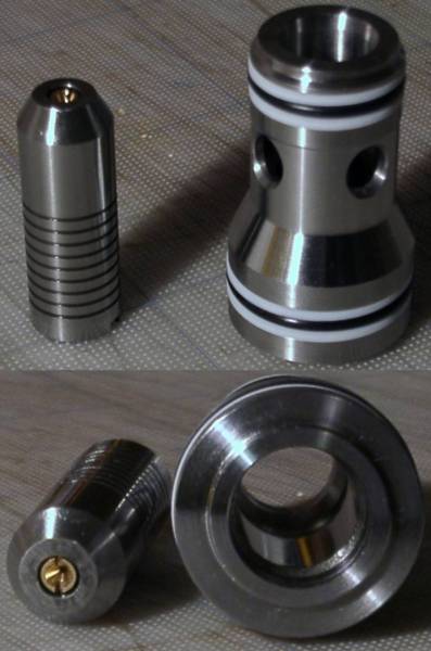

Pedro,
the valve cartridge i was talking about is 32mm in diameter and 56mm in height. But the upper portion mut be shortened a bit, cut on a lathe. The sealing edge part ought to be removed.
The piston is 16 in diameter. Let's see if can post a picture.

Pedro and all,
find attached a pix from the hydraulic valve cartridge.
You find me sitting with a big grin! 🙂
Have a good night, all!

Bernhard:
I'm a bit lost here.
What kind of valve is that on your picture?
what is its comercial aplication?
Pedro,
i guess it is a pressure limiting valve but i am not sure. I also have other valve cartridges but they do not have the dimension i would like to have. This one just fits. BTW, purpose in unimportant , the mechanical properties count.
All i can tell is that it is hard if not impossible to put the piston into the bore, but when the piston is in place, it runs smoooooth. And without noticeable play.
And i have seen the drawing, so i know the gap and the tolerances.
