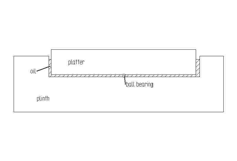

boy this is serious stuff!
I've just returned from my hollidays and suddenly this thread has emerged. I think it is great and would love to be part of it all. I am an industial designer by trade and by no means an engineer and therefore cannot really understand the technical bits of what you lot are saying. But i do have some expertise in manufacturing techniques. Reading all this got me wondering if you couldn't simply let the platter be the bearing (see picture). Let the platter sit in an oil(?)bath (and if neccessary use one ball bearing to support the platter).
As I said it is just an idea, but why wouldn't it work?
Peter
I try to attach a drawing, bur I am not sure it will work😡

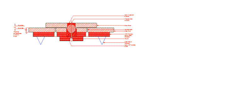

I hope this image works. I’m not good at getting stuff out of Autocad.
I can post an acad file too
My approach is to keep the design simple at first, then add complexity as EXPERIMENTATION shows the need. Perhaps 4 nozzles aren't enough. If it doesn't work, we drill more!
At the moment I'm sure your suggestions will improve it (or make it functional!) It is not proposed as a finished product. In fact it might be a horrible turntable or the finest ever made I sure don't know!!
Gilad's idea of grinding, which would allow those with extra energy to tighten the tolorences is an example of this. I think that what could make it great is the eperimentation and effort by many people to the basic design.
As it stands, the platter and plinth should be able to be made by any glass fabricators that makes thick tabletops. The bearing can be make by anyone. Keep in mind that I have seen a working example this bearing concept albeit without a heavy platter! This example used the actual ball to form the socket, but I can only agree that if a slightly oversized ball is available to make the socket that would be better. I guess it is quite possible that ball bearings are available in very tiny increments of size. Even though the air film must have varied-it worked fine.
Of course plinth and platter size and layers of additional material can be experimented with by all. Even suspension if Dice doesn't break down your door! Eeeek turntable police!!!
Another thought: The Teres was a great deal for the original participants, but because of the special machining, any DIY person has to order the parts from Teres at a cost that is still pretty steep (perhaps still a bargain) or pay a fortune at a local precision machine shop for a one off part. At least the Teres parts are still available, otherwise the design would just be an interesting footnote for those that didn't get one in the beginning.
If we use complicated special parts, then we are at the mercy of the fabricator, and future builders will not be able to replicate the design and improve on it at reasonable cost- especially if the fabricator loses interest.
!!!!! If we keep it easy to fabricate, it will gain a life of it's own. !!!!
Perhaps this can be combined with other proposed ideas to make a better design. I am open to that of course.
At the moment, I see a few steps that people could do to help analyze this design:
1. Check your local cost for a 12” dia piece of glass 25mm thick with a hole about 50mm, and a rectangular plate with a similar hole for the plinth.
2. Check the availability of ball bearings in about the 50mm size and a thousanth oversize (Dice-what is the air thickness we are looking for?
3. Don’t do anything because this design doesn’t catch your interest.
Enjoy,
Mark

Mark,
good job with AutoCAD! no need to humble yourself 🙂. Maybe you get in to 3D soon and stop hassling around with 2D drawings 🙂
I have asked a friend to make my LISP routines understandable for English people and to clean up the icon salad a bit. My routines help very much for 3D drafting and will be downloadable from my website soon.
no, TT police won't come, has to brush the own porcupine 🙂 . But you know my concerns, no need to repeat them.
I agree, dependance from a manufacturer could be a limiting factor for a DIY project. I had something other in mind when i suggested that. And i know what happened to the Teres thing, in fact one member of the original group maaged to occupy it and make his own business out of it.
To your drawing:
1) please muse about differnt materials. massing too much glass together and letting it be a major part of platter and plinth might cause glasses nasty sonic footprint to dominate and spoil sonics.
2) the edge of the lower epoxy cup should not touch the balls equator. Consider, vertical movements do not cause much gap variation at the equator but considerable gap variations at the south pole. Maybe it is better to have no south pole at all, maybe a band between Alaska and Florida would be best. No pressure belly then and almost uniform gap variations. Consider, the flat surface does the axial bearing job, no need for a well-meaning spherical bearing to help (and disturb). Make geometrical worstcase investigations, AutoCAD helps a lot; if you have drawn proplerly, you can measure down to 1/infinity. Try out how bearing gap varies on height variations.
3) 4 nozzles in the sphere and 8 in the flat surface, my suggestion.
4) please look that the air can leave the bearing gap on both sides. The flat surface needs air release holes at the inner radius.
So does the spherical surface. Imagine the bearings as circular elelmnatary bearings. The air has to be able to escape around the circle.
5) MicroSeiki had 25µm bearing gap. But provided surfaces are precise enough, on can go down to 10µm, maybe even 5.

---I want to make it clear that I have never proposed any sort of suspension - I just want to emphasize to people that they are free to experiment. I'm sure you are right, They would probably end up regreting it!!
---And I don't think that is a bad thing necessarily. At least the Teres lives on. Otherwise it would probably never be built again, because of the cost of one-off machining, and all the work they did designing it wouldn't continue to be used.
To your drawing:
---Of course this is true, but we had come to the conclusion that glass would work well for the bearing. Again-keep in mind that I'm not trying to prescribe an exact design. I assure you that the people on this forum will do things such as make the platter out of 10mm glass and glue a 50 mm disk of acrylic on top, or laminate various materials in the plinth. As it stands, the plinth glass is glued to another material such as wood or MDF or metal wich makes it very different than a piesce of glass by itself. This is constrained layer damping, and people could take it to ridiculous extents it they want. Also I'm sure someone will try stone for the plinth bearing even though I spec glass!! That's how DIY folks are!!!
--I would say that is why it is very important to have contact almost to the equator- that is the best part of the bearing (most consistant) and is required to take the lateral load of the motor and belt. Of course, any higher than the equator and it won't work!!
---Maybe since the south pole is thicker and relatively springier, it will have NO effect vs. the platter bearing. the air will just compress.
---Probably, but very difficult to make in my design
--As I mention above, perhaps the much thicker gap characteristic of the south polar region 🙂 make it affect the platter bearing very little. Perhaps just wishful thinking
-This is a lot less than initially mentioned, and could be done at a reasonable price I think. But keep in mind that I have seen the ball bearing in a working configuration with the socket made by the ball itself AND only one nozzle. It was very stable and worked very well. I suspect that you are right and more nozzles will work better, but because I have seen it work, I would be tempted to try one. I also like your suggestion to find a ball i tiny bit bigger to make the socket. I just don't know if they are available. Also, as I mentioned above, maybe the thicker air film on the souuth actually is good?
--Here is how I was originally envisioning it: ONE circular elementary bearing (the platter.) The air enters from the center and exits from the perimeter. I added the extra nozzles under the platter at your suggestion. This is probably necessary, You appear to knowabout this stuff and I don't, but as you point out, that creates more problems.
MAYBE if we had about 6 nozzles around the the ball socket
the air would flow into the gap between the platter and plinth evenly? Probably more wishful thinking. Damn 🙁

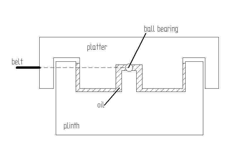

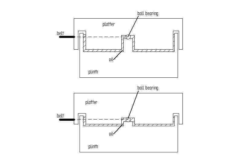

About 10 posts before this one I posted an idea to let the platter sit on a single ball bearing and stabilize the platter in an oil bath. Something like a unipivot arm.
Nobody has replied on it, so I assume it is a very stupid idea. But could anybody please explain why that is so? The drawing was there just to explain the principle of the bearing, the actual thing may have to be very different in order to solve other problems. But still, what is wrong with the basic idea?
Peter
Peter,
sorry to have not responded.
to be honest, I am not quite sure if your idea works. That is because the axial bearing is over-determined: either the ball or the flat bottom surface carries the platter. Reason: you cannot predict actually happening oil gap that precise and you probably cannot machine the ball surfaces that precise then. And there will be wear-off, adding to the problem.
Moreover the platter's center of inertia is above the ball so the platter will tend to tilt around.
If you omit the ball, this would help. But then the platter's outer diameter and the plinth hole has to be machined to a high precision.
Then i see an additional challenge: the oil will heavily dampen any platter motion.
Partial oscillation. That is good. Rotation. That is not so good. But, her lays the challenge, if you manage to find a motor able to drive this "oil-breaked" platter to a constant speed, you will have the most constant platter speed in the world. Because your motor/platter/platter-bearing assembly generates 99.9% static base load and 0.1% load variation by the record played.
thanks for your reply Bernhard,
*this seems to me to be a question of how much of the platter as actually supported by the oil. And also maybe about viscosity?
*see picture
*Isn't this also about viscosity and/or the width of the oil film?
Peter
yes. if the gap is thin, a bearing gap, then the oil film's coherenece carries the platter. With a wide gap, the oil only dampens. the wider the gap, the less the damping.
*see picture
way better! but please avoid the platter's Xsectional bell shape. make the platter massive as before. The circular fin hanging in the oil need not to be that thick.
you could use the shaft on which the ball is resting as radial bearing shaft.
Another weird idea once realized y some French guys: a stainless steel platter swimming in mercury. They used shaft and bushing for radial bearing. The rest of their platter looked like your draft, just that a thin layer of silicone oil prevented the mercury from evaporating slowly. Mercury (Hg) is quite poisonous.
Having the belt pulling along the axial bearing point height is a good idea. But your platter is a gyro: it tends to keep it's rotational plane. If this plane is tilted, it remains tilted. If the belt pulls not horizontally ..
What do you do to prevent that? Remember, tonearm vertical tracking angle is utterly sensitive for changes.
Yes. The wider the gap, the less the damping and breaking.
Bernhard,
I'm afraid I don't quite understand what you mean. I assume that the fin you speak of is the part of the PLATTER that hangs in the oil.But by thickness do you mean its height or its width?
If you mean width: shouldn't actually be even wider (see picture)
If you mean height: wouldn't the stability of the platter suffer as the point of gravity will lie above the ball. (see picture) I am supposing the ball should be in the oil (?)
Is this really an issue at 33rpm?
Thank you for your wisdom,
Peter
