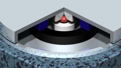

peted:
1) the belt always crawls on the biggest diameter within its reach. With force.
2) it the platter starts to rotate tilted, it probably remains tilted, due to being a gyro.
I agree that the oil bath will have a slight tendency to horizonalize the platter.
Forgetabout wood mockup, wood swims in oil, metal does not. Answer will be not significant, will fool you.
Oil damping platter vibrations: seconded.
Coupling disc2platter: from own experience i would not recommend liquid coupling. It sucks the life out of the music. I do recommend applying vacuum to press the record slightly on the platter. If then the platter is made from PVC and the record too, we have perfect mechanical impedance matching and the record can get rid of partial oscillation to a high percentage.
What also works fine: a thin mat made from leather, from chamois.
Careful platter design: there is no escape from it IMO. I would go as far as to say: avoid glass. Even if suited for air bearing.
The air bearing has high stffness and damping if done properly, i would expect it as effective as an oil bath. My objection against an platter air bearing: it needs considerable amounts of pressurized air. To ge such in a silent and smoothed way: expensive.
peterr:
agreed with your unipivot bearing,worth a try. But you still have to horizontalize the platter.
I do not intend to intimidate you but the tonearm i am designing currently as well as the tonearm you see on my web site has a linear dial gauge to measure vertical tracking angle. This dial gauge resolves 0.01mm for the current one and 0.001mm for the one on my website. I am well knowing why i have this precision provided, VTA can be adjusted to 10 arcseconds precision on a pivoted arm by ear reproducably. I bet a bottle of 25ys old Scotch single malt whisky on that.
I hope that Thom Mackris from redpoint audio is right with linear trackers being not so sensitive. But neverhteless it is vital for the tonearm VTA that the platter does not change its orientation or chooses an arbitrary one on each spin-up.
Thin oil film: would help you with the said above and, no, no problem to help the platter spin-up by hand if the motor can keep speed then.

To help avoid the problems of the motor/beltdrive putting a tilting force on the platter one could use 2 or 3 motors (not my idea, one of the local hifi koffeeklatch members has a DIY TT/air bearing Linear tracker with 3 motors (or at least 1 motor and 2 aux pullies). I've only seen it once and there was so much to see (his breadboarded triamped setup has something like 70-some pieces of iron in it and takes up a good 3 m2).
dave
dave
Dave,
unless i have a lightweight suspension TT (with belt force vectors having a resulting force vector of zero length), i am reluctant to advocate 3 pulleys.
The belt has a very small wrap angle then and very few grip on the platter. It only carresses instead of driving the platter to speed .
the grip the belt can have, the belt force it can grip the platter with is
F_1 = exp( µ * alpha * F_2 ),
with F_1 being the belt force of the tense, pulling end, F_2 the force in the loose end, µ the friction coefficient and alpha the wrap angle.
Now the 3 pulleys have to be located close to the platter to give the platter 3x a minimum belt warp angle. Which costs themselves belt wrap angle.
For a high mass TT 3 pulleys are pointless. I agree, if the platter has a convex outer diameter with the max.dia **exactly** at apex of bearing, and the max.dia of the pulleys **exactly** at this height position, this would tend to stabilize the platter orientation. May i express my doubt this stabilizes enough and to required precision?
Then: Carressing the platter and the belt not having grip is good, if the motor is bad.
But, assuming we all use maxon motors, the motor is extraordinarily good. No need to carress, better drive the platter and let the motor have a solid grip via the belt in order to swiftly re-feed the rotational energy lost by the orchestra on the record playing loud and noisy.

Have been on holiday and trying to catch up.
On the oil bath idea: How can the oil film carry weight if it is not pressurised? The only way it can is with Archimedes: by the platter displacing as much weight in oil as it weighs itself. (is this correct english?) This is the reason mercury was used in the french design. If we try this with oil and steel, we will probably end up with a hollow platter and that would not be a good idea in my opinion. So you end up pumping oil into the bearing (but then air is easier/cleaner to handle) or back to tight tolerances so it becomes self-pressurising.
Other way would be to make it an hydrodynamic bearing, but that is not an easy design, certainly out of my reach.
Just for the record: when using pulleys and flat belts to transfer power, one of the pulleys is mostly made convex. Forgot if it is the smaller or the larger, but that can be found in textbooks.

Havoc,
Peted is interested in a floating wood platter for just the reasons you mentioned. He refers to it in his last post.

I agree that in principle wood will float in oil. But if you have an approx. 7.5cm thick platter in an oilbath that is only about 1 to 2 cm high I am not so sure..Forgetabout wood mockup, wood swims in oil, metal does not. Answer will be not significant, will fool you.
Havoc,
As I said before I think the oil is not meant to carry the weight. The uniball is there to do that. The reason the oil is there is damping (and stabilizing).On the oil bath idea: How can the oil film carry weight if it is not pressurised?

I have some drawings in progress but have an additional idea for the mag bearing. Has anyone worked with or tried flexible magnetic tape or mat? I am try to find a quick local source to try an experiment with it. I am going to try and form the "cones" out of the tape/mat and see what kind of effect I can get. I wonder if the ends of the tape, which will form a butt joint seam, will cause a "dip" in the mag field, essentially causing a speed bump during platter rotation. I'll post my drawings in the next couple of days. Later
OK, here it goes. It's a combination of the ball radial bearing and the magnetic axial bearing.
Central is the radial ball bearing. Here a 20mm diam ball in 2 cups. Then there are 2 magnets (black and blue), same as in a loudspeaker. These have an axial field. The platter and static bearer are steel. So the repulsive force acts between the magnets, and the rims of the platter and the bearing. This is a closed system, only at the rim there is a fringe fields, but the strenght of this field is radial symmetric. So the cartridge is not in an AC field of the bearing, and the whole is not cogging. If needed, the platter/bearing can be made larger than the LP to get the fringe field out of the way.
Don't know about availability of loudspeaker magnets, but if needed a makeshift solution can be found by sandwiching several disk magnets between the bearer and a steel ring covering the magnets (like used in the large focal speakers).

Looks good. More machining required, i expect, than the air bearing idea.
Speaker magnets should be pretty easy to get -- i know i have many here, matched pairs might be a bit harder to scrounge (hate to "disassemble a working set of 12s for the magnets).
