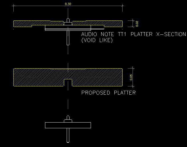

here goes a drawing of the platter based on my audio note TT1, (void design)
this has a cnc machined brass bearing with a stainless steel spindle with rounded end (see picture) with a drop of oil.
I ran some numbers and the projected weight in perspex is 4.98kg with a volume of 3519 cm3 and a moment of inertia of 11214cm4.
It has a top "hole" with 5cm radius and 2mm depht. I guess is for the label?
I made it with a hole in the bottom to "use" it with the axis of my current TT. what do u think of this kind on bearing?
maybe too simple 🙁
