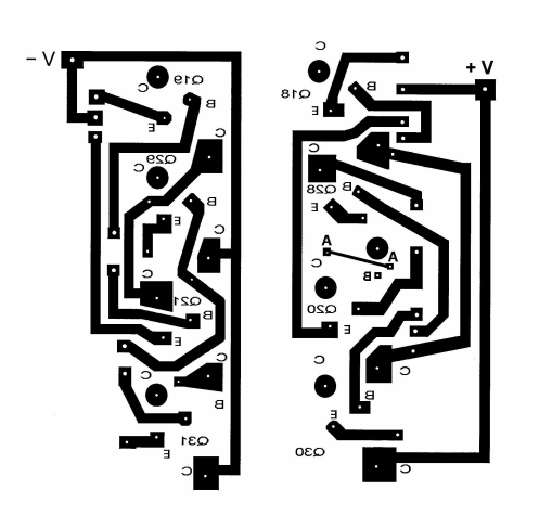

leach amp pcb

leach amp pcb
Well I got everthing on the way but the xformer and 10000uf caps.I decided to go press and peel .The have a thrift store here with an 18.00 hp4 laser.Got a bunch of cheap tools at show.SO i am all set . Gonna have to have a yard sale when I leave this hotel .I am going to build a low tim amp. I got an older version of pc cad with a 400 component limit and 6 layers with all the other bells and whistles.Now I can also make lcd set ups for a htpc.I figure in 2 or three years I will have the mome theater set up done and then it will be time remodel it.Thank you guys.If anyone needs anything let me know .I think i got enough stuff coming to build like 4 amps except the heatsinks and xformers and large caps.
pcb layout
I have a pcad 2000 , does anyone have a .pcb file that will work with it .All the ones I can find are in formats that will not load.I can make my own but I am kinda itching to start plus I got figure out how to use the program.Which I should do anyhow.Will using the bitmaps and pdf's printing to press and peel make boards that you can use ?

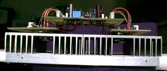

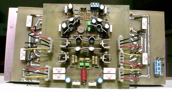

- Leach clone, pretty good looking
