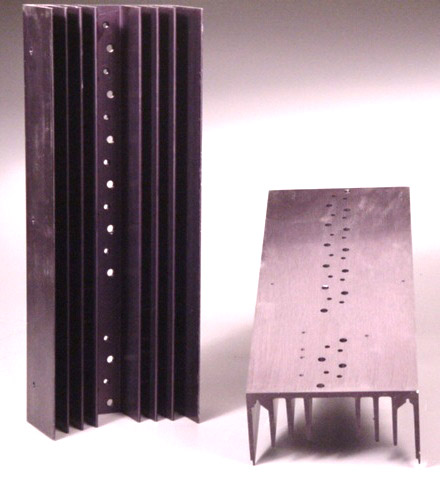

The heatsinks will be around 0.4 degrees/watt.
What voltage does the transformer on the P101 have ?
Does Rod recommend a specific heatsink for the different amplifier
outputs ?

You should do the basic math against the size of the heatsinks:
http://sound.westhost.com/heatsinks.htm
has a calculator that gives a conservative idea.
I seem to remember that Prof. Leach says about .67 degrees C/W for each heat sink on the Low TIM amp. Best check tho. The spacing on your heatsink is not really optimal.
This style from http://apexjr.com (not an endorsement, example only) is much better for even distribution of heat and for installing the diodes between the transistors.
What you already have may work OK, but if it was mine, I wouldn't use them.

The transformer I used in my P101 is a 45-0-45 which is giving me about +-65VDC rails.
Hi Ace,
I just received the heatsinks. They are too small for this project.:( I have some others that are larger but not well designed for TO-3 transistors. Are there equivalent transistors in a TO-264 or something like that?
I have two of these heatsinks.
I also have 4 of these heatsinks.
Thanks for all your help,
Terry
The "Large Aluminum Heat Sinks Allen Bradley" are probably more suited to the Superamp. However you will need to cut them in half for the heighth to make sense.
There are plastic transistors that you can use. Never used anything but T03's in my amps, so don't really know what the numbers are.

For your amplifier voltage is 45 Volts, after rectification half of it is around 22 Volts.
Suppose the amplifier will be set up for a minimum of 4 Ohm loads which it will drive with maximum power.
Maximum dissipation becomes (22 * 22) / 4 = 121 Watts.
With 4 output devices rated at 150 watts the thermal factor for a transistor is 125 / 150 = 0.83.
Thermal resistance for the mica layer is around 0.50.
Suppose maximum heating of the transistors is limited to 100 degrees C.
With an ambient temperature of 25 degrees C it leaves a safety margin of 25 degrees, maximum die temperature is 150 degrees C.
1 transistor will dissipate 121 / 4 ~ 30 watts.
At 100 degrees over ambient total thermal resistance may not be larger than 100 / 30 = 3.33
Which leaves for the heatsink : 3.33 - 0.83 - 0.50 = 2 .
There are 4 transistors on the heatsink each claiming 1/4 th of the heatsink.
Maximum thermal resistance of the heatsink will be:
2 / 4 = 0.50 C/W
Suppose your heatsinks are 0.35 C/W
That is 70 % of the calculated one, at 30 degrees C over ambient the remaining 70 degrees margin will still be able to take 121 watts dissipation before the die of the transistors becomes 125 Degrees C.
Raising the temperature of a 0.35 C/W heatsink by 30 degrees over ambient means putting 85 watts in it constantly.
