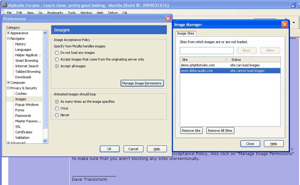

Here (see attachment) is the reason, why I asked about "missing" layout.
But yes. There is picture after all. Right click -> wiew image. I dont' know if some "wiewer" missing of my PC, or why it's not wisible.
Sorry about my nonsense 🙁

Hmmmm.....
That's odd. Both images are just run-of-the-mill GIF images, but they are quite large. If you have a dialup connection it may take a while to download.
Do you not have Mozilla set to automatically display images? Go to Edit > Preferences > Privacy & Security > Images. Select "Accept all images" under Image Acceptance Policy. Also click on "Manage Image Permissions" to make sure that you aren't blocking any sites unintentionally.

Hi and thank you very much 😉 Now that works
I have now located that bug. I don't know, how Mozilla did that by itself 😡
