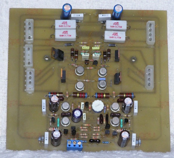

I Have not decided on the low tim or super amp yet .Before I do a pcb I am trying to find some large caps and xformer. The pcb they have is a little small and doesnt leave much room for heat sinks on transistors.They say they arent needed but I would prefer they had some just to be sure I dont have any thermal problems.Having to redo pcb would be costly .Any Ideas on layout ?I am open to suggestions because it would help lower my costs if I got some extras that other people would want. I want to build a 3 channel.I cant decide if I should go with 1 channel per board or have a larger one with all.I have also seen an amp done with the outputs on the pcb with sinks instead of the large vertical ones.They said they had no problem with heating.
still4given said:Would the layout on this page be good enough to make a pcb from?
Its up to you.
In my view it is substandard, had it not been symmetrical i would take it for a layout made with rub-on tape.
The output devices are not on the pcb, meaning that they need to be wired from the board.
Many regard this as a risk: it may create humming or even turn the amplifier in oscillation.

Thats what I was talking about .I was thinking of doing a pcb with the outputs on the board.This will make a much larger board with the cost going way up.I am on the road for 4 months so I cant make my own.It would be a pain for me to try and drill without a press(which would be no fun too).Shoulds I try a board with 2 channels on one or 1 channel each. I want to use screw type caps for filters or would large board ones work okay.Would it be good to put rectifier and those caps on there own boards.I am going to use 4 caps per channel.I want to put three channels in a box but this may be to large of an enclosure.Any suggjestions ?

OK folks,
"The output devices are not on the pcb, meaning that they need to be wired from the board."
This is why I redesigned the layout for my case.
"Many regard this as a risk: it may create humming or even turn the amplifier in oscillation."
Prof. Leach cautions about this issue in the destructions. Never experienced the problem myself. Only built a half dozen or so of his amps, tho.

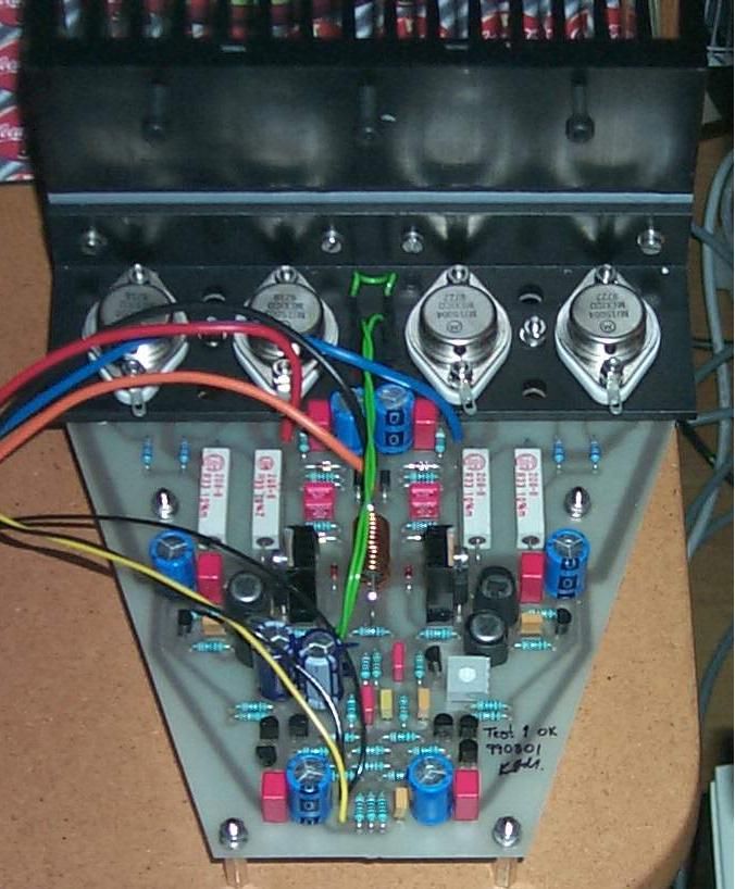

Try this guy's solution.
Website:
http://home.swipnet.se/malman/LeachAmp.html
Picture:
http://home.swipnet.se/malman/lowtim_circuitboard.jpg

"The pcb they have is a little small and doesnt leave much room for heat sinks on transistors."
Proper sized heatsinks are readily available for this purpose.
One stereo amp fits nicely in a 6"Hx17"Wx15"D box.
BTW, if you put the recommended resistors across the caps, there are NO turn on or turn off noises. Also in the doc's, you may learn that if a transistor dies in this amp, you do not destroy your valuable speakers.

I've built several Leach amps over the years with outputs
wired some six inches away from the board, with no
obvious stability problems or hum. Despite the necessary
rat's nest of wiring, the design seems very stable. I do
recommend plenty of heat sink area and good ventilation;
thermal runaway was never a problem for me, but I've got
enough bias on that the heatsinks get fairly warm at idle.
Sustained high power output into my inefficient AR-11s gets
pretty toasty.

Hi Terry,
Built the first one according to the original Low TIM as a test. After that I changed the layout for all the other amps. I did not use the heatsinks he recommends in the parts list. They are about 6''Hx15"L W 2" fins and run warm partly cause the bias is set to 125 for a bit more bass. They never run hot.
"seperate heatsinks for the PNP & NPN output Transistors"?
Haven't been able to find a reference to this with a cursurory glance thru the doc's. However since the parts list refers to Q18 - Q21, which are the output transistors and they are mounted on the same heatink
as described in the Drilling the Heat Sinks section of "Construction Details", I hope you can find this info. I know of no one who has done it otherwise. I certainly did not mount them separate.

Pic of the prototype board for the Superamp.
I used computer power connectors to clean up the wiring rats nest.
The bitmap files are much too large to post here.
I can sent them to you private if you wish.
The final boards are in the amp mounted in a rack not so easy to get photos.
