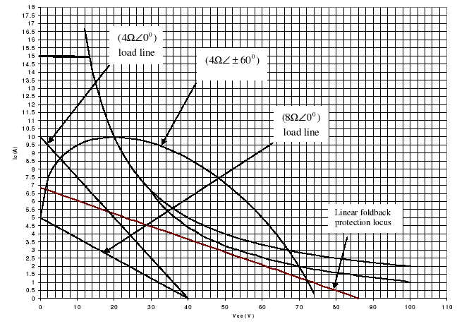

JensRasmussen said:
The load lines in the manual are absolute worst case. They allow 2xVcc Vce on the output.
There is no protection curcuit in the manual.......yet ;)
\Jens
Actually, your loadlines (e.g fig4-11) do not represent the worst-case 4ohm reactive load....This is an error i believe originated sometime in 1970-72WW.
Easy to prove: Just plot a 4ohm<60deg load line (an ellipse actually) and superimpose it on your fig 4-11....
You'll find it falls way beyond your 'worst-case' 4ohm projection...Try 4ohm<45deg as well...
see below:
mikeks,
Nice graph, what does it show?
Peak values, RMS values and what is the graph based on square waves or sine waves?
I have been looking for literature that describes how to make the graph at different impedance loads, but so far I have been unable to find anything else than the DC load lines I have already presented. There are plenty of application notes that mention the 45-degree load line as worst case, but none of the papers I have found actually explain how they arrive at a given graph.
If you have information, please post it…. I want to offer the best documentation that I can find. SO far I have used info found in Self’s and Sloan’s books.
\Jens
