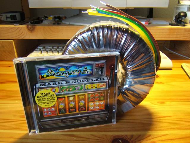

Very hefty nice looking tranny, Jens.

Hi Jacco,
I just love the way you always come up with some sort of explanation that involves cars 🙂
I just tested the amp in my “lab” with the new transformer
Rails idle = +-81V
Rails fully loaded with 8 ohms = 72V
Peak output into 8 ohm = 66V => 270W into 8 ohms, should be plenty
Have not tested into 4 ohm yes, I’m afraid to burn the load
\Jens
Rails idle = +-81V
\Jens
I should hope so !
Times 10 is enough to need re-decorating your new nest again shortly, i see the plaster already falling down from the ceiling.
That should put my hot ladies over the 200 line on 50vac transformers and some gained volts from 75 Vdc regulation.
Actually i am a flunked car mechanic.
I do not know any transistor sizes but i know bore and stroke of every Chevrolet engine, be it road, race or baja, by heart.
The 1000VA-er is a Plitron? i seem to see a rainbow on the label.
The Transformer is from www.el-supply.dk they import the transformers them selves. Im unsure of the brand, but the tracking of the two windings is ok (within 0.5V) and there is no hum from it.
I can however hear it when I play a sinewave at full power, it sings along, but so does the resistor load that I use. I guess that is difficult to get rid of mechanical noice when the transformer is pumping 500W.
\Jens
\Jens
