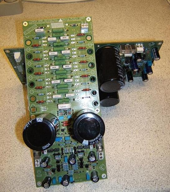

To all builders:
Change of value for R28 and R30, both must be 330 ohm.
This is only important if you run the amp above +-60V rails
The change is in the componentlist on the website now.
I am making a table with values for different rail voltages, it will be included in the manual that I'm working on.
Sorry for any trouble this may cause, I know that removing components from the PCB is hard work, so please be carefull when you perform the operation
\Jens

Hi Jacco,
Nope, my prototype is running at +-75V as we speak, but on a test supply.
I just made a calc that suggested that 330 ohm was better for higher voltages
I'm waiting for my 1000 VA 2x55V AC trafor, when it arrives I will make a short circuit test at see what happens

I have read the manual revision, Jens.
I figured weekend is J&J time.
And i am not the other J !!!!!!!!!!
The load line for the MJ15003/15004 on the 3 device version does point out how little the powerhandling of a device is worth.
I chose 0.22 Ohm emitter resistors instead of the 0.47 Ohm, or the original 0.33.
So i have to change R28/R30 anyway to activate the protection gear.
Setting it around 25 amps per device.
I am going to use an intelligent protection circuit that will activate the output relays depending on the product of Vce value and output current, with a delay of 10 mS.
Within the 10 mS its up to the Leach driver protection
