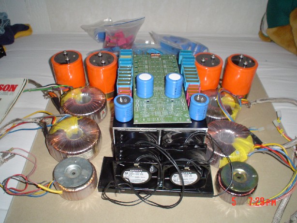

The extended leach boards have arrived.
Jens, these are the very best boards i have ever seen.
Anyone still waiting for your boards to arrive is in for a treat.
I do not desire to build another chassis for the Super Leach so i am going to build a universal one.
I decided to go full throttle on the extended leach.
Meaning:
i am placing the board on a heatsink, which will be mounted in a heatsink tunnel.
The tunnel will be U-shaped, welded from 10mm alloy plates.
The ampboard-heatsink module will slide in the U-channel, fastened on the sides with bolts.
The tunnel will have doubled dual-prop vents, two vents behind eachother, 4 vents per channel
dual-props you see with airplanes for noise reduction.
Cruiseships have Dutch Lips dual duct screws, for saving fuel and noise level reduction, like the Queen Elisabeth 2.
Doubling vents adds 3 dB, dualing two 80 mm 30 dB ventilators produce less noise than a single 120 mm type, with the same air flow volume.
Better even, the same flow through 0.44 of the 120mm area, which means 2.25 higher air speed.
Higher air speed means higher cooling rate.
I am aiming at a heatsink factor of 0.05.
Good enough for full class A with the extended leach, hopefully 200 watts.
The Super leach i am going to place on a similar heatsink, changing the two should be a matter of minutes.
I added a picture of the initial setup with one of your boards on top of two mirrored 250mm heatsinks.
The Orange caps are 100 Volt Siemens Long Lifes, the two small 50VA toroids for the front end powersupply.
The Blue's are Sprague 200 Volt models.
The pic is for a mono setup.

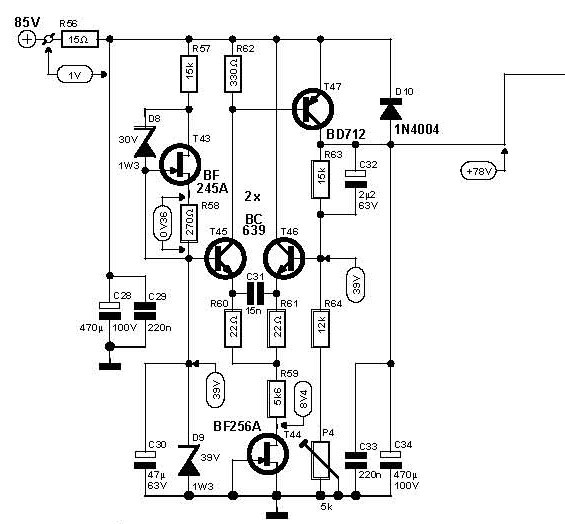

i decided to use the 300 watt/8 Giant2000 regulator for regulating the voltage on the front end of the extended Leach amp.
That amplifier used a stacked powersupply too, 15VDC on top of the 70Vdc main toroidal.
This circuit handled the voltage regulation for the entire front end including the driver section, the reason for using the BD712 that does well over 10 amps, 18 Max.
The 75 watt BD712 only has an Ft of 3 MHz.
I am going to swap that one for a faster Toshiba, or an IRF mosfet.
Basically i am going for at least 4 regulators for the front end.
For the regulator that handles the front end gain stages a 25 watt device will do as substitute for the BD712, 2SA968/2SC2238 or better.
For the regulator that does the driver stage the BD712 will be swapped for something with the same power capability or more.
Maybe a couple of them 2SA1302/3281 on a decent heatsink.

Jens, I looked at your homepage and the picture of the step response. Did you compare the input signal also? Was it totally "clean" or did you have a small overshoot there also? What I ment was that your amp may be better than the picture wants to show.

To Jacco : Using of faster transistors is unneccessary, 'cos output of regulator is bypased by C 33,34 which are " batery " of energy. Faster transistors can make problems at this possition.
Pavel,
you think the circuit is good as is, and good enough for regulating the Leach front stage?
I thought of emitting the caps, or placing a low value resistor between the emitter of T47 and the capacitors.

I mean that it will be OK. Inrush current is supressed by R 56, so you can't change anything 😎 .
Actually UpuPMaPavel, now that you mentioned it.
I was also considering exchanging the entrance filter for more extensive R-C's, and reducing R56 to half or 1/4th and increasing C30 accordingly.
I am doubling the regulators for separate regulation of front end and driver stages anyway.
I'll take your advice and use the circuit as is.
