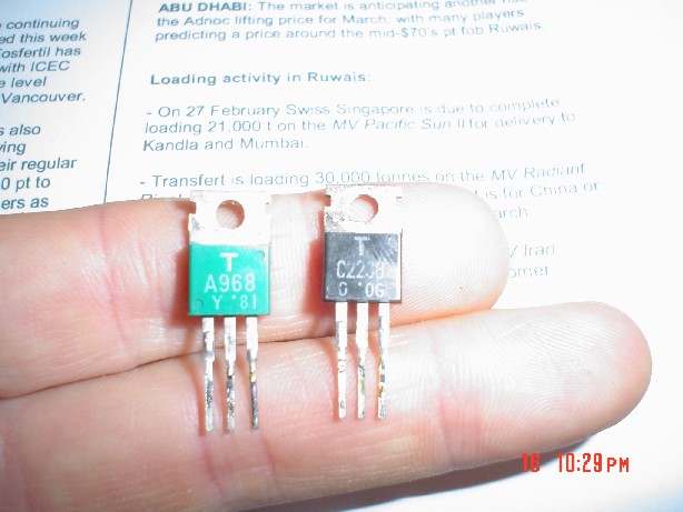

Is it believed that replacing the MJE transistors with something else will yielded an auditable improvement with out causing any problems? If so, dose anybody have any recommendations (something form digikey or mouser)? I could not even begin to guess what would even work in the circuit. Given the low cost of medium power transistors, testing at least one alternate type seem like a very practical thing to do, especially if they have the same pin out. I have been told by many different people that Zetex makes very good sounding transistors. If anyone has a recommendation that looks reasonable and is available from digikey of mouser I would be willing to try it out. However, at the rate I’m making progress it’s going to take me about 6 months just to get to the point where I can try them out. Leach says, on his web site, that the second stage dose contribute the most to the sound as it is where most of the voltage gain is done.
Leve
Leve
Joined 2002
My favorite medium power transistors: 2SC2238 and 2SA968.
25 watts, 180 volts, 1.5 amp max, 70< Hfe < 240, 100 mHz.
