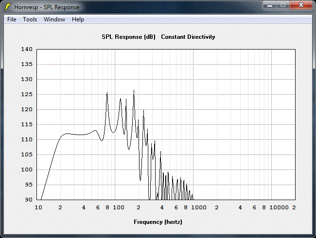

This is a great Tapped Horn build! :D I don't think I've seen the Frequency Response graph posted here. Does anyone have a link to it?
Also, is the speaker the Eminence Lab12 Generation II sub? Is there a Generation I, and if there is a Gen 1, are there any spec differences between the two? I'm getting conflicting information while Googling this subwoofer. Thanks for your time
"Gen I" was a prototype, and it was never sold. Here is the response curve for 100 watts input (the max I'd use for sine waves). For music, 300 watts
works just fine. This is a small TH for 18Hz, and requires some careful woodworking to prevent any leaks.

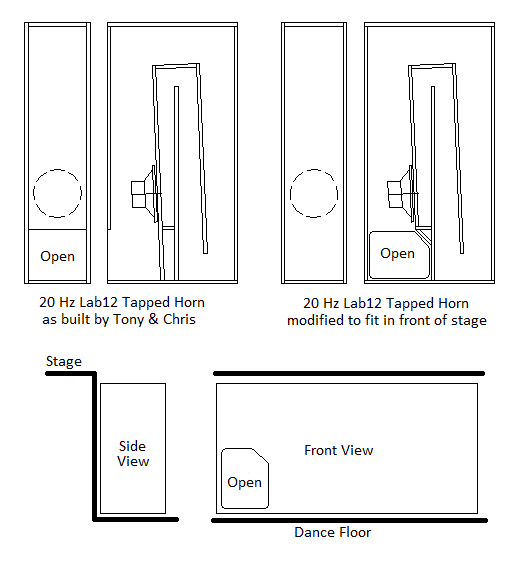

Consider alternate speaker mouth shown back about 10 posts. It can mount below/behind the video unit. Keep the
speaker coil away from the screen, it's not shielded.

If this cab is to be used under a loveseat, would you recommend the alternate design with the mouth facing up into the loveseat or the original design where the mouth would be facing parallel to the floor?
Also, regarding your alternate design, do you have dimensions for the mouth? Or is it important to just keep the mouth square footage the same as the original? Lastly, will this alternate design alter the frequency response? thanks much for your patience and time! :)
