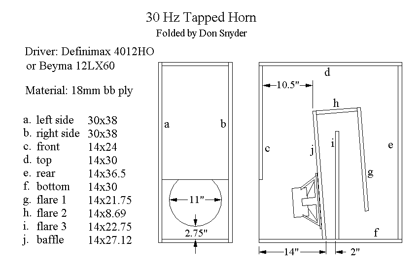

Lab12 - Tapped Horn
I left out "a. thru j. down the left side. Here's the fix.

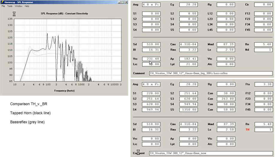

Hi joqi59,
After reading through the Visaton Forum threads I tried simulating the enclosures in question, and Hornresp will give responses similar to the responses shown in the anechoic chamber graphs. As noted before, it looks like the tapped horn used as a comparison standard is sub-optimum.
I'll attach a TH_v._BR comparison with a different tapped horn model. I believe this puts the tapped horn in a more appropriate light, even if the TIW 300 is not the ideal TH driver. To me the TH clearly outperforms the BR in a subwoofer application.
P.S.: I hope that layertone will have more information on his LAB12 build.
Last night while listening to the Fostex 168Sigma's, I felt the need for a sub to cover the most bottom end of the spectrum. I pulled out my 2 unused Lab12 drivers and began contemplating on a TH vs ELF sub. I have a intuitive notion that the TH would sound more 'natural' requiring little or no EQing, thus matching the tonal characteristics of the Fostex.
However, looking at Don's TH fold for the Lab12, a footprint of 30"x13" would have low SAF. Hence, I was wondering if I could ask here for help to increase the height and reduce the depth of the TH. Someone might have already done it and I may not know. Can someone please point out to such a fold, if it exists?

This is my first tapped horn build & also first build using the 3/4" Appleply (15 Ply's!!) Next one will have some braces for sure

Details of this plan was posted by Don

Don Snyder said:
It's great when a plan comes together ...
MaVo did the simulation, Chris8sirhC decided to build the first one, and I did the fold
for Chris. Now, Layertone has built one of the nicest Tapped Horns of this series.
Great job & pics,
Don

Re: TH_v._BR
tb46 said:
Hi joqi59,
