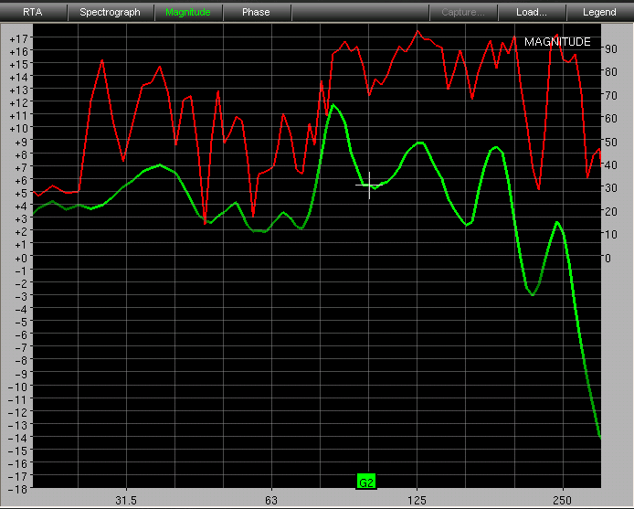

some measurements
i measured the one that me and chris (my brother) built:
i was using a behringer measurement mic plugged into a m audio mobile pre. Measurements were made using the signal generator in smaart
@GM - Yes, the same config as the opening post in this thread. Chris built two cabinets using OSB.
@CrazyTubax86 - Did you measure it outside (2Pi) or inside? Subjectively, how does it sound? Chris asked about extending
it, to port it thru a door. If L34 is extended no more than 8 inches it should work OK. Room effects overshadow everything at these
frequencys.

The sub was measured outside on the driveway. I was very surprised that it did not drop off much at all down low compared to what the response was simulated to be at 1pie or 1/2pie. It was basically flat to 20hz in full 2pie radiation (mouth was on the ground). It sounds awesome. It is so clean that you really have a hard time understanding how loud it is without a spl meter... or being able to hear it from over a block away as your drive up in your car while your brother is testing it out at low power.

Hi Chris,
Good to hear that you're happy with the fold. MaVo did a great job getting the sim to be as flat as it is. Layertone
tested his at 16 Hz, which was well below what I'd recomend (I wouldn't suggest pushing it much below 20Hz).
So far, no one has done any damping to smooth the 80-100 Hz area. Where are you crossing it over?
