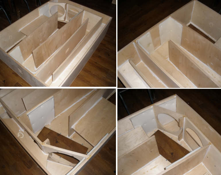

What angle for cut on bottom of piece J, on the original plans from page 1?...
Looking at the plans from page 1 of this thread, what is the angle for the mitre cut on the bottom of piece J, to make it sit at precisely the right inclination relative to the bottom piece F?...
Also, are pieces J, I and H joined at 90 degress, right angles, to each other, as it appears to the naked eye from the plans?...
Thanks guys!...
James
That's right ...
... anything not square is at 2.3 degrees. That includes j, h, and i as well as k. Tapped Horns require leak-proof construction.
Any leak will ruin the output, and once it's glued-up good luck finding the leaks. And yes ... if it looks square, it is square.
Make all the 13 inch cuts with one set-up of a well adjusted table saw, and they won't vary by more than 1/64 inch.

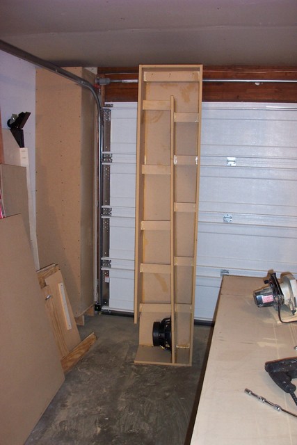

Stuffing, any general rules? Will have to have a new read, but bracing etc, I think there was a pic from someone who had better bracing etc. Is it worthwhile to do?? If I do, any general rules??

Maybe you could just put some in and leave it. I think you have a fair amount of EQ power and will probably roll off the top end. I wouldn't worry too much for trying things out, I might even get a bit lazy and leave out bracing. The bracing is a fair bit of extra effort, since it means accurate fitting. The angles make it worse. That kind of things drives me nuts! I can be meticulous, but the patience can get tested!

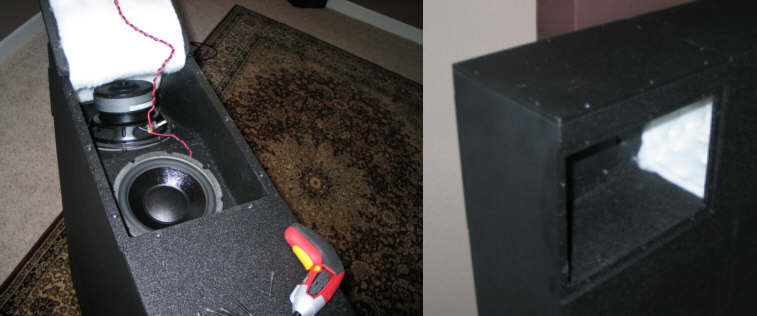

Terry, I'm not sure tapped horns are fully understood yet and I'm not completely up to speed on them so not the best one to answer. I've seen some measurements stuffed vs unstuffed and as you expect, the peaks get some damping. THs have things in common with transmission line, and they are stuffed for the same reason. Perhaps it's more common with TLs to use more stuffing as they usually are expected to run up higher.
You got me thinking about stuffing. I'm planning some horns (front loaded) and I was thinking about the idea of using stuffing to selectively absorb distortion products, ie the harmonics which are higher in frequency.
Stuffing tapped horns.
Hi Y'all,
Stuffing as in a transmission line does not work for tapped horns, their function depends on the interaction of the front and back waves.

Basically, a little around the drivers (throat area), in the horn corners and maybe around the mouth area is all it takes, and the amount seems to depend largely on experimenting, as simulation will take you only so far (pictures from AVS - Ricci).

Last quick one, 'stuffing'. The little pic lhad stuffing that looked white, so I assume not fibreglass. Just that white wadding from sewing stores?
stuffing
Hi Terry,
When you're done with the AVS thread try the collaborative tapped horn thread for some more light reading. 🙂
The stuffing in Post #75 looks like a thin, open-pore polyfoam, and in #76 some polyester batting.
Terry, it's only about 13" wide so bracing side to side might be a bit much - second thought, maybe not. Bracing along the length might help. Here's a pic I grabbed some time back from the big TH thread to give an idea what I mean. Stubby braces from each of the braces shown to the side walls would be how I'd try.
