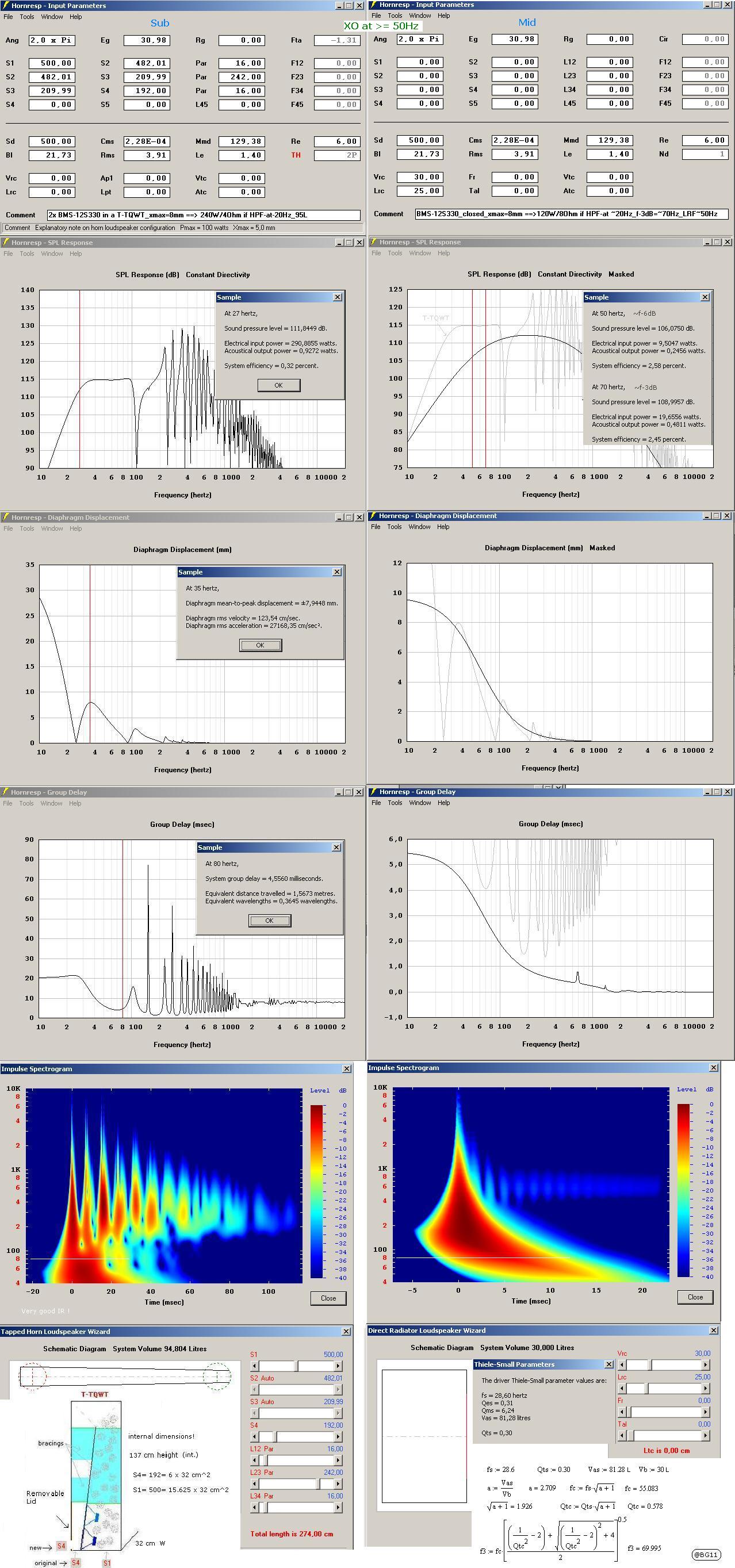

Hi, If you consider the MTH-30 using the BMS-12S330, you're leaving, IMO, Hi-Fi SQ for live PA Mid sound colorations/artifacts. See a simulated example using this driver in a system capable of THX levels and superior SQ:

Hi Andrew,
The first vertical column concerns a T-TQWT-sub and the second to a closed mid-bass box: suggested to be a part of a main speaker system.

The efficiency depends on the different specific system load impedance given as a function of the frequency in use : See the picture for more comparisons.

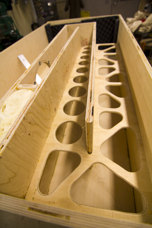

I'm using the lab12 and the 5.5 meter design by Don Snyder. So far I have the outside pieces cut, I also have the driver and all the wood, so this might be glued up by Friday. I was also thinking of using 1/2" subfloor for bracing.

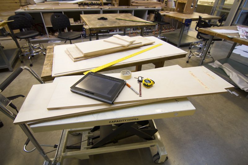

i'm about to build this i have the perfect amount of space under my TV for it and i have the lab 12. just figuring out a cut sheet since i didn't see one posted here. i'll post up pics in the process!
It took me two sheets of 5' x 5' x 3/4" baltic birch, 26" x 48" x 3/4" of underlay ply for the inner baffles and a chunk of 1/2" subfloor ply for bracing. If you use biscuits, the inside ones have to be layed out perfect or the side will not go on easily.
damn that bracing looks crazy! i didn't use any bracing on mine, i just used 3/4" mdf for the whole project.
