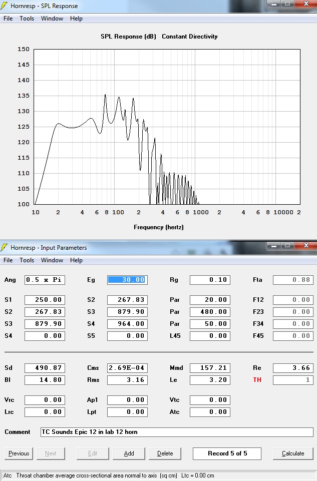

No more so than the Lab12. Not at a glance, it really 'wants' a lower tuned alignment down around 11 Hz based on Prof. Leach's math.
Here's what I get 'blowing up' a Prof. Leach alignment to the 'close enough' same net Vb, so import it into HR to fiddle with to see how it might can be adapted:

Hi nuconz,
When you look back at Hornresp listing in the first post, you'll see that Le is listed as 8mH. The nominal inductance for the LAB12 is 1.48mH. That means a series inductor has been added to smoothen the response. In practice that may not make much of a difference. The resistance of the inductor is added under Rg (e.g.: .1 Ohm for the supply cables, and .05 Ohm for every added mH of series inductor.)

The Lab12 has too soft a suspension and too low Fs. It's a good driver for the money, and available.
I'm trying to make sure I have the context correct. Is the above quote in reference to a different design? Or are we saying the Lab12 is not a good driver for the box shown in the very first post of this thread?

...a series inductor has been added to smoothen the response. In practice that may not make much of a difference.
Has anyone tried this design without the series inductor? It would be nice to leave it out if the inductor doesn't make a significant difference in actual practice.
My last observation... I plotted the cross sectional area versus the path length. It seems to me the very first section (from the throat through to the first 180 degree bend) is just a little bit off, being larger than I think it ought to be. Is this intentional, simply a compromise of the design, or a mistake in my calculations? For what it's worth, the rest of the folding seems to have a very consistent expansion throughout all the folds.
