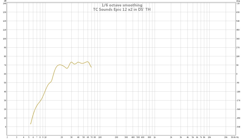

After spending a couple of days fussing with the MiniDSP, here's my response at the MLP.
SPL isn't calibrated anywhere near correctly, but I guess I'd call the volume I recorded this at "pretty loud".
Digs down to 17-18ish...love it!
Drops at 40 dB per octave from 20 Hz, but that is some pants flapping response.
It's got a little help dropping off quick, I have the HPF set at 15 cycles..which I may change after some experimentation. I'm still not entirely convinced that even the 1812 overture will get me to xmech unless I get really abusive with the volume.

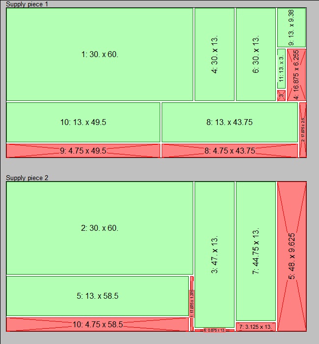

Does anyone have a cutlist for the Lab 12 tapped horn on the first post of this thread? I have been searching for days and can not, for the life of me find it. If anyone has one could you please post it. Thanks in advance, Bill
By far the easiest way is to use this:
Cut List
I messed with it this morning and came up with what I've attached. This is for MDF or wood where you can ignore the grain direction.

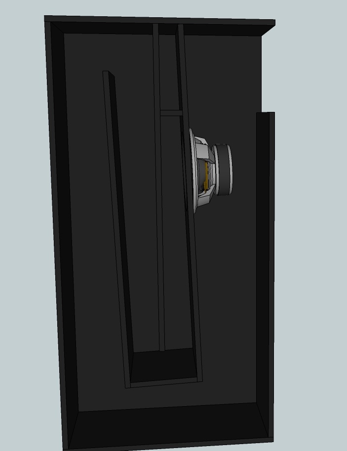

After much searching, I found this design as almost a perfect match for what I'm looking to do.
I'm planning on keeping this behind my couch as it will be well hidden, and good for a shelf when not cranked up too loud. With that in mind, I have some newbie questions:
1) Moving the opening so that it fires straight out (From panel C "Front" to panel F "Bottom) and having the enclosure rest on what used to be the rear wouldn't have a negative impact, correct?
2) Should I plan on mounting a plate amp (say the Bash 300) somewhere on the main enclosure, building a separate addition to house the plate amp, or getting a stand-alone amp?
I recently got into DIY speakers with the Tritrix TL mains and am adding a tritrix center and MT surrounds. This sub, although large, seems like a great value and great addition to my setup.
Thanks for the help!

It's a monster, I'm sure you'll love it. Imo, there wouldn't be a problem relocating the mouth as you've suggested. Resting on the rear puts the driver facing down. The driver I used can work like this, however I haven't checked the Lab 12 to know what it's sag % is to know if there would be any adverse effects.
Thanks!
So the Epic 12 will work, how much power are you you sending to it? Would the bash 300 be too large/small?
