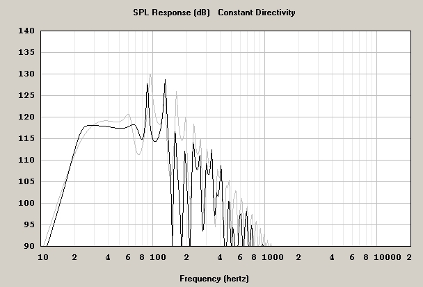

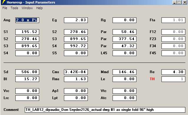

I took my drawing of Don's LAB12 TH design, and stretched it into a single fold, then I chopped it off to 96", and readjusted the parts to fit with a single taper. This should get you started.

Thank you very much Oliver for taking time off and putting in the extra effort to do the sims , drawings and sheet cuts. So this will take 2 sheets and will still require the PE Inductor. -3db may be around 23Hz but this also seems to take the max SPL up by a couple of decibels. Any comments? Thank you, once again.

Just to clarify, if a rectangular cross-section horn segment has two parallel straight walls and two non-parallel straight walls, then the actual area expansion will be parabolic not conical. It is therefore more accurate to specify Par rather than Con in this case.

I think you got it, and yes, it will still need the inductor. This may be a nice alternative for people looking for a different form factor. It's also an even easier build.

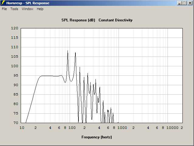

It also looks like the single fold has a wider passband and flatter frequency response.
Although I suspect that allot of the "clutter" and wild swings in frequency response that Hrsp. shows (in the SPL graphs) in reality get damped out either mechanically or by damping material physically added to the transmission line.
Single fold shown in bold, multiple fold shown in backround, both @ 100W (20.71 V) and 1.0 Pi

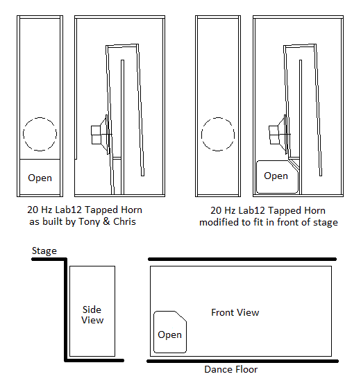

Everybody - This is an old design, with the SIM by MaVo. It was the first design to go below 20 Hz, and it works well for Home Theater.
For those who want to move the mouth, I suggest this:

Don,
I'm fairly new to the DIY speaker / subwoofer thing. If I move the mouth as you suggest, it will fire directly into a couch in the placement I am thinking of using. Is there not enough area to move the mouth straight out? Is firing into a couch ok?
I'll be using this 90% HT and 10% music. I notice you said 300w for music would be fine but only 100w for sine waves. Would 100w be enough for reasonable listening levels in a HT setting?

End open? No problem!
Hi Andrew - Should work exactly the same as the original. Room effects are
something I can't predict, since the room dimensions and the wavelength
are nearly the same.
Hi AVERYRM - For home use, 100 Watts is overkill. Tom Danley has sold some
kits that go lower, but this is almost as good for much less money.
