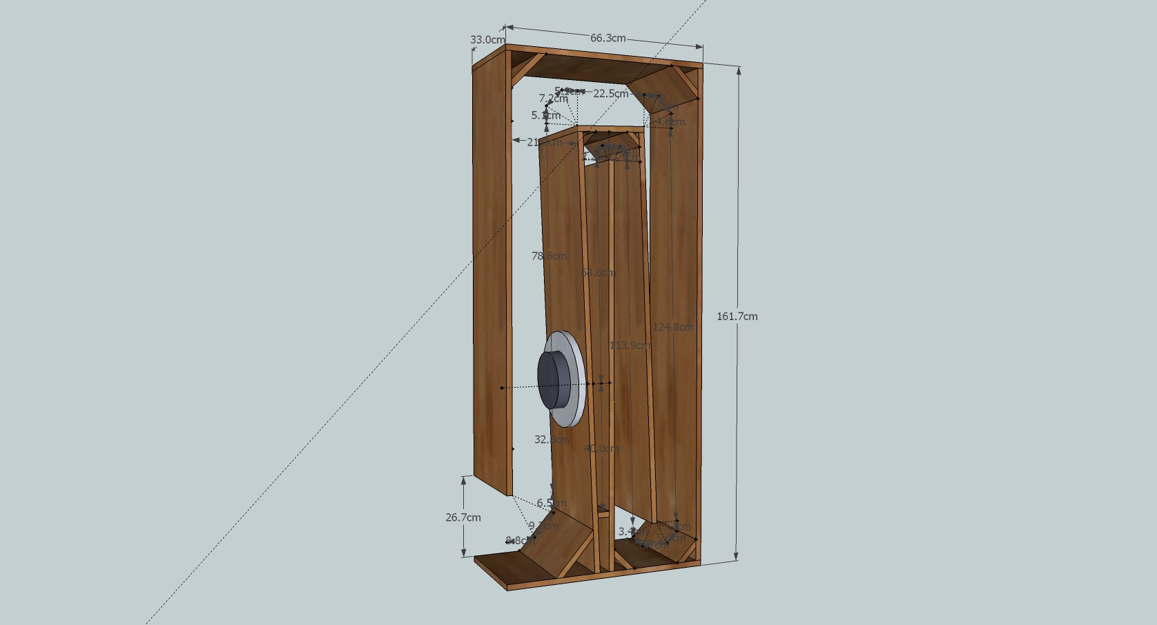

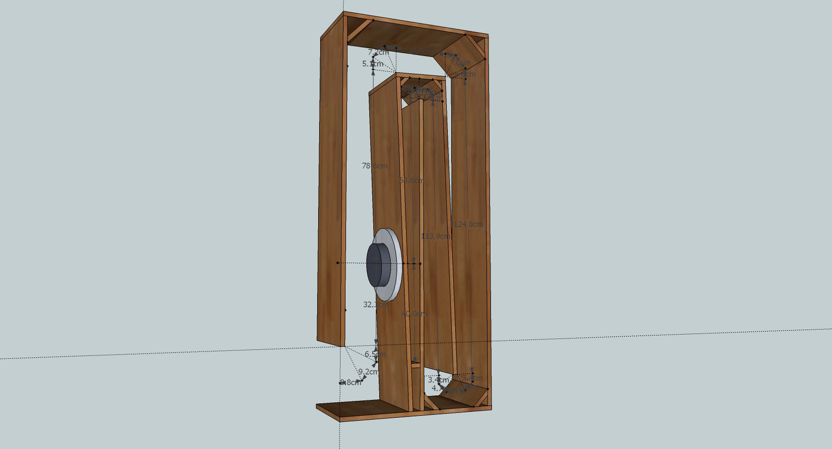

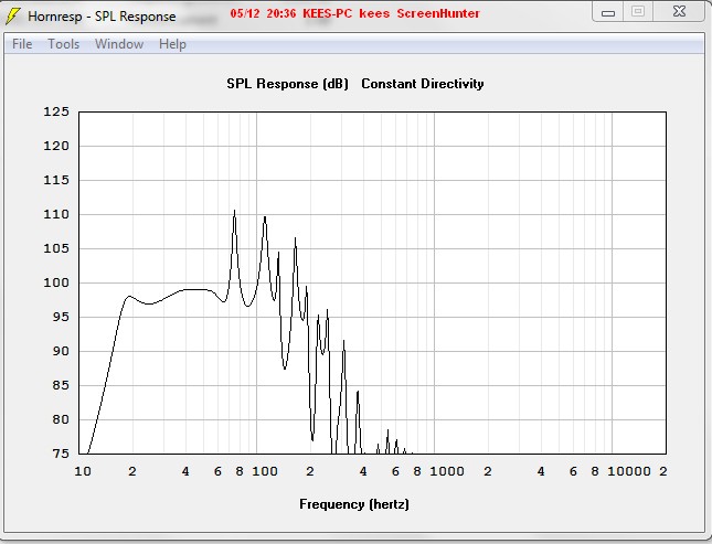

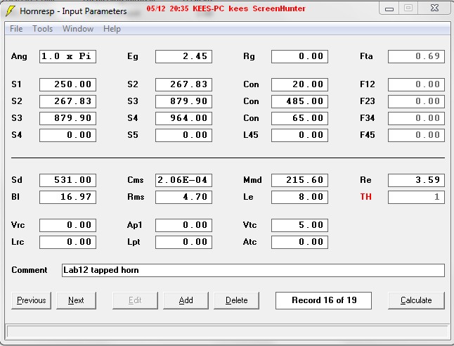

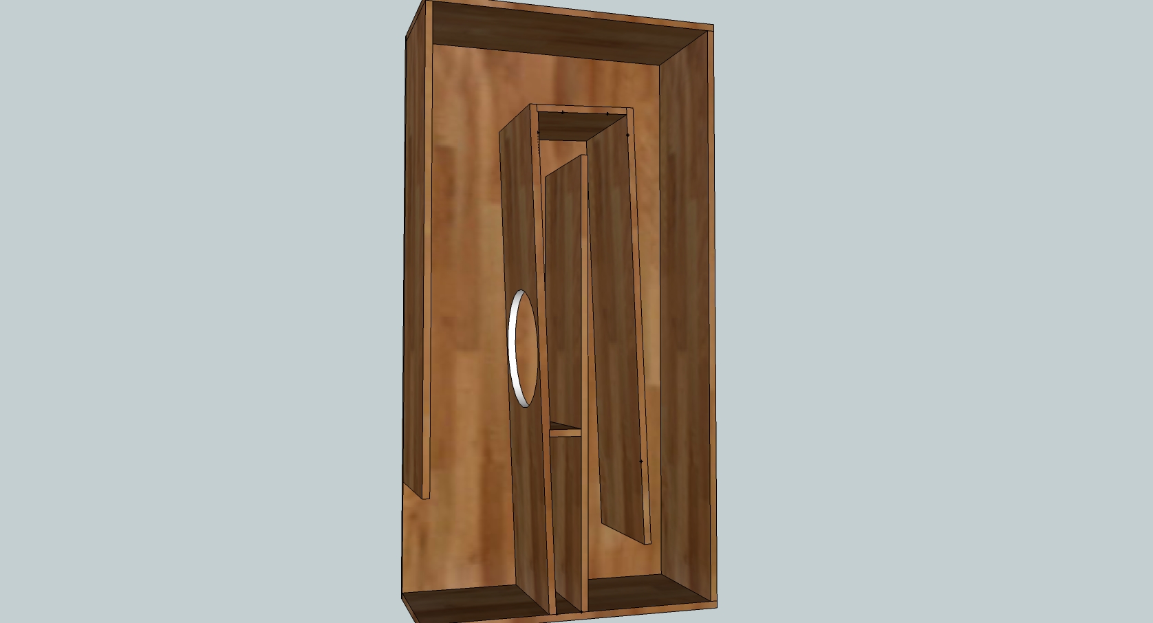

Have it changed for the infinity 1260W woofer.
see sketch.
regards kees

I did make some errors, so I have to drawn again, the box will not be much different of size.
I did see also just in hornresp that it can a lot better also, with smaller coil.
keep follow.
i downloaded the .zip file into sketchup and found no dimensions, that's why i asked about the dimensions.
smaller coil? do you mean an inductor in the circuit? in series with the woofer?

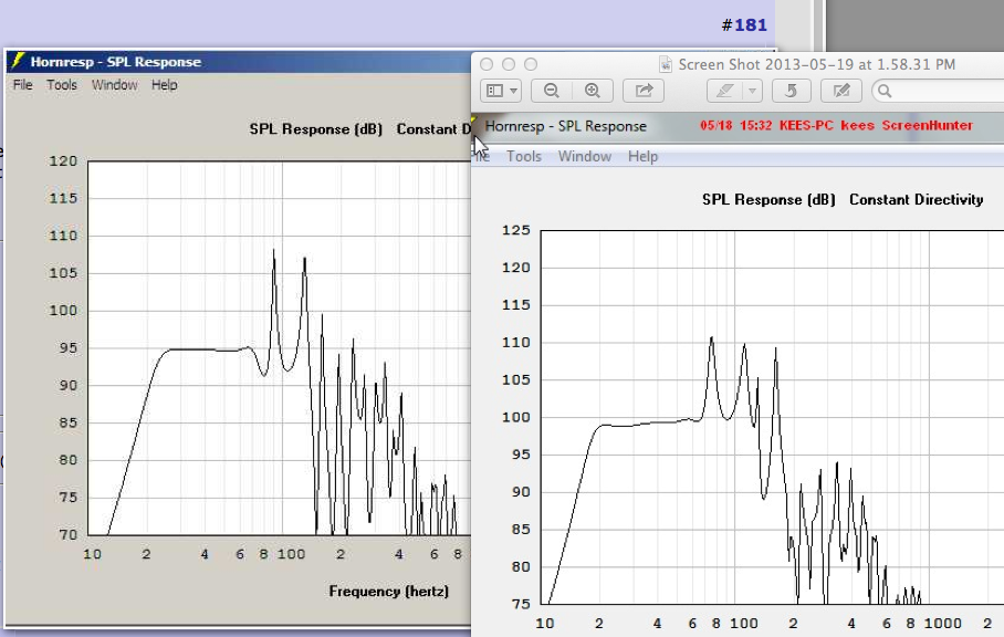

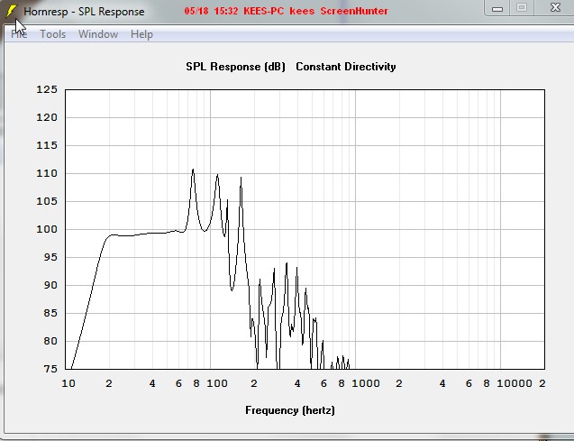

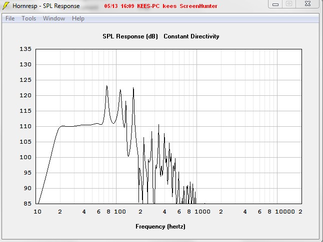

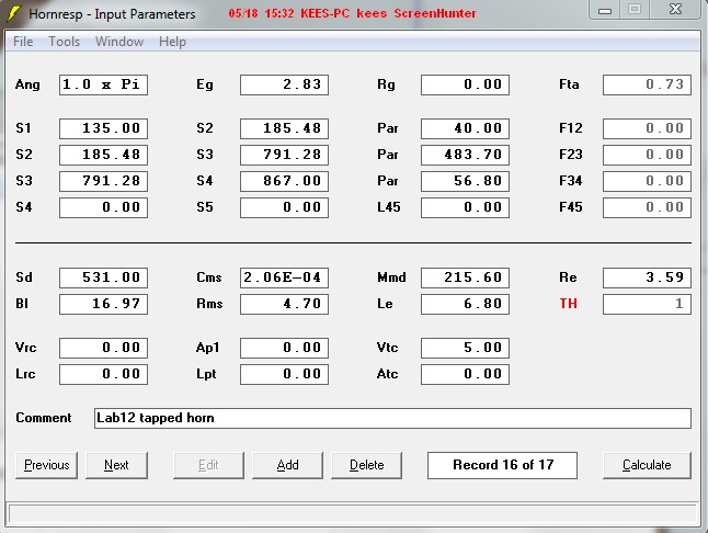

Hi All The Tapped horn is ready, box is folded and very precise also.
nice graph.
good luck with building.
kees

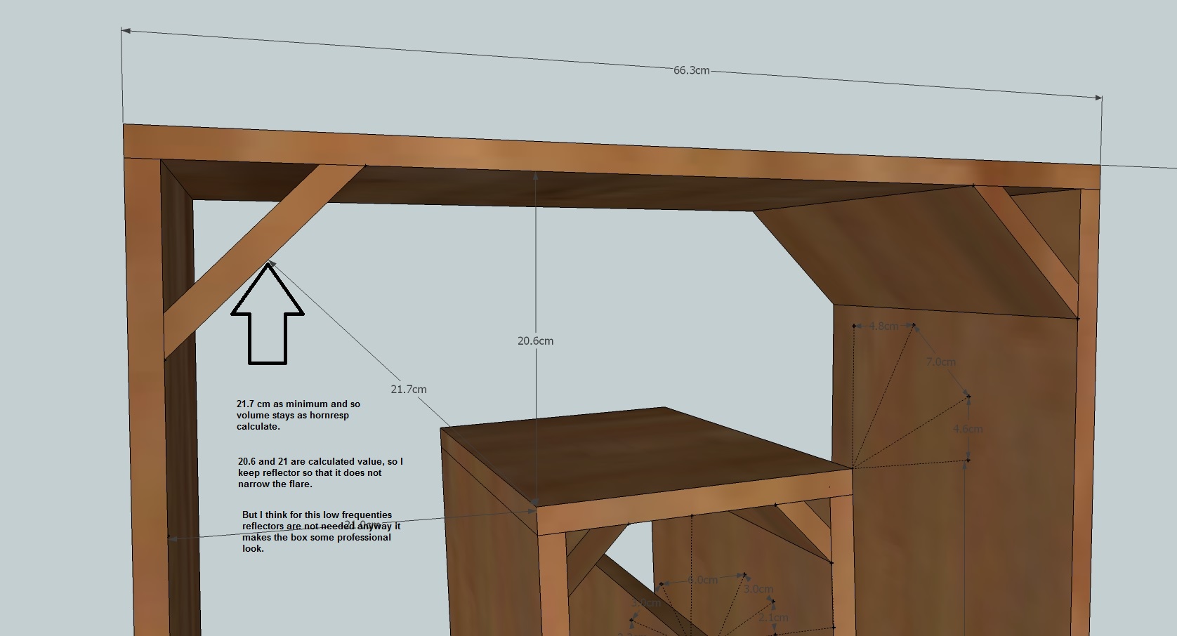

I have measure the corner volume, the reflectors smallest part is some bigger then needed so it wil not reduce the volume. the same with folding i did step by step measure the height
in the foldings a la hornresp output, and so the panel has automatic correct placement. I did start with the volvotreters folding scheme and then work out the proper length.
But I was forgotten the conus correction, it has to be done, I did not now.
regards
If you have an expansion from the 20.6 just before the corner to 21 just after the corner, then you should continue that expansion smoothly (in comparison to the wavelengths) through the corner.
We have seen from earlier experiment that a throttle has a disproportionate effect if implemented in the wave route. Similarly a short and small expansion that returns to the normal area has a lesser effect, much less it seems.
Using that evidence, then the minimum width in the route around the corner must be >=20.8, at half way around.
Smaller will appear as a throttle, whereas bigger should have a minimal effect.
But at the wavelengths we are handling, does the addition of the corner corrector give a measurable, or audible improvement? Or does it just look "right"?
I recall one of our experts stating that a bass horn could have parallel sections (no expansion) that "stepped" up the area, in discrete stages from throat to mouth and it would perform just the same as a smoothly expanded horn shape. Can someone remember who and exactly what was stated?
Hi
The dimensions are not the same, I did need to do different for better respons, in picture is
the dimensions given, or download the sketchup zip file.
I need to correct the tapped horn because I have not correct the conus volume, Now I don,t now
exactly how to do this, some make a panel, others do shifting S2 to the edge of the woofer making
S1 bigger etc, but if someone can explane how to do this best i like it to hear, the conus volume of
the woofer is 2.3712 liter 23712 cc.
regards
kees
