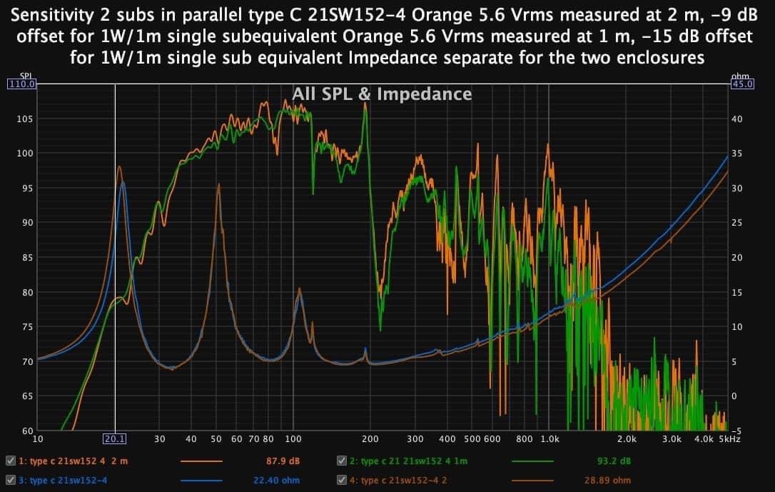

Thanks David. There’s a few resonances colliding in that akward area in these. Always intersting to try and figure out what’s causing what in there

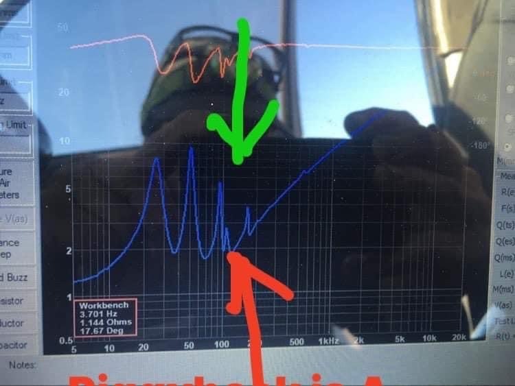

For sub design I think that up to 200hz is more than adequate , when you apply a BW 4th order LP @100Hz all the nasty resonances got shaved up but you can still see some stuff up to around 200 sneaking in , according to Mr Weldz you can hear those "undesirable" resonances.
Unless is a Bose style 3:1 designed TL (quoting Mr Weldz here)
But I guess everything is subjective

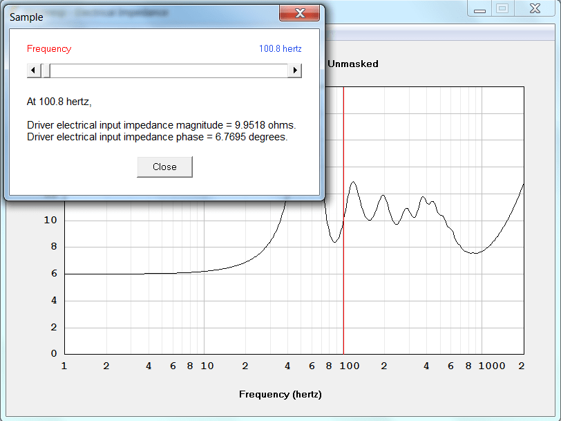

The resolution of the Hornresp charts is fixed at 533 frequency points between 10Hz and 20kHz, which will to some extent limit the degree to which things can be discerned.
I should have perhaps mentioned that if the Sample tool is used however, it possible to check values at 0.1 Hz intervals when the frequency range is set to 1 - 2000 Hz, and at 1 Hz intervals when the range is set to 10 - 20000 Hz :).

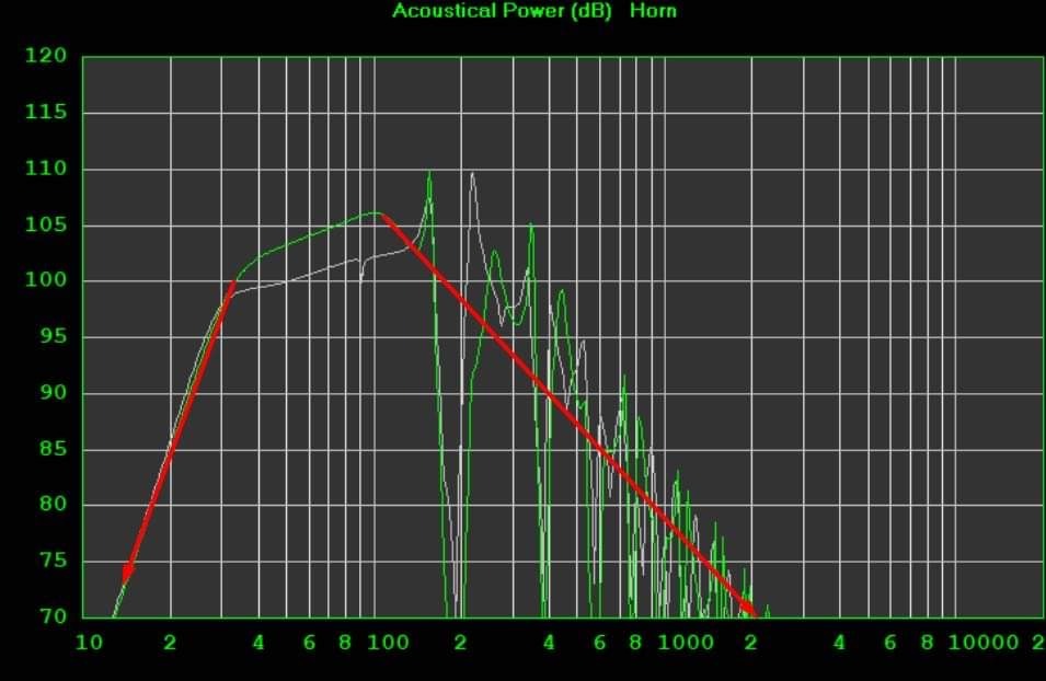

Aligning the resonators @ 3:1 is similar to offsetting a driver @1/3. Remove the cancellation and manage the 3/4 resonance it proceeds?
Reactions: 1 user
