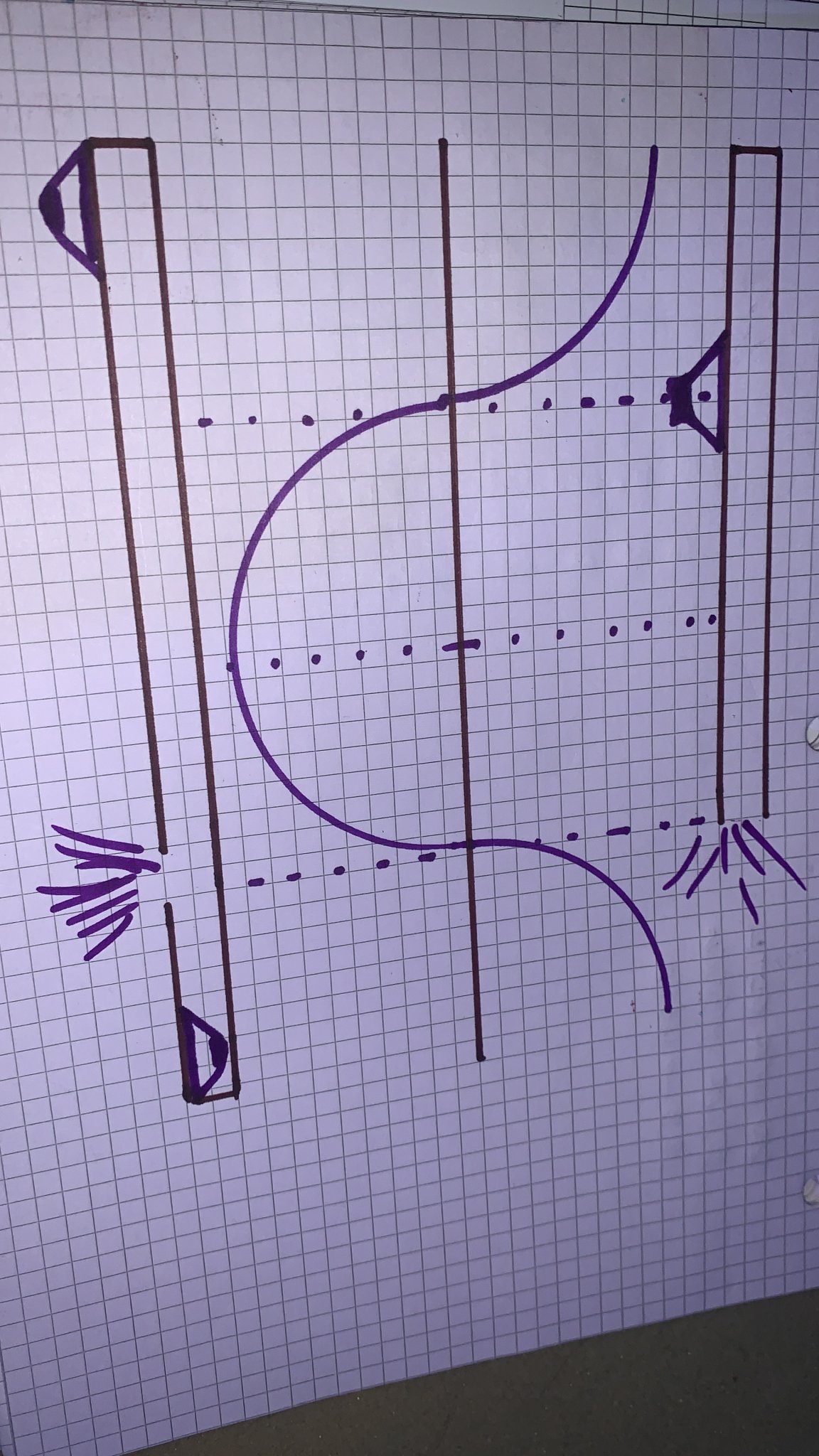

Hadn't really given it any thought in that 'we' never came up with this type of alignment per se; 'we' just experimented with corner loaded full room height pipes (0.354 or 0.25 pi space?, either way 'mucho' wide BW gain!) with drivers at each end and trying different 3rd driver options (4th ones 'muddied' it up) along its length, eventually creating a rather surprisingly simple/'dirt' cheap ('freebie' drivers/horns from all the mono radios & HIFI consoles junked for stereo) 'FR' 'infinite' line array. Note that this was in an era of rather/very lossy rooms down here in the Deep South where in only the relatively wealthy had well sealed rooms, full house A/C and being PP tube driven, variable DF bass/treble tone controls.

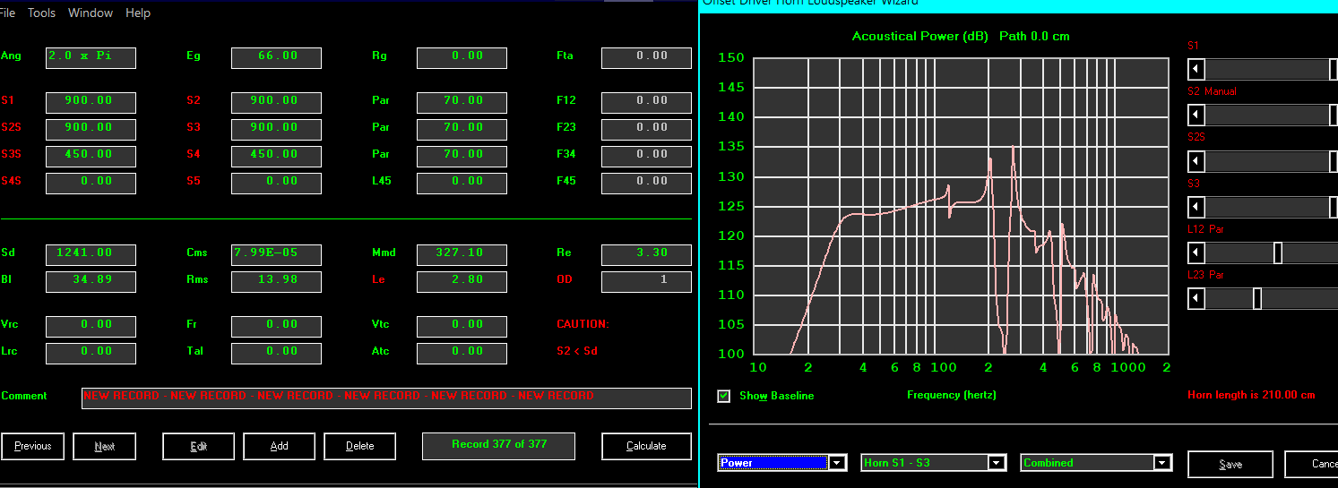

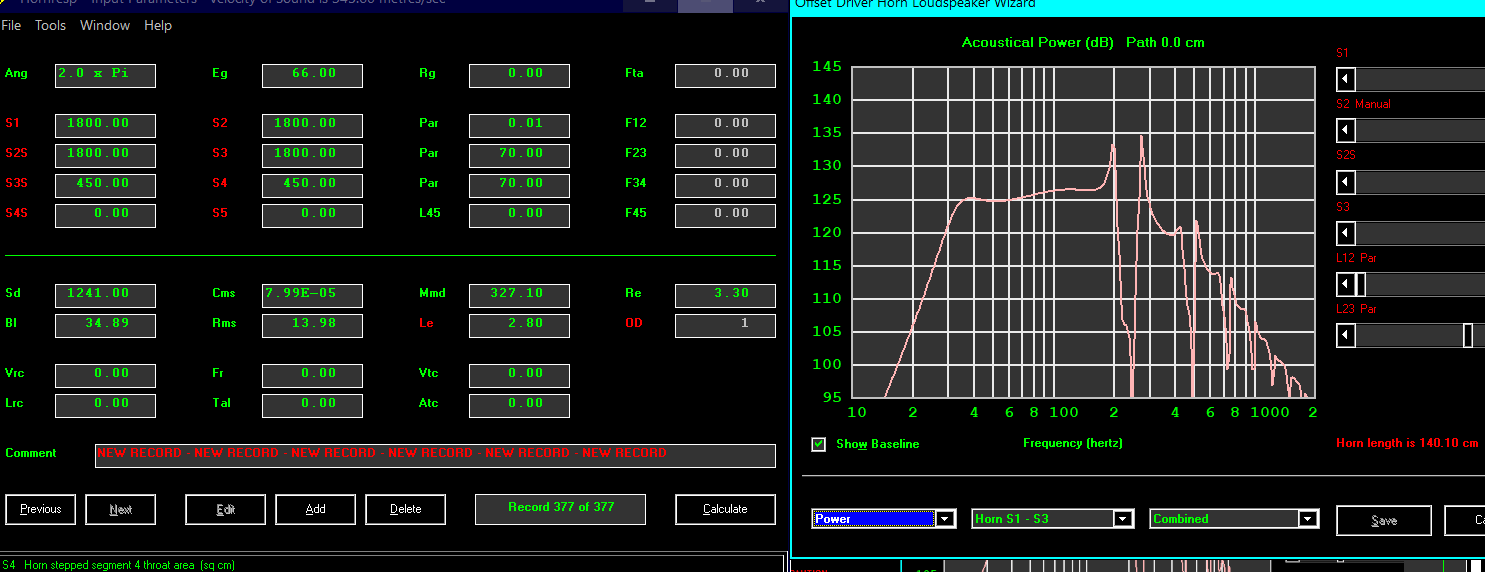

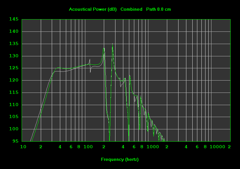

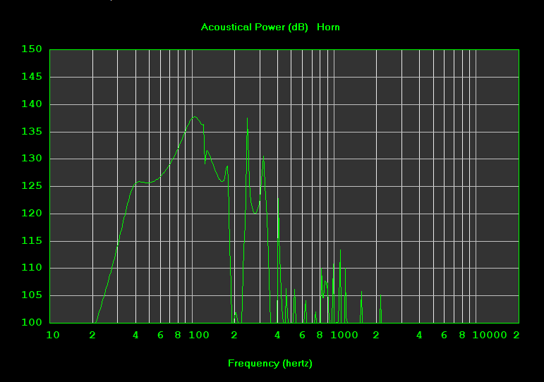

Without doing any comparison sims, seems like the extra section would yield a wider HF BW, overall increased damping.
ID = 54.10
Comment = NEW RECORD - NEW RECORD - NEW RECORD - NEW RECORD - NEW RECORD - NEW RECORD
|RADIATION, SOURCE AND MOUTH PARAMETER VALUES:
Ang = 2.0 x Pi
Eg = 66.00
Rg = 0.00
Fta = 0.00
|HORN PARAMETER VALUES:
S1 = 1800.00
S2 = 1800.00
Par = 0.01
F12 = 0.00
S2S = 1800.00
S3 = 1800.00
Par = 70.00
F23 = 0.00
S3S = 450.00
S4 = 450.00
Par = 70.00
F34 = 0.00
S4S = 0.00
S5 = 0.00
L45 = 0.00
F45 = 0.00
|TRADITIONAL DRIVER PARAMETER VALUES:
Sd = 1241.00
Bl = 34.89
Cms = 7.99E-05
Rms = 13.98
Mmd = 327.10
Le = 2.80
Re = 3.30
OD = 1
|ADVANCED DRIVER PARAMETER VALUES FOR SEMI-INDUCTANCE MODEL:
Re' = 0.00
Leb = 0.00
Le = 0.00
Ke = 0.00
Rss = 0.00
|ADVANCED DRIVER PARAMETER VALUES FOR FREQUENCY-DEPENDENT DAMPING MODEL:
Rms = 0.00
Ams = 0.00
|PASSIVE RADIATOR PARAMETER VALUE:
Added Mass = 0.00
|CHAMBER PARAMETER VALUES:
Vrc = 0.00
Lrc = 0.00
Fr = 0.00
Tal = 0.00
Vtc = 0.00
Atc = 0.00
Acoustic Path Length = 0.0
|MAXIMUM SPL PARAMETER VALUES:
Pamp = 100
Vamp = 25
Iamp = 4
Pmax = 1700
Xmax = 16.5
Maximum SPL Setting = 3
|ABSORBENT FILLING MATERIAL PARAMETER VALUES:
Fr1 = 0.00
Fr2 = 0.00
Fr3 = 0.00
Fr4 = 0.00
Tal1 = 100
Tal2 = 100
Tal3 = 100
Tal4 = 100
|ACTIVE BAND PASS FILTER PARAMETER VALUES:
High Pass Frequency = 0
High Pass Slope = 1
Low Pass Frequency = 0
Low Pass Slope = 1
Butterworth High Pass Order = 1
Butterworth Low Pass Order = 1
Linkwitz-Riley High Pass Order = 2
Linkwitz-Riley Low Pass Order = 2
Bessel High Pass Order = 1
Bessel Low Pass Order = 1
2nd Order High Pass Q = 0.5
2nd Order Low Pass Q = 0.5
4th Order High Pass Q = 0.5
4th Order Low Pass Q = 0.5
Active Filter Alignment = 1
Active Filter On / Off Switch = 1
|PASSIVE FILTER PARAMETER VALUES:
Series / Parallel 1 = S
Series / Parallel 2 = S
Series / Parallel 3 = S
Series / Parallel 4 = S
|EQUALISER FILTER PARAMETER VALUES:
Band 1 Frequency = 0
Band 1 Q Factor = 0.01
Band 1 Gain = 0.0
Band 1 Type = -1
Band 2 Frequency = 0
Band 2 Q Factor = 0.01
Band 2 Gain = 0.0
Band 2 Type = -1
Band 3 Frequency = 0
Band 3 Q Factor = 0.01
Band 3 Gain = 0.0
Band 3 Type = -1
Band 4 Frequency = 0
Band 4 Q Factor = 0.01
Band 4 Gain = 0.0
Band 4 Type = -1
Band 5 Frequency = 0
Band 5 Q Factor = 0.01
Band 5 Gain = 0.0
Band 5 Type = -1
Band 6 Frequency = 0
Band 6 Q Factor = 0.01
Band 6 Gain = 0.0
Band 6 Type = -1
|STATUS FLAGS:
Auto Path Flag = 0
Lossy Inductance Model Flag = 1
Semi-Inductance Model Flag = 0
Damping Model Flag = 0
Closed Mouth Flag = 0
Continuous Flag = 0
|OTHER SETTINGS:
Filter Type Index = 0
Filter Input Index = 0
Filter Output Index = 0
Filter Type = 1
MEH Configuration = 0
ME Amplifier Polarity Value = 1

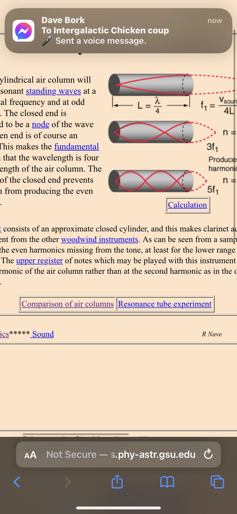

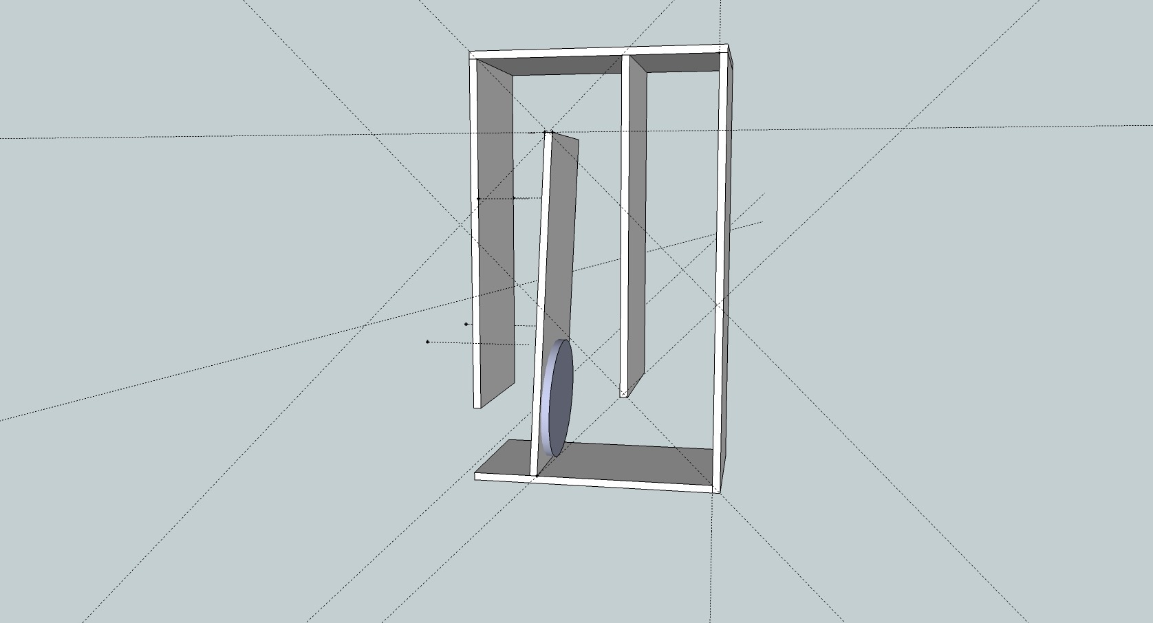

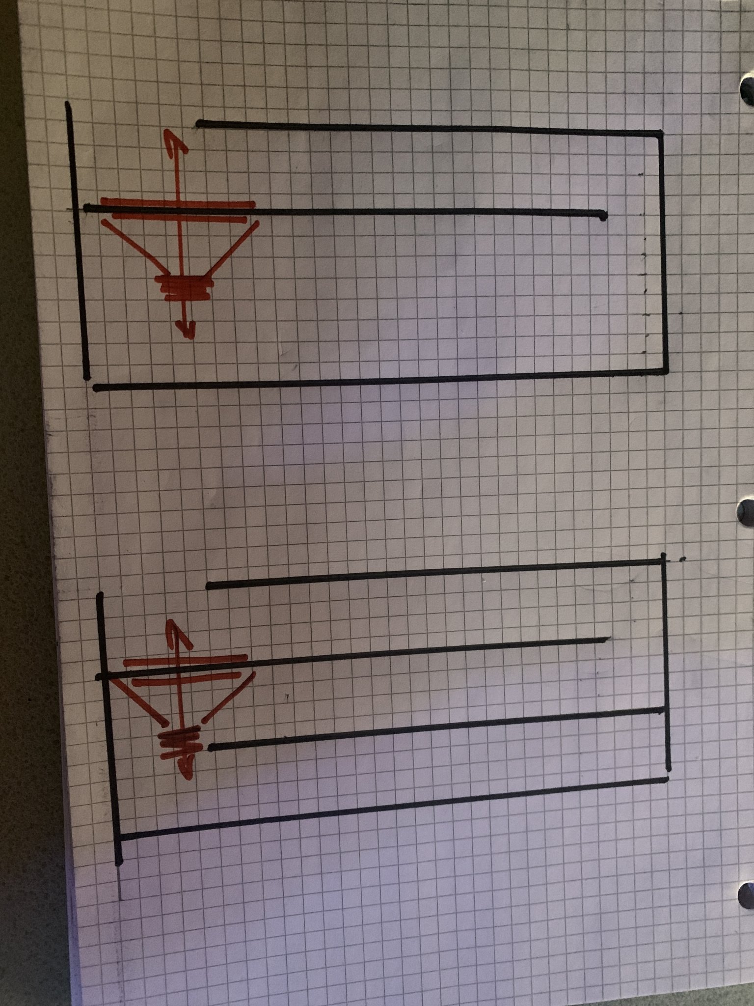

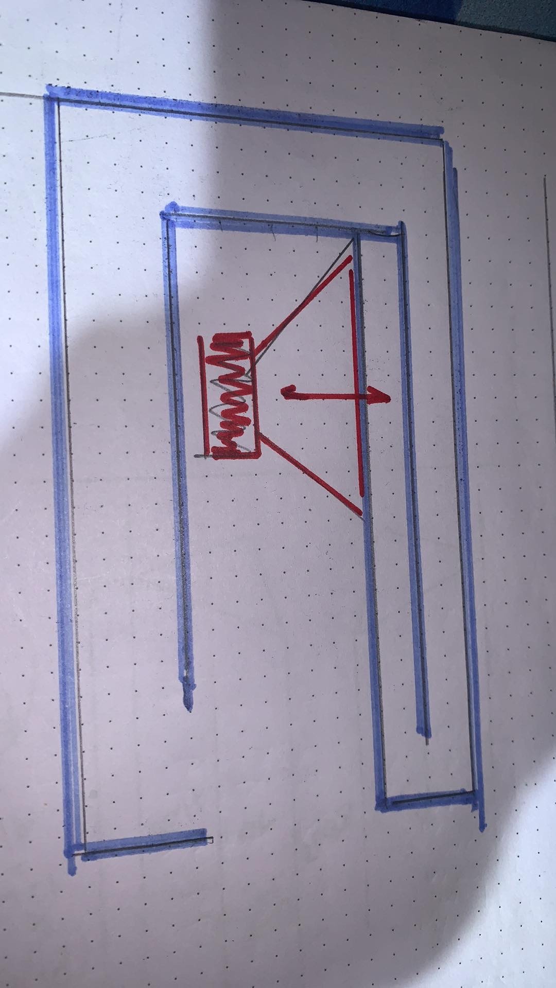

Isn’t it still ‘1/4 wave’ except the affective ‘shape’ of the ‘resonator’ has a stepped reduction in it?
if I put it in a generic sim of VRc/Lrc and ap/Lpt and I retain the exact same ‘Volume’, but drastically reduce ‘LRC’ ….
(don’t change anything else ) …. See what I mean?
I thought 1/4 wave equals some type of bandpass enclosure where the speaker is mounted inside the box?

1/4 wave? Land on a resonance in phase at velocity max or piggy back it in parallel. But in the case of ‘paraflex’ be careful 🤮🙈🤔. If misaligned that sh!t sounds weird (at best), especially if it starts ringing . Maybe the ‘devastator’ isn’t so finicky ?
I dont understand how a ‘TH’ is suppose to sound ‘better’ when it’s just gathering all those 1/4 wave resonances together and abbreviating the useful part of bandwidth or polluting it up top with midbass funk?
or maybe even worse, adding a random resonator in parallel to further booger that up?
Bandpass systems (Ok, bandpass systems that use Helmholtz resonators to limit the passband because technically every subwoofer build is a bandpass design), like other systems, have their advantages and their disadvantages. Their main advantage IMO is the acoustic filtering provided by the vents. The disadvantage is the dynamic compression that can result because of the use of said vents for ALL of their output. And once you start using vents large enough to minimize that compression, you're into 1/4 wave territory, and out of band resonances become more pronounced, limiting the distortion-reducing effect. A TH is basically an example of a 6th order series-tuned BP taken to its logical limit, the result being little compression caused by the design, but pretty significant out of band resonance effects.
My first ‘parallel’ qw pipe was an epic fail (the ‘one note wonder’ wast even a ‘subwoofer’ freq 🙈and the car audio driver ciuldnt wait to go nuts at that sloppy area of resonance .I thought 1/4 wave equals some type of bandpass enclosure where the speaker is mounted inside the box?

later on i would build these as 3:1 resonators (bose) and everything became infinitely better

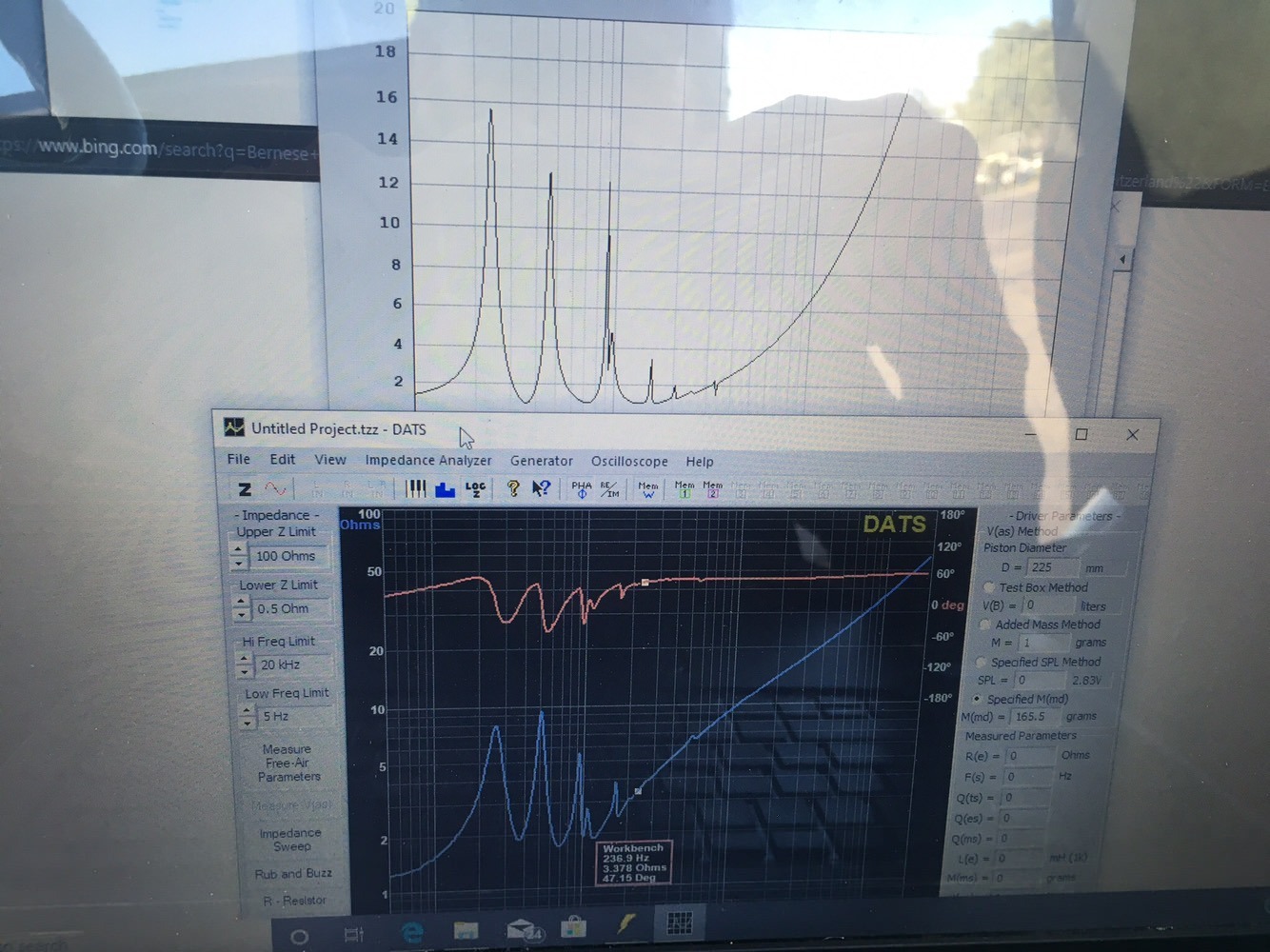

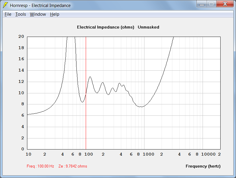

I wish I could decipher the impedance plot in that areaMy first ‘parallel’ qw pipe was an epic fail (the ‘one note wonder’ wast even a ‘subwoofer’ freq 🙈and the car audio driver ciuldnt wait to go nuts at that sloppy area of resonance .
Not sure what you mean by the above, or if the following helps, but the range on the Hornresp impedance chart can be changed if required. The data can also exported for even closer examination if necessary.
