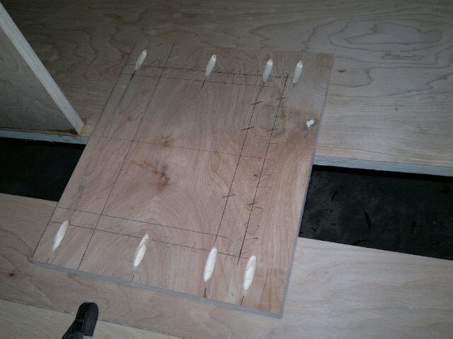

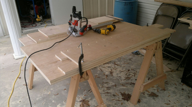

I built a Lab 12 tapped horn like the one on the first page on the lab 12 thread. Someone built a single folded one on post 181. I need another one with a single fold, but that one is shorter. Is there a single fold that matches the original one in length? Please help a brother out. I want two Lab 12s in my living room. Bill
Lab 12 build

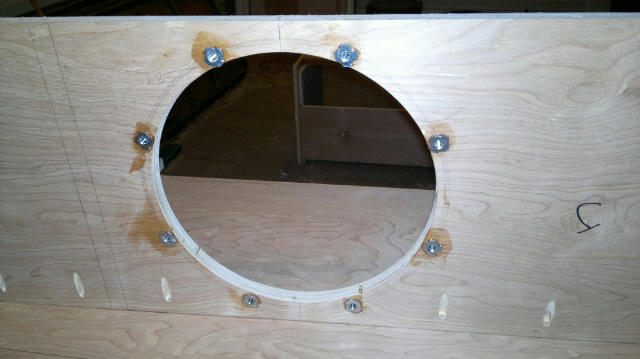

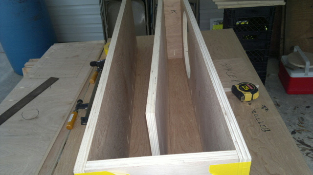

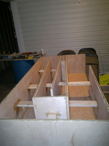

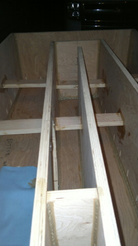

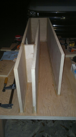

I want to show you my Lab 12 build I did this winter. MY garage was full so I did it under the carport. I love it. Would like to build one with one fold so I can set it next to my fireplace. Anyone willing to help me with a single fold to match the original? Thanks, Bill

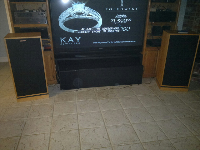

I built two when I did mine 🙂
I'll build two again if I ever rebuild them. Whenever I build subs, it's always a pair. OCD maybe, but I need symmetry.
I want to show you my Lab 12 build I did this winter. MY garage was full so I did it under the carport. Thanks, Bill
Nice build!

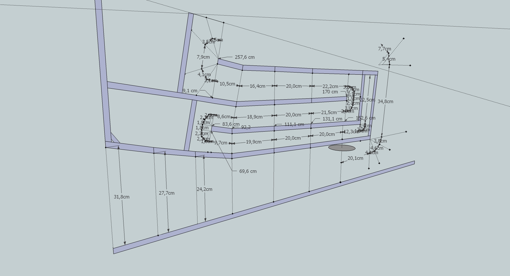

Symmetry is not really needed for box below 100 hz because ears dont have ability to find the source for such low frequenties.

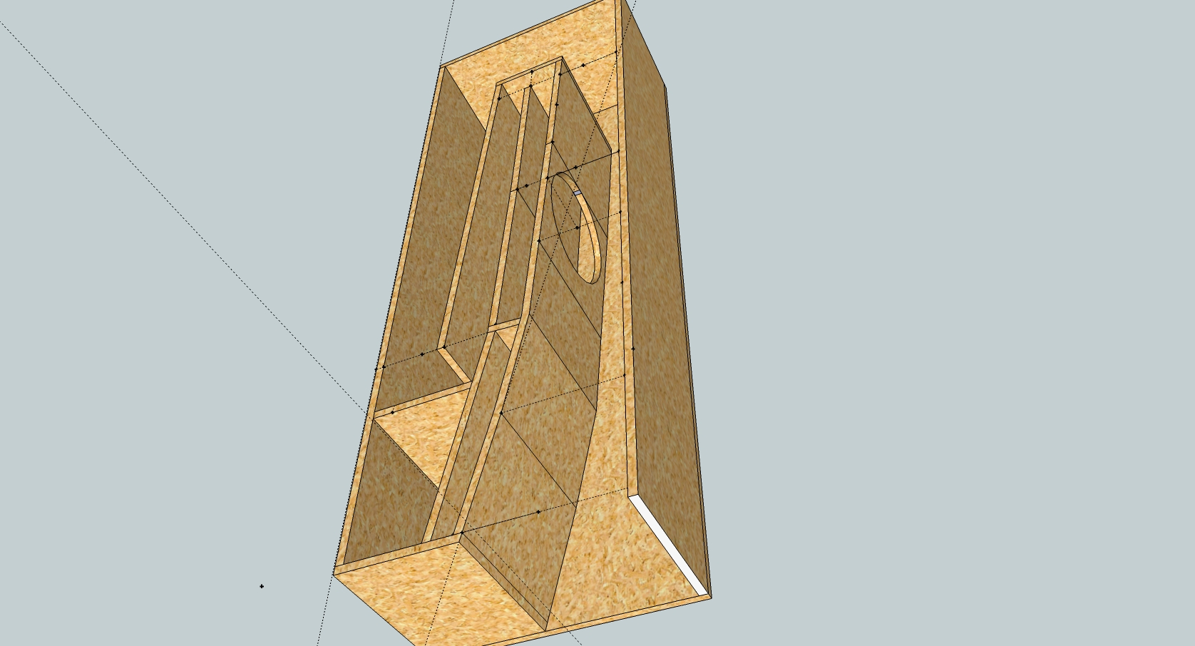

You can make a double fold with volvotreter folding scheme, and then fine tune length.

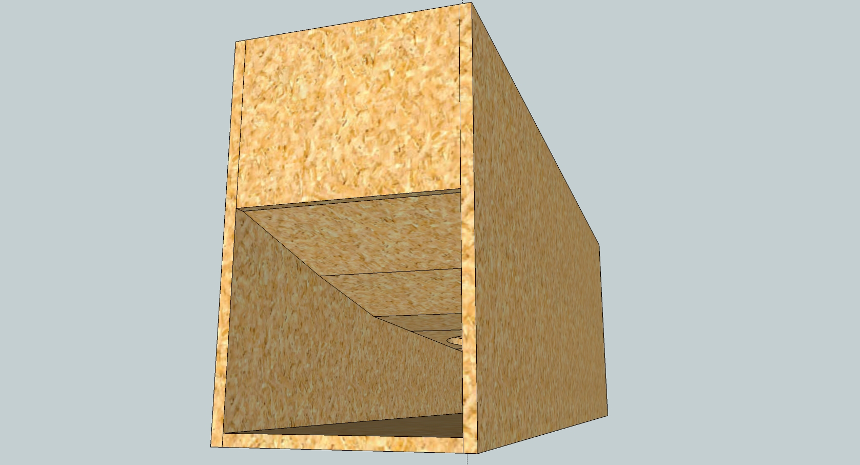

I go make a exp folded tapped horn, it is smaller, and better delay.
Oictures are example of exponential horn..
it seems to me the only problem with this box is the 'wasted space'?🙂
Yes with a exponential one it is difficuld, but as I say it is example, I am prepared when sim is nice to have some wasted space, a horn has always some.
I go try a lab 12 fold for the exp box, it is the best bet.
regards
kees

You'd be surprised how quick you can locate the sub if it's 1 m behind the listening position and the main speakers are 3 m 😵.....add to that my habit of having mad, wild EDM and dubstep parties once I get to drinking and the extra sensitivity helps.
I'm actually considering 4 subs.

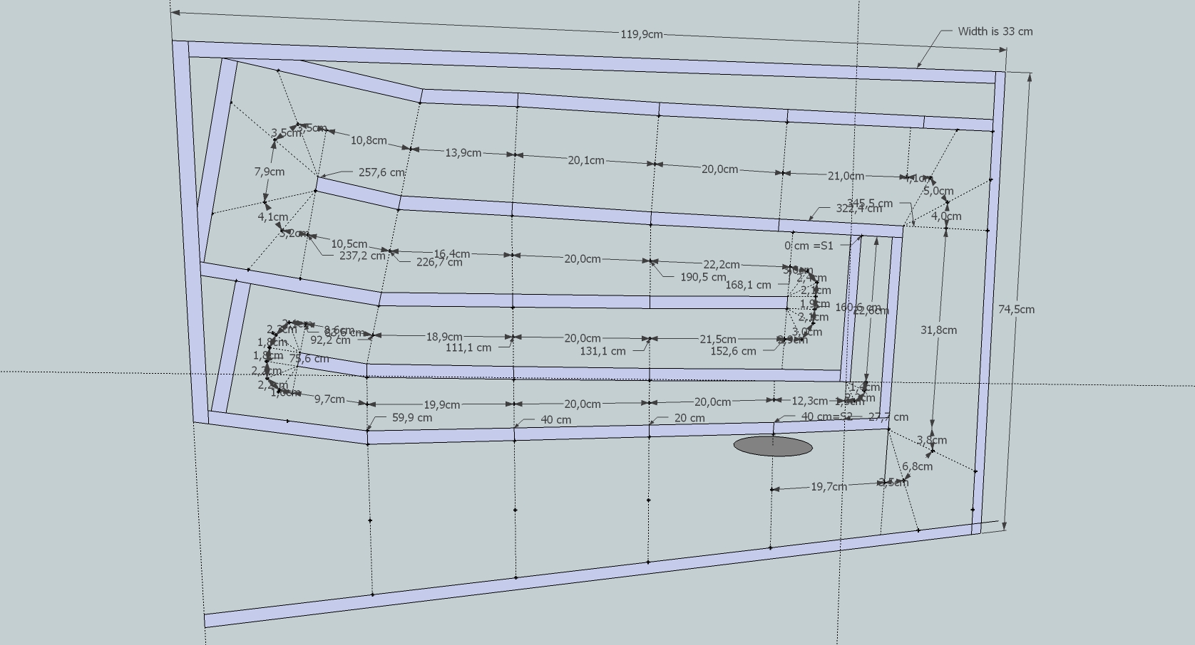

Lab 12 single fold
Thanks tb46. That is exactly what I was looking for. As for why I want two Lab 12s, I want to balance the room. My living room opens into my kitchen and I need more SPL. That's what I keep telling myself to justify the cost.🙂 Does anyone know if there is a Hornresp graph on this single fold? Thanks again, Bill
And to add, I will take photos of this build and show how I will "stretch" the plywood.
Hi snailtrax,
There is no change in the Hornresp Input between Don's version in Post #1, and the Post #251 full size single fold. I thought that's what you wanted. 🙂

Hornresp doesn't deal with folds at all, your resulting schematic in Hornresp will always be unfolded...and there's usually no less than over 9000 different ways to fold it, or even leave it unfolded if you don't have a driver tap to deal with.

I do it this way, a exponential one, I have empy spaces left in box, but this is
because of the exp flare and long pipe after the speaker.
Do you want it tall and skinny or short and boxy? If you want a four fold here's how you do it.
http://www.diyaudio.com/forums/subw...tive-tapped-horn-project-149.html#post1478209
There's a lot of info in the big thread (collaborative tapped horn project) but it'll take some time

I have now close to what I want, length is within 2 cm. now this box is exponential
less delay better respons more spl. but more work to make with all the parts for making the flare.
