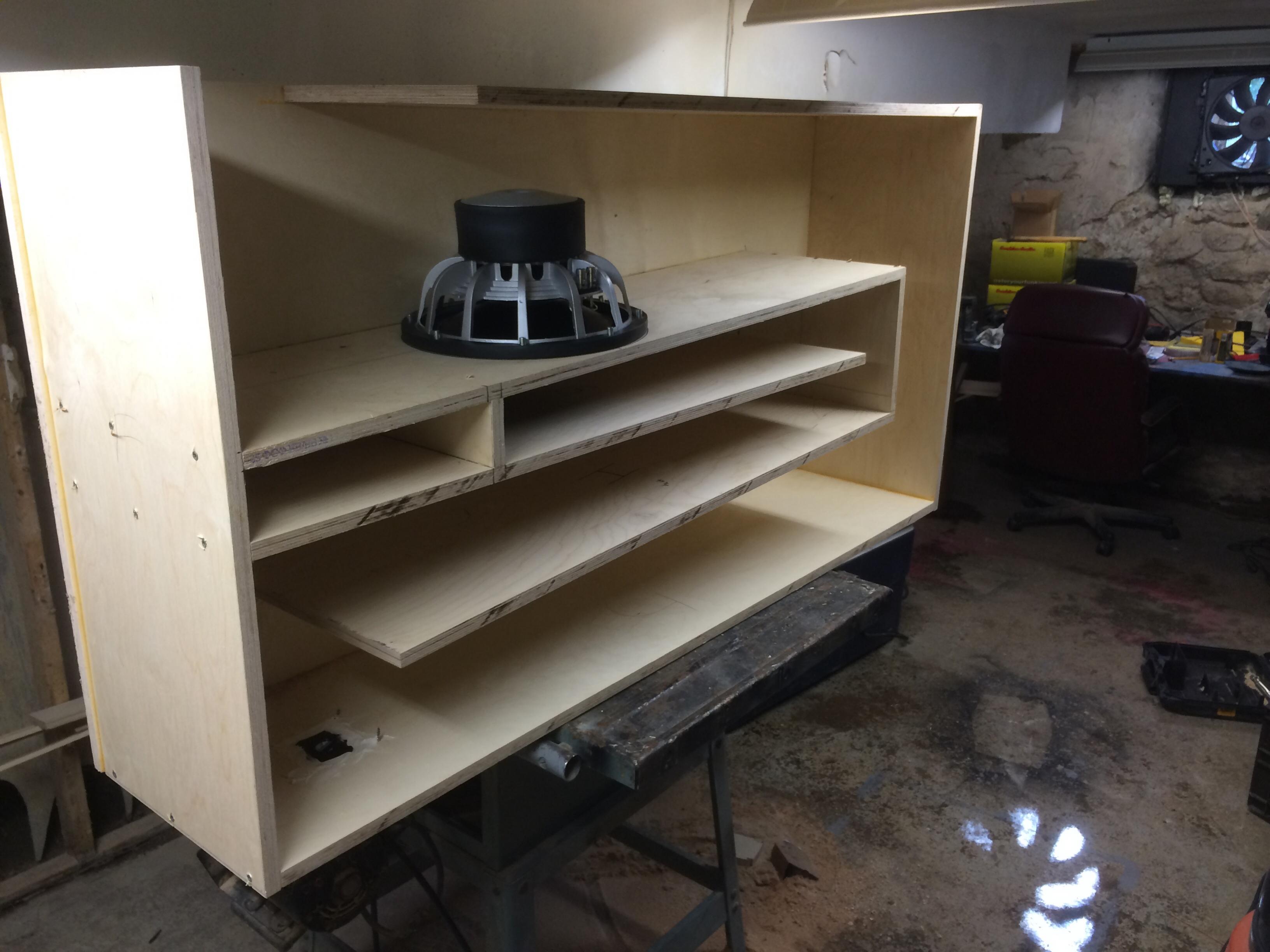

I have the epic12 in hand, just need to find the time to get some wood cut. Did you add any bracing? Do you think it would benefit from any?

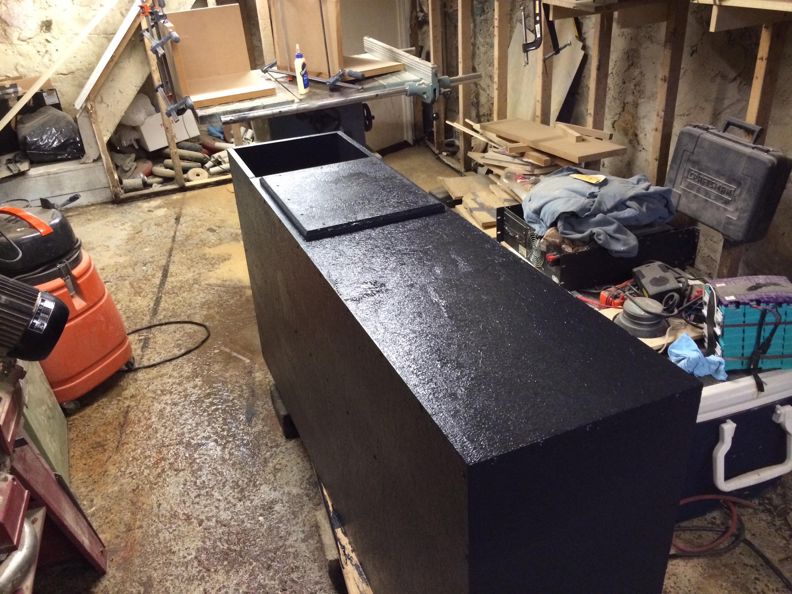

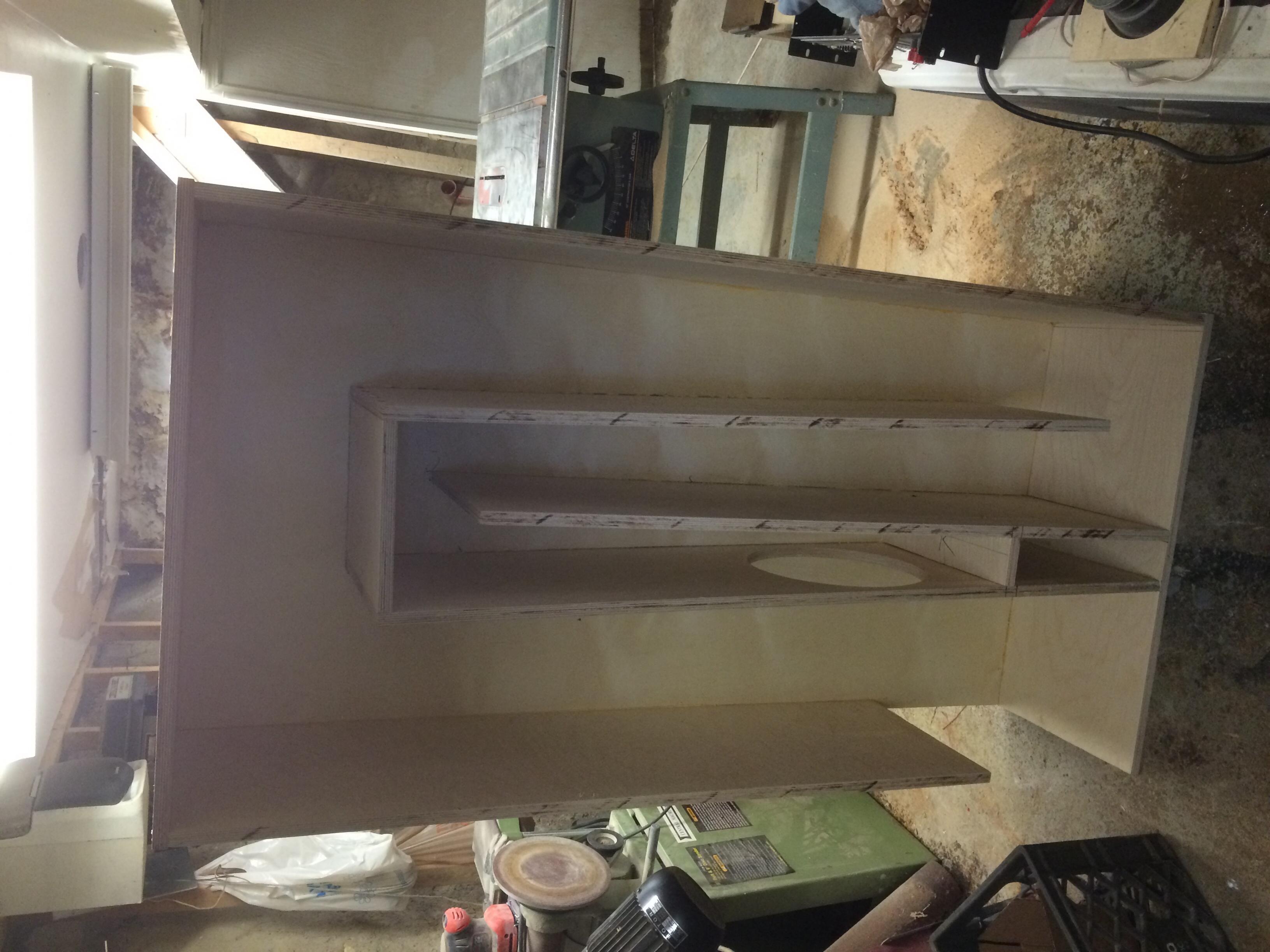

I didn't add any on the ones I built, as I hadn't seen anyone doing it, nor saying they wish they had. They seemed solid, right up till the day they spent 3 hours marinating in my basement leak and got ruined. 😡

As far as the TH, the rear board started to curve when it got wet, so it started to pull apart. I ended up dismantling them and building smaller subs (the OD-ML-TL) with the drivers so I'd have something small enough to have upstairs. Once all the basement woes are addressed I'm definitely making another pair of THs though..maybe even something bigger 😵.

I would have braced don the middle but if your using this no where near its rated Xmax then you will probably be fine the way it is.
I dont like gaps bigger than 8" with out a brace. But thats just me.

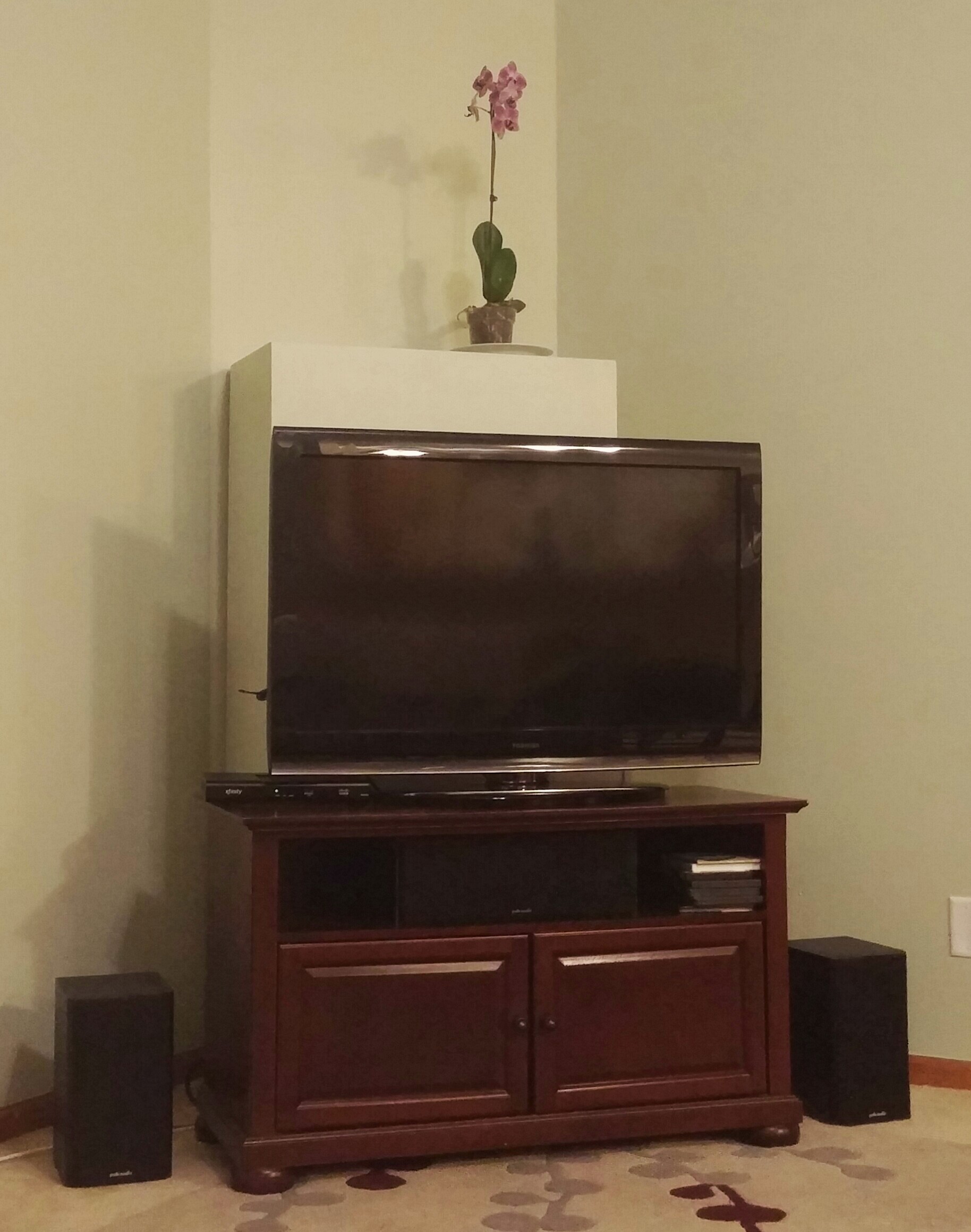

Thank you all for the plans. I have recently built one and am very satisfied thus far. WAF was very low but I have tucked it behind the TV and TV stand and will be painting it the same color as the walls in the room as it has been determined that the sound improvements are worth it!
