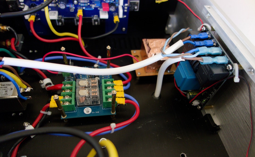

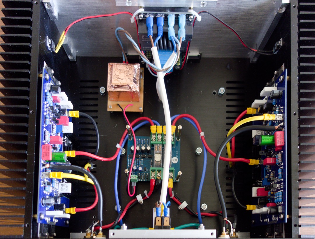

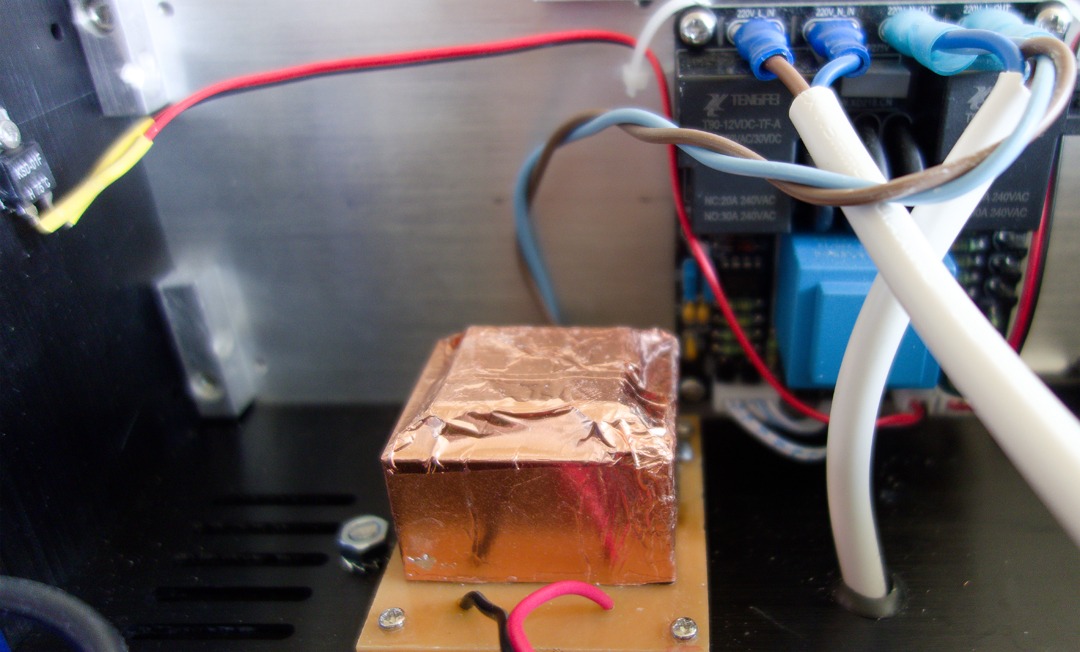

Interior of the amplifier box (with the soft start circuit in the middle back, the shielded transformer of the speakers protection circuit, the speakers protection circuit in the middle and the amplifiers PCB mounted on heatsinks on the sides).
Other view of the components with the AC power filter on the left (in a metallic box).

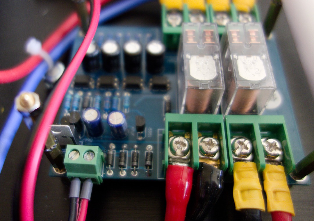

The speakers protection circuit.
The soft start with thermal protection circuit with the shielded transformer for the speakers protection circuit.

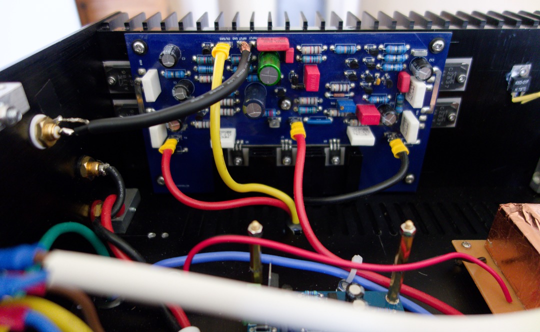

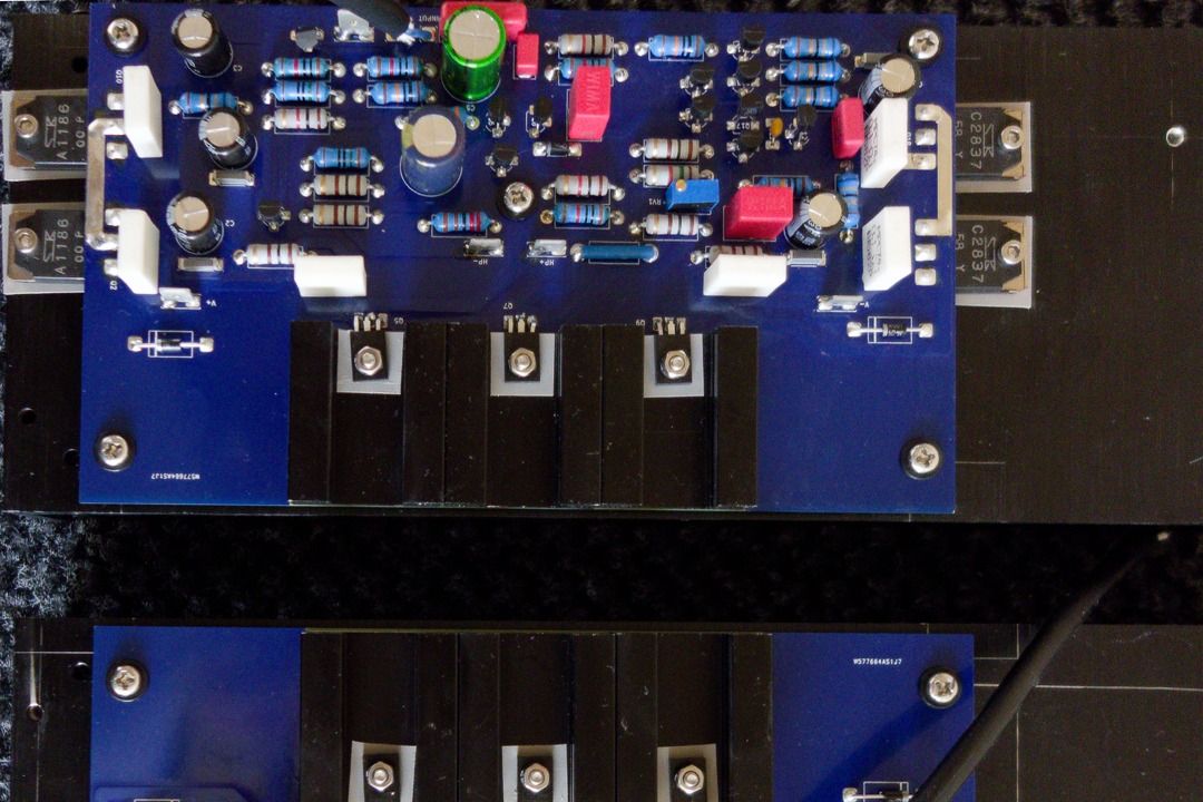

The left channel amplifier PCB with his heatsink before mounting.
The same element installed in the box (with a temperature sensor on the right)

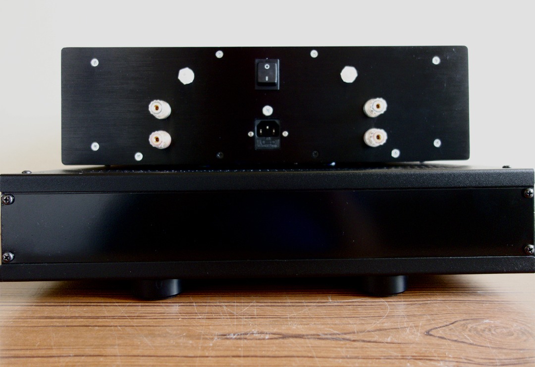

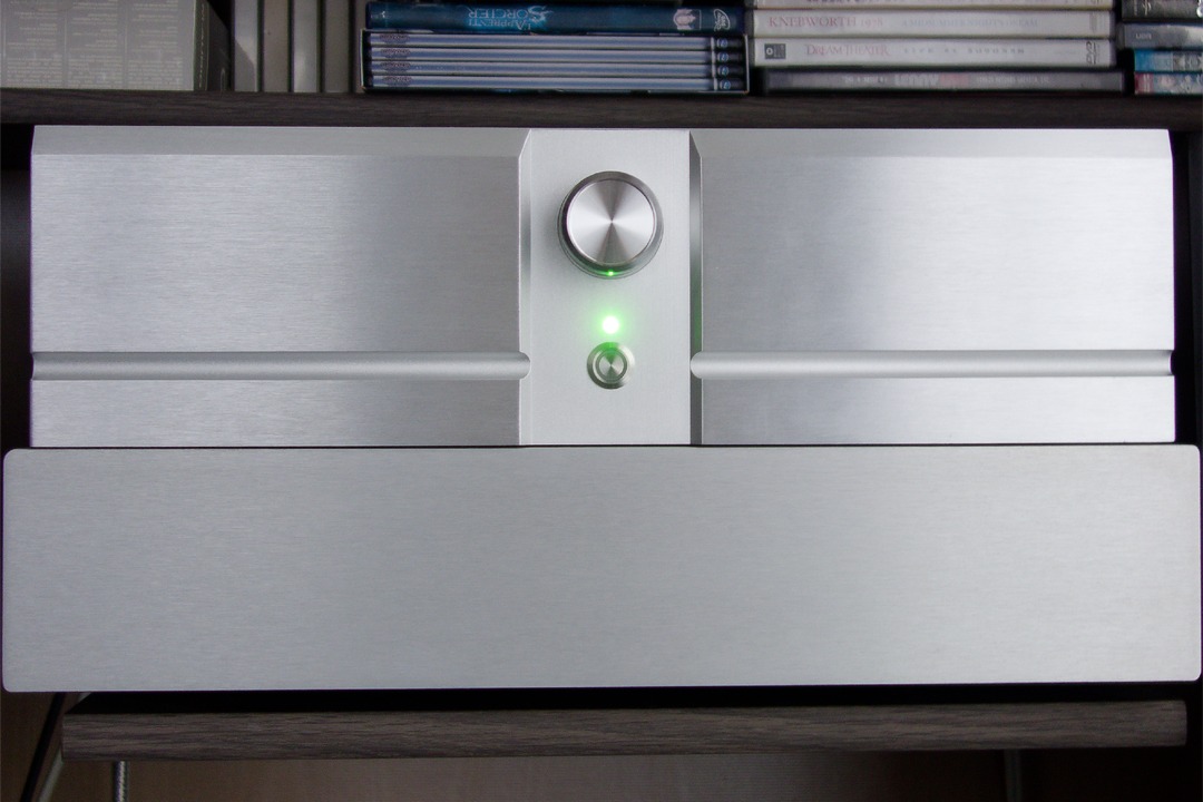

View from the back of the amplifier and the PSU.
View from the front (with amplifier working).

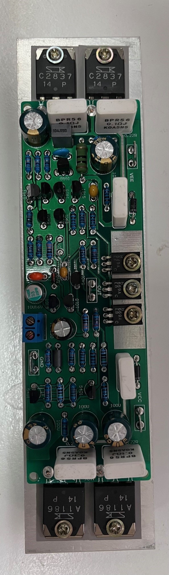

What is this l12-2 Pcb? New version? Or modified by yourself? If could please share details

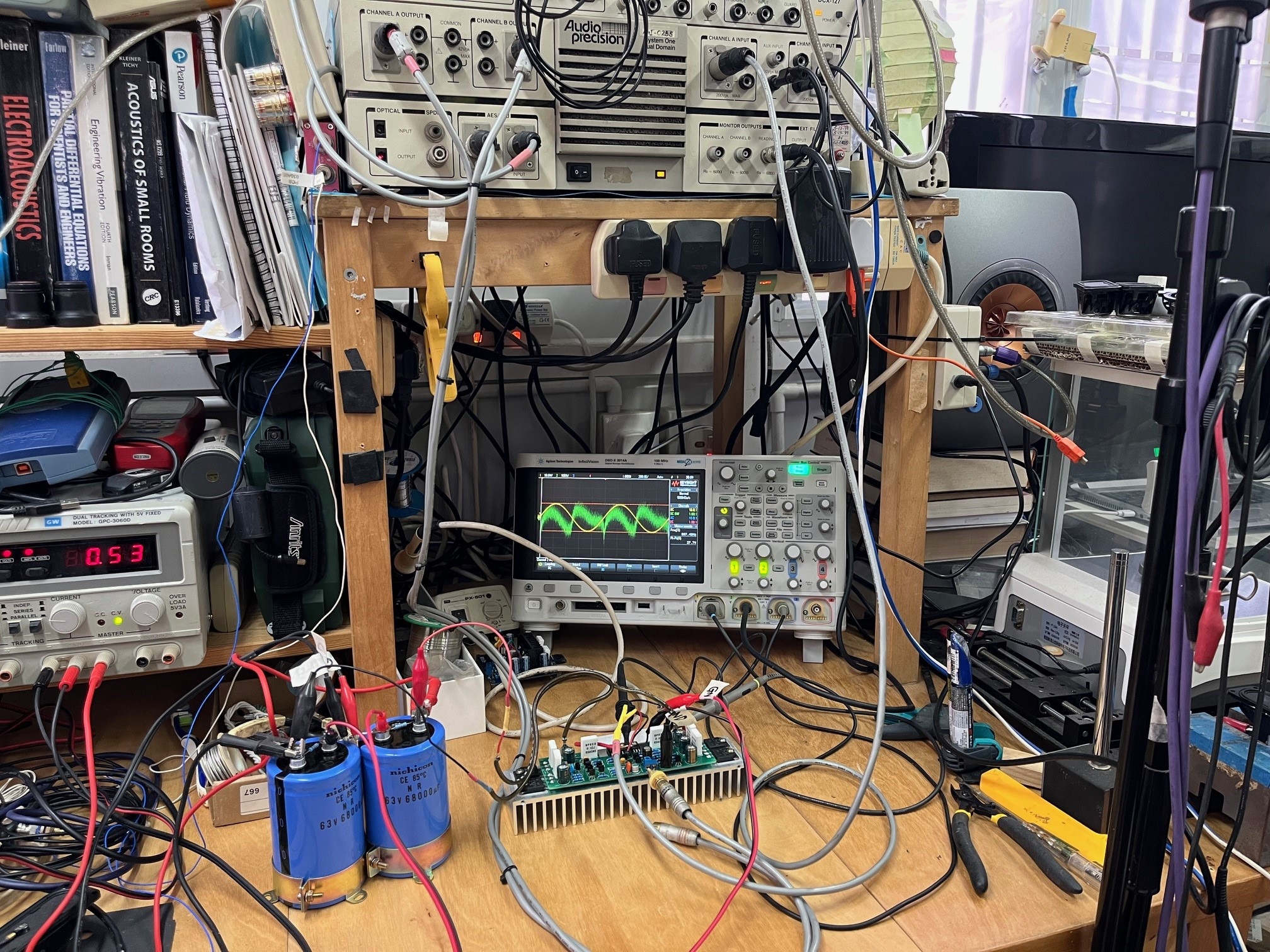

I can't believe I bought the kit (LJM L12-2 x2) in 2015 and just tested one of them today. Time flies!

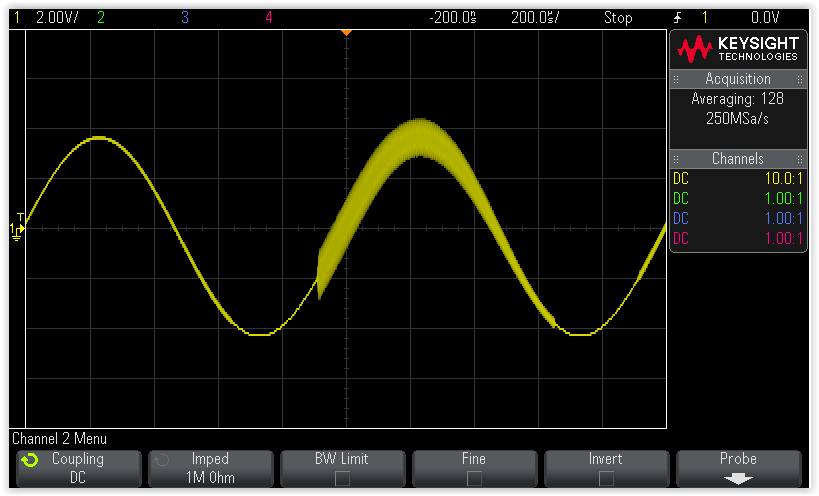

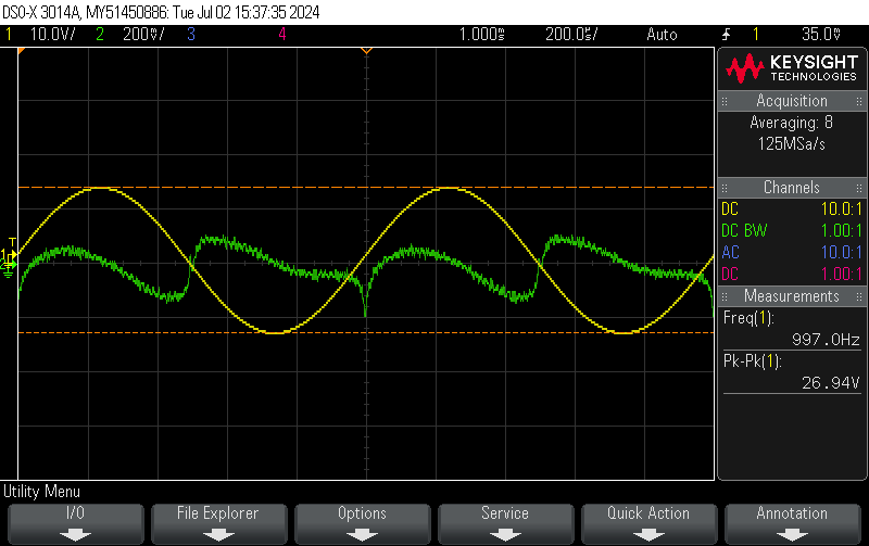

I use a bench DC supply to set the DC 30Vx2. In addition, a pair of 68000 uF reservoir caps are used. As shown in the picture, the wiring is just aimed at preliminary test.

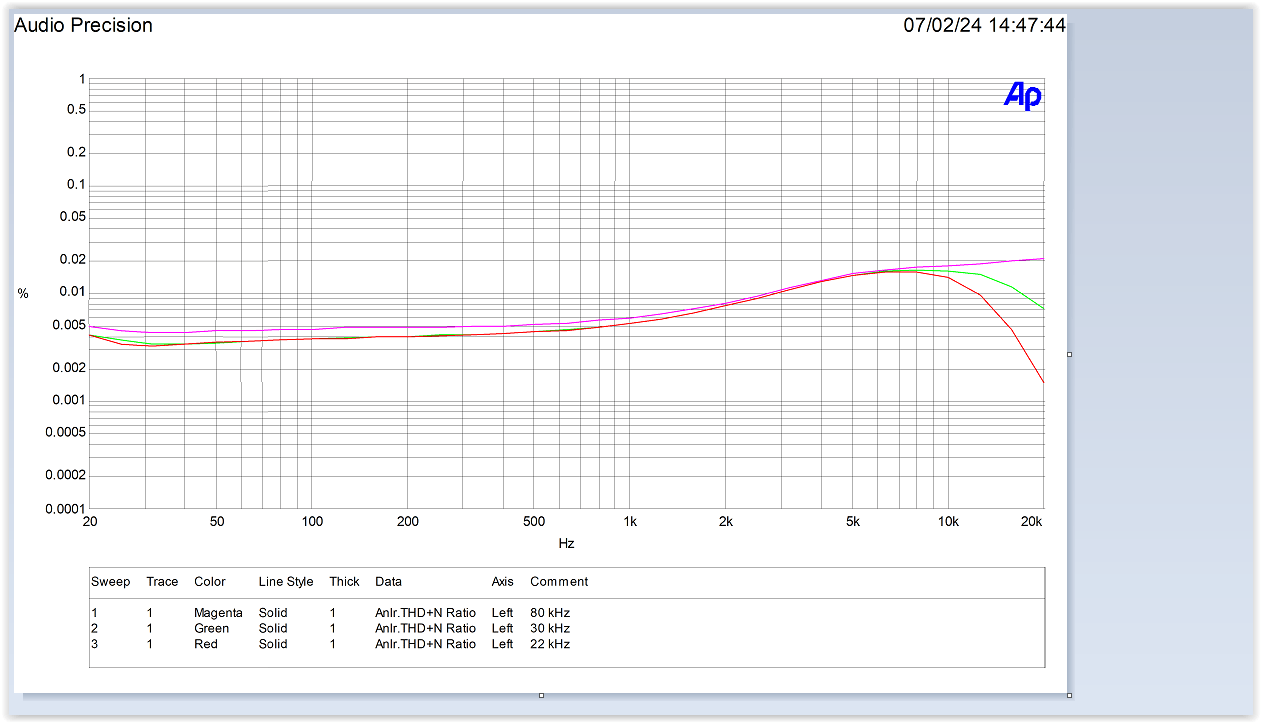

The scope screen capture shows the 10W, 1 kHz waveform across an 8 Ohm resistor load. The green curve is the distortion residual from the AP-S1.
A quick THD+N vs freq. at the power level was performed to see if there is anything not normal. So far so good.

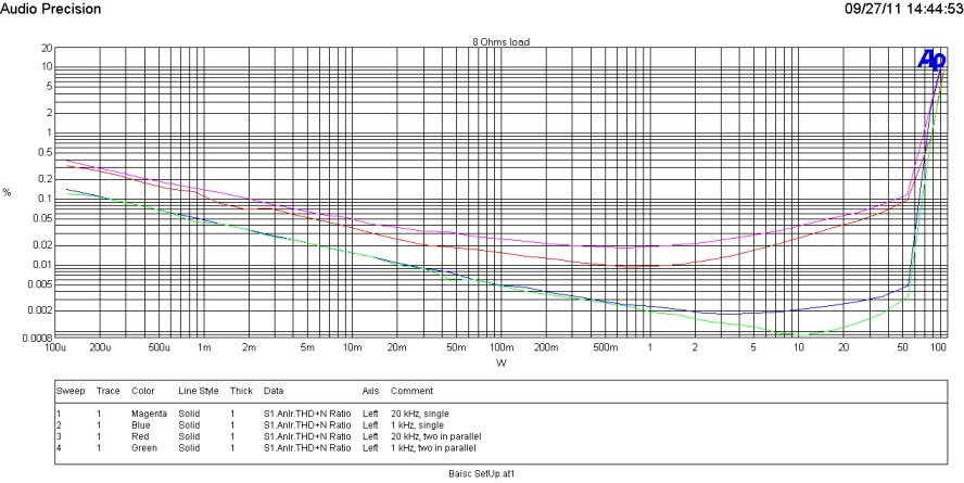

TDA7293 single, bridge, parallel from summer of 2011 is still quite interesting.
Motivated by that post I have made four parallel TDA7293 amplifiers with decent performance.
Even Michael Beeny, who loved his L12-2 found parallel TDA7293 much better amplifier.

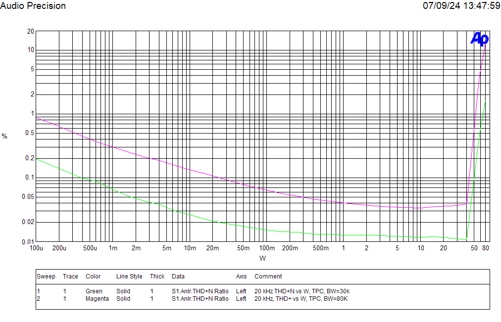

I was able to attain results comparable to these you published in 2011, shown in a graph below. In my view parallel TDA7293 outmerforms L12-2 and can be easily expanded into a decent high power HiFi amplifier by bridging and paralleling.
Please, your thoughts - you have tested them both.
Performance of TDA7293 in parallel measured by Panson in summer 2011

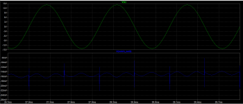

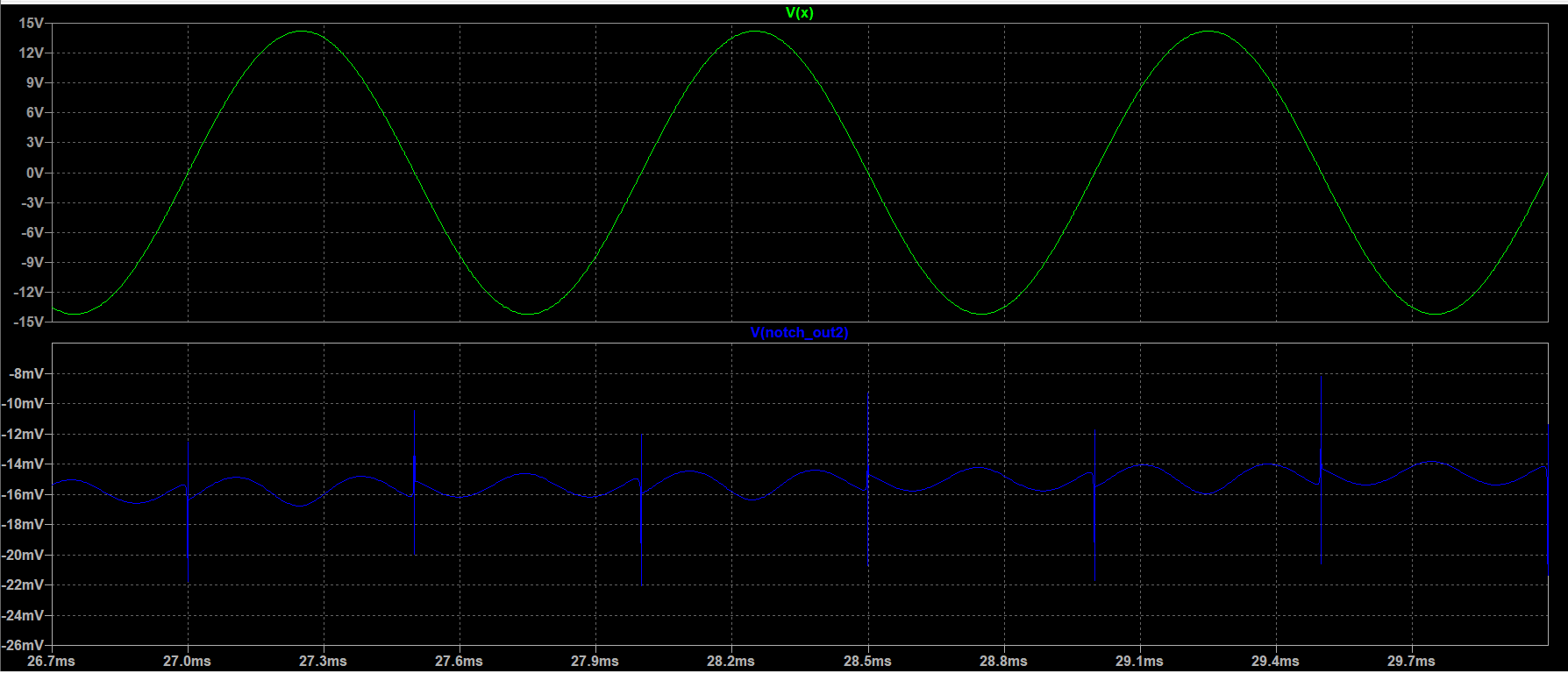

The circuit is created in LTspice for simulations. Here are some preliminary results.
Output waveform of 1 kHz, 12 W across an 8 Ohms load, the current of the upper- and lower-half of the output stage and the corresponding distortion residual.
The other graph shows THD vs Freq for 12 W/8 Ohm.

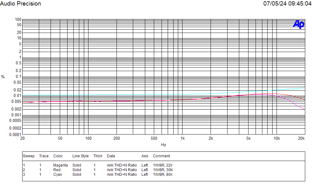

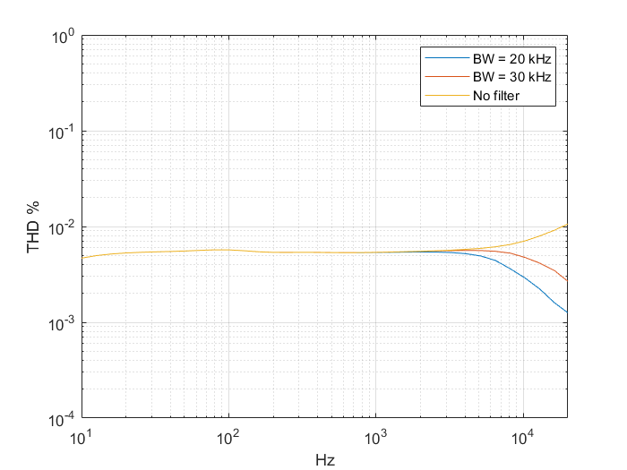

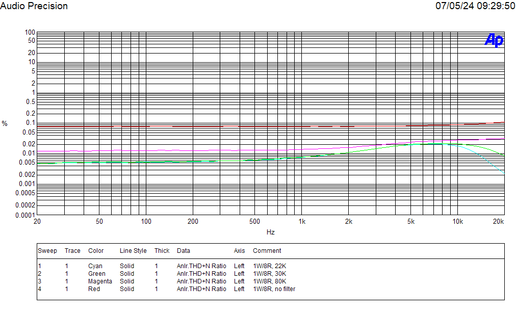

Just to show the importance of 0.1 uF caps (or similar) across the main reservoir caps (well, everybody knows) in the test.
The supply was initially without the 0.1 uF caps. The THD vs Freq for 1W/8Ohm is shown in the left figure. THD at 2 kHz with 22 K BW filter is nearly 0.01 %. When the 0.1 uF caps are added, the THD is reduced to about 0.008 %.

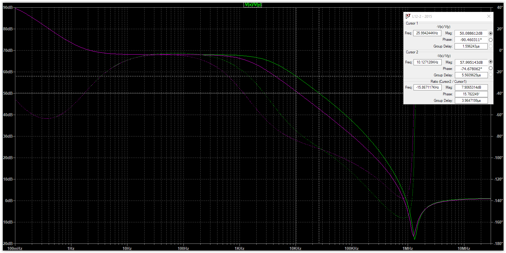

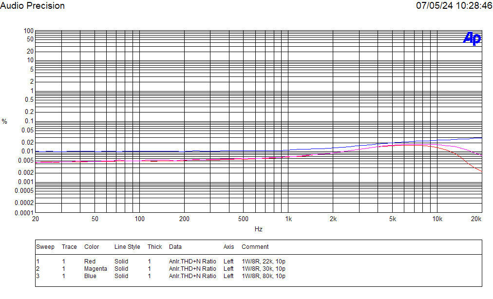

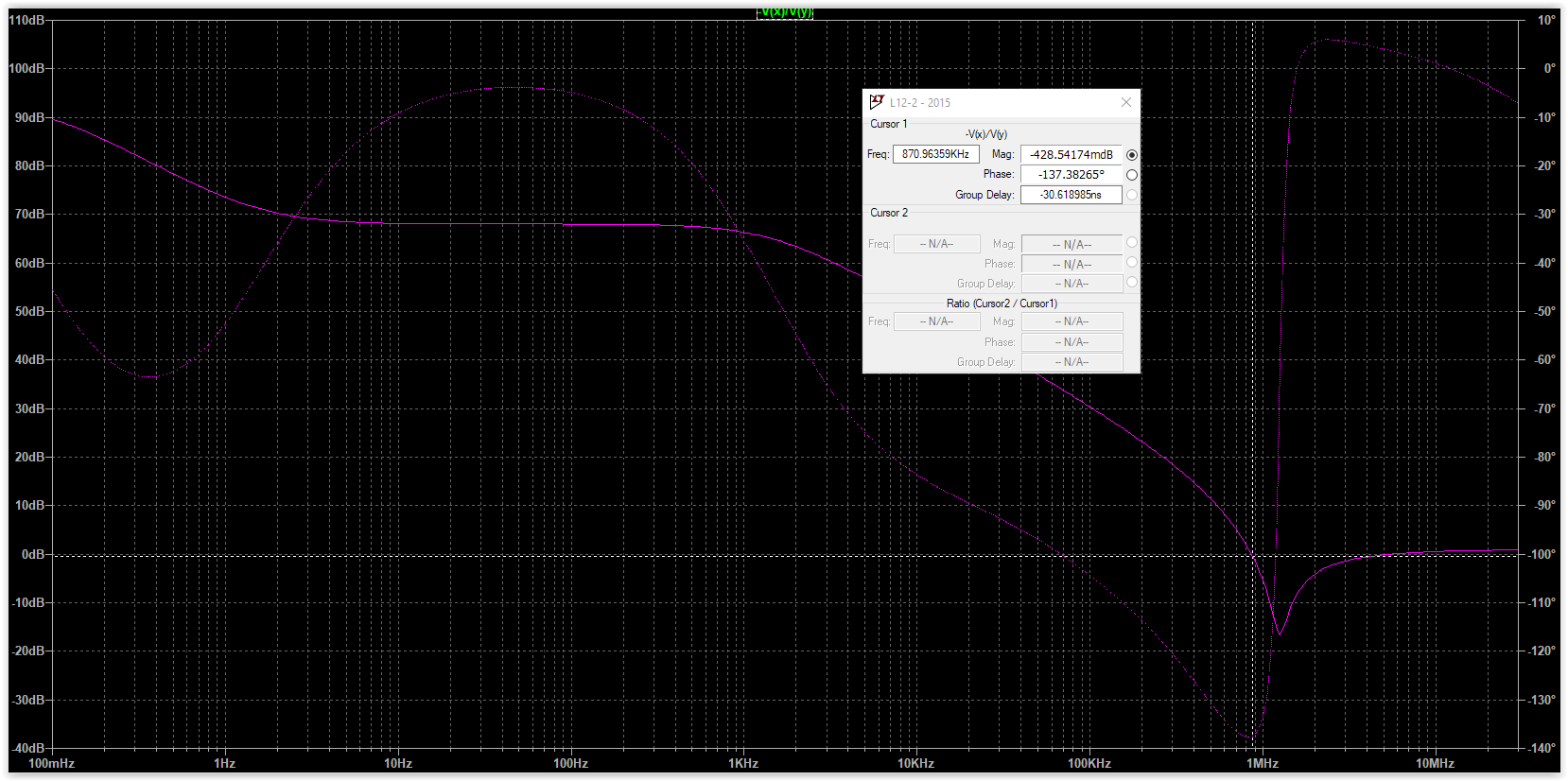

Simulation shows the phase margin is about 30 deg without the dominant/Miller cap at the VAS. Simulation shows a Cdom = 6.8 pF giving a PM of 43 deg.
I don't have 6.8 pF around. Instead, a 10 pF cap is added to the board for testing. THD increases due to the reduction of the loop gain.
Figures: Loop-gain simulation with 6.8 pF, THD vs Freq for 1W/8 Ohms with Cdom = 10 pF, and loo-gain comparison for no Cdom and Cdom=6.8 pF. There is about 7 dB gain difference from 10 kHz to 20 kHz.

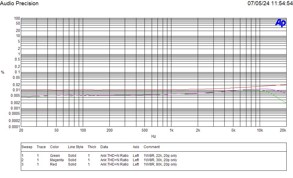

Correction: The board comes with a Cdom = 100 pF. There is not need to add a Cdom.
If the original Cdom is replaced with the 10 pF, the amplifier is unstable as shown in the figure. It is stable for using 20 pF. The THD vs Freq for 1W/8 Ohms is given in the other figure.
The board with Cdom = 20 pF will be tested for reactive loads.

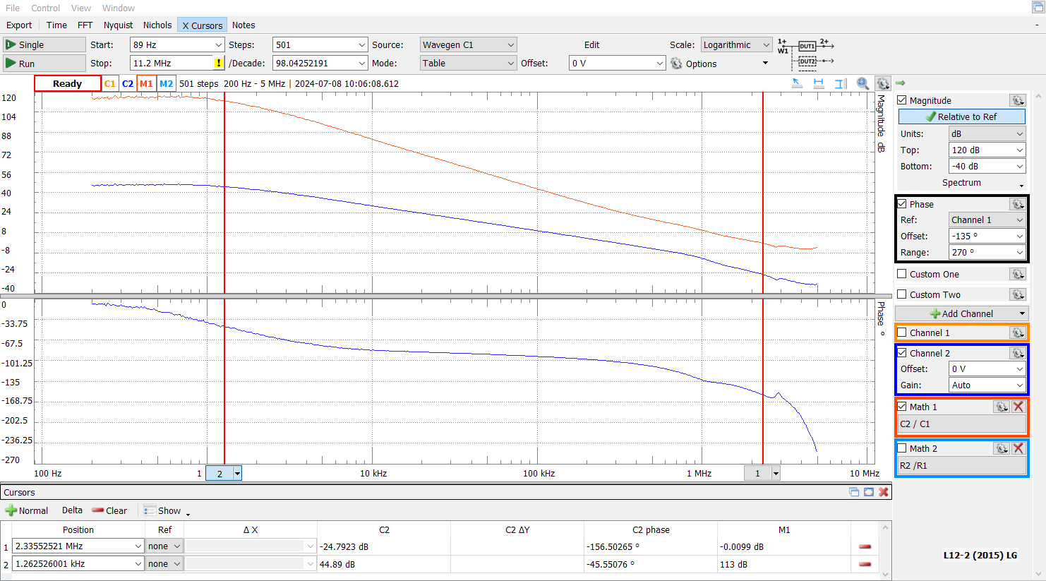

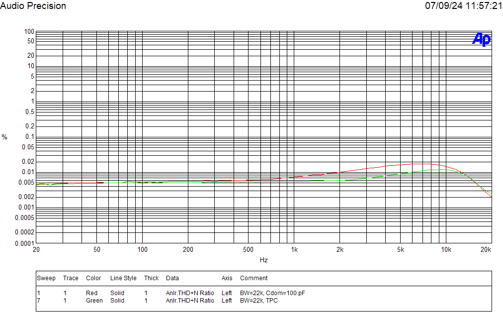

I used the analog discovery 2 (AD2) network analyzer to measure the loop gain of the board with the original Cdom = 100 pF. PE-51687 current sense transformer was employed for signal injection. The result is shown in the figure below. The phase margin is 22 deg. This seems to be not sufficient.
The Cdom creates a corner frequency at 1.27 kHz. Reduction of the loop gain causes the THD to increase vs frequency as seen in the previous measurements.
The AD2 appears to fulfill the loop-gain measurement task.
