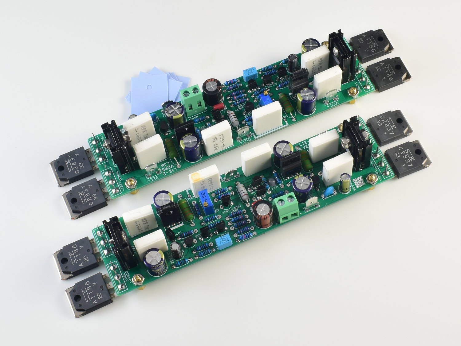

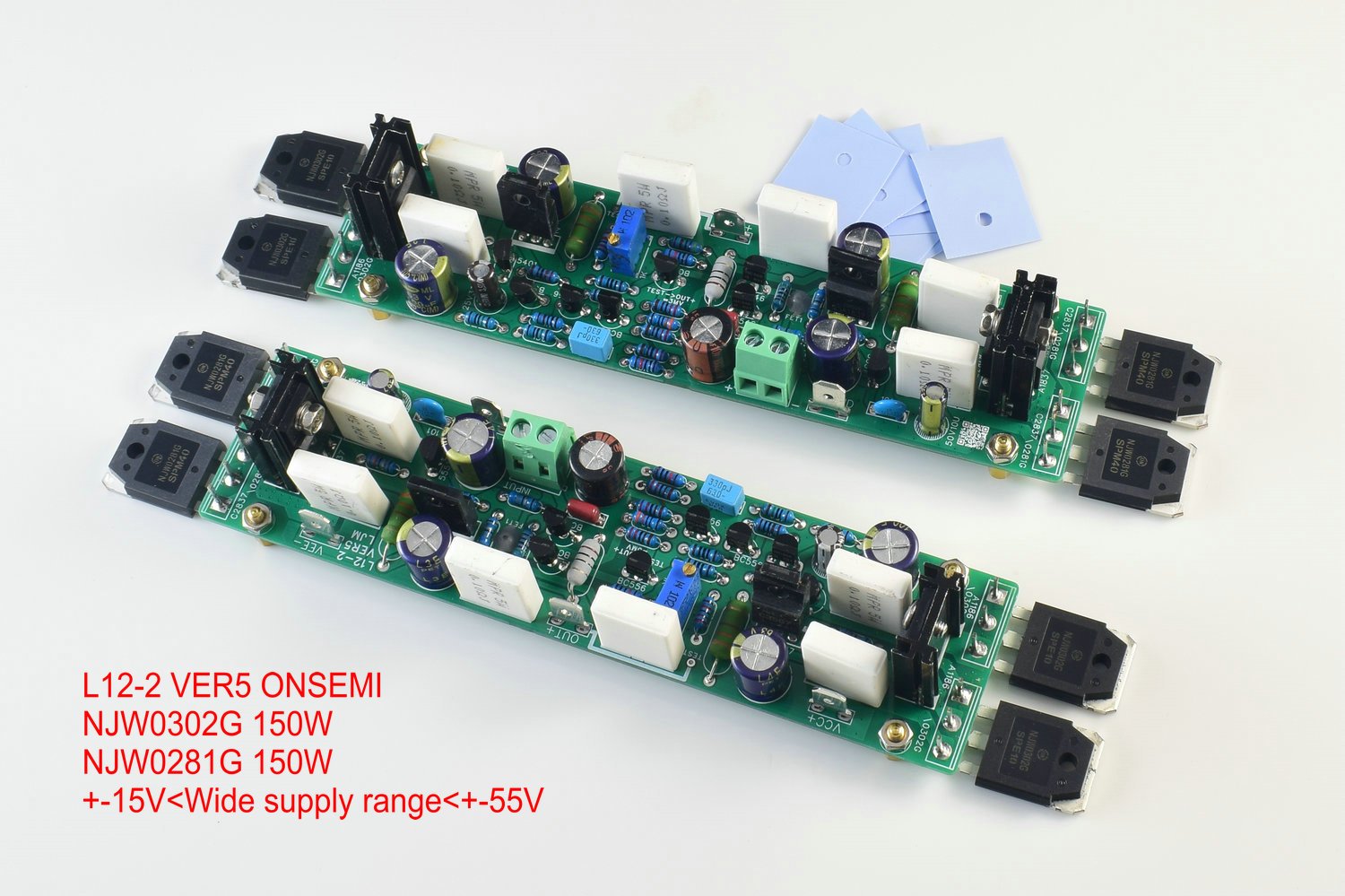

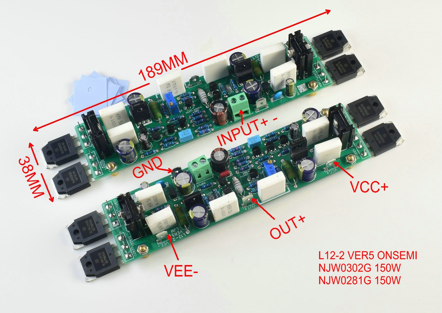

This is an introduction to the L12-2 VER5 version
Replace the low-power transistors B649 and D669 with medium-power transistors A1837 and C4793.
Increase the static current of the drive power transistors from 6mA to 18mA.
Add a heat sink to the medium-power transistors.
Add a static current adjustment function for the output power transistors to make the static current of the left and right channel circuit boards the same.
Use electronic filters to replace the previous RC passive filters to reduce interference at the input stage.
Change the input stage method to increase the input impedance and enhance low-frequency performance.
