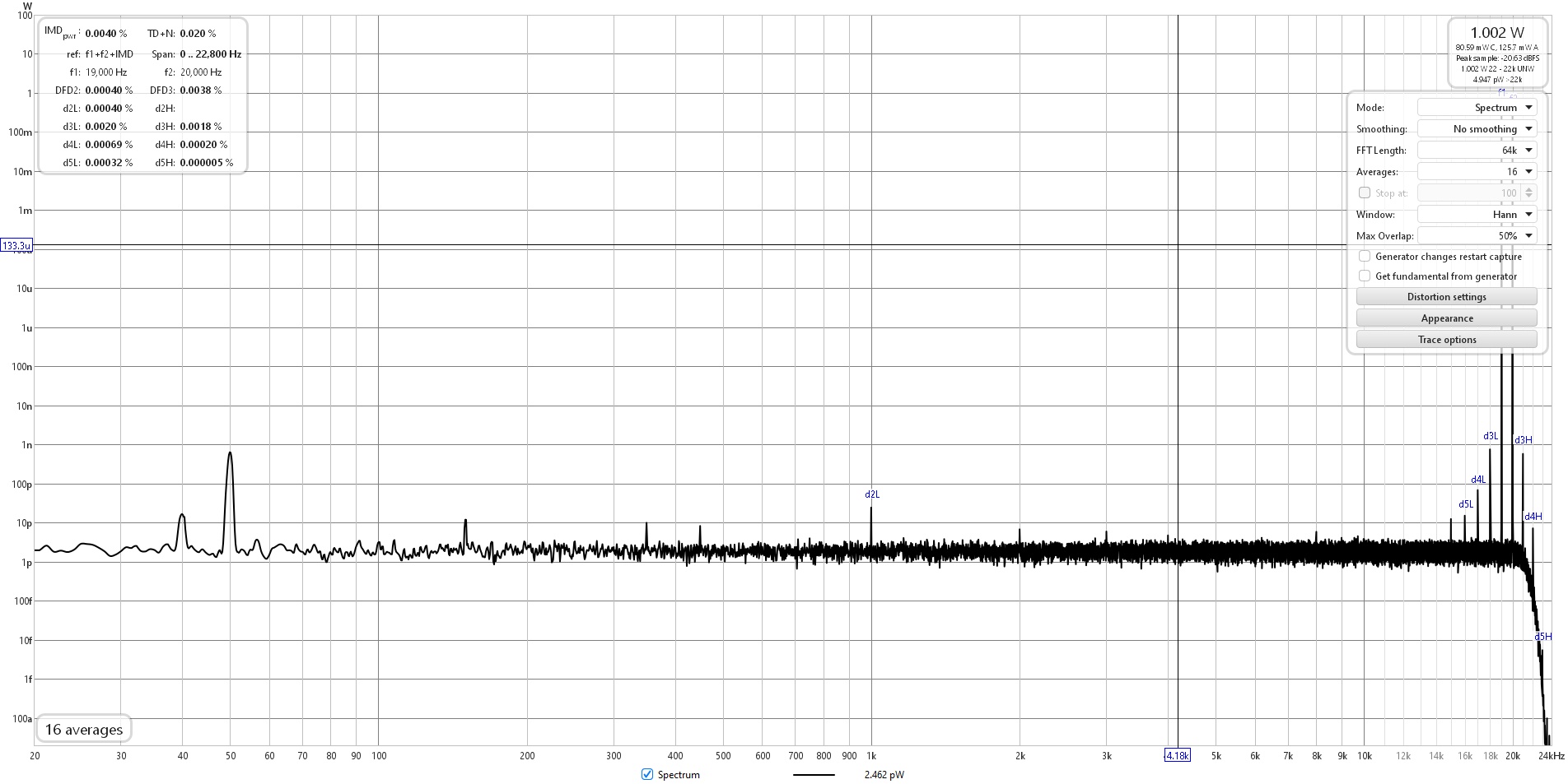

I performed some measurements of my V4 modules, using 400W 4*37VAC transformer, and 6*22000uF caps. Signal source Yulong DA8 MK II, signal input Cosmos ADC grade 1. Both DAC and ADC connected to notebook, powered from its battery, to eliminate ground loop issues.
While noise looks good, and THD looks really great, IMD figures are not so great, but still in acceptable margins. The output power at 8Ohm, is 115W @ 0.05% THD, if one pair of secondaries of transformer used. Promised 120W possible if all outputs of 400W transformer connected to rectifier. So if one want to unleash full power of that amp, 500-600w single transformer, or 2*250-300W transformers should to be considered. The heatsinks sold on Ali for that amp, good in case you want to test modules, or drive some very sensitive loudspeakers only.

19+20k IMD test - a file called IMD CCIF 5W. At audiosciencereview.com IMD tests performed at 5W. But I can try at 1. I don't think it will change numbers dramatically.

As for the IMD test. This is actually quite a good number. I have no idea why you might be disappointed with it. Correct me if I'm wrong, the measured figure is 0.00033%. Do you know what the accuracy of your equipment is? Just curious. I'm used to seeing dB numbers, not wanting to compute these. If you are using a sound card rather than an audio analyser the numbers may be optimistic, or pessimistic. Depends on the equipment and software.

0.00033%, you added extra zero.Correct me if I'm wrong, the measured figure is 0.00033%.
Generally, I test the noise floor with short inputs. Here is the 1w IMD test. As I expected, there were no critical changes in numbers.
What bores me here else, is the 50Hz spike. Even 66000uF per rail isn't enough. On the other hand, caps are Chinese. Good Chinese, but it's still not Epcos or Kemet.
Oh, you was correct with .00033%. I’m sorry. It’s a bit difficult to count zeros after midnight))

I'm having difficulty with your scale. I measure x dB from reference. In my case it would be 1 watt or 1 volt for signal stuff. Consumer gear is 0 dBu at 0.316 mV. I don't bother with +4 dBm, but I could with balanced gear.
What software are you running? I've seen it before but never asked.
About mains noise. It is next to impossible to eliminate mains pick up. I use isolation transformers for audio to look at supply stuff, they do have distortion. Your measuring equipment may introduce a ground current. Then you have your 50 Hz and harmonics show up. 60 Hz here. Additionally, it is extremely difficult to get the grounding perfect in equipment. If your noise is below 100 dB, it isn't normally audible. Not unless the system noise is also so high you can hear that plainly.
So if you are showing your mains frequency, that is normally stray pickup. 2X that may come from a normal full wave power supply. Capacitors will have some ripple, this is unavoidable. Going too large with capacitance is a very bad thing though. It creates higher frequency supply noise which is far more difficult to get rid of than the lower frequency stuff.
