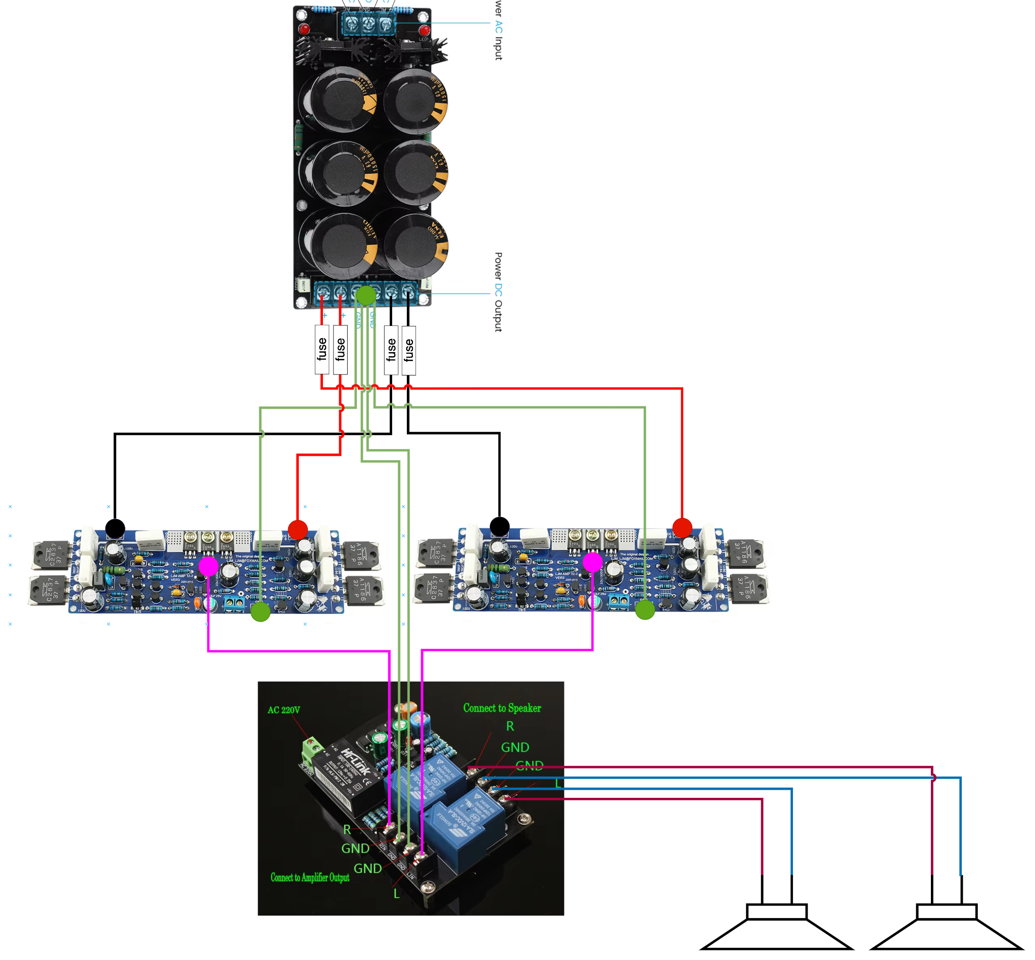

@michael beeny sir after watching your videos I have assembled the amps but I have a persistent hum from both speakers.
I am using:
The wiring is as per the option 1 diagram here: https://www.diyaudio.com/community/threads/ljm-l12-2-ver-4-2-help-me-wire-this-plz.421972/
Speaker negative to amp ground
Amp ground to PSU ground
The issue occurs as soon as I connect a source to BOTH RCA inputs. With source turned off or on I get the hum. It doesn't seem to amplify, just there like an annoying itch.
I have tried to:
What can I do guys??
I am using:
- L12-2 version 4.2 amps
- 500va 30-30v transformer1
- 5000uf x 6 PSU board
- 220v speaker protect
- slow start module
- topping d50s as source with volume control and dac
I have tried to:
- Float the signal ground for one rca = no change
- Adding capictor in series to signal ground=no effect
- Testing each amp individually I get no hum
- Removing the RCA input I get no hum
- Removing one RCA I get no hum
Sir, could you please take a look at my hum issue and help me if it's related to what you postedJust a word of warning for newbs and the unwary - Ver4.2 and Ver5 of the L12-2 have a dc coupled input ( i.e. no input capacitor ). Check the output offset voltage if your preamp has a dc coupled output; and add an input capacitor if you intend to put a volume control directly in front of the power amp. I'm currently tracing the L12-2 Ver4.2 schematic from the pcb and will post it here when I'm done.
What I meant by floating the RCA ground was that on one of the RCA inputs I simply removed the ground connection. The other RCA had both ground and signal connected.
I also removed all RCA inputs and removed power. And measured the resistance across the signal ground and signal input. Both at the RCA inputs and also at signal input jack on the amp board.
I get:
Left: 0.854 k ohm
Right: 0.631 k ohm
Does this imply that version 4.2 indeed doesn't have any DC coupling caps?
I also tried a different input source and I get exactly the same behaviour.

Update
I have fitted 2.2uf capacitor (audiophiler mkp, 400vdc) to both RCA input signals. The buzzing is slightly reduced but it's still there, albeit 80% of before.
With the system turned off I get infinite resistance across both RCA inputs after I installed the caps.
With the system turned on and no music playing at source.. I get a DC reading of
4.6mv at both the amp signal terminals. This is after the capictor has been put inline at RCA input.
Speaker terminals have a DC reading of:
DC -52mv and DC -45mv
The buzz is still there:
Summary of what i have so far tried:
- 2 alternative star grounds (details here) Thread 'LJM L12-2 ver 4.2 - help me wire this plz' https://www.diyaudio.com/community/threads/ljm-l12-2-ver-4-2-help-me-wire-this-plz.421972/
- different input source
- different RCA cables
- different PSU
- twisted cables
- only 1 amp connected (no hum)
- only 1 RCA connected (no hum)
- no RCA connected (no hum)
- source off, both RCA connected (hum)
- source on, both RCA connected (hum)
- DC blocking capacitor on RCA (hum)
- NO DC blocking capacitor on RCA (hum)
- L12-2 CFP Output amp 120W*2 8R
