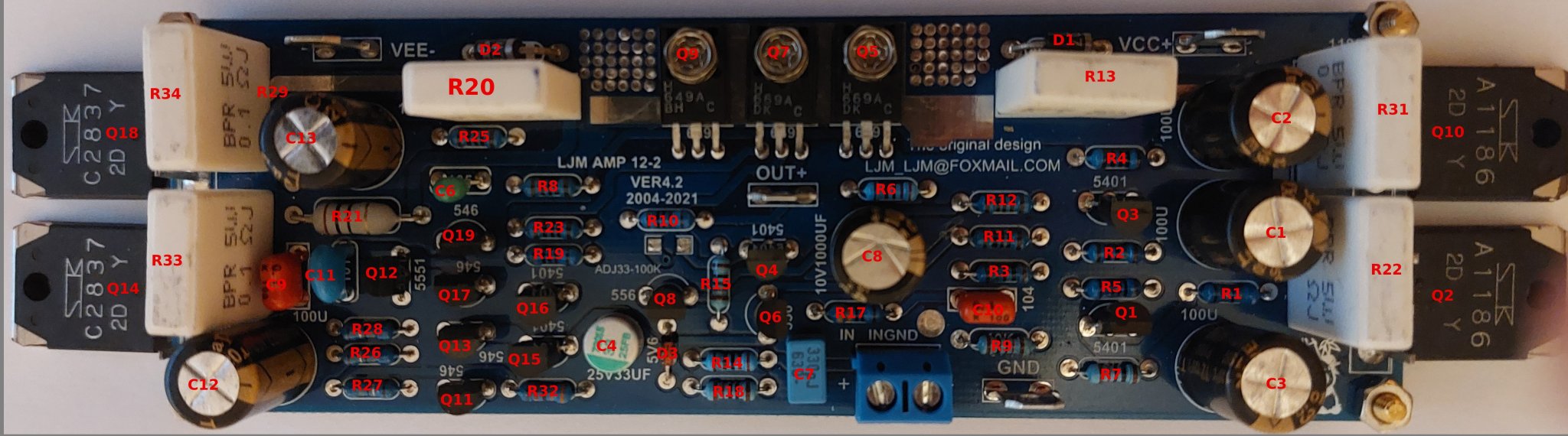

Here are pictures of the PCB with the references (I have done to understand the schematic) and the schematic of version 4 (given by Calvin). References are the same on both. On the schematics polarity of C12 and C13 must be inverted, R2 is 150 Ohms, C6 and C4 are in fact 1µf. It seems that your version have not the same references for Q11, Q13, Q17 and Q19 (2SC1815). Also, R16 is replaced by a capacitor, R7 and Q1 are inverted, C5 is missing. Good luck

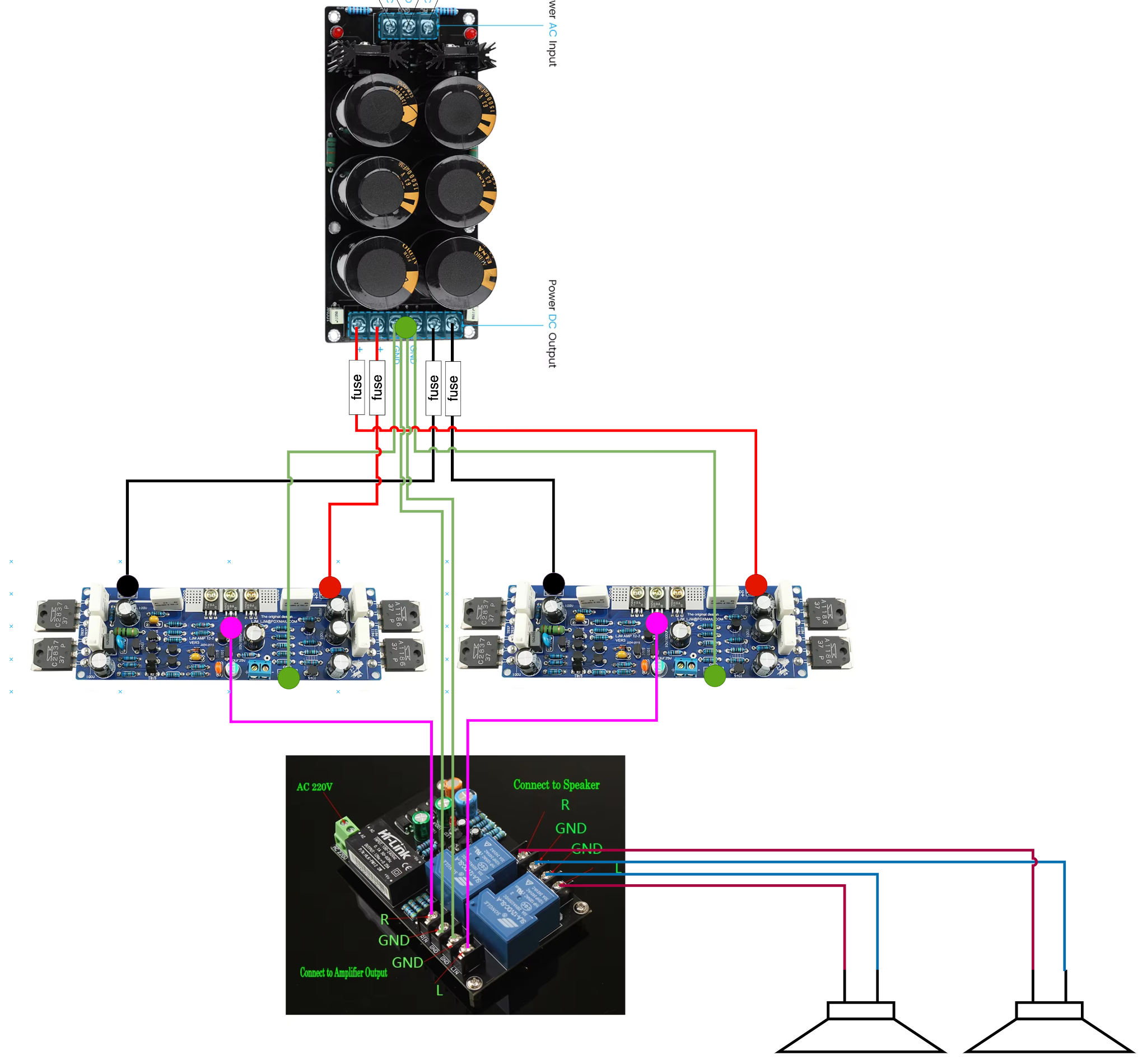

Thanks Peter, it gave me food for though so I tried the following with no effect to hum. It's still there..
  • Disconnected the signal shields (ground) from amps
  • connected new ground wires from the PSU and connected them to each RCA plug

Hi Calvin,
My back panel to the amp is plywood, so there should be no accidental connection to chassis. I tried your suggestion above and ran a ground straight from RCA plug to PSU. Disconnected the shield from both amp signal inputs. Sadly no difference.
Finished tracing out the Ver4.2 pcb and Ive attached an annotated picture of the pcb showing the part numbers according to post #383. I've also attached a parts list corresponding to the picture. Schematic to follow.

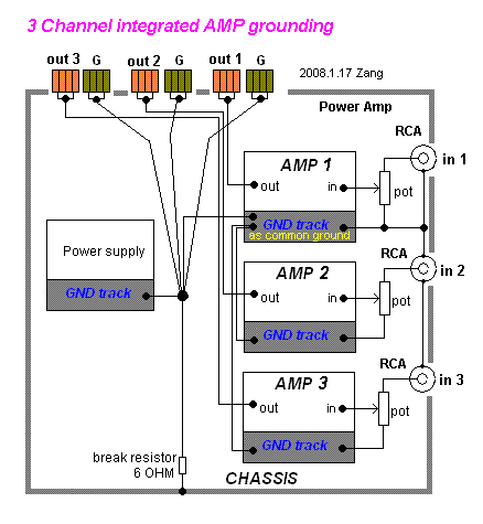

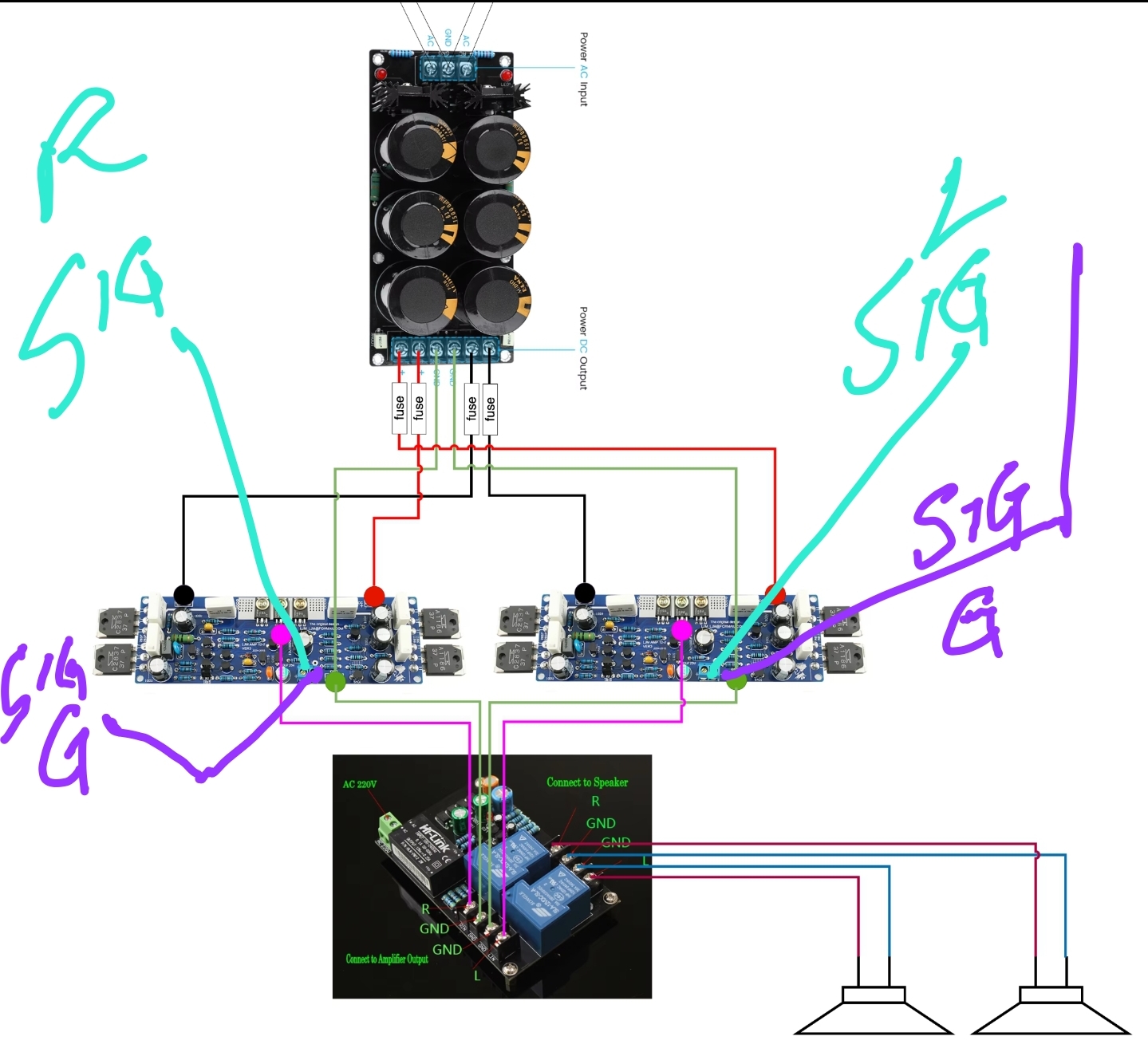

In your schematics you don't draw signal grounds, which are essential to spot the real source of your problem. Just draw the signal grounds and you'll see a huge ground loop that you have created. You should connect your both signal grounds at a single point. I bet you have connected left channels' ground to the left channel board and right channels' signal ground to the right channel board. That is wrong: either-or, not both. Go back to the @digi01 post #7 and try to learn.

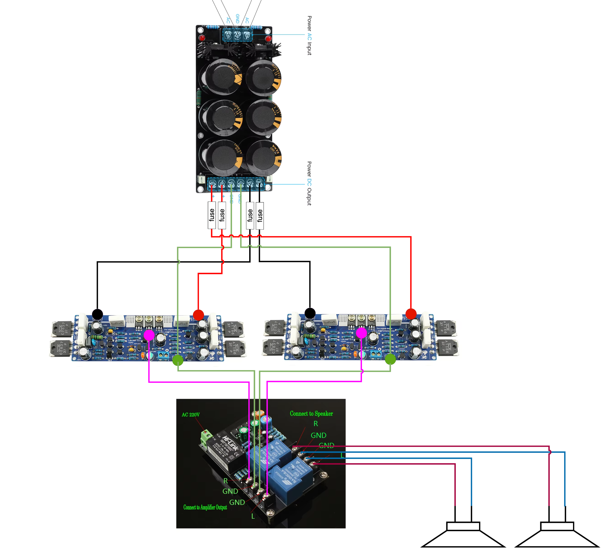

In the meantime this is how my RCA signal wires are connected. RCA signal and shield are connected to each amp respectively.
Would be grateful if you can help outline the potential ground loop.

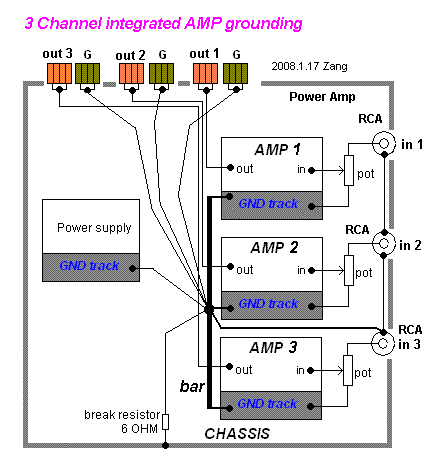

Let me explain you how to solve this problem.
Refer to the wiring diagram in my previous post #1.015
1. Your RCA connectors should be as close as possible to each other.
2. Solder the RCA grounds to each other with a short wire and use one wire to connect the RCA ground to the star ground
3. Connect just the signal of the RCAs to INs at the board and do not connect anything to the input GND on the board. Your input grounds are now connected to the star ground via one, single, wire. That is essential.
4. Connect grounds of the both channels to the star ground with a THICK wire to ensure the lowest possible resistance.
Thats all.
