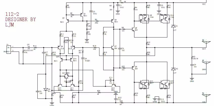

Does anyone know which version of L12-2 this is? It shows darlington ouputs, but their part names are not....

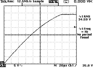

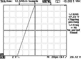

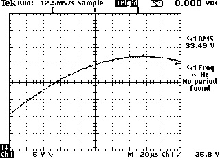

So, as I planned, I replaced the last A1837 transistor on the PCB with the Toshiba A1837. The result is the same oscillation as previously. I can add pictures of PCB, Scope, and transistors. But I don't think I'ts necessary after Michael Beeny showed absolutely the same results.

What is the correct resistor value for the 6x Output Devices? It was once 2R2 but I have seen them as 1R5 and 1R0. Thanks

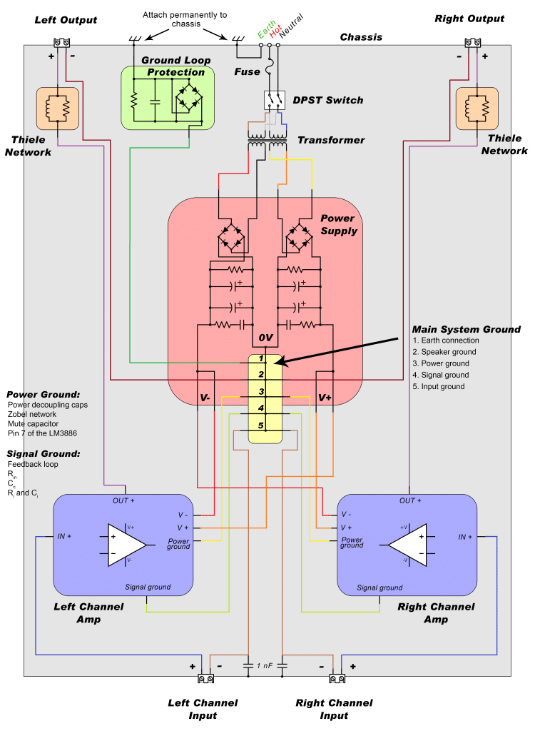

Hi Berlusconi. I am a little puzzled that you suggest to dakku that he "duplicating" the inputs grounding connection? (POST1,024) I can only see ONE gnd connection the to the star earth on his diagram. The amp wiring diagram you show, (above) does however do it the very same way as I would do it, IE: with BOTH input grounds remaining separate all the way to the star-earth. Many thanks for explaining things.@dakku, first, we are all friends here - there is no need to refer to anyone with "Sir". Though, I understand that as a habit of a courteous gentleman.
Correct, except connection to the input onboard "GND" should not be connected. Your signal input ground is already connected to the board ground. You can verify this with multimeter continuity check.
There is no need for duplicate connection of the input "GND" through an alternative route. (Occam's razor)
Below is a wiring diagram from the internet by Scott Campbell published in his great article entittled "A Complete Guide to Design and Build a Hi-Fi LM3886 Amplifier".
Go and read it - there is plenty of useful information in this article even though it is about another amplifier configuration. Basics of wiring are the same.
B
Thanks for pointing to this: you're right. My bad.
L12-2 has GND so close to the input terminal that I've thought his purple lines (GND) have been connected to the input ground. That is the most common cause of hum. Input GND on the board is useful just when testing individual boards but when the both boards are connected, the input GND should be disconnected. It is impossible to overemphasize the need to use thck wire and the shortest path from GND to the star.
Thanks again @sonicles... and appologies to @dakku. His last schematics was correct.
EDIT: In fact Campbells schematics has double GND connection to the star. It should be single.
EDIT: When I think (contemplate) this issue I use less common concept "return path" instead of "ground" and even more confusing "earth".

Thanks for replying to me Berlusconi. However, you say above: "EDIT: In fact Campbell's schematics has double GND connection to the star. It should be single.". I have to differ and say, in my opinion, Campbell's method is correct. I think dakku should also have used 2x individual wires from the input grounds to the Star Earth, (he shows just the one GREEN wire on one channel). Some builders short the incoming signal ground at the input sockets and have one wire back to the main earth point. Having two wires makes certain there are no earth loops before the signal is grounded, and it will result in less hum or other signal being induced into the signal input. HOWEVER, it is often true that both channels have their earth side (but not always) joined together inside the preamplifier, so maybe one should try both a single earth (as dakku shows) or use 2x separate earth wires as I usually prefer. (as does Cambell). One method should result in less noise pickup
Indeed. This line of reasoning correctly involves the need to analyse the system as a whole, including the wiring of the signal cables. However, my reasoning is as follows: If we connect both GNDs to the star we end up with two conductors of different impedance hence creating unnecessary difference of potentials, however this difference low is. Let me again refer to the good old Occam's Razzor. (Ockham: pluralitas non est ponenda sine necessitate, “plurality should not be posited without necessity.”)it is often true that that in both channels, the earth/ground side will, very likely, (but not always) be joined inside the preamplifier, so maybe one should try both a single earth (as dakku shows) or use 2x separate earth wires as I usually prefer. (as does Cambell). One method should result in less noise pickup
But you're absolutely right: different paths and cable connections should be investigated because you never know in advance, in the real world, which is the best, without empirical investigation. When unsure I measure distortion for different configurations using FFT analysis. Human hearing simply isn't reliable enough for this purpose.

So Version 5 with the Toshiba transistors. Look like that with 66000uF per rail the amp feels better than with SMPS. And here a two questions: what about PSRR, and/or who can ensure that either short-time stability issue will not cause an amplifier failure? Then the bias stability: Last time I set the bias to 4-5mV, but now after tests, the bias was 15mV. 300% deviation?! WTF! I Allowed the amp to cool, then adjusted the bias to 5mV, and then I heated the amp again near 45 degrees C. Bias being 7.5mV.
While there are no visible artefacts, the performance of the amp, due to the "strange" behaviour of the bias, is still questionable. So there is time for the Cosmos ADC and THD IMD Noise plots. Stay tuned to that channel...
... P.S. When I finished writing all of the above, I tested bias again at 3.6mV. Stability is here!
