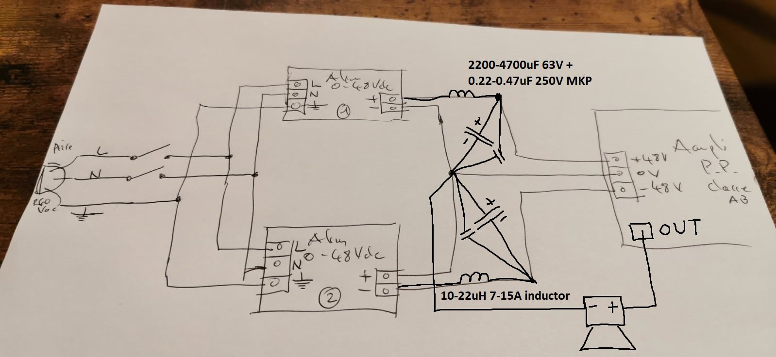

Hello,
So this is a duplicate to this post that I can't delete
I got this smps for my l12-2
https://a.aliexpress.com/_EuE444c
The thing is that it does not have any ground connection on the dc side so i grounded my amp boards and speaker output to the socket.
Everything is silent until I turn my dac on. When i do that, i get a hard buzzzz
When i connect my tablet instead of the dac everything is silent. In Guess have a ground loop with the dac.
My question is finally how can I ground the dc side? (Speaker negative and board ground)
The ground of the amp board and loudspeaker negative should be connected to the SMPS ground terminal.
Then just break the ground loop with a USB isolator.
Disconnect the DAC input from the source and check hiss, if no hiss - use usb isolator. If hiss persist - try isolation transformer
Thanks tolik,
I can still send the smps back, i will take the same one as you in order to have a straight forward setup
When the jacks are off or the dac not powered there is no noise, it is when the dac is powered that the problems start
I will try disconnecting the usb
Finally an electonician friend told me I can make the 0 point with 2 transformers. As this one is good quality and dead silent, i will get another one and assemble them like on this schématic
Just pay attention next time you choose a power supply. The one you purchased is a SINGLE output power supply. It is say 0 +50V. It is ok for class D amplifiers, of single-ended linear amps, like Hood 1969.
For a linear amp with bipolar output, a BIPOLAR (or dual, or +/- XX volt) power supply is required. Its output is -50 0 +50V.
This is what I use
https://www.aliexpress.com/item/100...order_list.order_list_main.550.3a131802UWa2u8
One such board can power 2 L12 boards, or with 2 such SMPS, a very nice dual mono configuration is possible.

I am tempted to just buy a 2nd rectifier board and run the two boards from one torodial transformer.
Do you think that should take care of ground issues?
Hi dakku.... Don't bother. I have 2x power units the same type as your single one) and I am having IDENTICAL hum problems as you are. I've spent a day on it but nothing changes the hum. With ONE input connected, on whatever channel, the amp runs with zero hum. When you connect the second input (even with its ground not connected) there is a hum..... I think the ONLY way is to have 2x transformers with the 2 PSUs so each amp is COMPLETELY separate from the other, like Dual Monos in one box.... having suggested that, it would be around 100 quid+ at least, and I'm not absolutely sure even that would take the hum away. I am COMPLETELY baffled and have made lots of power amps without hum problems.... I just do not know what is going on. BTW isn't the input resistor the 33uF solid electrolyte can that is now called C4 rather than C5?... I'm sure LJM has fitted an input blocking cap. NB**** With one toroidal and 2x PSUs they are still connected together by the NEUTRAL centre tap of the 2 windings that will be shared, so there is a link between the GROUNDS that feed each amp board.... the neutral input on the PSU is cross connected to the output GROUND terminals on this design! As said above, the ONLY way to break the GROUNDS is to have 2x transformers and 2x PSUs
