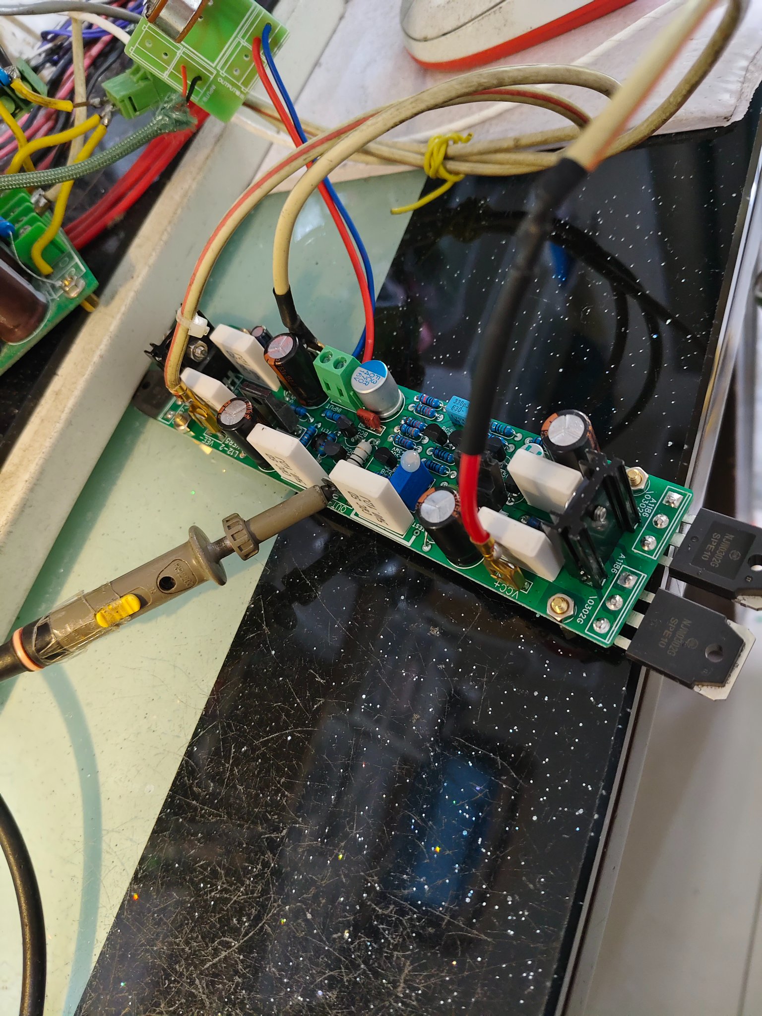

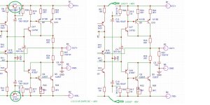

L12-2 CFP Output amp 120W*2 8R
The CFP structure has the best thermal stability in the world. If you can understand this structure.
Just tighten the two 2SA1837 screws on the circuit board.
If static current changes with temperature. It's obvious. The screw of A 1837 is not tightened.
Just get some silicone grease.
Additionally. Regardless of whether the power transistor is ON SANKEN. or Toshiba. There is no difference at all.
But the power tube needs to be installed on the radiator.

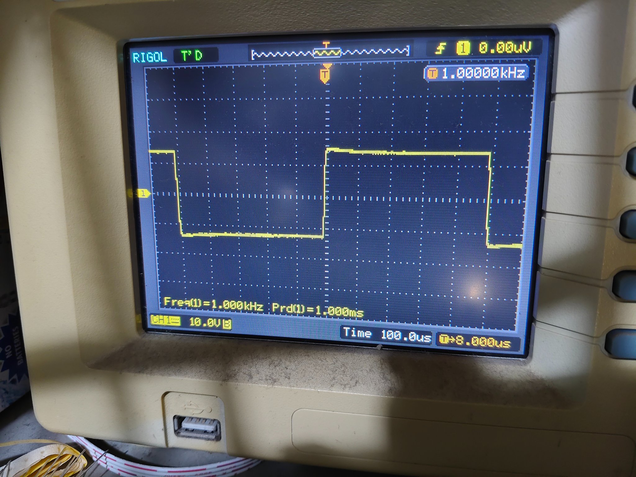

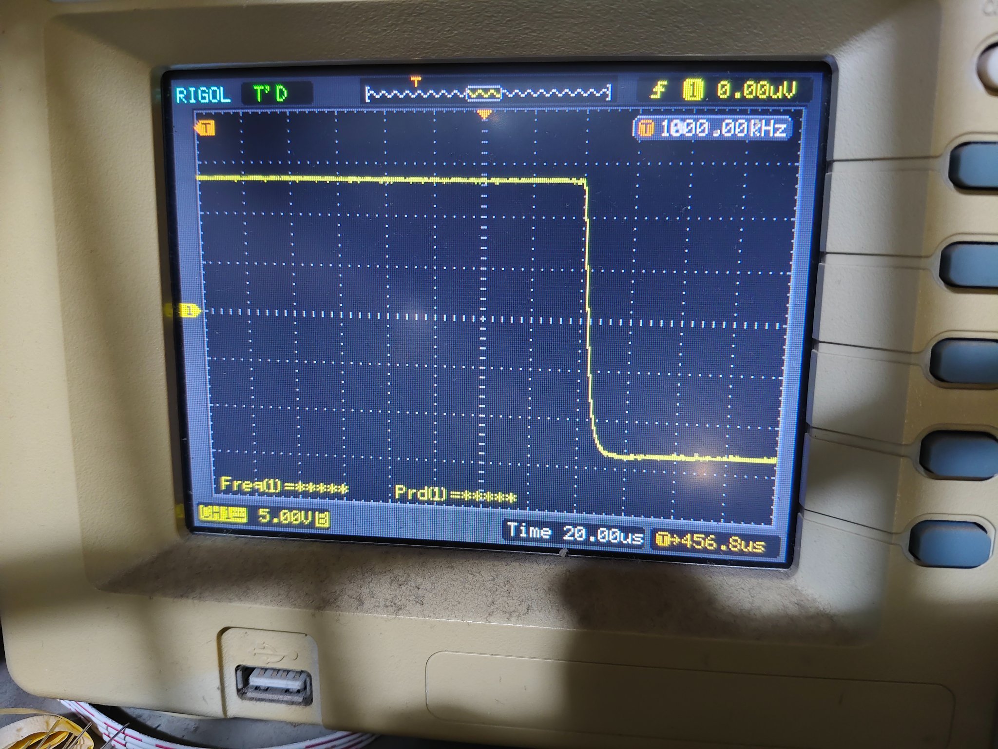

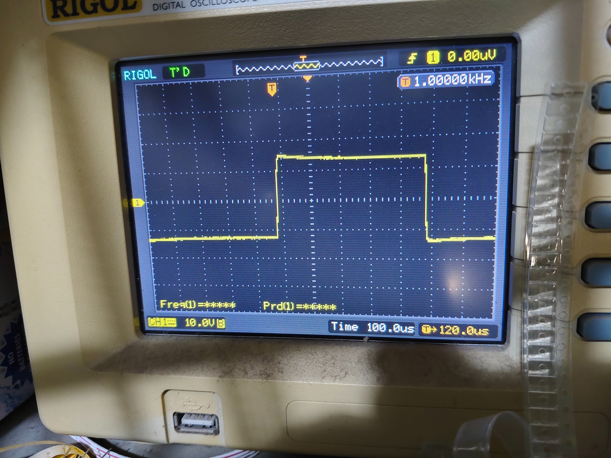

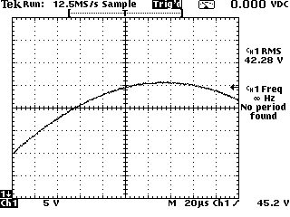

Add measurement images. business as usual. There is no instability.

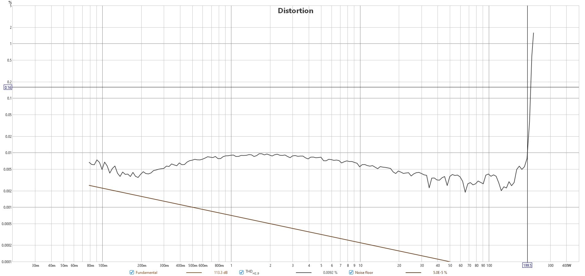

So L12-2 V5 (Toshiba transistors) with linear PSU. The transformer is 400W 2x37V 2x2.7A rated. The filter is 3x22000uF per rail JCCON caps.
The bias was checked after powering on as 3.2mV (last time it was set to 5 mV), was adjusted to 5mV, and then the amplifier was preheated with 1W output power for 30min. then bias was adjusted again. During tests, bias floated 5-15mV. The amplifier module was tested on a 200x70x30mm heatsink. While 8Ohm load tests, the heatsink became pretty hot, and testing at 4Ohm was impossible without a fan. So take care while purchasing the "recommended" heatsink on Aliexpress, that even smaller than I used.
Ewen with a 400W supply, V5 can't deliver the 120 clean Watts promised.
Do I going to power my new MoFi 888 with that amp - no. Regardless of THD figures. Amp should be stable with SMPS, bias should not float. And my Wolverine modules have arrived...

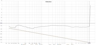

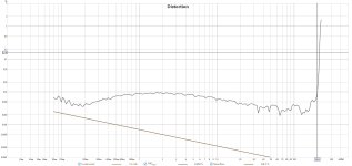

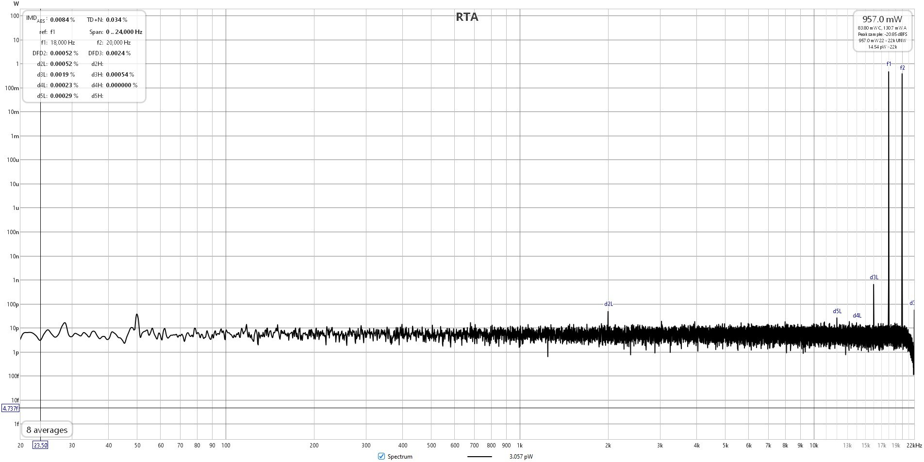

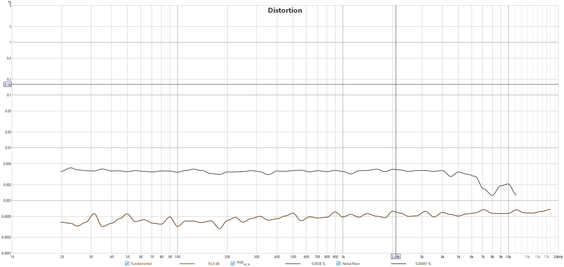

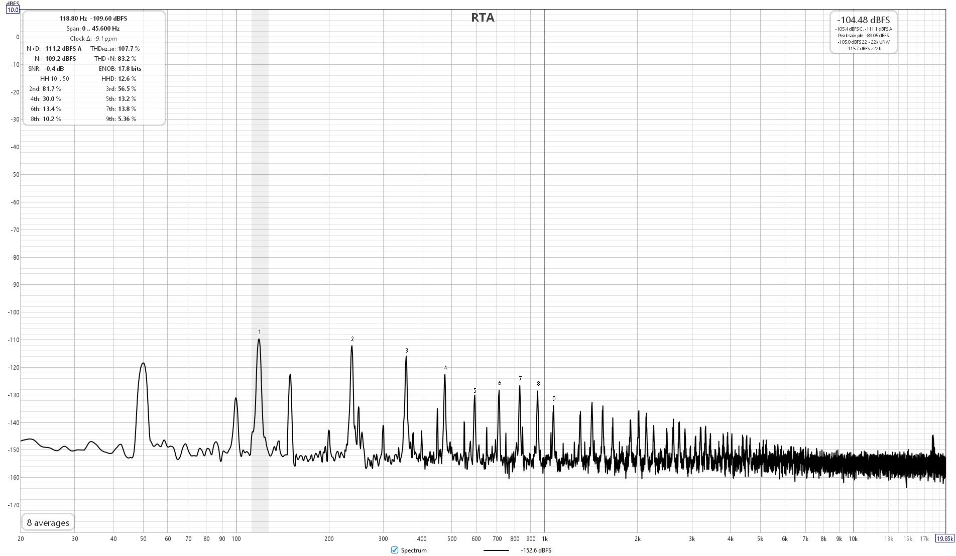

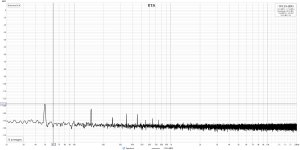

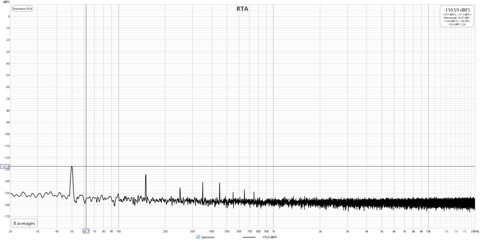

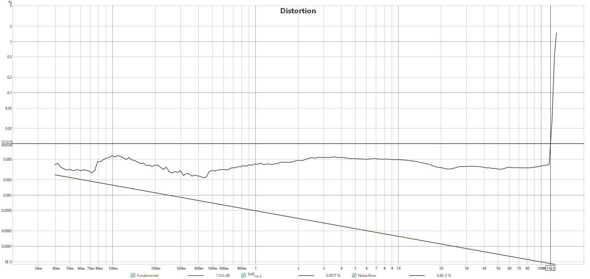

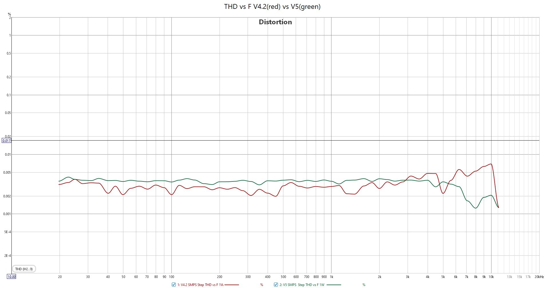

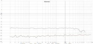

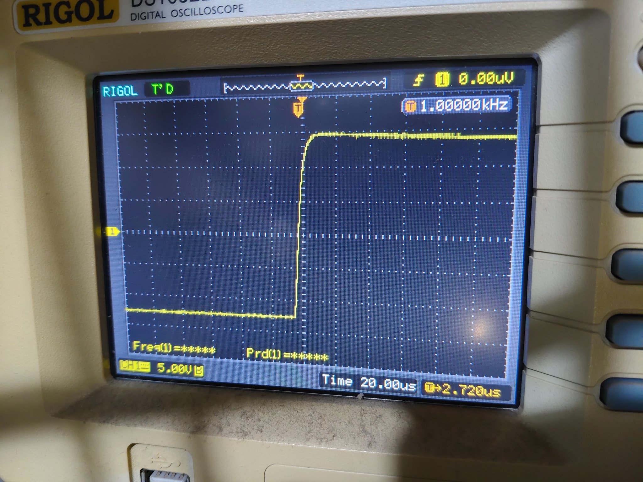

"oscillations" might originate from environment, not from the design itself.
Why “oscillations” not originating from v4 boards? Same environment, same signal source, same power supply?

V4.2 will not be better. But the V4.2 input transistor has a voltage regulator diode. There is a 5V6 diode.
It can avoid high-frequency oscillations generated by SMPS. And V5 does not have this voltage regulator diode.
But if we don't use SMPS. V5 would be better. Because V5 adopts CFP input structure.
V4.2 will have a DC output of approximately 20MV. And V5 usually only has 0.1-3MV.

L12-2 VER 4.2 has a voltage regulator circuit as its input. So it's just that this situation won't happen.

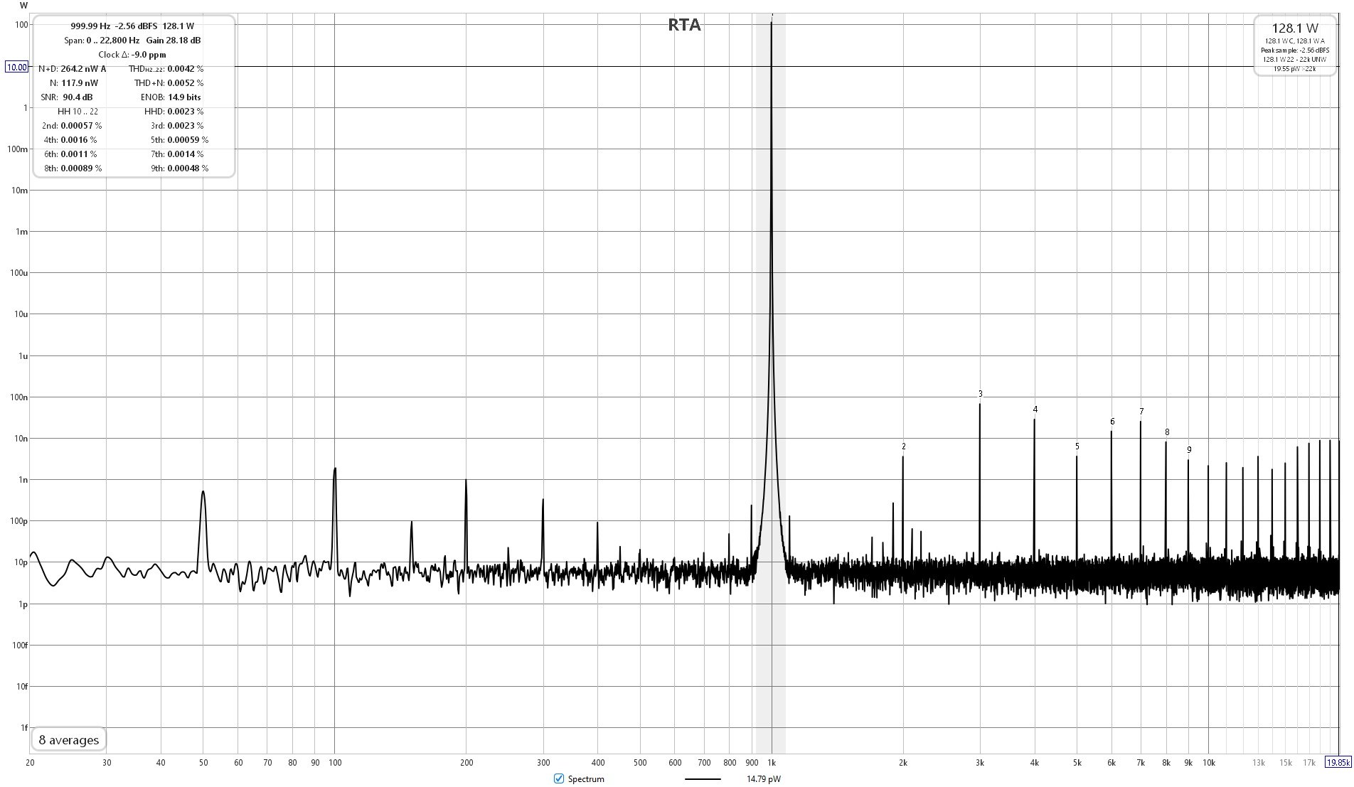

The noise floor isn't great like with linear PSU, but still at good -103dbfs/A

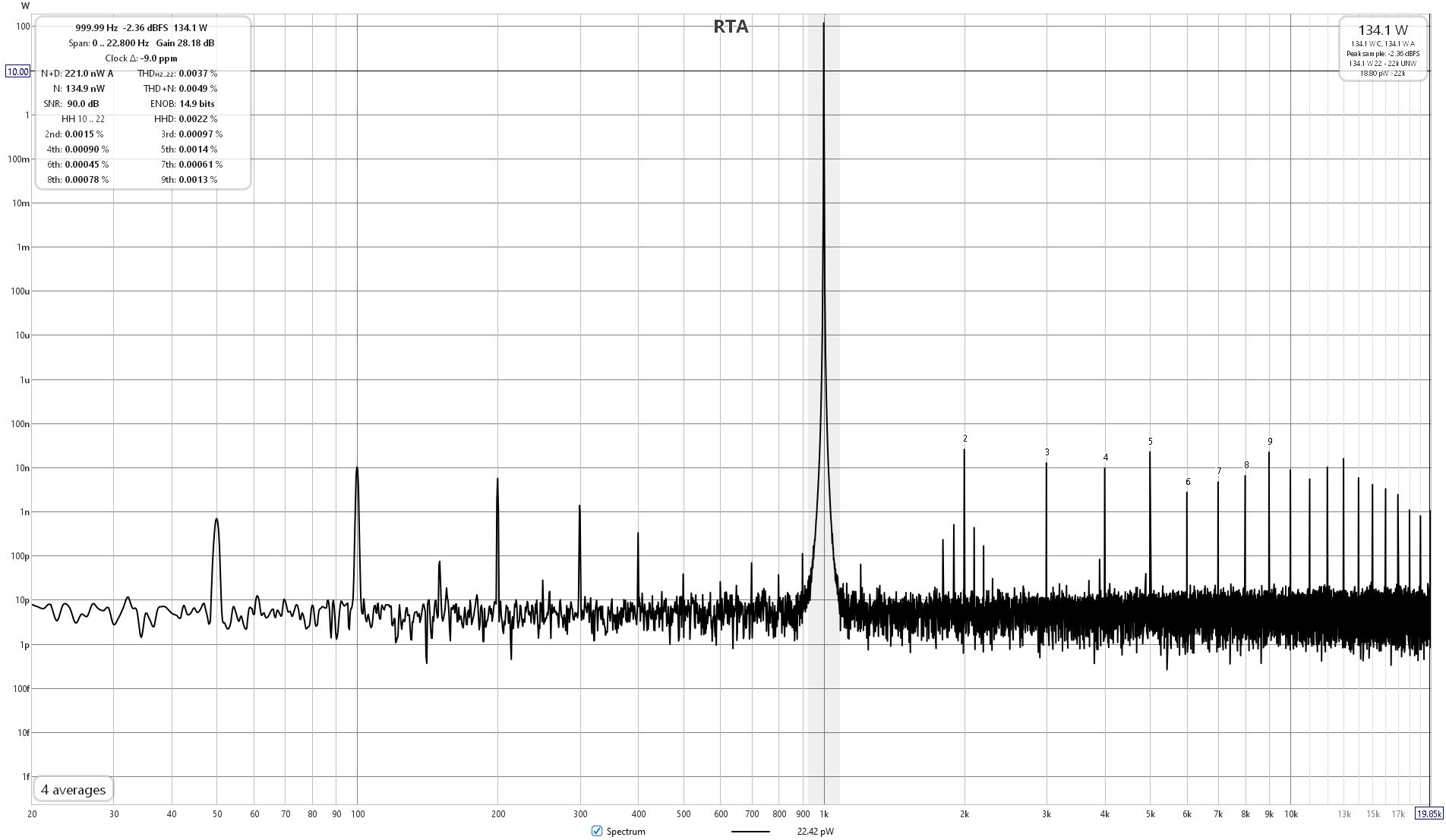

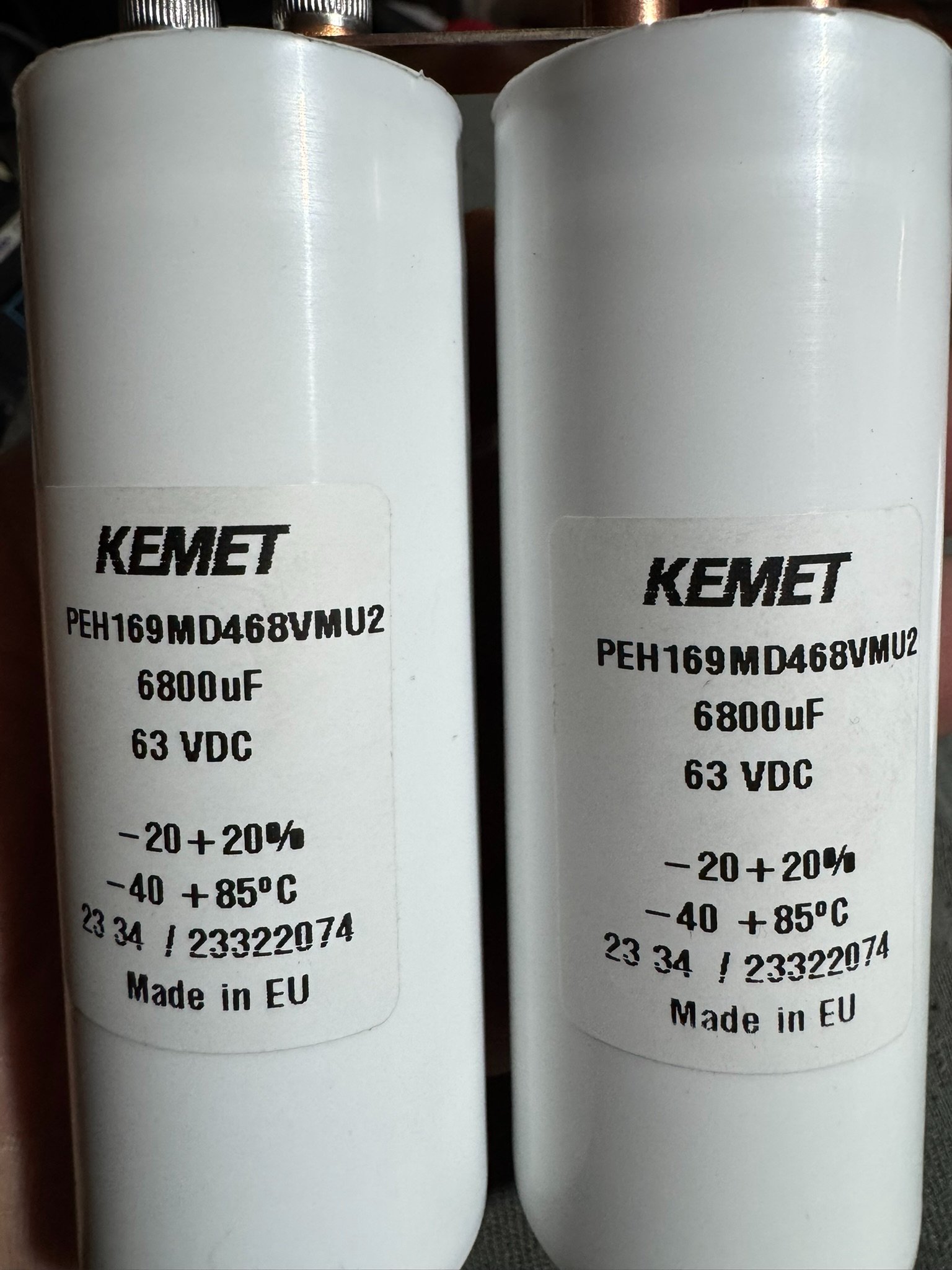

Power output - up to 134W within 0.004% THD. Great, inexpensive SMPS outperforms linear PSU with a 100-euro transformer.
Ripple - IT'S NOT HERE ANYMORE. There is no need for reworks proposed by Michael Benny. Just PROPER filtering. LJM was right when told that V5 can't tolerate SMPS noise. I was correct also when I told V5.2 should be able to work with SMPS. Hope LJM will hear, and make L12-2 great again.
Each thing has its drawbacks, and my approach is taken here, not an exception. So minuses of those caps are:
The price of ultra-low ESR ESL is Lifespan. It is shorter than 20,000 hours of Vishay caps.
The price is $29.90 per cap.
The SMPS should be able to charge a massive power bank. That's all.

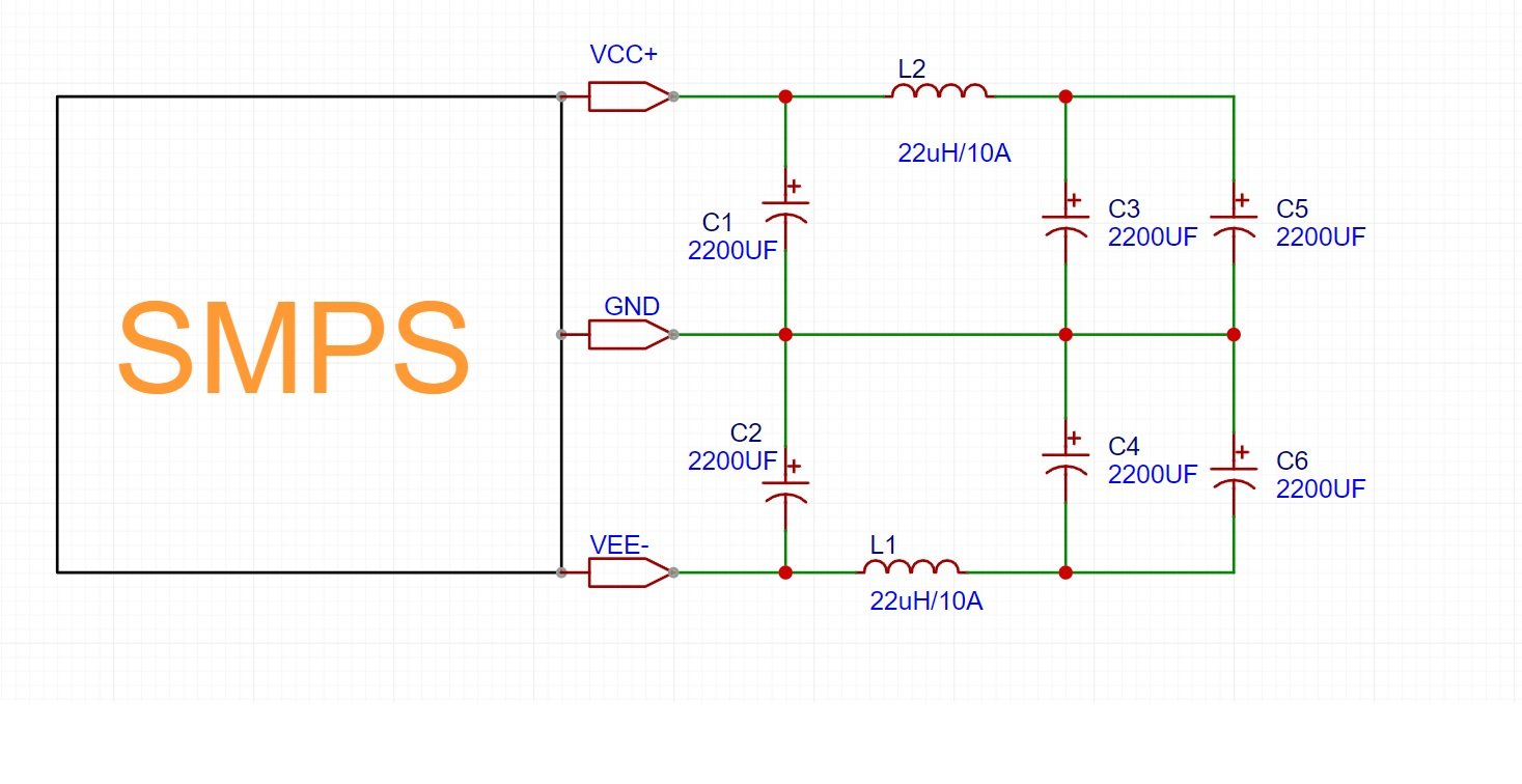

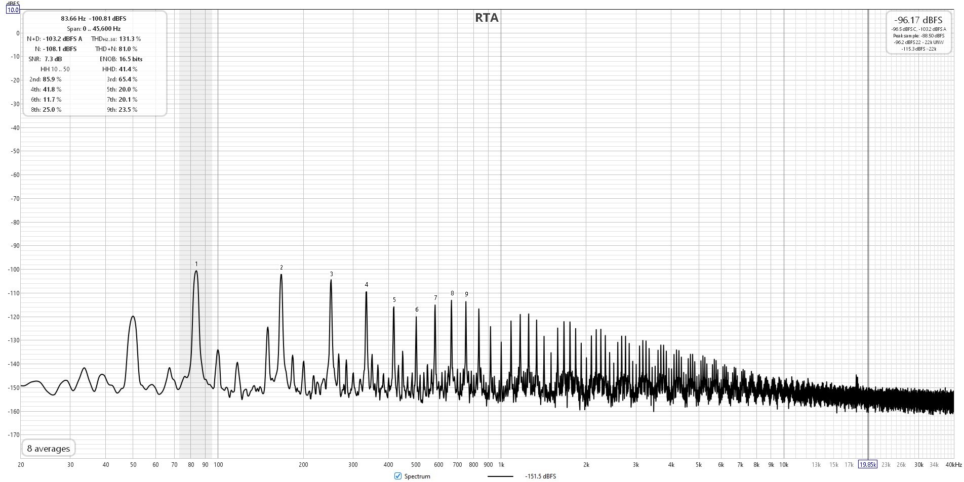

During continuing research on how to fix the side effects of LJM's attempt to squeeze every last coin from his latest creature, by omitting several cheap, yet important components, and compromising the quality of his product, I came across the idea to follow one old good document, released by Ridley Engenirreng. Dr Ridley suggested a simple way to reduce output SMPS noise: C-L-C filter. I found suitable 10uH inductors. 10uH is a bit low, but enough to see if the idea is working at all. To make things perfect, I added 2x5.6uF MKP.
First I added MKP and the noise was reduced by nearly 3dB, then I connected inductors and got the next -5dB, a total of -111dBfs/A
I noticed an interesting effect: the noise floor, just after powering the amplifier on, was 97-98dBfs, the number increased slowly, and after either 5-6 minutes, it stopped at -103dB (MKP and inductors were still not added) Just like a tube, or massive class A amp, and of course not due to bias instability. I repeated the cooling-heating cycle, with the signal applied to the input of the amp, and monitoring of THD. 0.009% THD dropped to 0.003% after the same 5-6 min. I remember and trust in LJM's words - "bias is stable".
The total cost of the filter, assembled by point-to-point wiring, (not including PCB) - near $80. Just like 3 sets of L12 V5. Just because somebody saved on the coin-priced components.

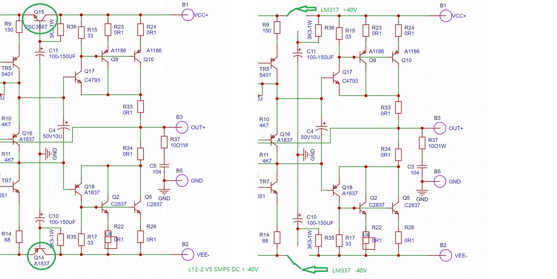

Different SMPs are different. Do not compare different amplifiers using SMPS with L12-2.
Because some SMPS outputs a DC voltage closer to that of the battery. Some SMPS outputs have high high-frequency interference. This is not related to the amplifier itself.
There are rarely significant differences between different circular transformers. But there are significant differences among different SMPSs. SMPS with the same power may have a price difference of more than ten times.
Many SMPS, especially DIY SMPS products, are unqualified. This is quite common. They lack filtering capacitors. Filter inductor.
Adding CLC can avoid this situation.
Relatively speaking, the output ripple voltage of SMPS with higher operating frequencies will be lower. There is less interference.
Alternatively, a voltage regulator and a three pole current expansion circuit can be used. Provide power to the power amplifier.
All these plans. Suitable for all SMPS+AMP solutions. It's not just related to L12-2. Most SMPSs have the same issue.
You can also modify the input level power supply module of L12-2. Add LM317.337 for separate voltage regulation power supply. Provide separate power supply to the input stage.

You should modify this sentence to. Try to avoid using all analog power amplifiers as much as possible when using SMPS.
Including LM3886 LM49810. Because they yield the same results as L12-2.
Additionally. Not all SMPSs have the same problem. For example. ASTEC, Delta, SMPS is very good.
Don't always categorize problems as L12-2 problems. This is why your SMPS output is very high. High frequency interference. That's it.

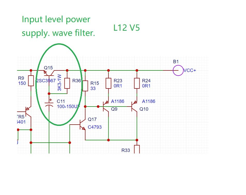

In fact, the input stage power supply of L12-2 V5 has exceeded 95% of the power amplifier modules.
It adopts the method of transistor+filtering capacitor. In theory, it is equivalent to using two 10000 UF capacitors separately for the input stage.
I know the possibility of providing a separate supply to the input stages, and I know IC better than 317/337, specially designed to deal with SMPS output voltage. The question is why do I need it at all? Why do buyers have to pay for your attempt to cut the price of the board? Why do the sellers of 12-5 not warn buyers about SMPS incompatibility? It is so expensive to return the zener diode and cap? It is so difficult to add "DO NOT USE WITH SMPS" in the description?
It's impossible to fix bias walking?
What's next? Single-ended V6, with one output device, because 20-30W of output power is OK for comfortable listening level, on most loudspeakers, in most apartments?
The amount of the modifications proposed to V5 is enough, to build another amplifier already. So what do we need V5 for?

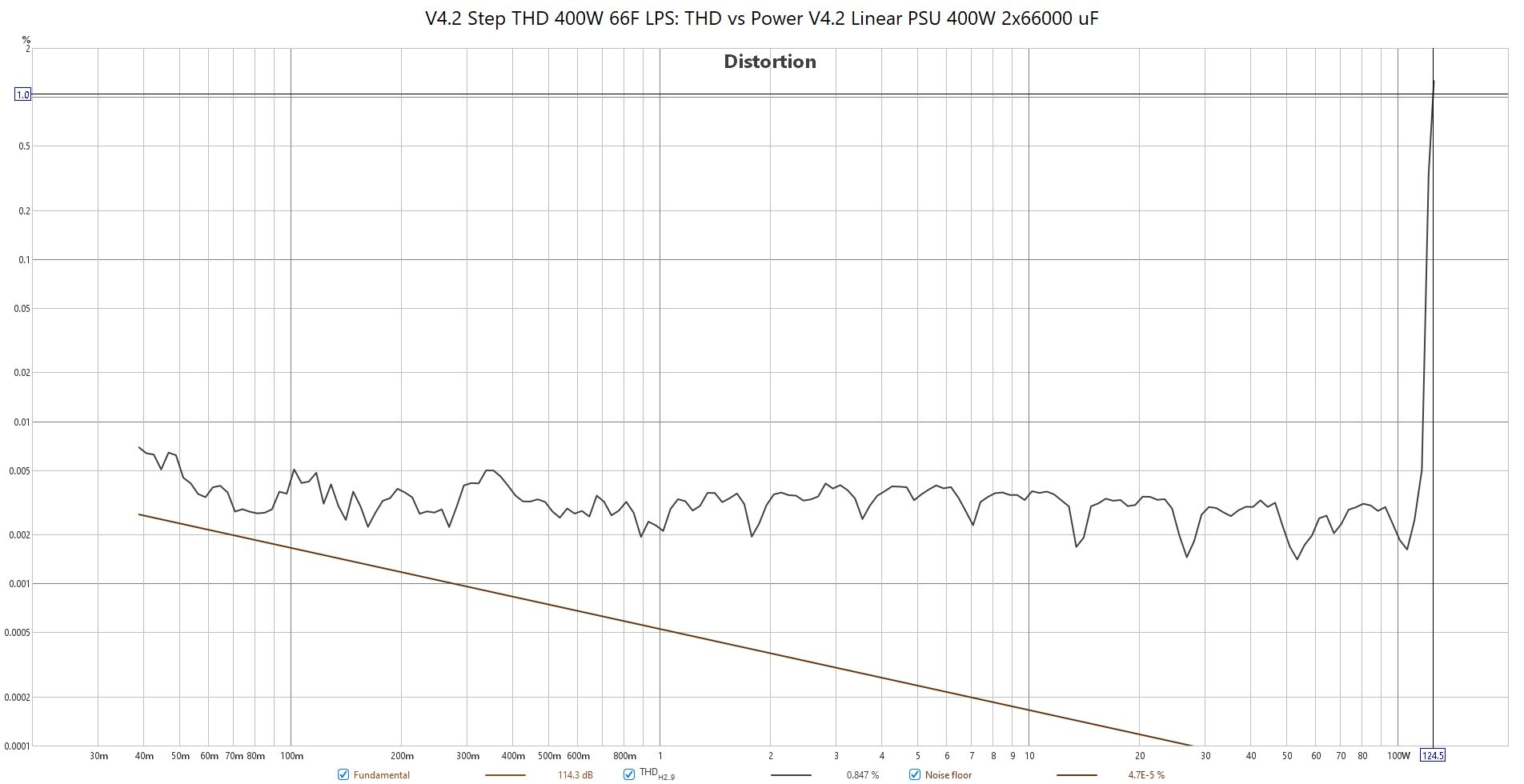

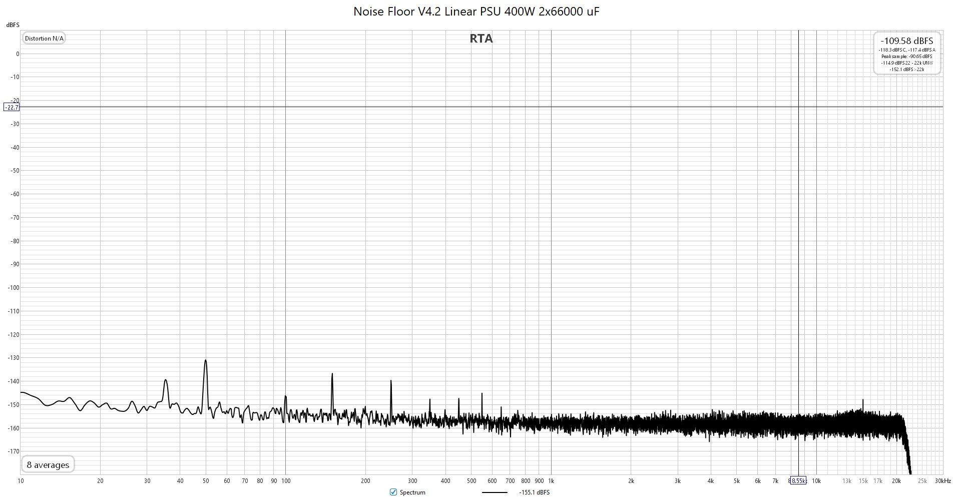

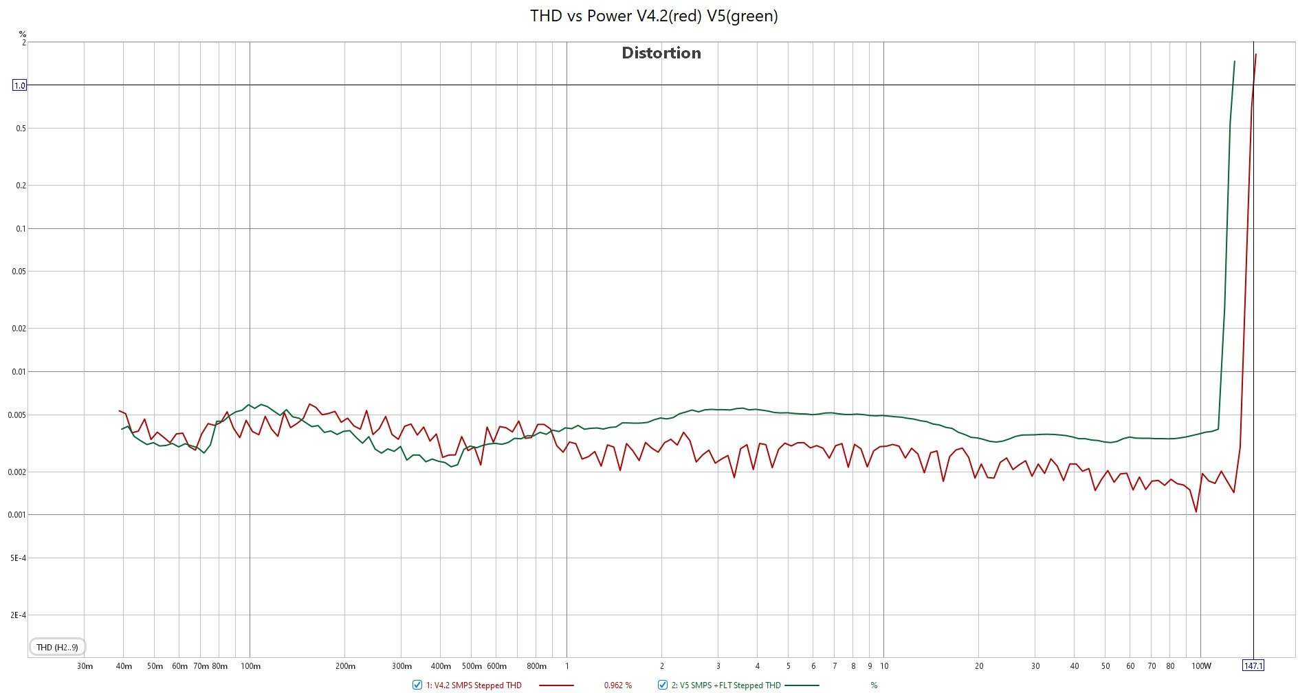

V4.2 measurements and brief comparison to V5.
Noise floor: V5 show no advantage with LPS over v4.2, while with SMPS V4.2 is the clear winner with 114-117dBfs vs 103dBfs of V5
THD: V4.2 Linear PSU 400W 2x66000 uF at its best.
Efficiency: V4.2 is the clear winner.
IMD: V5 does not show superiority
So V4.2 works perfectly with the bare SMPS, with no additional filter, while V5 asks for low-noise SMPS or Linear PSU.

SMPS +V4.2 working well even with no additional filter.
Why do we need to pay that extra in the case of V5? - Probably to allow LJM to save almost $1 on the Zener diode, small capacitor, and pair of small signal transistors. Is it possible to solve the problems of V5? - Yes, the designer should understand, that fine measurement instruments are available and affordable even to housewives today. And each step, each attempt to sell the snake oil, can be validated easily.
