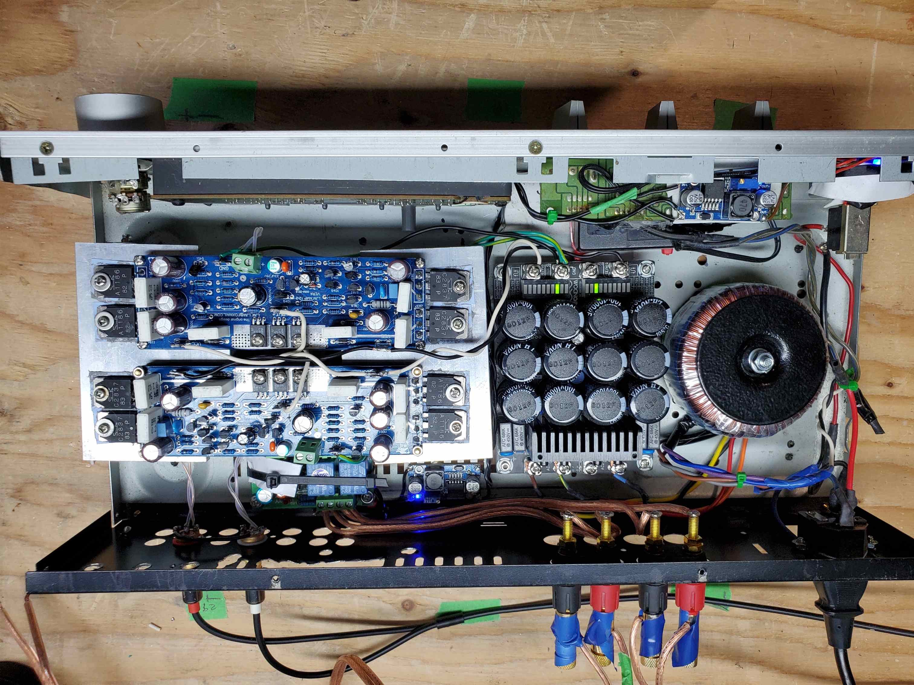

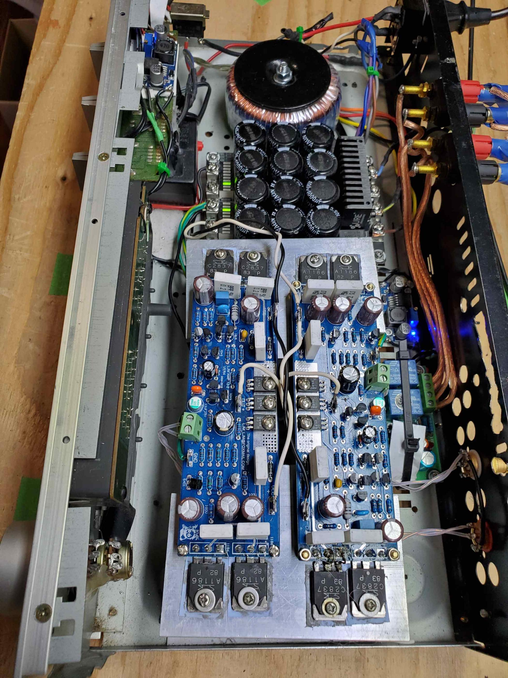

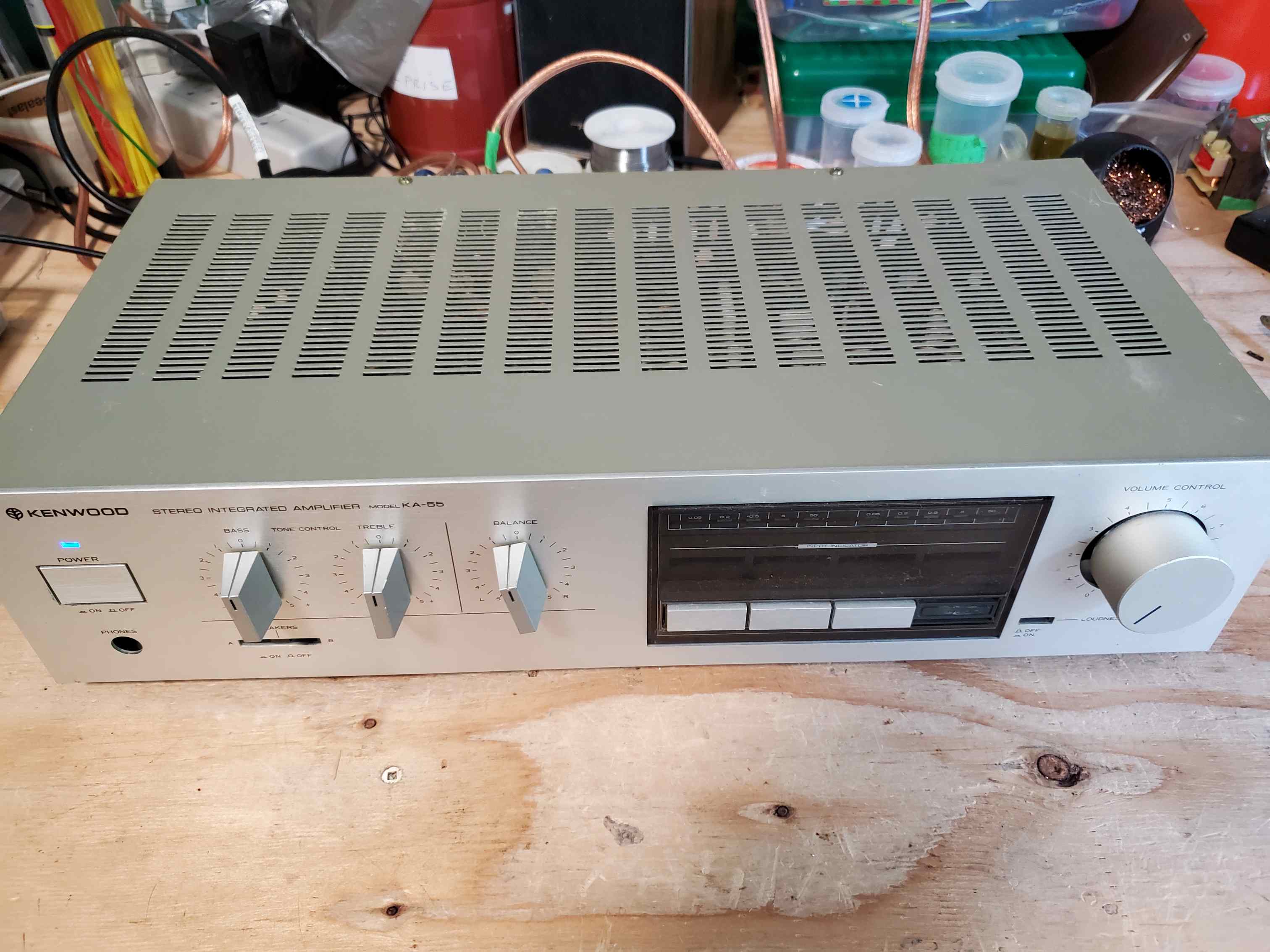

I have relocated the L12.2 from the original case to a second one, as I got its PSU back for the MX50X2.
The latter (MX50X2)I like it a lot and I ordered a second for bi-amplification.
For now here are some pictures of the L12.2 that I put in a vintage Kenwood box, previously it was a class D amp that was in it, an IRS2092 based amp for the bass.

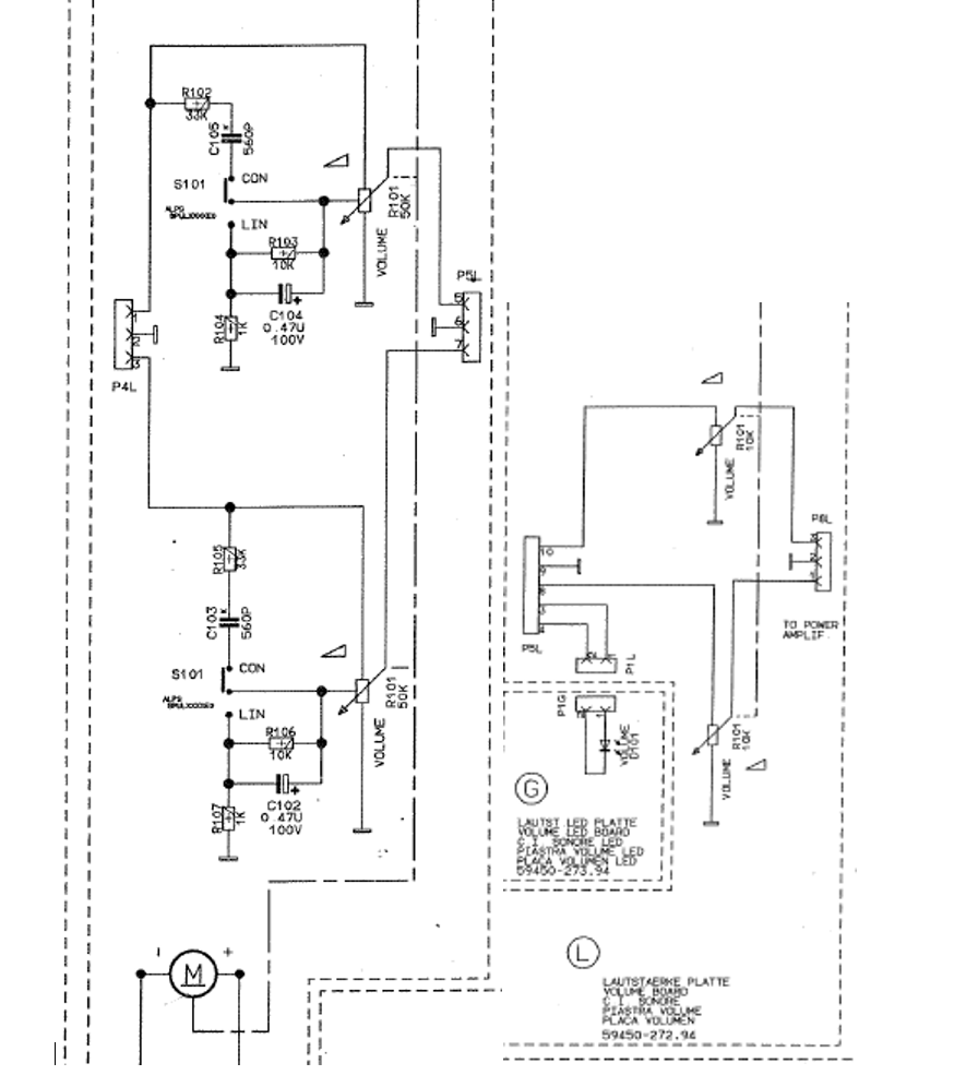

@tp1975 thank you for coming back to this topic as it is still not solved. The main problem is that when I power up both L12-2 without preamplifier connected to them there's no hum at all. Therefore I do not blame my PSU.
The hum apperas not after connecting whole preamplifier ( powered from the same PSU ) but just the volume/loudness assembly with motor as seen on a picture. There are 2 x2 potentiometers on that plate. One set is for signal into preamplifier and second set is for signal out to power amplifier. Don't know what causes that hum and I am asking for an advice.
