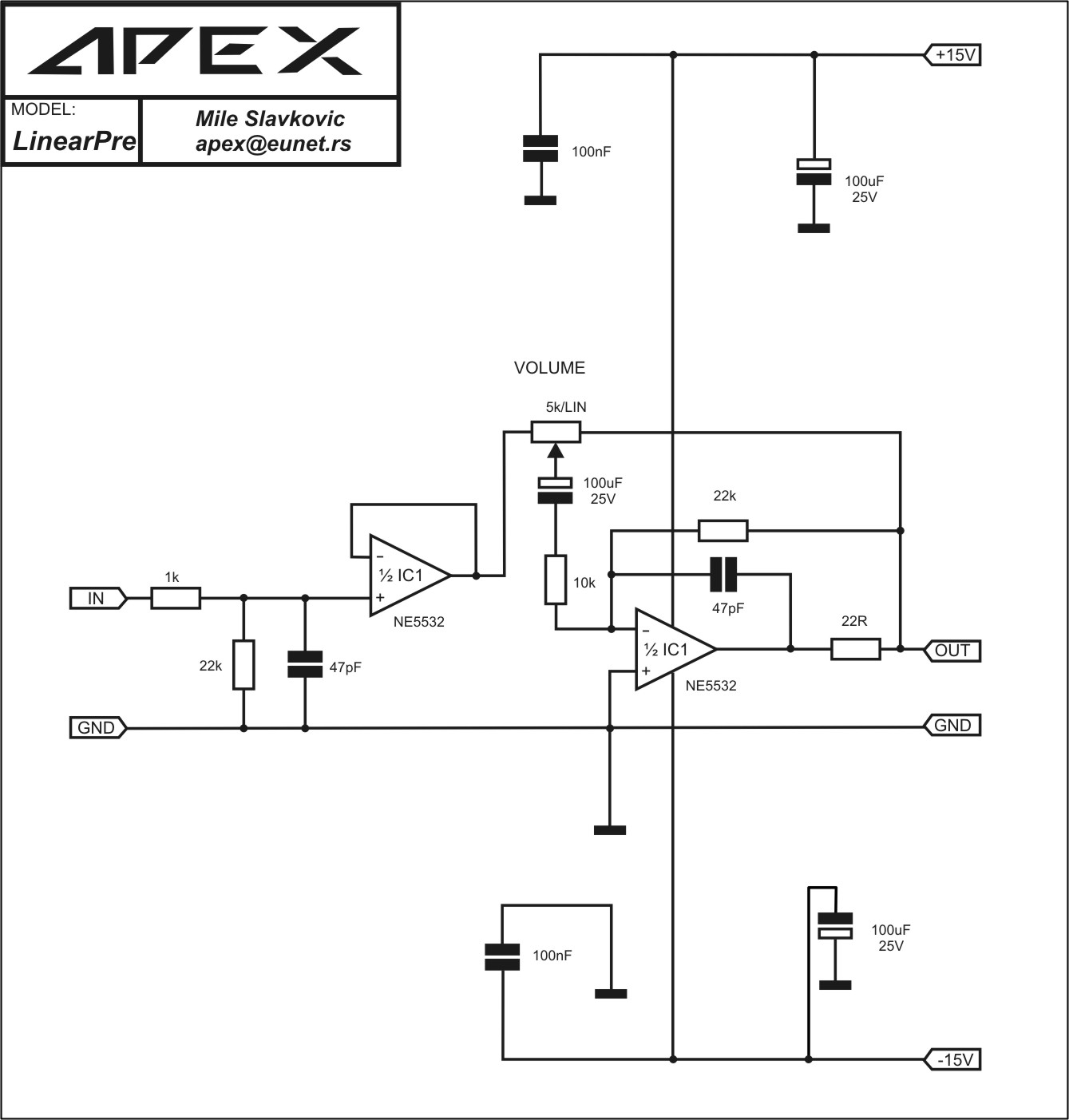

Anyone see anything that can be added to this buffer amp or will it work as is?
After reading through the forums, I quickly realized that if I'm going to use potentiometers for these L12-2 v4 amps, they should be a buffer type circuit.
The amp sounded terrible with just pots before the input. When I go straight in without pots, it sounds very good. Even with the bias set to 1.3-1.7mV per pair.
Any thoughts?
Any thoughts?

The buffer amp from Apex
There is a misunderstanding, I don't have the Apex buffer. It is rather an OP OPA1692.
Do you have the circuit that you used?

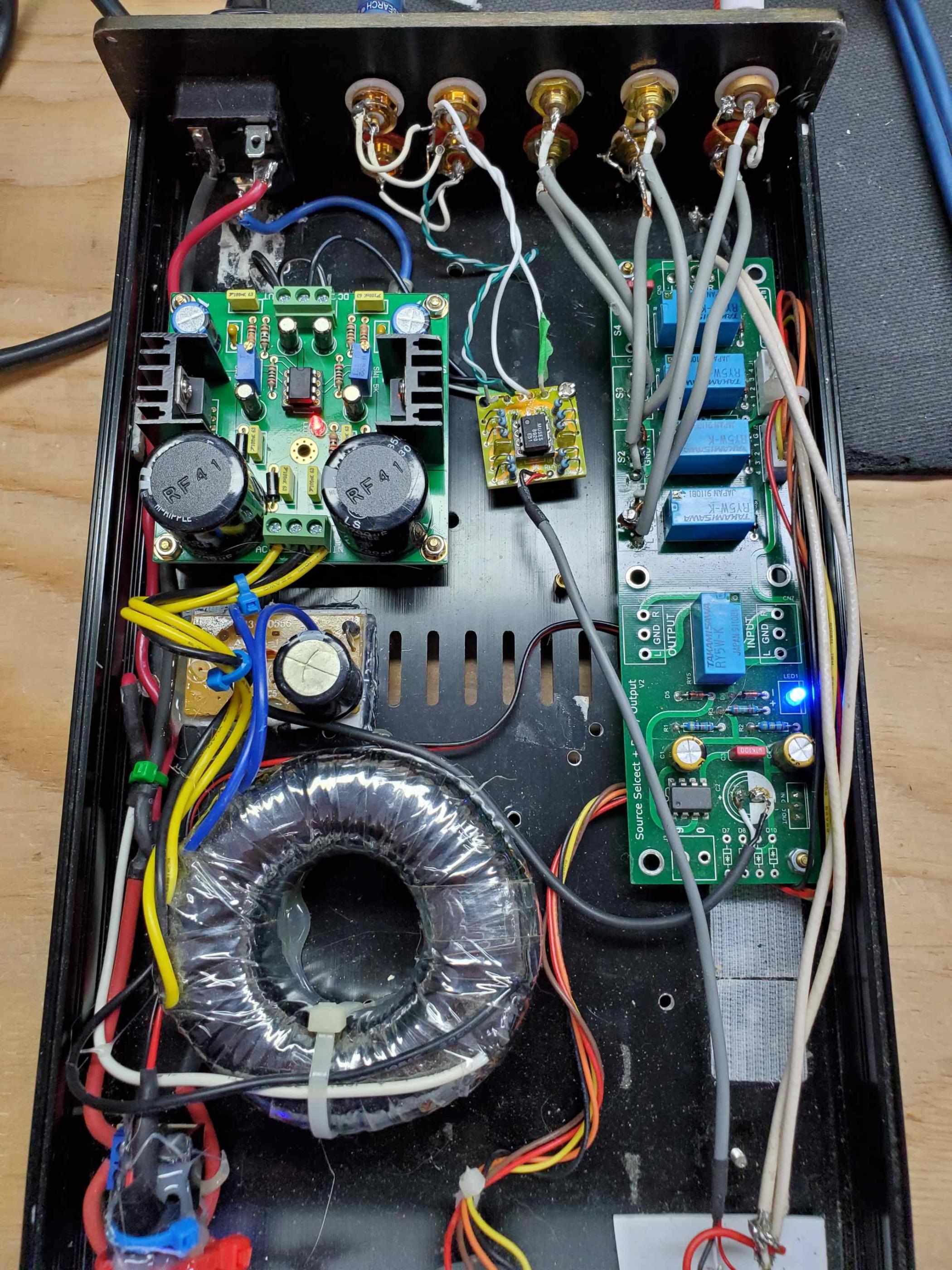

The circuit is simple, I don't have a diagram. The output of the DAC goes directly to the 10k volume pot and the output to the OP, output of the OP to the amplifier. Nothing else. I have 2 PSUs with 10k pot and OP (OPA1692). I will compare the quality of the 2 PSUs, I put a photo of my other PSU + OP.

Yes, the amp has low AC impedance. To my ears, all systems sound bad with 10k pot in front of the amplifier. But the standard is to have 47k resistor instead of the 10k resistor in front of the amplifier's LTP. But you cannot change/increase this 10k resistor in this CFP amp.
If your ears is sensitive enough to appreciate the sound of this CFP amp, I think you should not use NE5532. Or you can create discrete JFET buffer before and after the pot.
So use a jfet op-amp like the old TL072's or is there better options?
I meant discrete JFET circuit like what you'll find in Pass Labs active crossover. Discrete JFET is a solution for those who cannot accept the low transparency of op-amp circuit. A good opamp circuit can be very expensive (the opamp and the power supply).
For my part I find the sound exceptionally transparent. It's very difficult to have more without falling into an overly analytical sound.
You have to try the OPA1692 (or OPA1656) you will change your mind.
So I would have to do some smd work I do see to use DIP8 ADAPTERs. Do you think I would have to do anything special to this circuit? or use it as is?
