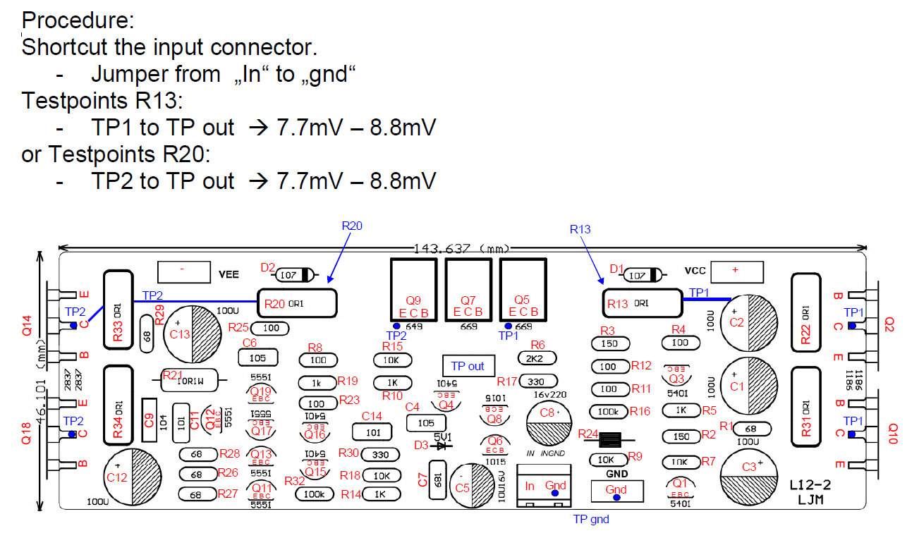

After thinking about it and looking at Calvins PCB and knowing we want about 40ma for each transistor...this works out.
So Calvin measures over R13 OR over R20, not both!
On his PCB, it shows the Collector resistors at 0.1 ohm.
So there are a pair of transistor on each side that a 0.1 om resistor is connected between the collector of the pair and the speaker output.
So his formula 8.8mV (.0088 divided by 0.1 = .088 amp or 88ma. That is 44ma for each transistor on that side.
OK, I think I'm clear... Hope this helps others.
Thanks johnego for making me think!!!

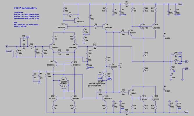

Hi, Calvin says "35-40mA for a pair of output transistors suffices". Total 40ma is enough, not for each transistors.
If current 40ma and old schematic resistance 0.22 ohm(in kit 0.2 ohm). So, voltage on resistor(R13 or R20) max 8.8 mv (or 8.0mv). For 0.1 ohm resistor, only 4 mv.
Speakers not connected when you measure the voltage, so current on the two output resistors are the same as 40ma max.
If you use more than this, transistors will be hot. And I didn't see any difference in sound between 40ma or 10ma?
(note: in this schematic R5 is wrong.it must be connected to base of Q1. nobody wrote up to now 🙂

If you have 0.22 ohm collector resistors...and do the math
?mv divided by .22 = .088 (88ma)
.22 X .088 = .019
.019 divided by .22 = .088 (88ma)
So 19mv measured across one of the .22 resistors.
He should have shown this...
But if you look at the PCB layout from him, it has 0.1 ohm resistors and it says to measure 7.7 to 8.8 mv across R13 OR R20...NOT BOTH...

OK, so between emitters of Q5 and Q9 having 0,22 collector resistors it should be 2x 19 = ca 38 mV
The effect will be paralleling the 100 Ohm resistor, lowering a bit such that the LTP current is a bit higher.
Hello Calvin, Can you clarify your L12-2 Schematics Mods Trim and Probs PDF.
The schematic shows 0.22 ohm resistors and your saying bias 35 to 40mA (7.7 to 8.8mV) OVER R13 AND R20!
Don't you want 35 to 40mA for each of the transistors? So 70 to 80mA?
This should say OVER R13 OR R20. People think you mean across both resistors so they are setting it to low.
To get 77mA to 88mA across .22...
17mV divided by .22 = 77mA
19mV divided by .22 = 88mA
So that's about 38 to 44 mA for each transistor.
Also the PCB layout shows 0.1 ohm resistors.
You say to measure across R13 OR R20...
If I'm doing the math correct...
mV across each resistor...
7.7mV divided by .1 = 77mA
8.8mV divided by .1 = 88mA
So each of the two transistor will get half of this..
38.5mA to 44mA
Correct?

iIrc I used to measure across both emitter resistors, R13+R20.
Reason was to increase measurement accuracy.
For one are the tolerances of low-ohmic resistors typically large and for second is the measurement error for typical 3.5-4.5digit DMMs quite high in those low-voltage ranges.

@mdardeniz: Thank You for pointing to the schematics error.
In all those years no one -me included- seems to have noticed this hoppala 😉
