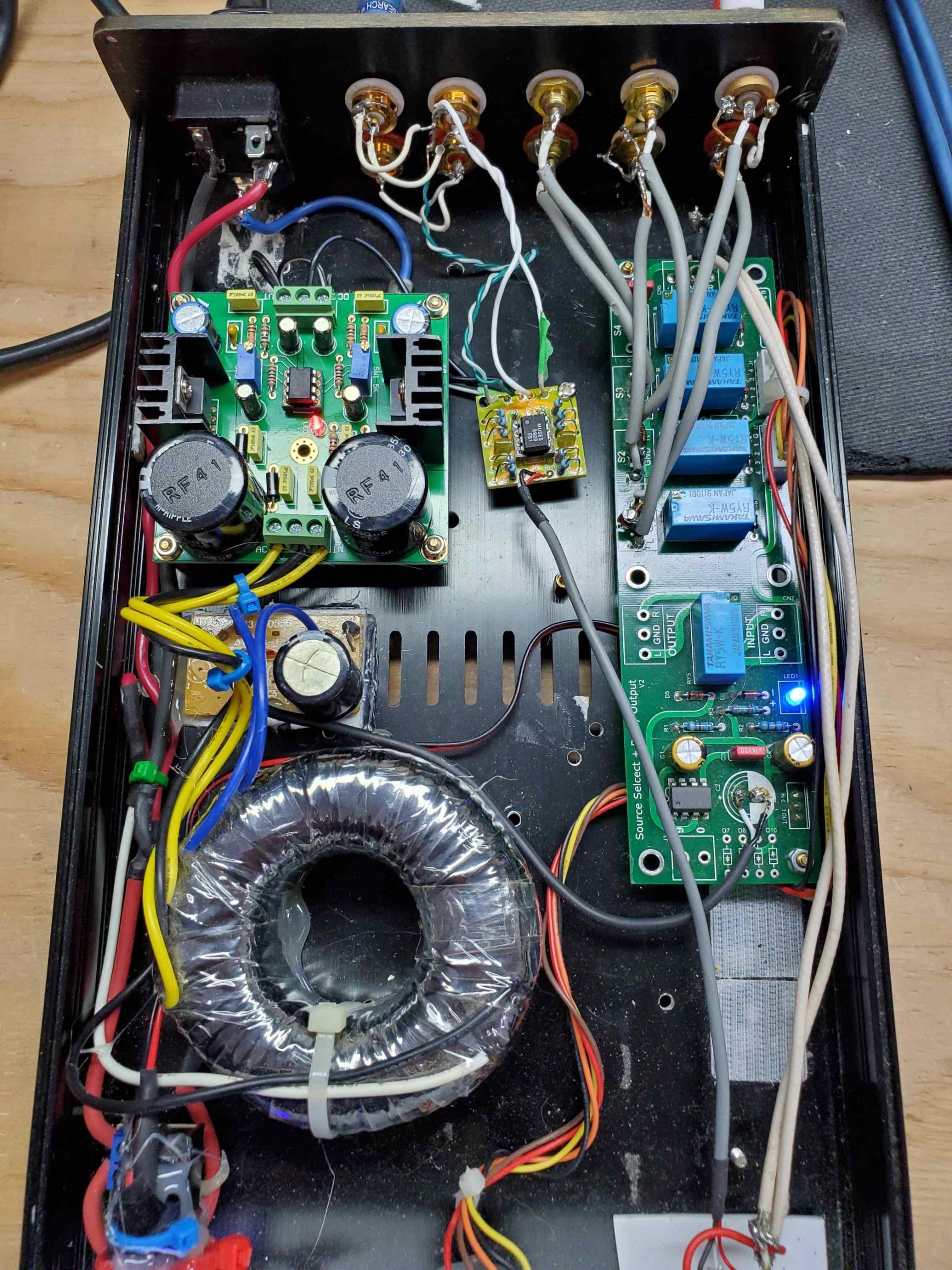

My

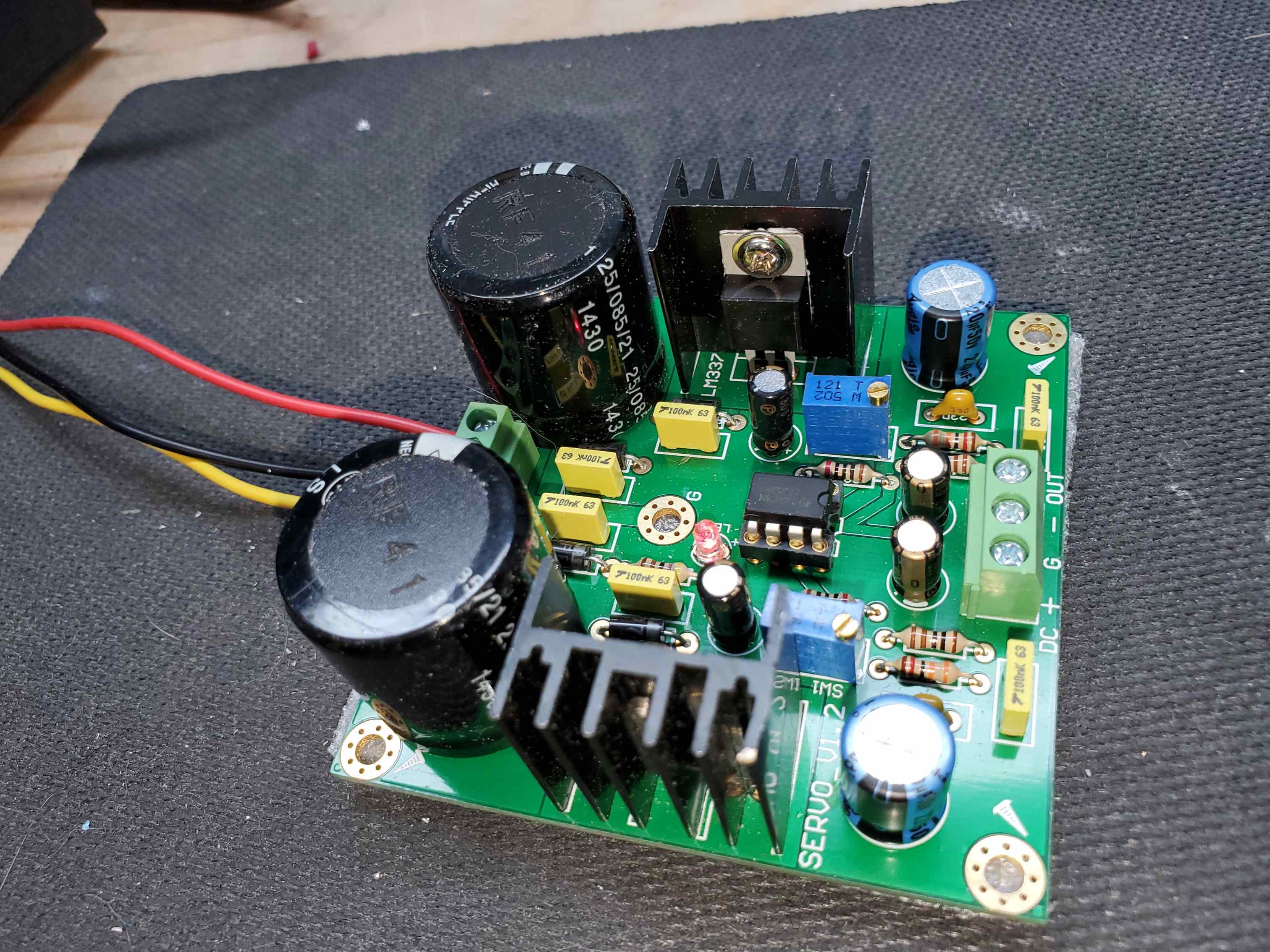

other PSU, I changed the 2 big Elna fake condos by others that.
AC-DC LM317 LM337 LF353 Servo Rectifier Filter Power Supply Module Adjustable 783710088352 | eBay

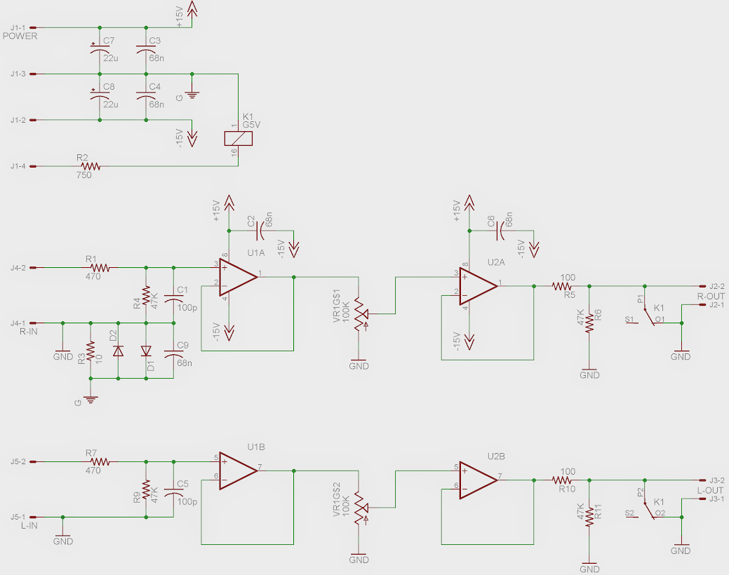

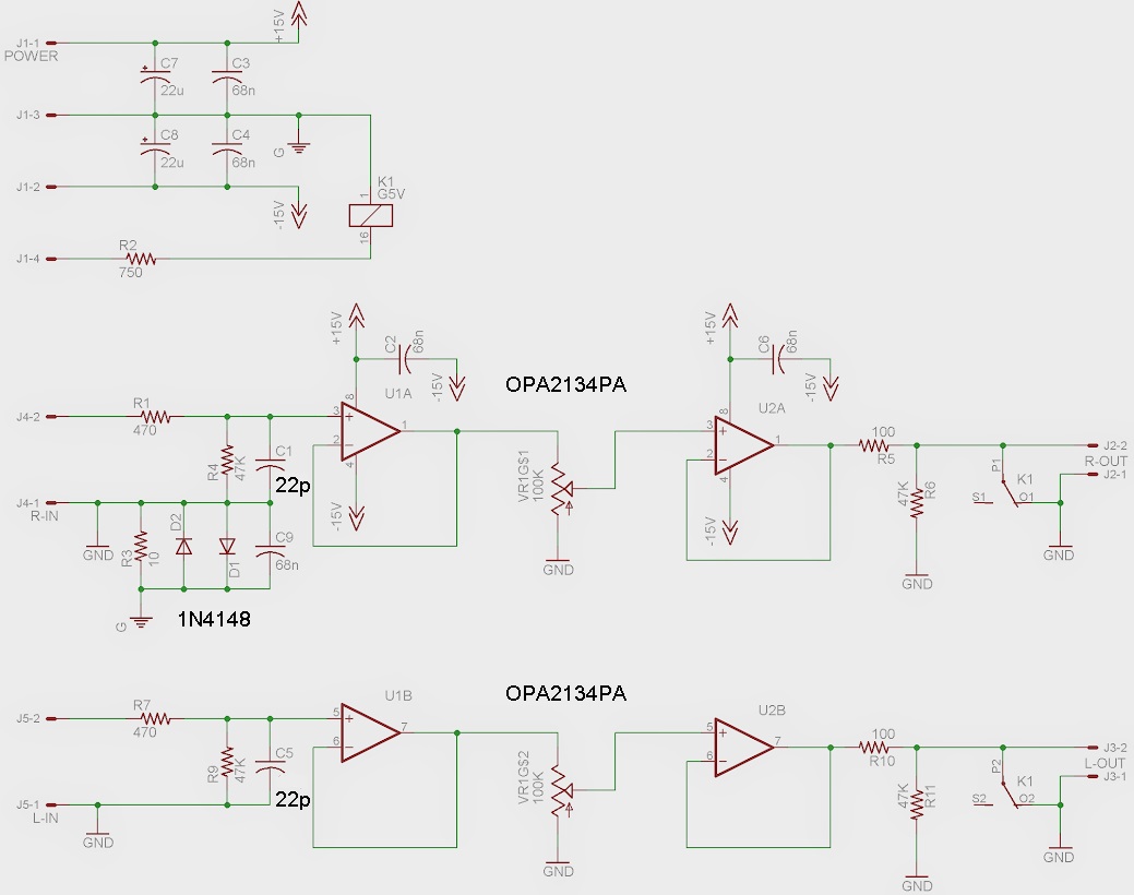

Should have put the op-amp type😱 and a revision

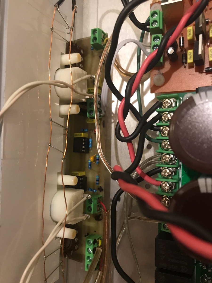

This post probably does not belong here but I wanted to have gain or volume pots for the L12-2 amp. Something that works.
LJM's earlier posts, he adviced two preamp.(preamp 7 P7 mini) for L12-2. They are very simple preamp.s, first you can try them.

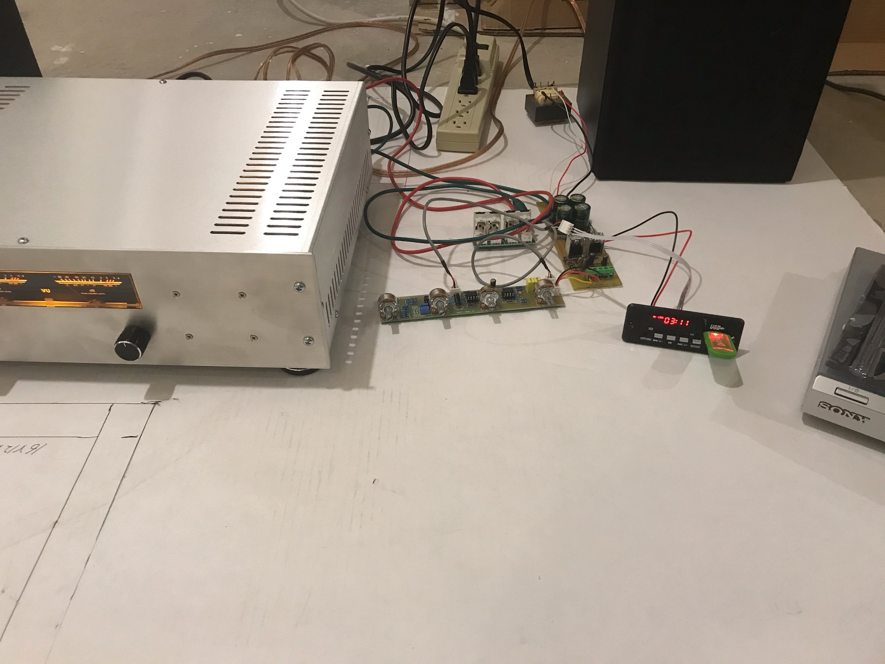

Finished... Sounds perfect, no noise very transparent. 😀

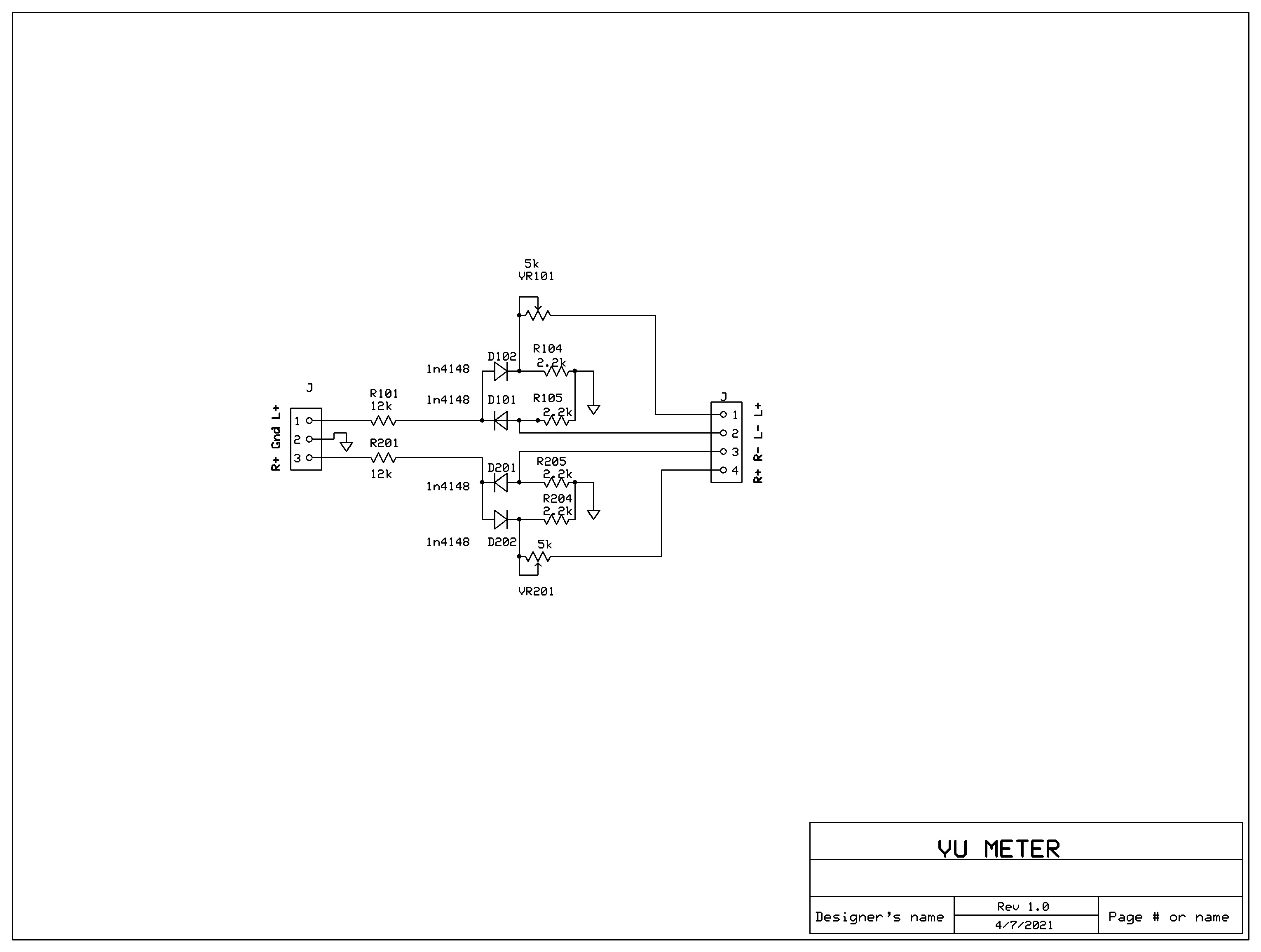

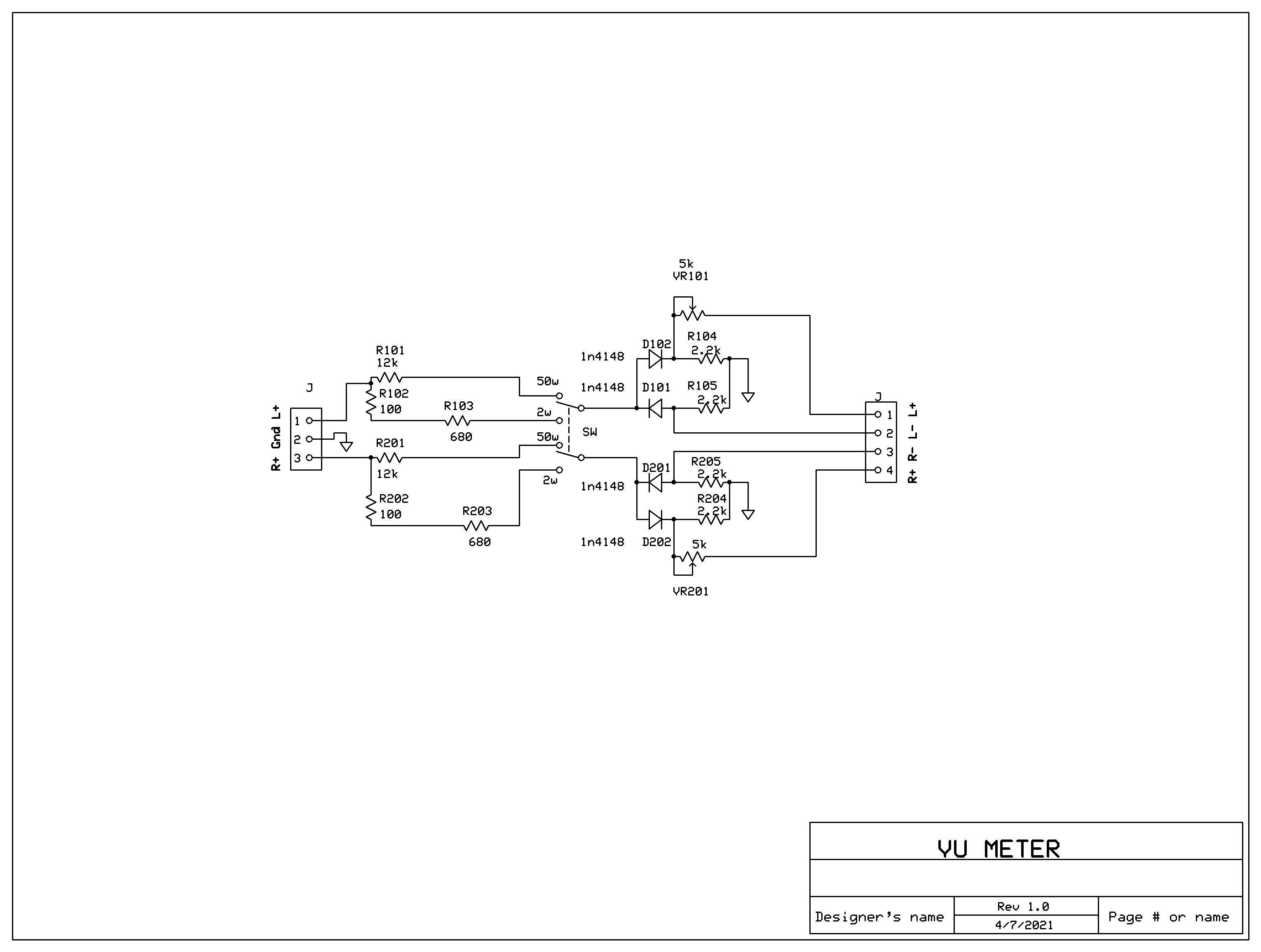

If anyone is interested, I can post the schematic I used for the VU meters. It gets its signal from the speaker out-puts and there are pots to set-up for max VU when amp just starts to clip, looking at a scope sine wave. It runs completely from the speaker outputs.
The LED lights are fed from a 2 volt regulator.
I want to say that, VU meters looks pretty good like old times amplifiers. (I can't add vu meters on my amplifier. but, for knowledge base you can post here).

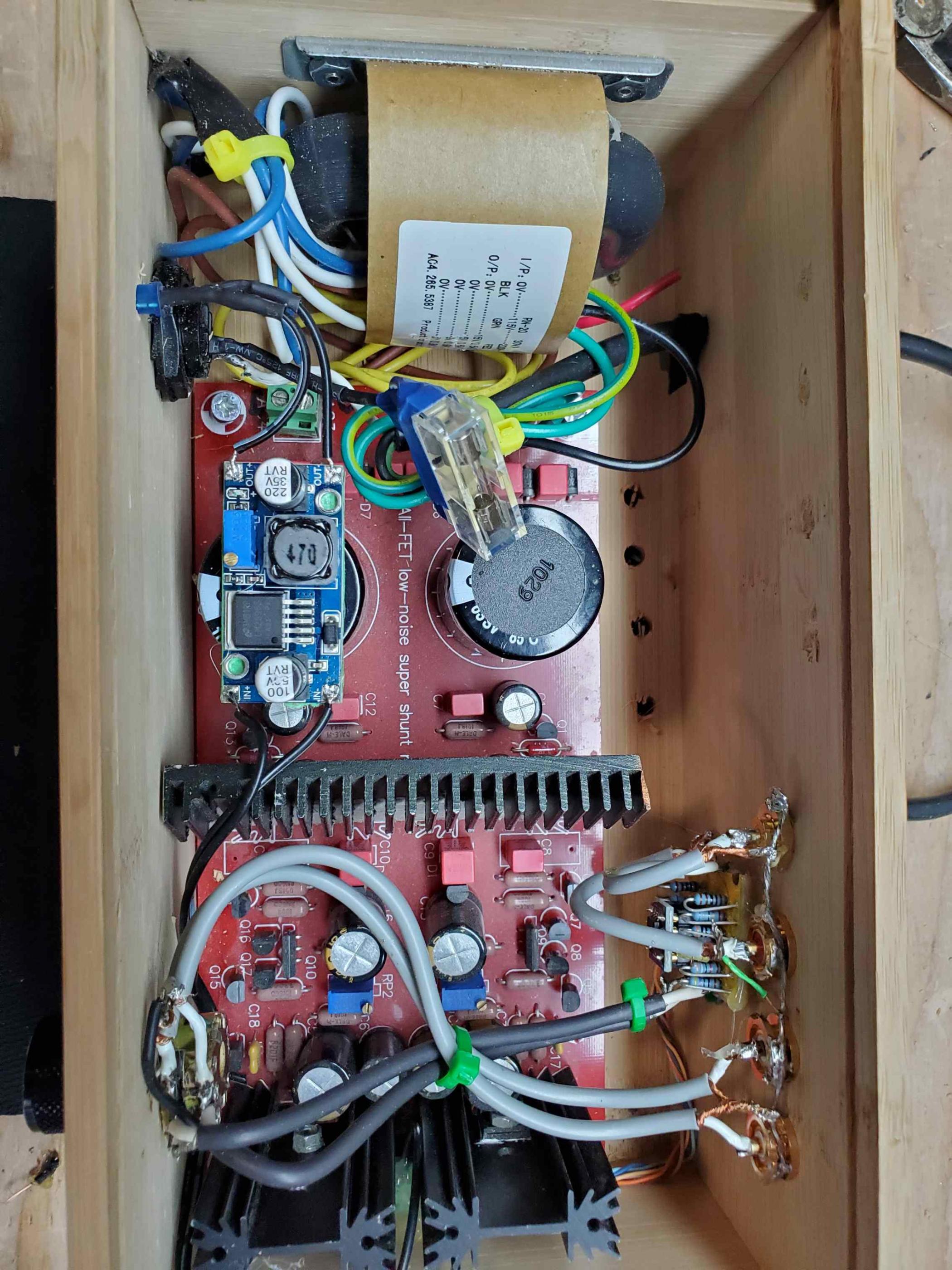

Preamp used
This preamplifier has no gain.
In my opinion, you can use potentiometer directly.
Operational amplifier with power supply. And there's no gain. It doesn't have to be used.
It may produce some noise. Anything with electricity has noise.😱

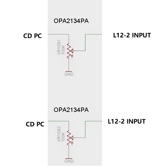

Preamp used
I suggest you use it like this
No power is required.
A lot of times, we add something. Including money. It's possible to get the bad, not the good.
Here's a picture. Remove opa2134
