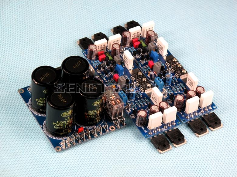

Received my pre-assembled boards, they look fine (to my inexperienced eye). One board could use a little cleaning of the back side, the other one looks pretty clean as is. Are they poorly assembled? I'm not seeing anything bad except for some junk tangled in the legs of the power transistors, looks like the snipped-off remains of some other components' leads. Very easily removed, but could be a disaster if you miss it.
Here are the photos.

The datasheet says that heatsink is connected to the collector for both of these transistor models. And collectors are already connected on the schematic, so it's okay to bolt them directly to the heatsink pair-wise. But not okay to connect 2837 and 1186 together on the same heatsink because there is supposed to be a 0.22 Ohm resistor between each of them and the output (0.44 in total). Guess this is why I received a set of thermal pads with each amplifier - glad I won't have to source mica pads.
By the way, what's the purpose of this resistor (R13/R20)? Doesn't it automatically increase the output resistance by 0.22 Ohms, which is quite bad for a power amplifier - damping factor less than 18 at 4 Ohm load?
The output impedance is mainly defined by feedback action and alot lower than 0.22R.

I understand my question is about electronics in general and not about the L12-2, but I genuinely don't understand something here. The emitter resistors are in series with the load (amp's output), aren't they? And it's not possible for the total impedance to be lower than its active component (in this case 0.22 Ohms). Or is it?..

Yes, but don't forget those emitter resistors are inside feedback loop. Total output impedance is then defined by feedback factor and much lower than 0.22R
