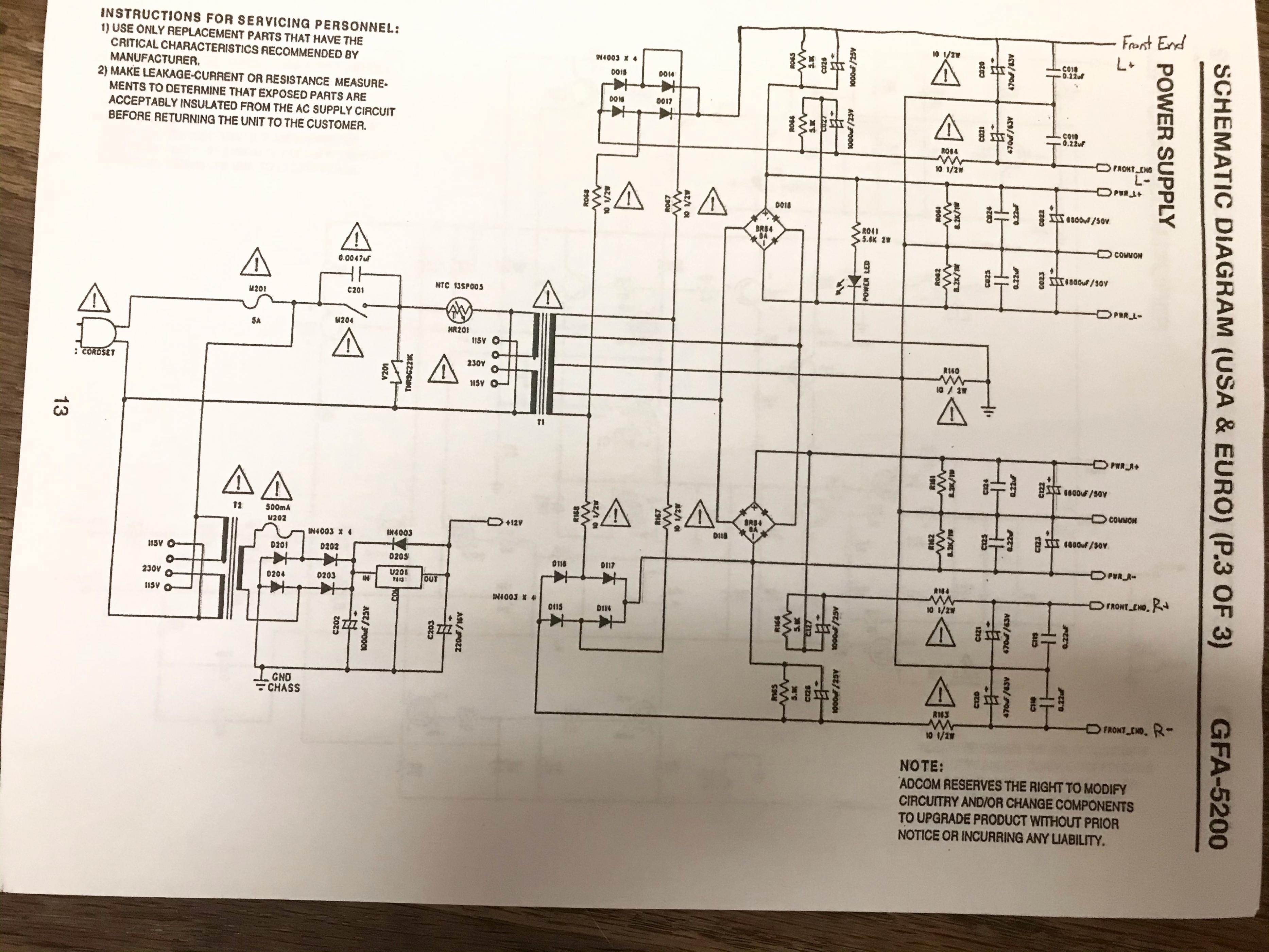

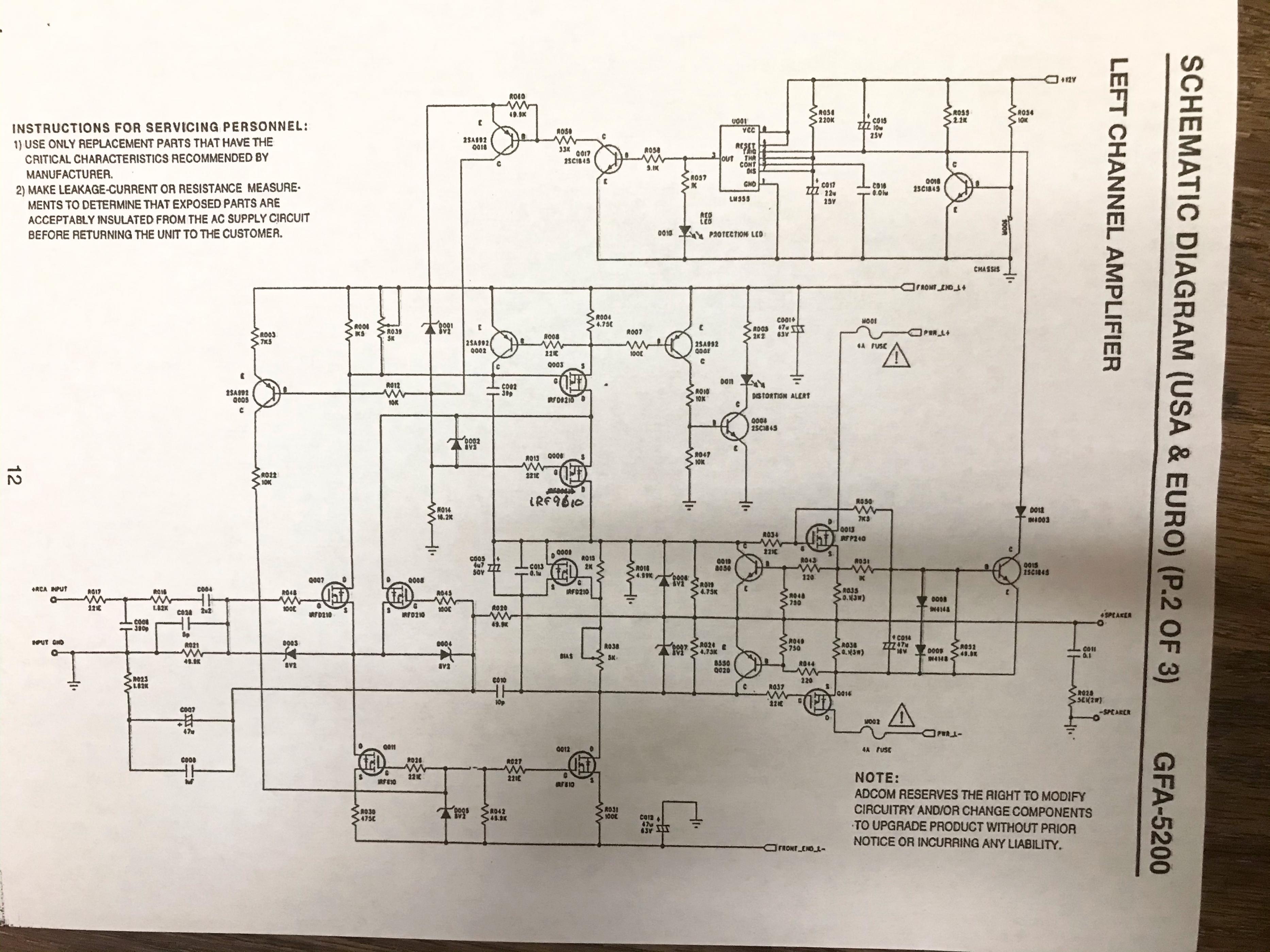

The early Adcom GFA-5200 had common supply rails, but the later ones had separate, higher rails for the front end (see attached), and also the 5300 and 5400 have separate front end rails, which gives them all an advantage in a quieter, lower ripple supply, and also able to 'swing' the full output rail. Those are all-mosfet amps which need lots of output stage bias to sound nice, while the L12-2 is a different topology, so I'm wondering if it benefits from its front end rails being of higher voltage.
Note the Adcom PS attached uses a 1000uF 25V cap (and bleeder R) between the higher and lower rail, apparently to keep the front end rail up longer than the output rail.

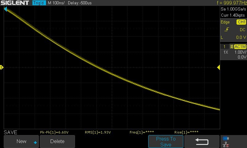

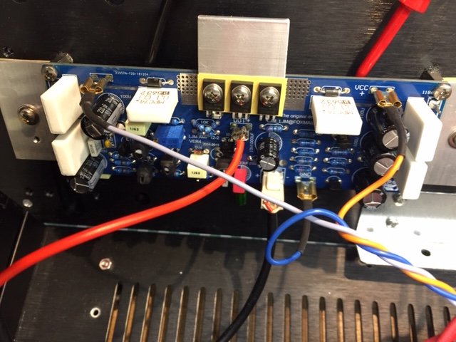

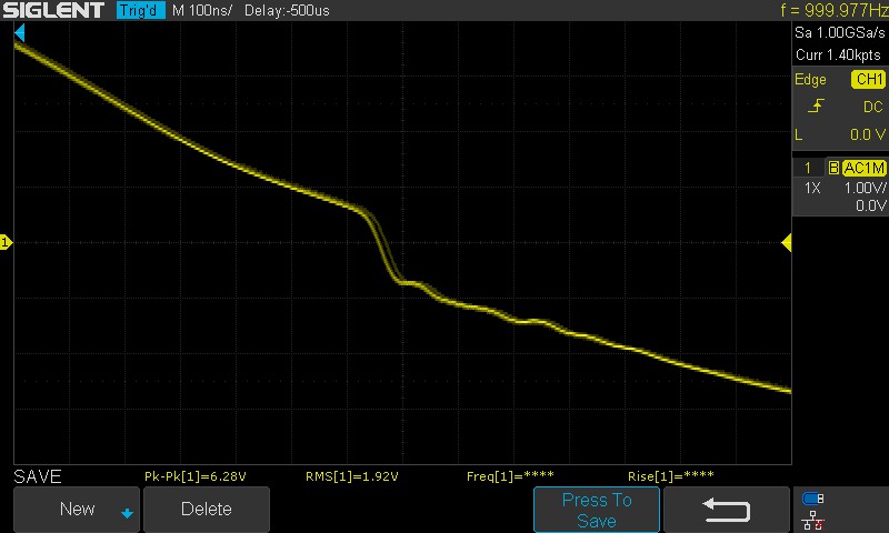

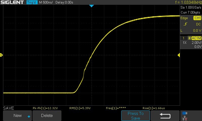

Hello all, I have been building a compact amplifier for a friend using the 12-2 boards. The measured THD is very low, but the square wave test results are not very good:
I am wondering if anyone else have seen some unusual "bumpiness" on the slopes of the square wave under load?
It is only visible if you "zoom in" on either the rising or falling slope. See pictures below, showing detail of 1 khz square wave unloaded and with 8 ohm load.
On the down slope there is also some jittering, that doesn't look so good.
I have tested with different VAS, Drivers and output transistors, and I can change the shape of the bumps somewhat, but not make them go away.
The boards are built by me, using all tested and matched quality components. I have used only a few of the parts supplied with the kit.
I was at first seeing oscillation with no load, but 220pf across BC of the lower Driver (Q9) seems to have cured this (as used by Rod Elliott on his Project 3A amp design).
I have Vq at around 6mV, which gives a low THD (around 0.0025% @ 10W) and relatively good harmonics. DC offset is only 2mV.

Follow up: I have just tried the same test with an LJM MX50 SE board (which is basically the same circuit, only with a single output pair), and the same type of bumps/lumps on the slope of the square wave can be seen, but much smaller - barely noticeable.
I am no expert on CFP/Sziklai pair outputs, so I don't know if this is to be expected?
Is this simply a "feature" of this topology? Perhaps nothing to worry about, or?..

A true square wave input usually forces an amplifier to slew-rate limit (aka internal current clipping), and its a great test for amp stability if an amp is stable with high speed large amplitude edges like this is probably stable with any audio input.
When an amp slew-rate limits there are often artifacts in the rising and falling slopes, as various parts of the circuit current saturate and/or recover from current saturation in response to the step-change. An amp with negative feedback is guaranteed to lose feedback lock during such a transient, which is why its a good way to push stability to the limit.
So long as the ringing is minimal and the rise/fall times are significantly faster than worst-case audio signals, I'd not worry.

Hi Mark, thanks, your explanation sounds quite reasonable. As long as sine wave and THD perfomance is very good, the square wave artifacts probably don't matter.
But it does seem curious to me, that no one else have experienced (or noticed?) the same with this design.
I have since tested two low-medium quality commercial amps, both with EF output topology, and neither exhibit the "bumpy artifacts".
This again makes me wonder if it is typical of CFP designs in general, or perhaps just typical of LJM designs?
If anyone with an MX50SE or L12-2 (or another CFP type amp) could perform the same test, it would be very interesting to compare the results!
Again, it's just a 1khz square wave into 4 or 8 load. Not high power, just around 3-4w (in 8 ohm), so no risk of damage to anything.
I get similar results at 10khz, and the exact signal level isn't critical in my case.

Thanks for insightful observations.But it does seem curious to me, that no one else have experienced (or noticed?) the same with this design.

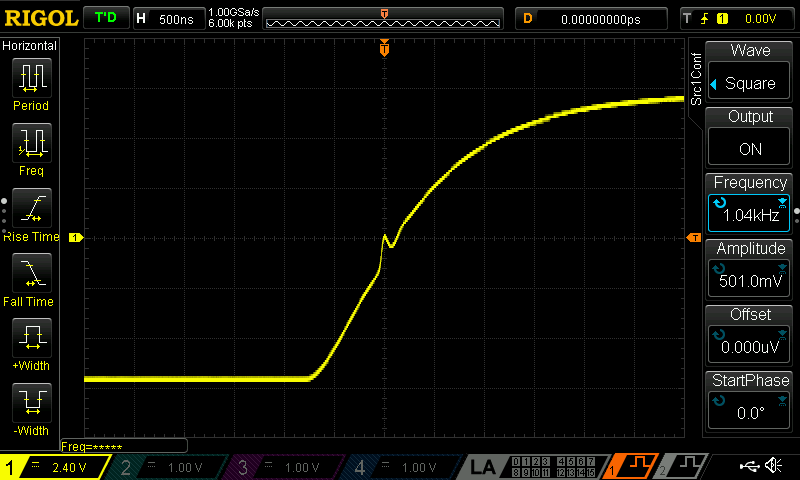

I have presented similar measurements HERE in this thread (look at the snapshot below). Also in L20.5, along with medicine for this. In fact, LJM boards seem to be under-biased for some reason, perhaps to reduce the size of heat sinks required for attaining the higher bias values. Look here too.
But, as you have an oscilloscope you may see the 12-2 square wave response at lower frequencies. Quite revealing.
Low THD is not everything. Something like a pretty face and yet... unattractive. Low frequencies must be adequate too. 😉
Here are my previous measurements of square wave response.
Hi, thanks for the info and links. I had somehow missed your posts in the thread (even though I have been through it from the start).
In a way, this is good news to me, because now I know that it isn't an error or defect in my particular L12-2 build.
My test results:
I can also clean up the response by raising the bias, same as your experience.
However: This is really just "moving the problem upwards" to a higher power level.
For a given square wave amplitude, eg. 12 Vpp, I can get a nice square wave with Vq at 75mV (=> 0.8A bias total) into 8 ohm load. Bumps all gone - looks smooth.
But if I then raise the amplitude of the square wave a little, eg. to 15Vpp, the problem comes back! - then I can again up the Vq correspondingly, and the square wave will clean up again - and so forth until meltdown..
So the way I interpret this is: If the amp is biased to Class A for the given signal level, the square wave is much improved.
But that is not a solution (not for me at least), as one of the main advantages of the CFP/Sziklai design, is to be able to get very low crossover distortion at a very low bias level (3-5mV according to D. Self) - and thus have very low idle dissipation (also making it ideal for compact amp. builds and active speakers with small heatsinks).
So I would like find a way to optimize the circuit, improving the square wave response, while still running low bias level, and with good stability.

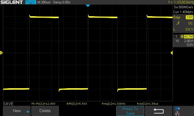

Hi jvhb,
You don't need that high with bias to eliminate the crossover distortion. Just use the oscilloscope and you'll literally see when the bias is large enough. Look HERE for short but adequate answer.
Problems with poor square wave are unrelated with the bias. Just turn your signal generator to, say, 25Hz and select square wave and observe the response. Not so "blameless".

Yes, that is precisely what I did: Observing the waveform, I need 80mV bias to get a completely "bump free" square wave at 12Vpp with 8 ohm load.You don't need that high with bias to eliminate the crossover distortion. Just use the oscilloscope and you'll literally see when the bias is large enough. (...)
If I test with a lower amplitude square wave, then less bias is required.
It is simply a question of biasing to full class A for the given signal level and load impedance.
Have you tried raising the level of the test signal after biasing, to see if the bumps/artifacts then reappear in the wave form? (my guess is, that they will)
