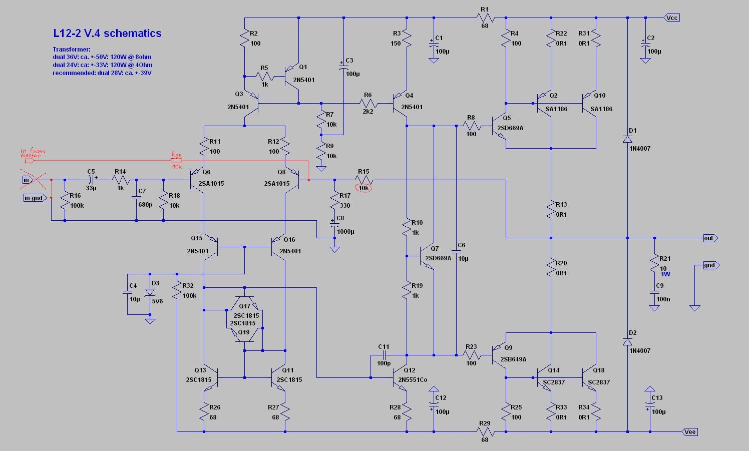

Is this correct for the "slave" amp in a bridged configuration? I'm going by this article.
Changes in red. The old input is removed and grounded. The new input is coming from the amplified out pin of the "master" amp, goes through R_BR (same value as the feedback resistor circled red, 10k) directly into the feedback of the slave.
Thanks!
That would work, I would personally add LPF and HPF on the new (neg) input.
Thanks Calvin. Since I'm expecting 4 Ω loads, parallel would probaly be more sensible. I'm still concerned that the 0.1 Ω output resistors might not suffice tho...
And thanks for the schematics! btw, I think I found a mistake. In your L12-2 V.4 schematics, you changed C4 and C6 to 10μ. However, my (blue) VER4 board is silkscreened 105 for 1μ and came with 1μ caps (look like small unpolarized electrolytics).
I was also surprised to find a Rubycon MCZ for the 1000μ feedback attenuator in my kit (C8). Likely to be a fake?
And I'm scratching my head at your suggestion to add film caps in parallel to C5. Doesn't the original cap have to be removed to get rid of its nonlinearities?

when paralleling either Transistors or complete amps one needs to either match tightly or use balancing resistors (here: emitter resistors or output series resistors).
For every so small difference in output the second amp would otherwise appear almost like a dead short to the first amp.
To check if the amps stay within their SOA in bridged mode just calculate the required minimum supply voltages and current.
Say the supply lines are ~+-30V.
That's good for ~100W@4R (+-28Vpp -> 20Vrms).
The load then draws 5Arms, +-7App.
In bridged mode each amp would work into a 2R load, hence the current would double to 10Arms, +-14App.
Since the voltage across the load and the current through the load double each, the power quadruples.
Due to supply lines giving in, losses, etc. the practical figure is rather only 3x the power.
Calculating with 150W@2R per amp it requires ~18Vrms and ~8.5Arms (+-24Vpp and +-12.5App).
Since of each amp only one of the two output pairs (either the NPNs or the PNPs) drives the load, the current through the single transistor is half that value, hence between 6A and 7A.
The chosen transistors should be able to drive such amounts of current for short periods with still some headroom left.

Say the supply lines are ~+-30V. That's good for ~100W@4R (+-28Vpp -> 20Vrms).
How did you arrive at 100W? +-30Vac*sqrt(2) gives me +-42Vdc. That's 10.6A or 450W @ 4Ω. That can't be right. Where's my mistake?
My transformers are closer to 35Vac, which would raise the power to over 600W - per amp! That can't be right.
