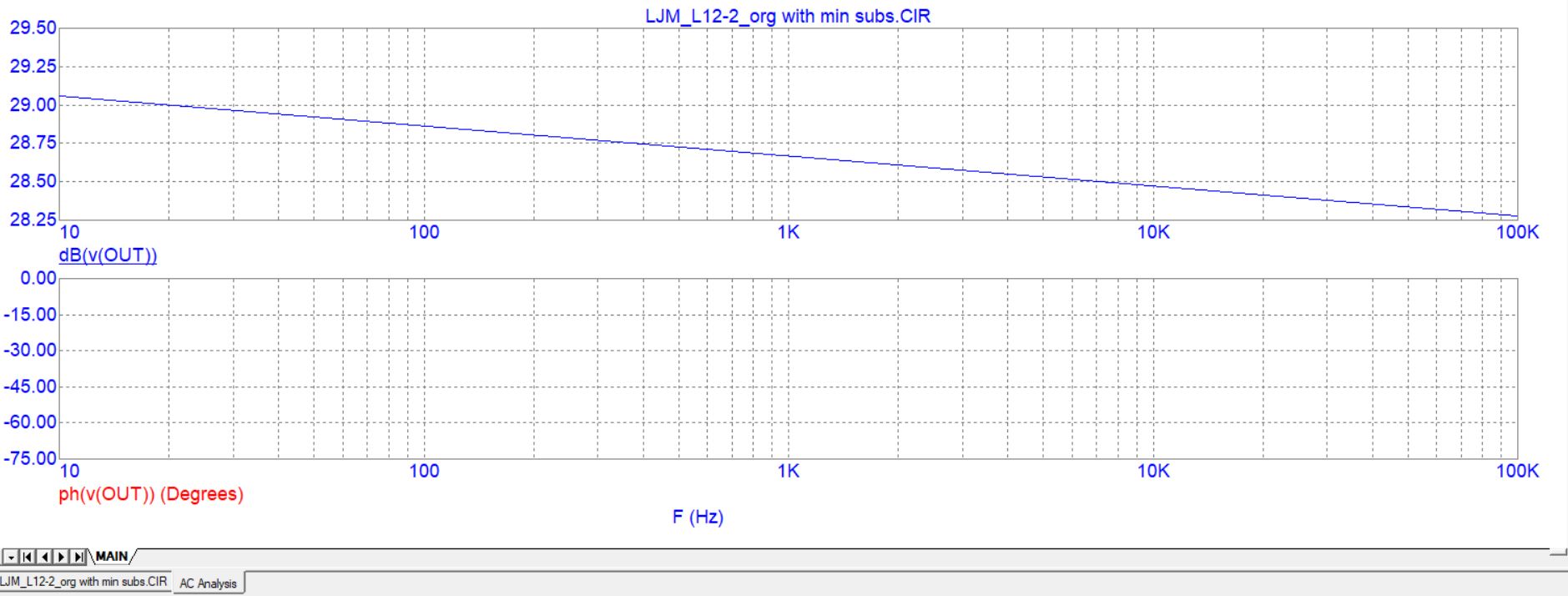

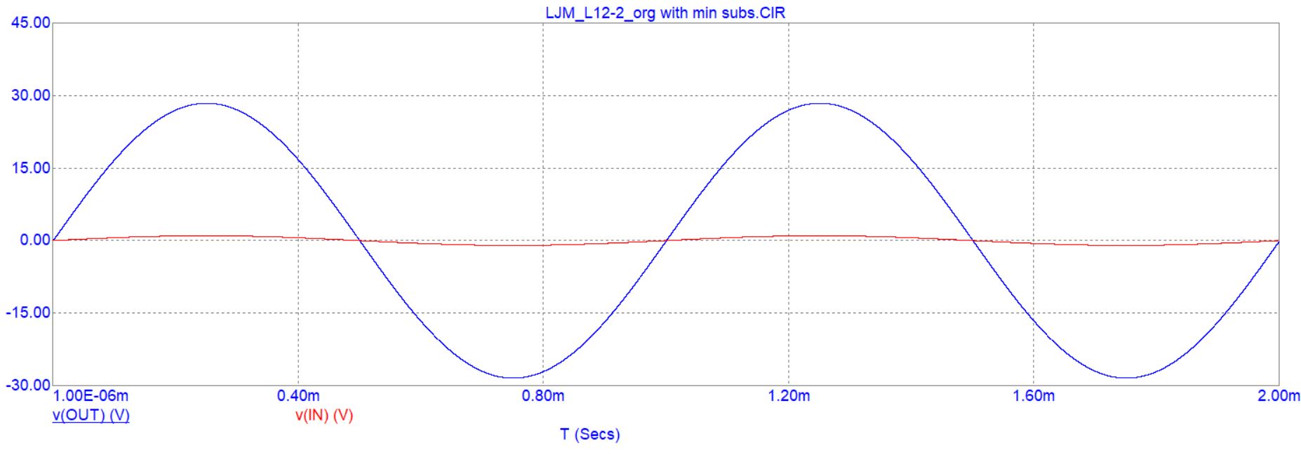

Hello,
Starting from the file kindly shared by GIT (post #773) I have fired up Microcap 12 which now is free (FREE !!!)
My goal is to learn a few things and play with minor changes.
I made the minimal substitution needed to work with the default libraries of Microcap 12 plain vanilla :
2SA1015 -> KSA1015
2SC1815 -> KSC1815
2SC4793 and 2SA1837 models embedded in the circuit
2SD669->MJE344
2SB664-> MJE350
let's put aside for a second if those are the best substitution or not. I cannot get a decent bode plot (frequency response).
The transient analysis shows the amplification happens, but the response seems ... nonsense to me.
Any suggestion?
Thank
Tibia

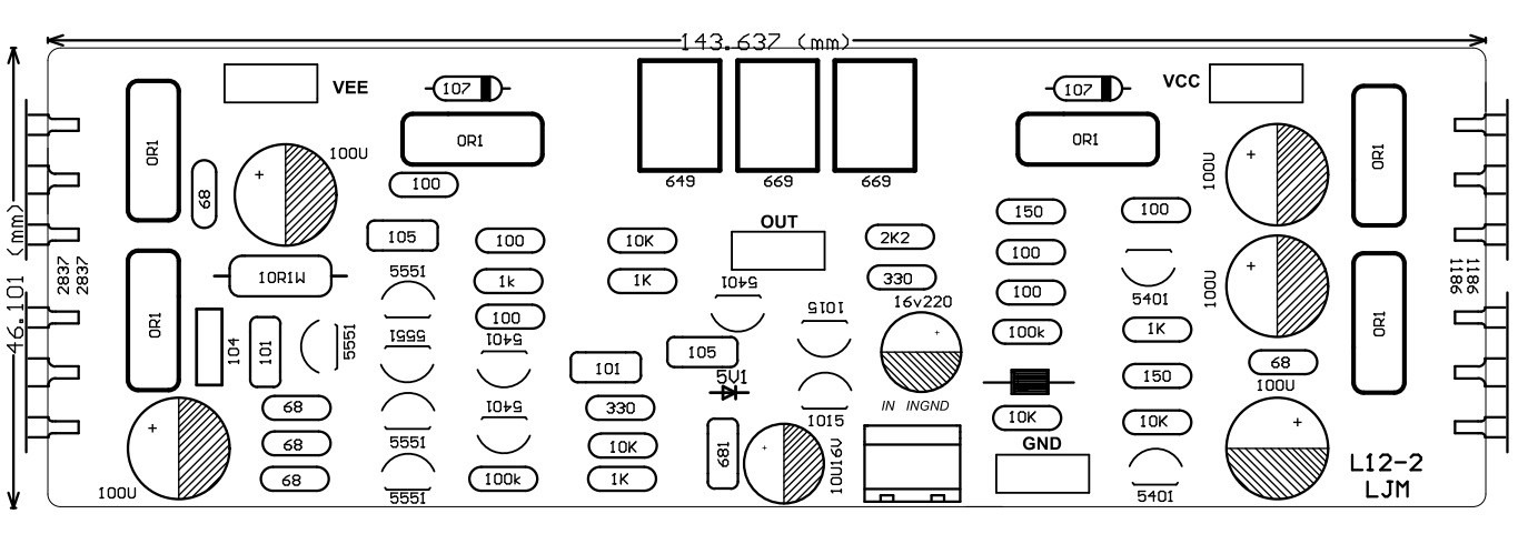

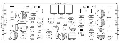

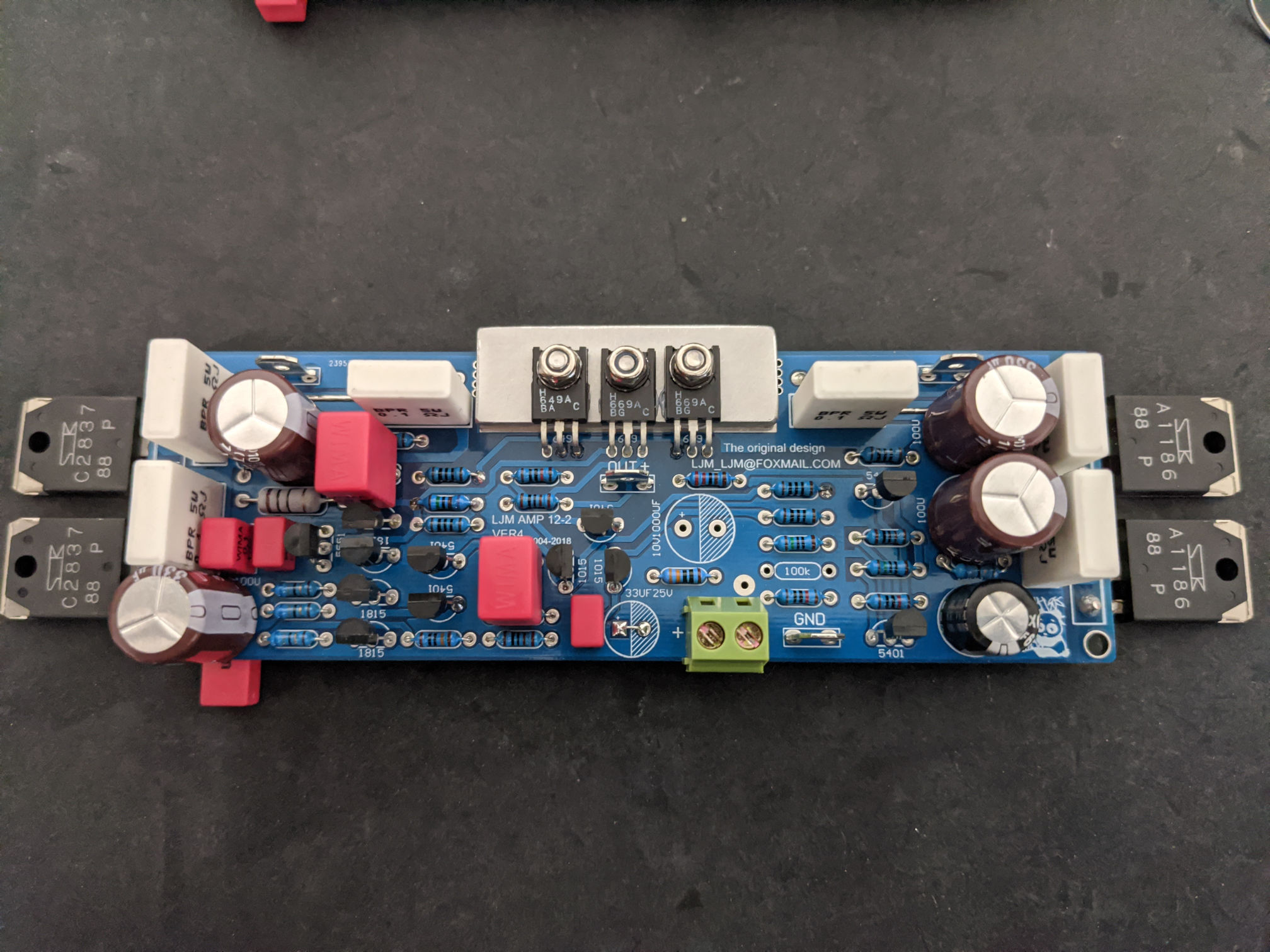

Almost finished my boards.
Changes from original:
Still waiting for C8 and then I'll have to clean the flux from the backside.
- Quiescent current trimmers
- Since I had 4 boards, I matched each pair of Sanken output transistors to have their Ube and hFE as similar as possible
- Also matched the large output resistors
- Added a piece of aluminium to improve thermal coupling between Q7/Q5/Q9.
- Thickened exposed traces with additional tin
- C5 (33μF) will be replaced with off-board 2x10μF Wima film caps
- Feedback cap C8 (1000μF) will be replaced with 680μF Elna Silmic 2. Not soldered in yet.
- Replaced all caps ≤ 1μF with Wima film ones. Wasn't sure which caps affect the signal, so I just did them all. The small ones aren't super expensive.
- Replaced 100μF bypass caps with 330μF low-ESR ones. They have a slightly larger diameter, but I managed to make them fit.
- Also added 150nF film caps in parallel to the 330μF ones on the backside
- C3 remained original 100μF part - I don't think it serves a bypass purpose. I don't know which purpose it serves at all.

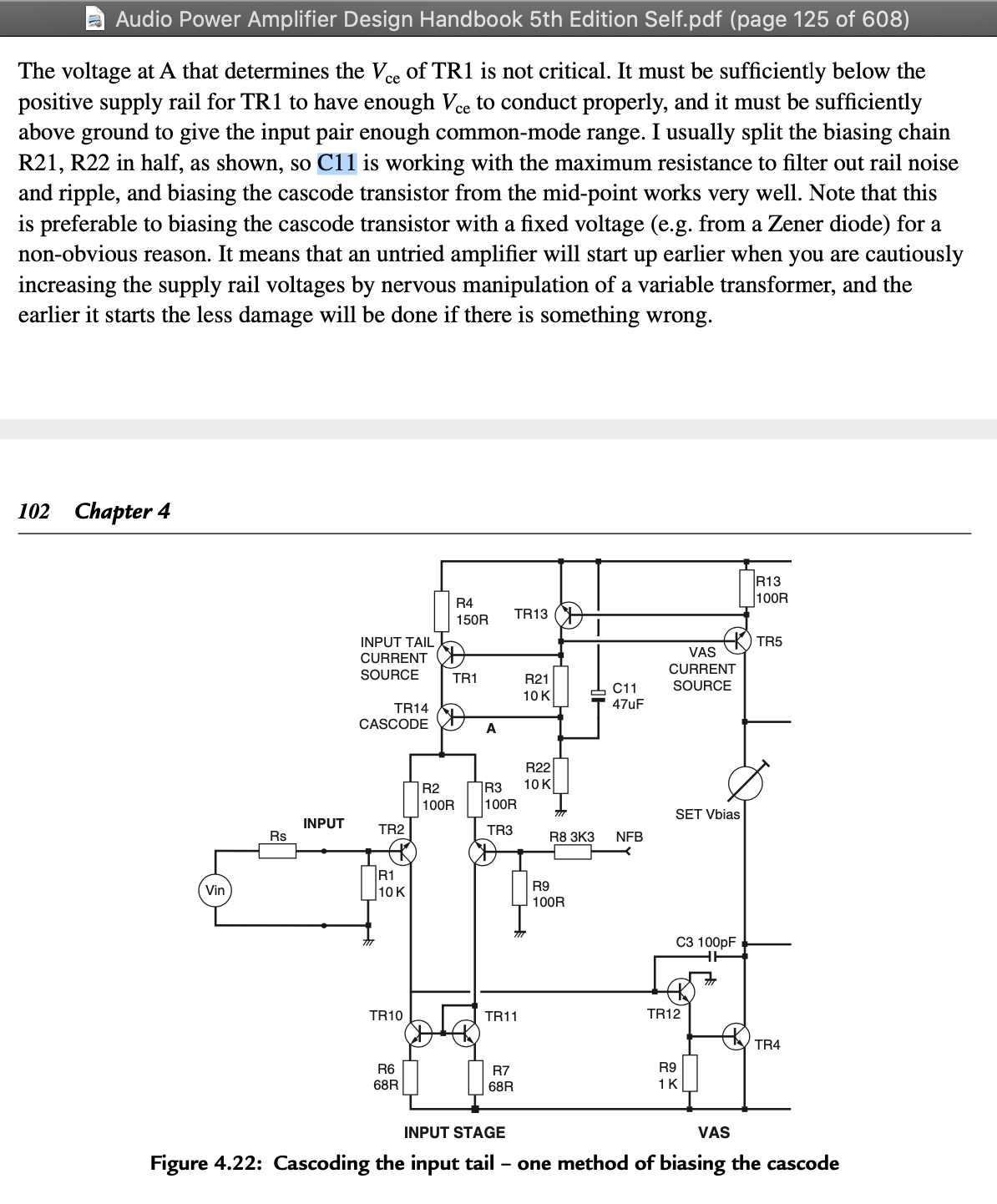

It can reduce the noise generated by heat.
of course. If the operating voltage of the amplifier itself is relatively low. The coascode structure may not be used.
bc550c, mpsa18 - it's n-p-n pinoutSuch as bc550c, mpsa18 and 2sa1015.
2sa1015. - it's p-n-p pinout
we are talking about a circuit in which p-n-p conductivity at the input?
yes, that is what I said above, that an additional cascade in this circuit is needed if the power supply is high.Minimal noise. Relatively high HFE and high performance. But their VCE is very low.
Generally less than dc45v.
But because of this cascade, you incorrectly inserted the integrated common-mode correction R30C14 circuit, you need to put them at the high-resistance points of the cascade, where the anti-clip transistors are in the diode connection.
for this, it is necessary to organize the stabilization of the bases of the cascade with a common base correctly, for example, instead of R32, put a stable current source.The input transistor operates at a lower voltage, such as 5V. Heat generation of the input transistor can be reduced.
I'm just giving an example. Bc550c or bc560c are similar.bc550c, mpsa18 - it's n-p-n pinout
