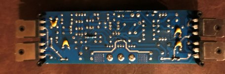

Can someone please post a picture of how the potentiometer is soldered on the board? I am mounting these boards on the sides of the case (sides are built-in heatsinks), and it would be nice to be able to access the potentiometer without much of disassembly.
Hanair, I assume you put your boards vertically with power transistors on left and right side. If so please put R19 resistor of 1K5 value normally from components side and add to it 5K potentiometer from the other = soldering side vertically. You will have access to it from the top.
What I also did - I left emiter legs of transistors Q9 and Q5 uncut and straight - it is easy to connect there multimeter probes from the back and measure idle current.

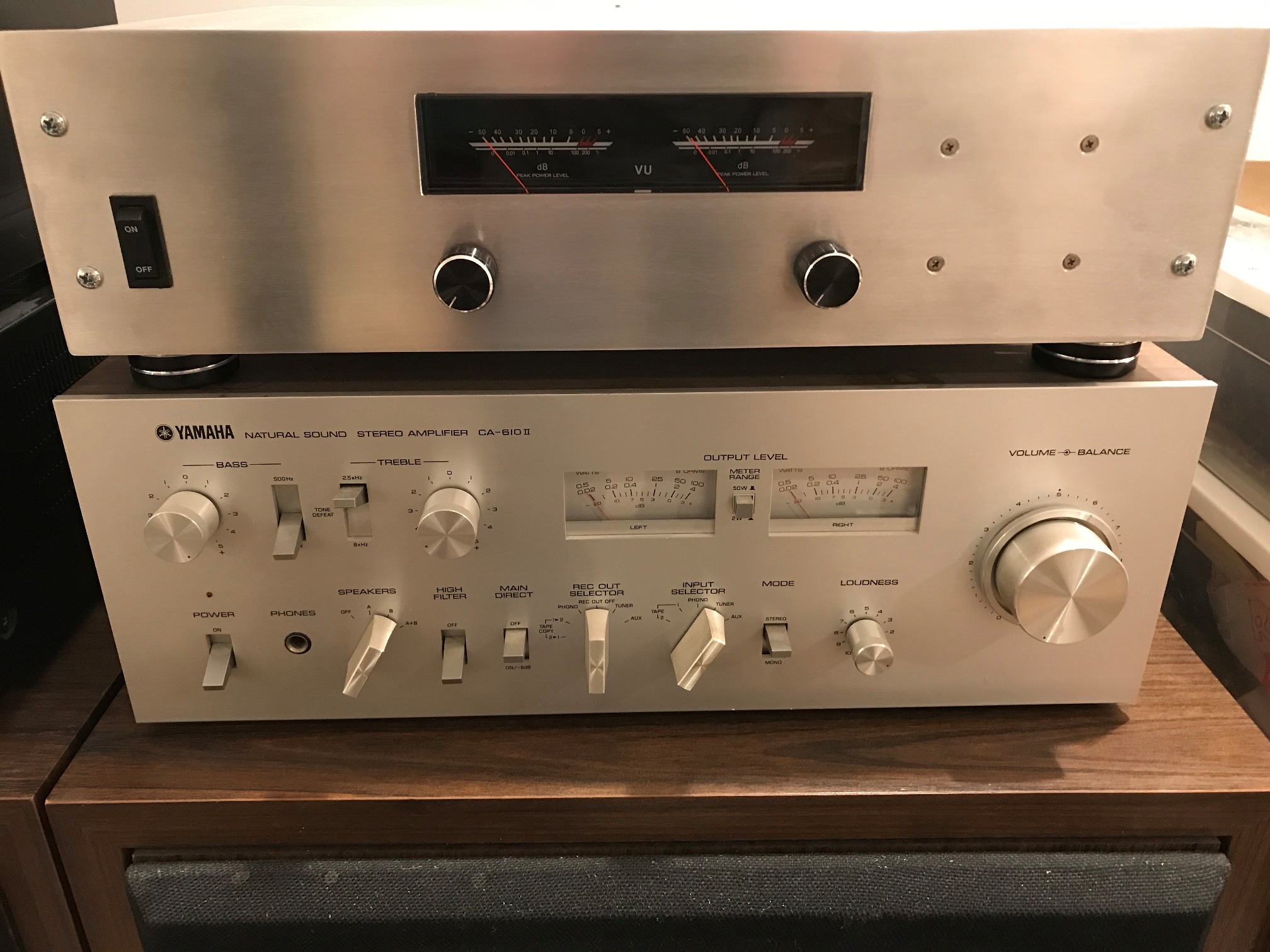

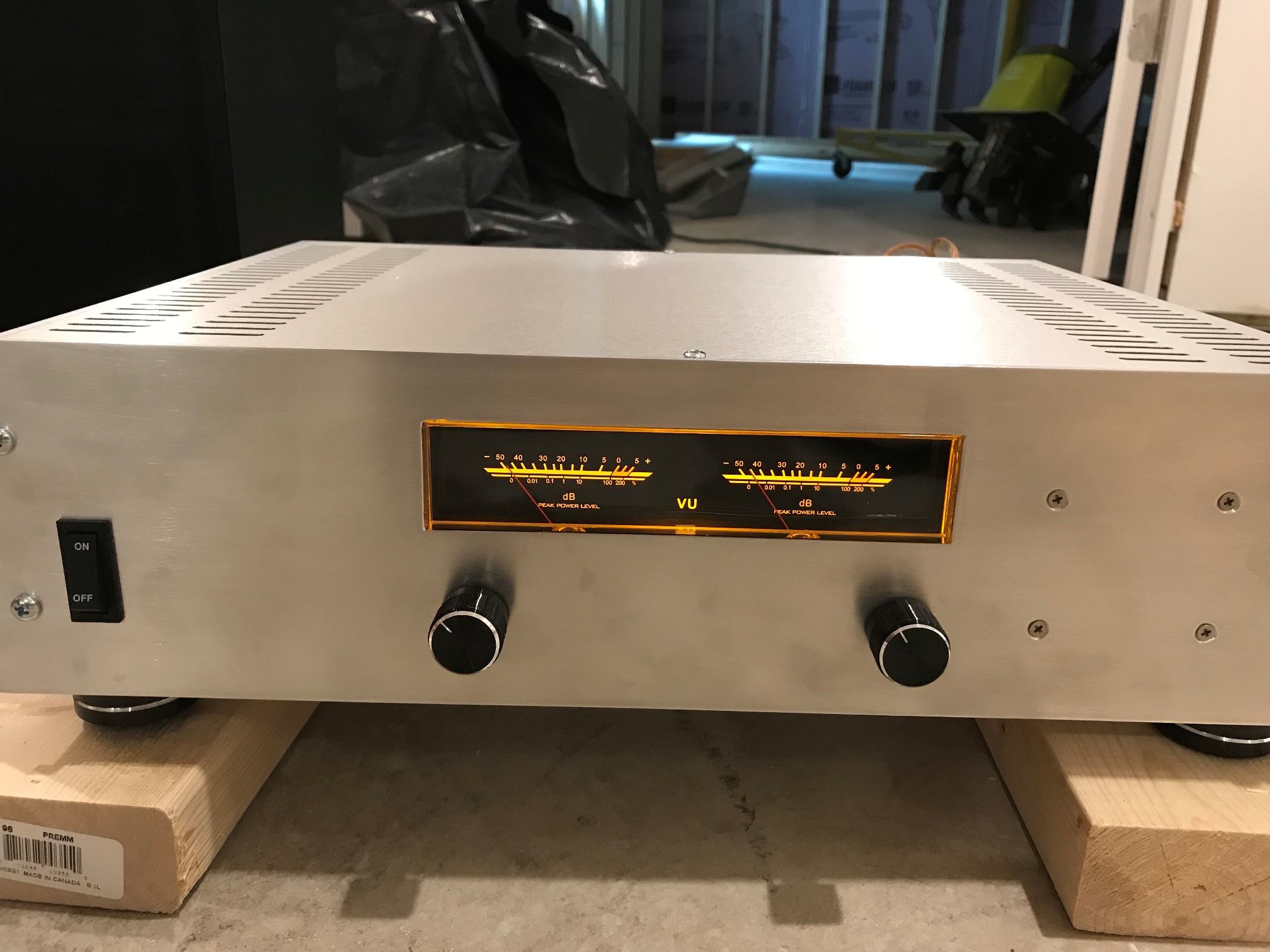

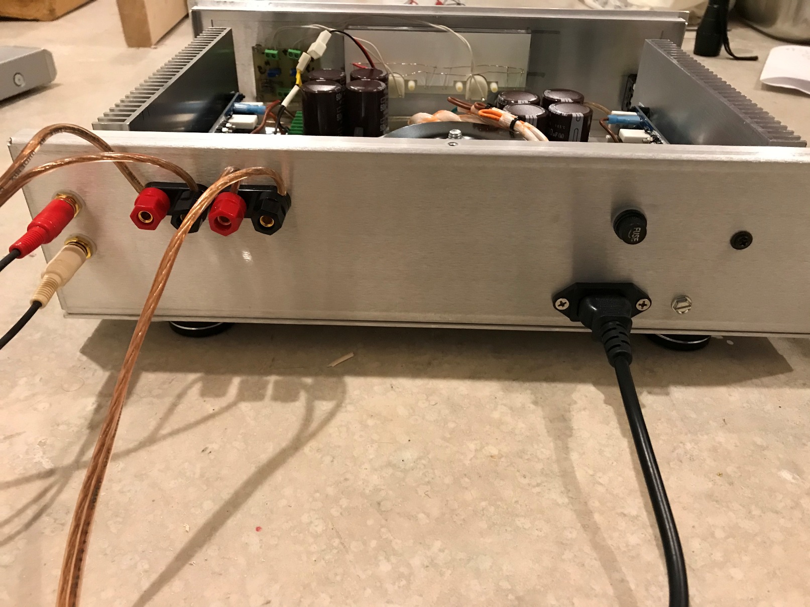

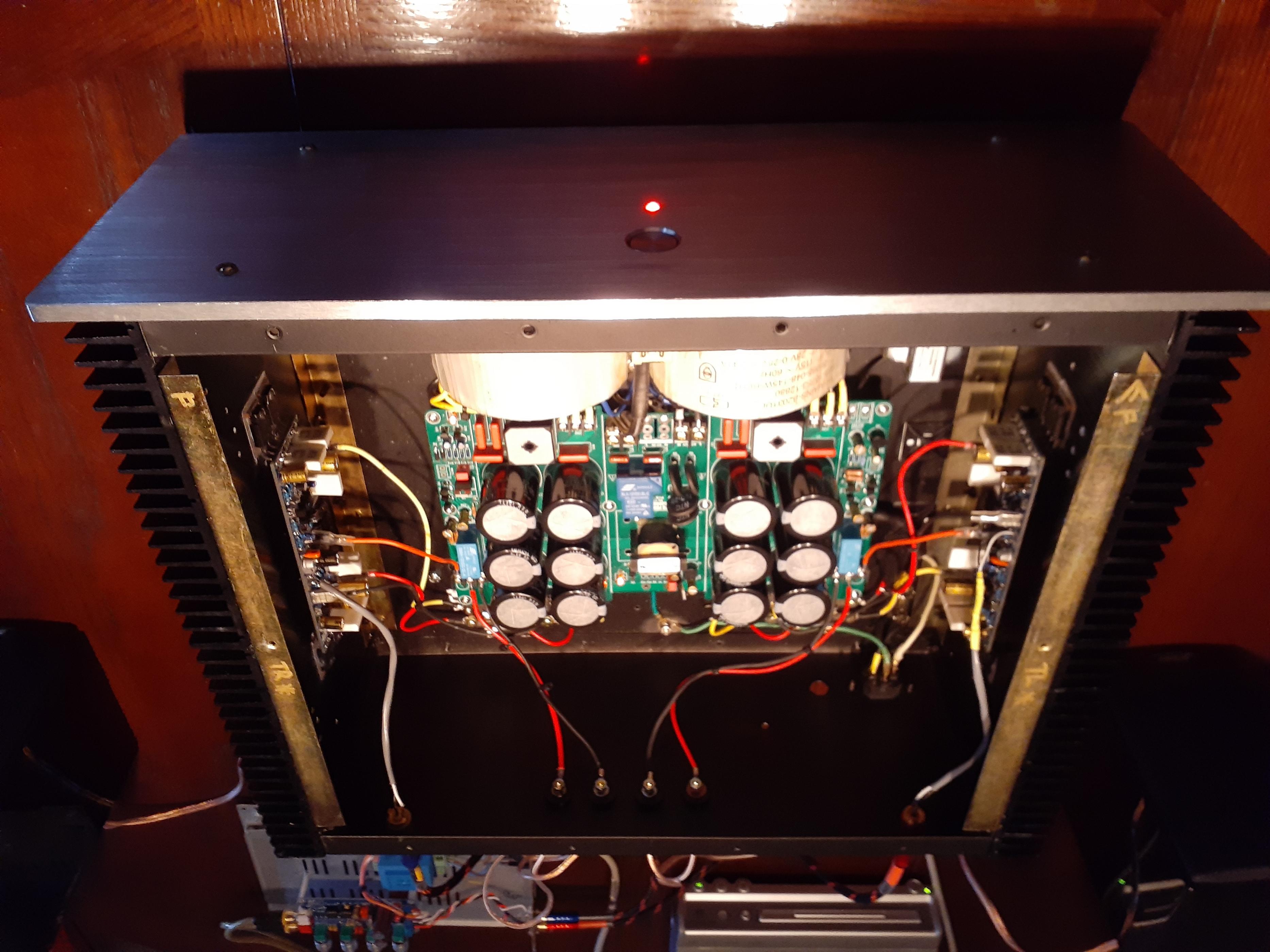

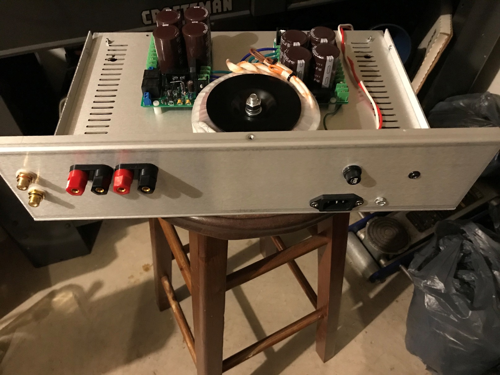

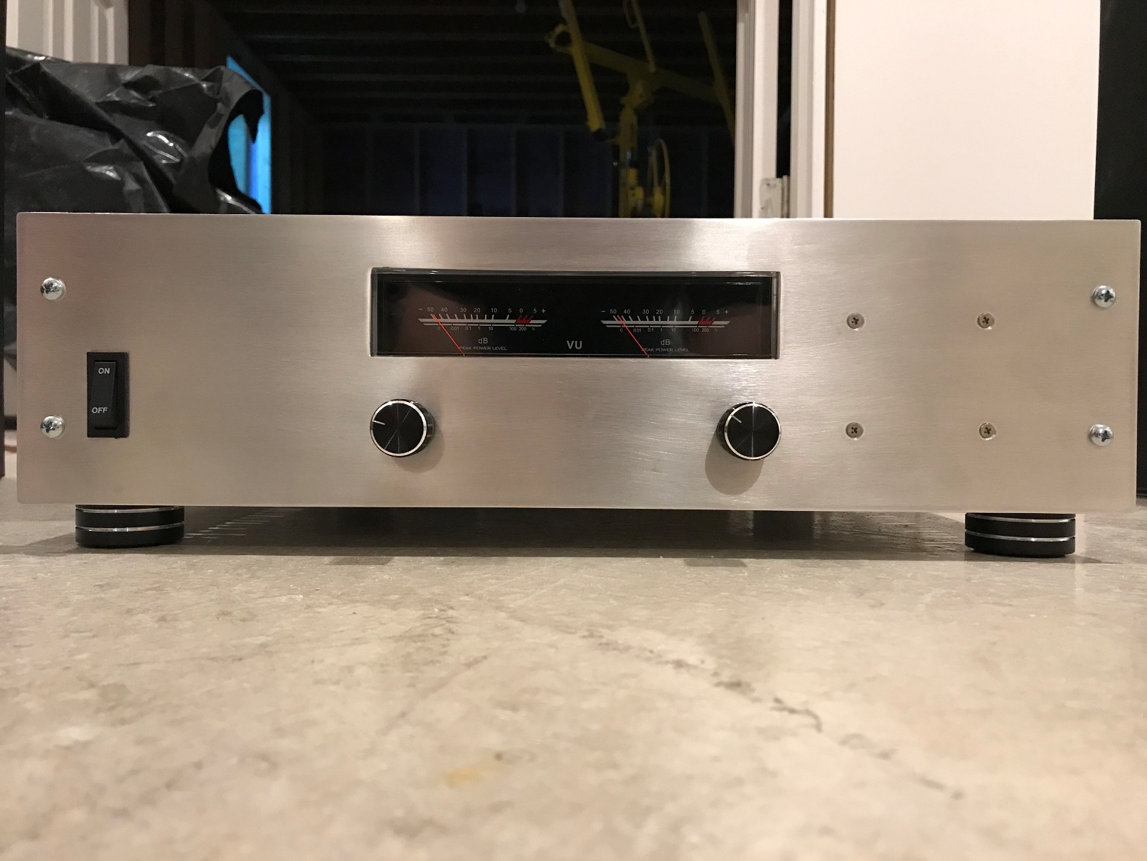

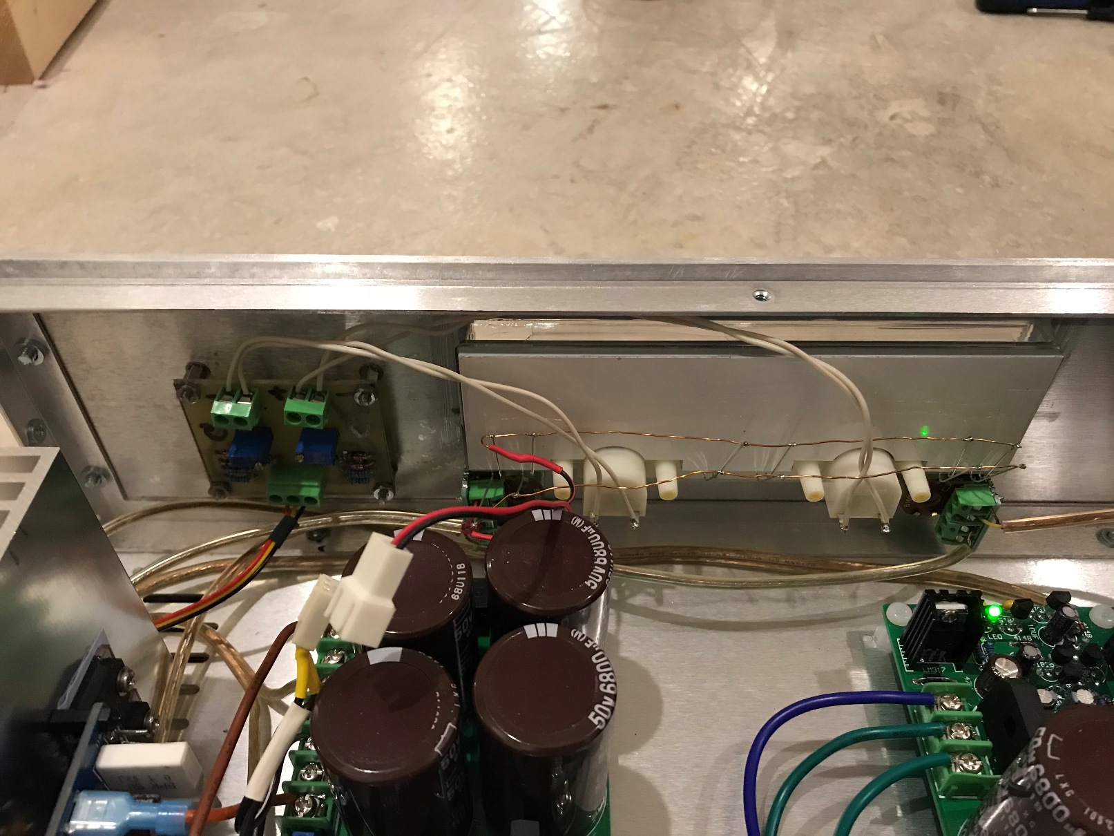

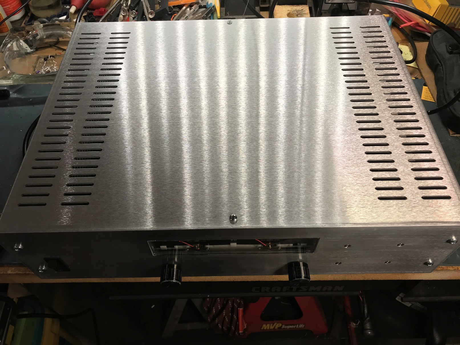

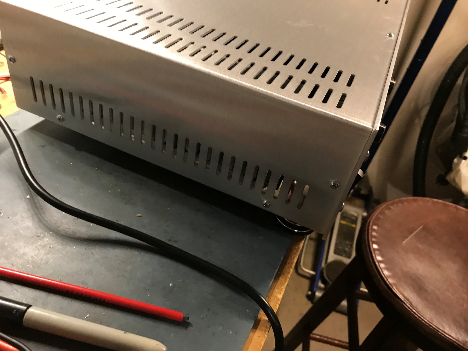

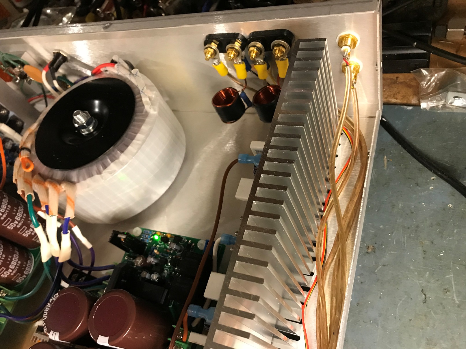

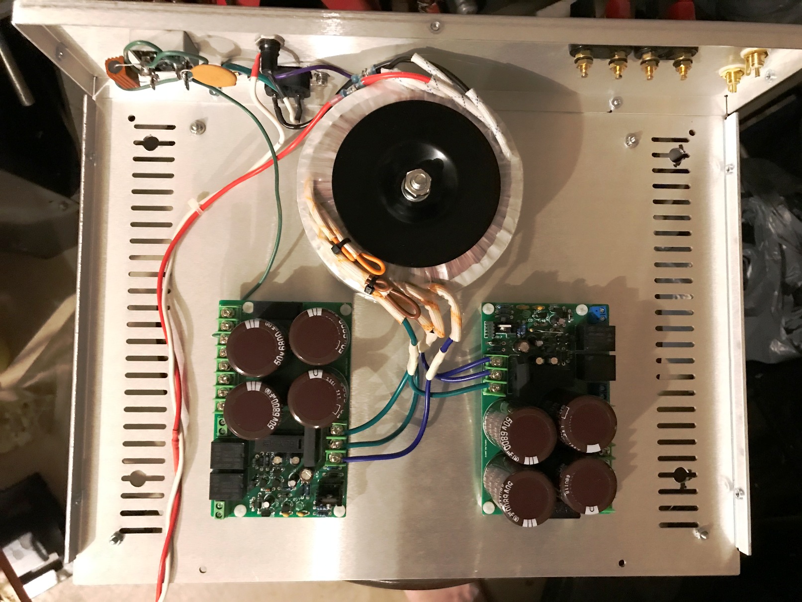

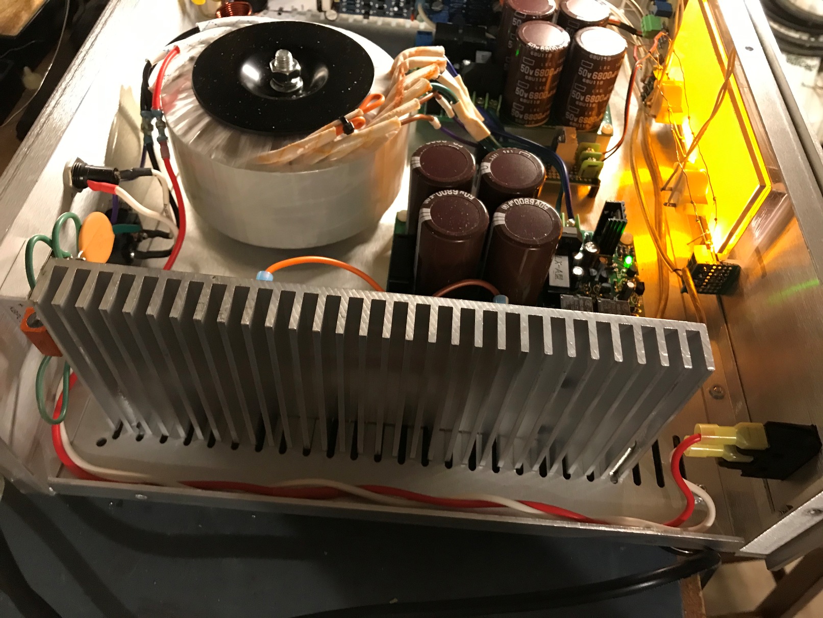

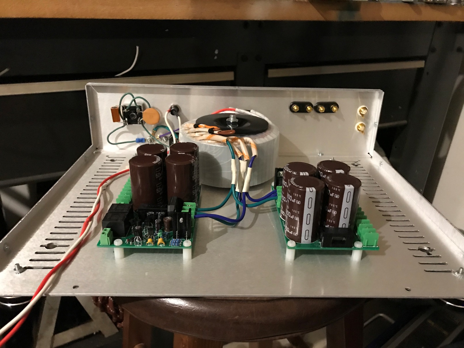

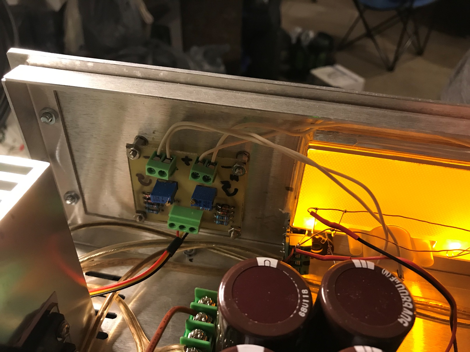

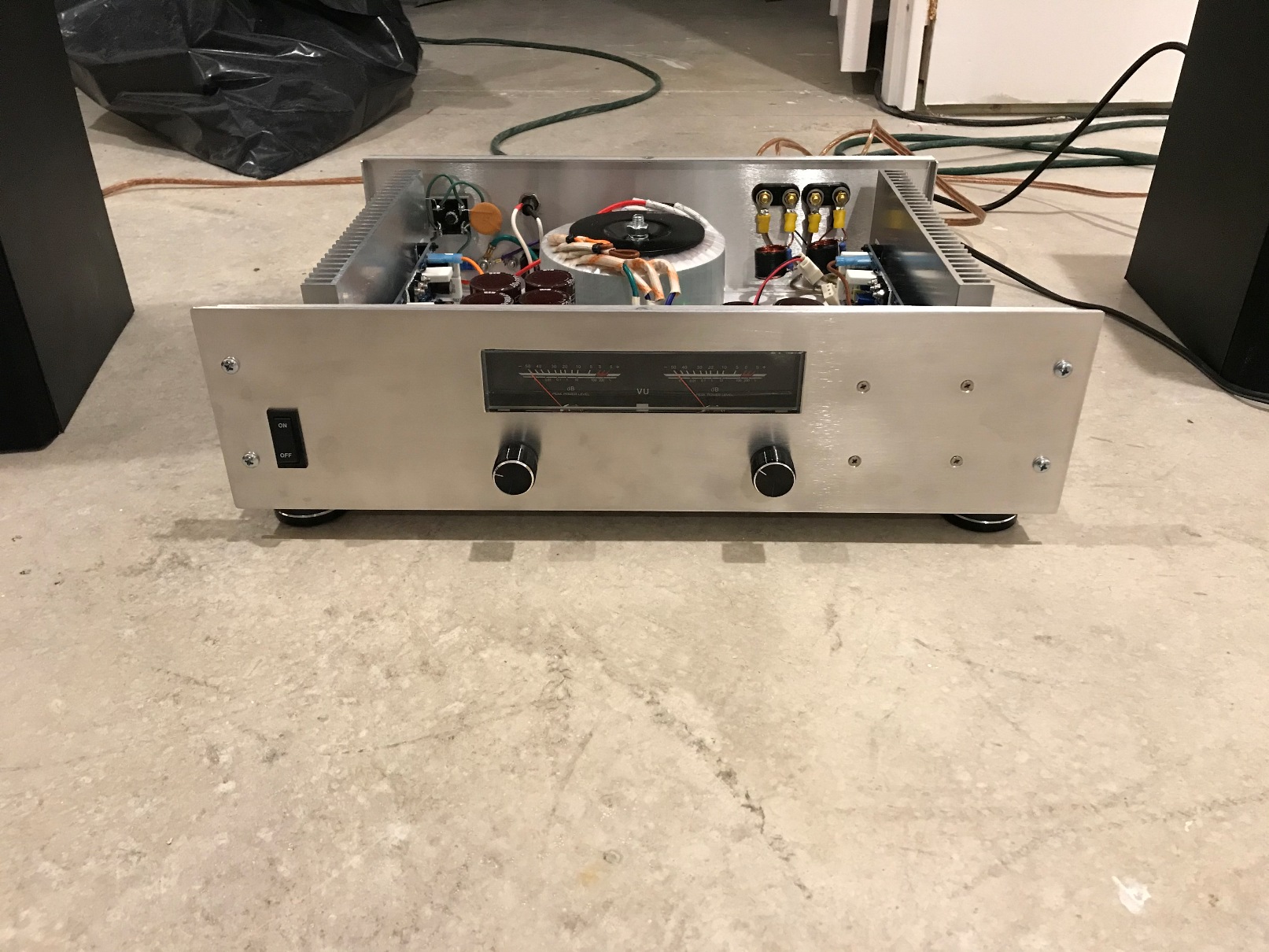

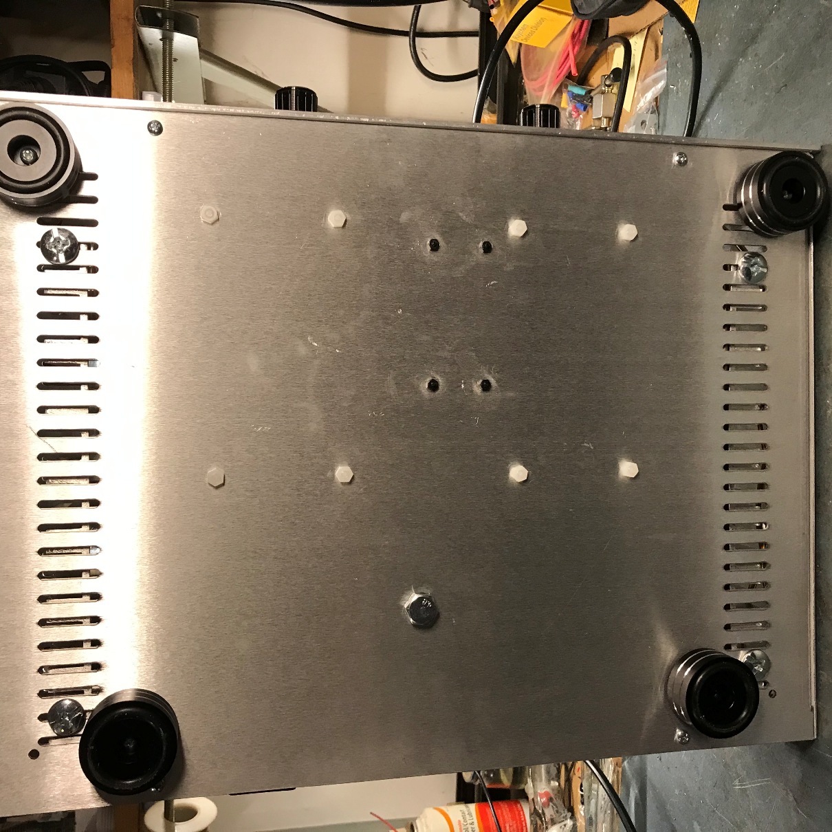

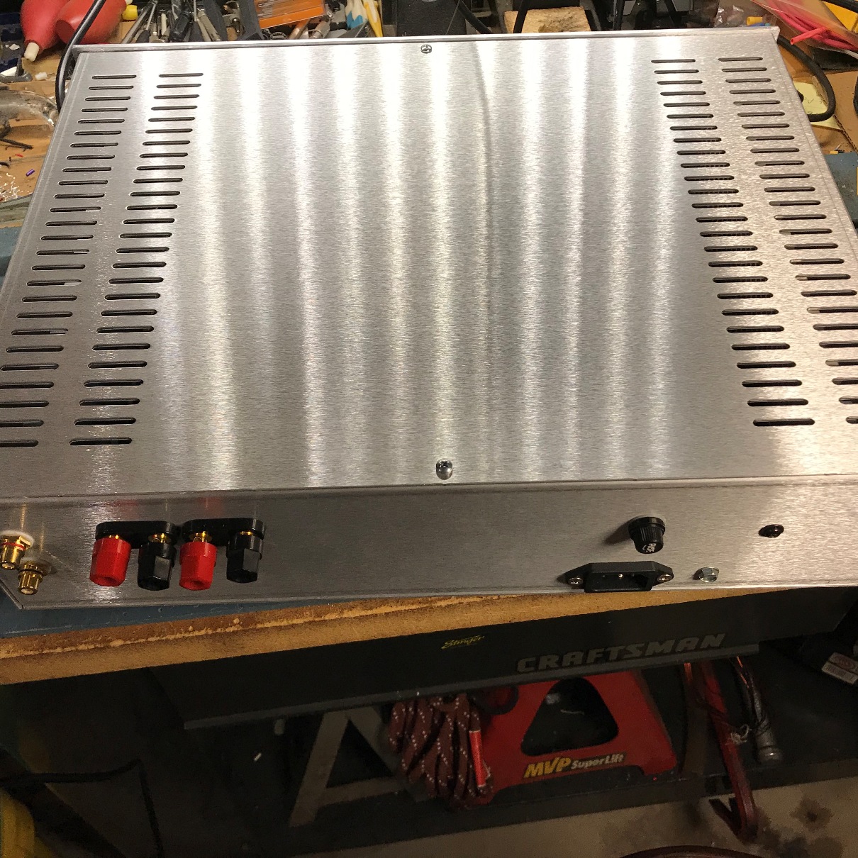

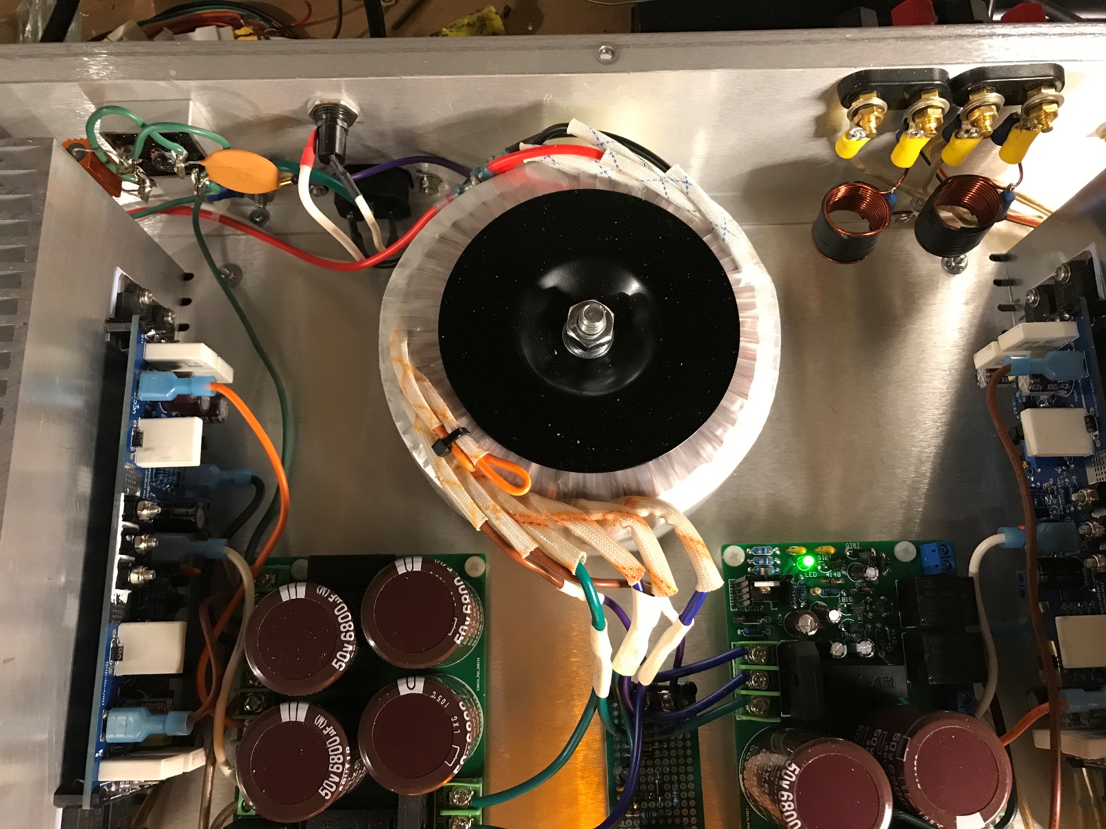

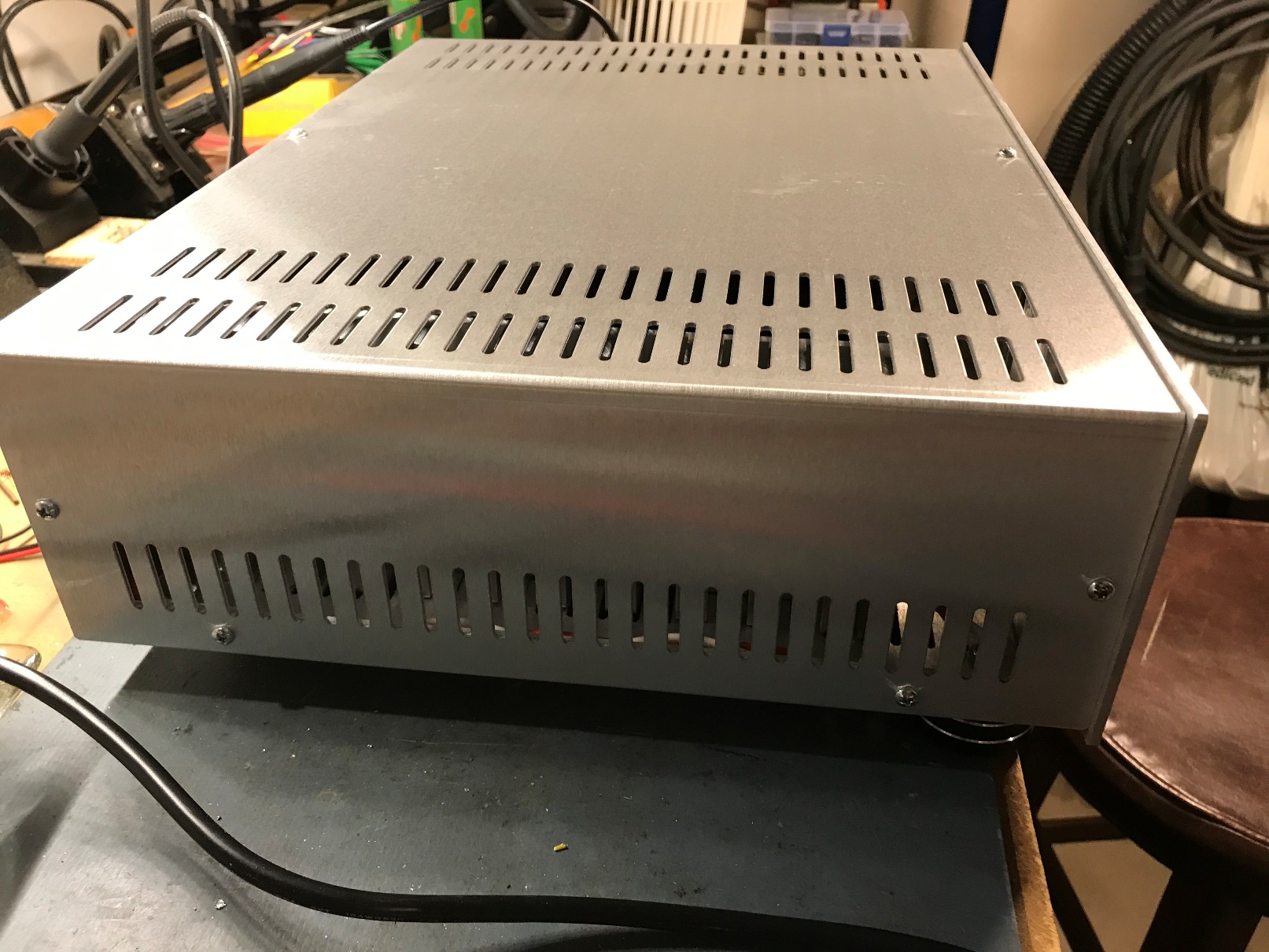

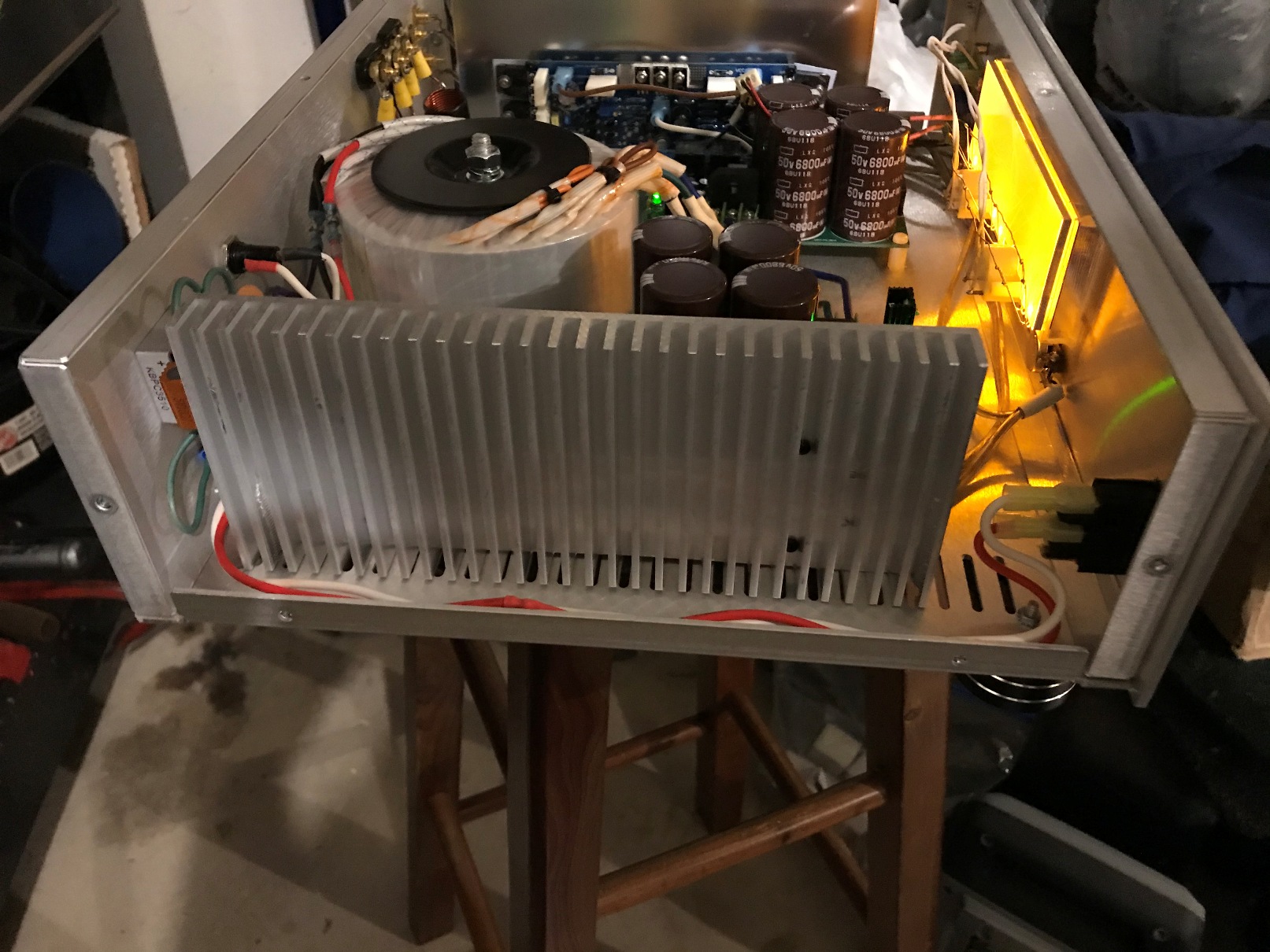

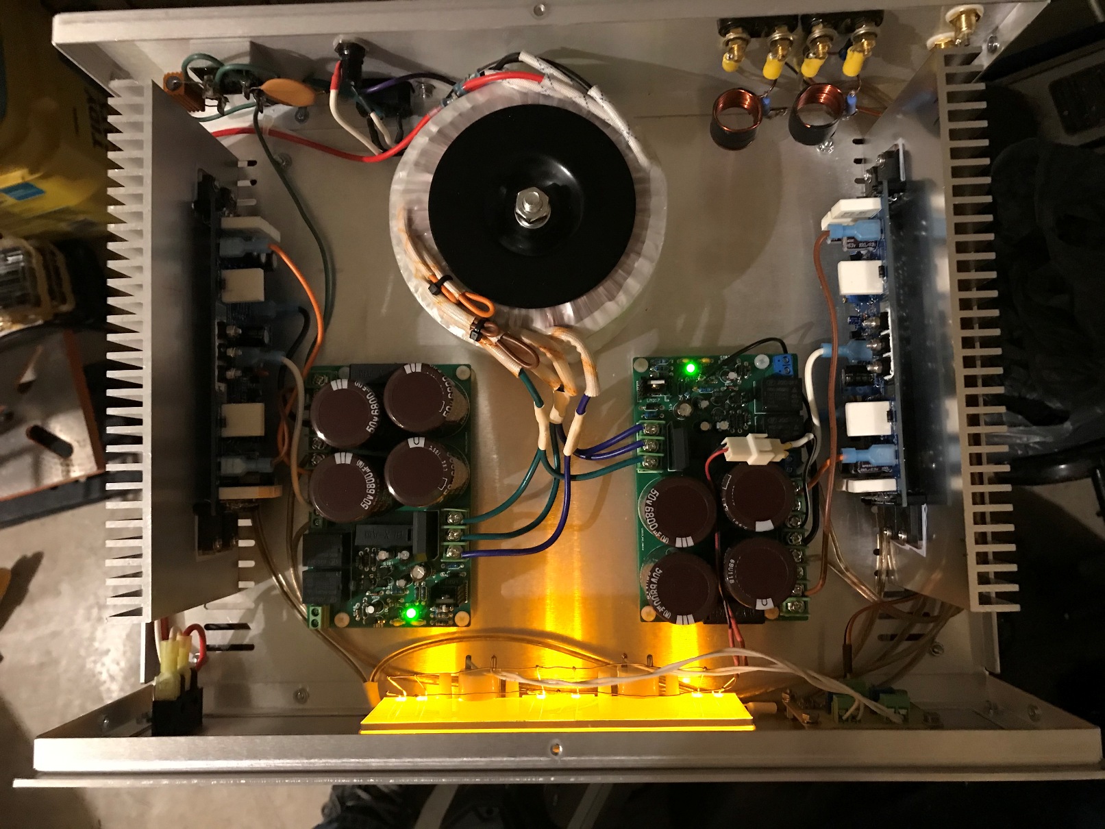

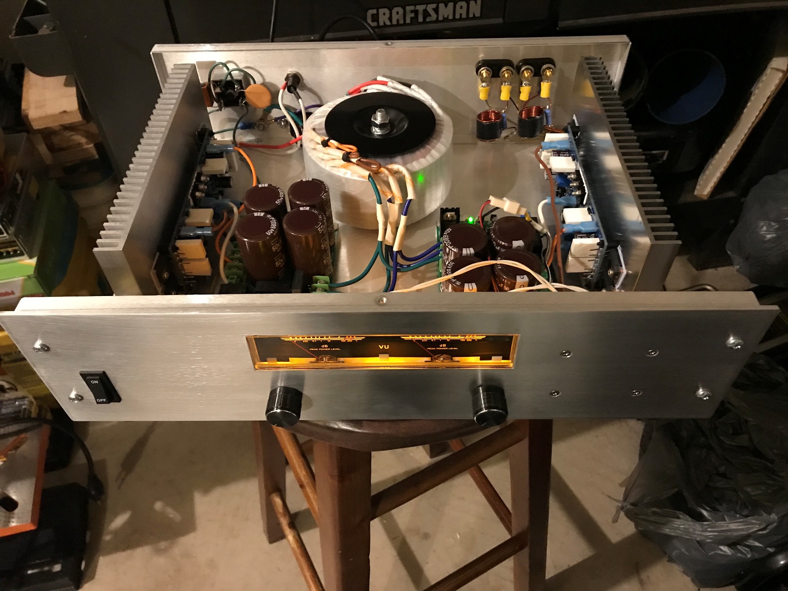

Finished Chassis for L12-2
It's been a workout! I drilled, cut and filed all the holes to fit everything.
I did the few mods recommended by members of this forum.
I set the Bias to 8.3mv or 16.6 across the collectors.
Power supply is an AnTek AS3430 30V 10A/60VCT 300VA Low Noise Audio Toroidal Power Transformer.
Rectifier Filter Power Supply Board w Speaker Protection 50V/6800UF kit. 2ea.
Had to build Power supply board for the VU LED lights. It's set at 2vdc.
Cassis came from pimetalproducts HiFi DIY Audio amp chassis 20-16124N
Volume idea is from Elliott Sound Products, works perfect!
VU meter circuit is driven from speaker level output. It's an old circuit, requires no power supply, each meter is set to 100watts to 0dB.
The Rail voltage is +-43.1 vdc with 15mv ripple on each rail.
DC offset is Lt ch...11.5mv. Rt ch...10mv
Unit is dead quiet at idle.
Now onto the pre-amp project😛😀

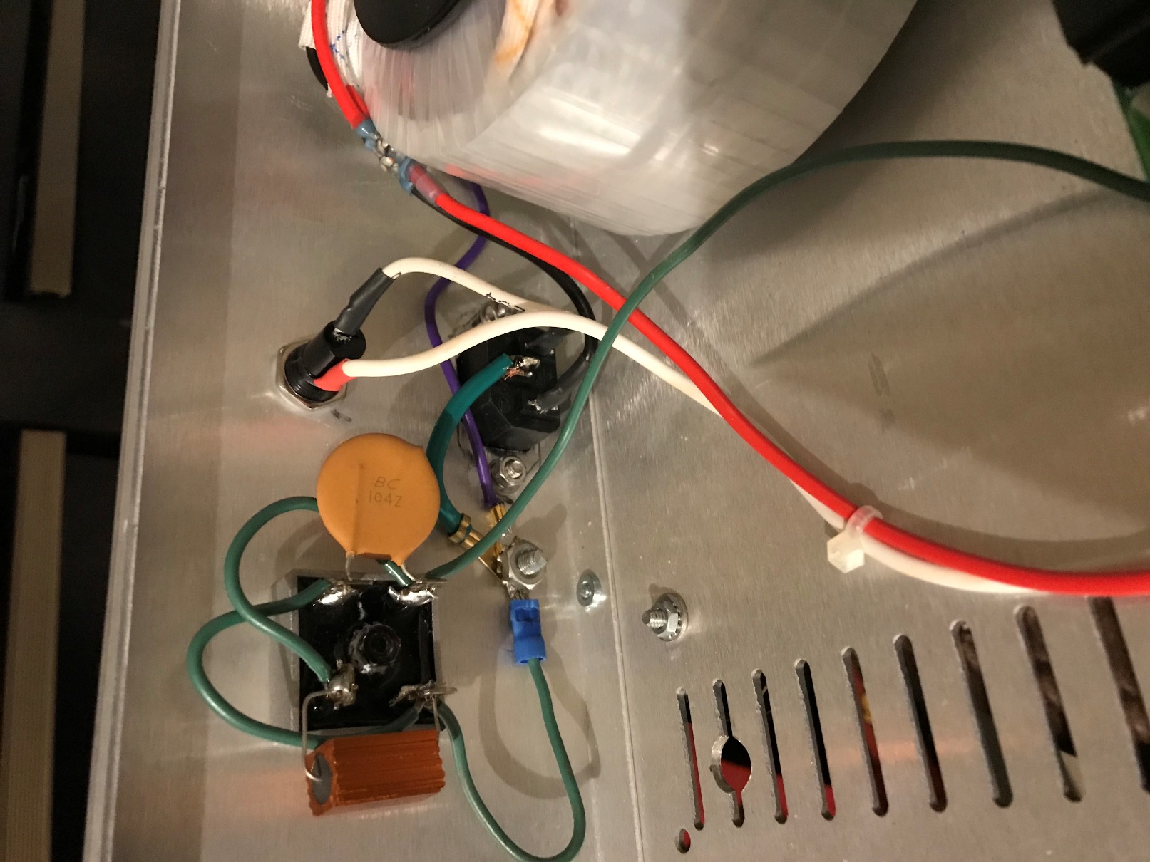

For ac voltage in, filter may be like that;
4.7nf, safety standards X1 Y2 400v (I used 2000volts)
330nf 275 volt, Polyester (X2?)
* and 1 turn for input ac cables in ferrite ring
If anybody advice better values?, those values copied from a PSU.

mdardeniz, where would those components be installed?
Pic?
